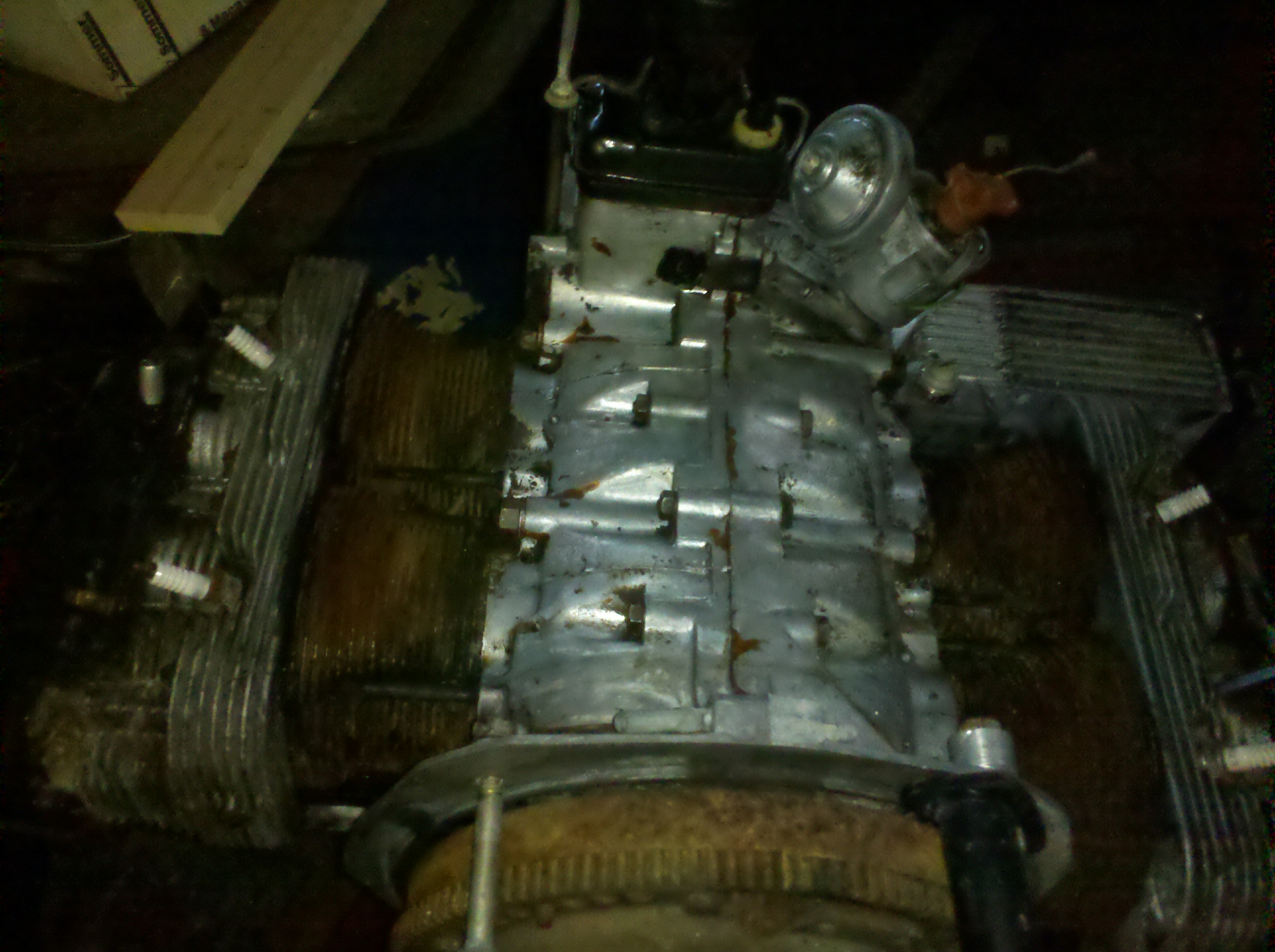

In the process of aquiring a 73 914 with a two liter and 916 suspension.so far I have gotten the motor,cleaned the crap out of it,cleand the exchangers up,dismantled the long block ,I don't plan on spliting the case.I broke the heads down everythings good except exhaust vavles .its a low milage engine and looks as ifthe vavles on the one side wernt properly adjusted and peened the tops of the stems up.the guides are all in good shape .bill got me a great deal on valves and lifters witch just arived .the carbs are courtesy of a friend of mine and need to be claened and rebuilt but I have a set of fdelortos that come with the car also....
That's it for now

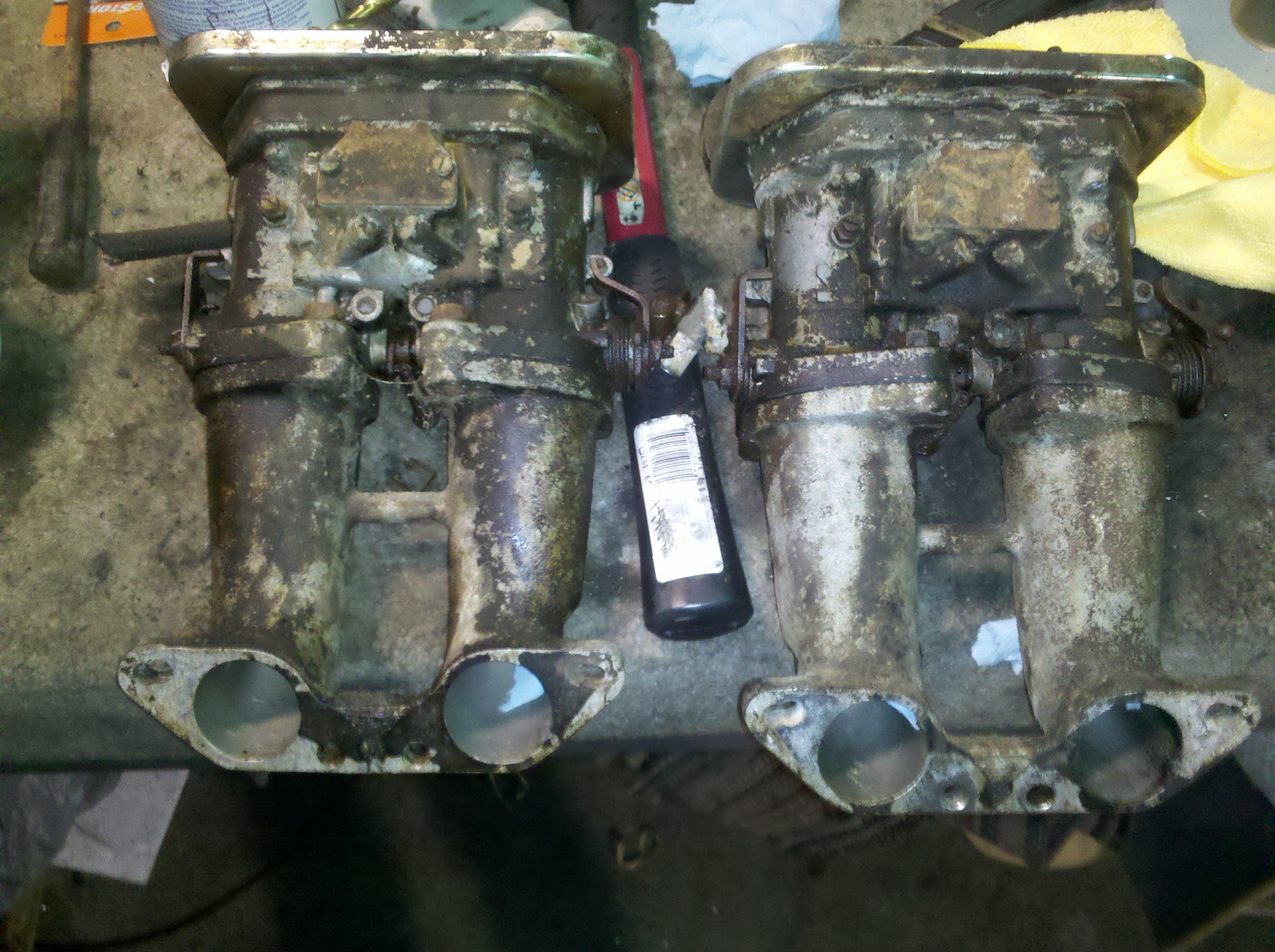

Weber 44s need of help considering using

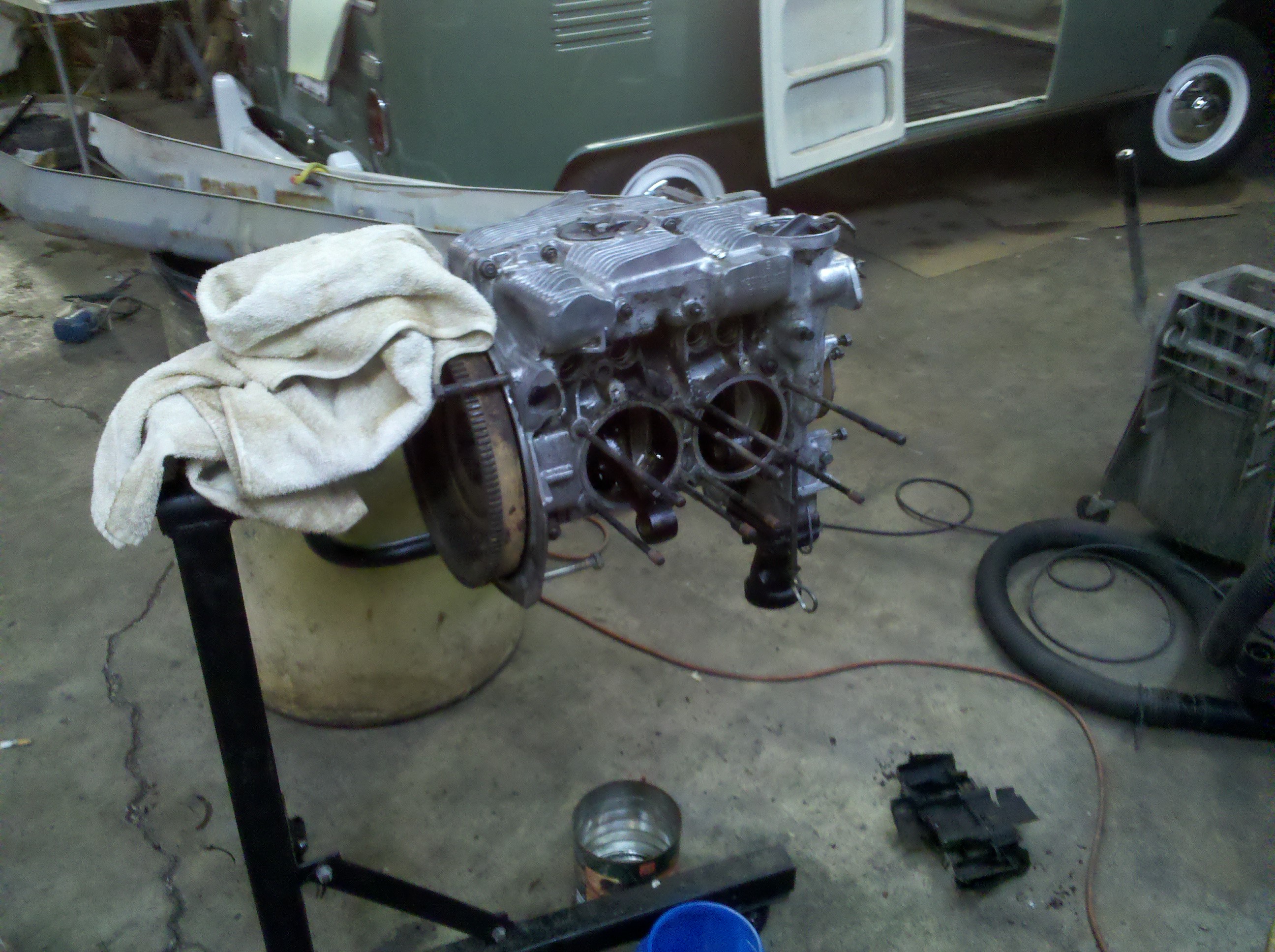

Dissasembled block ,thanks bill

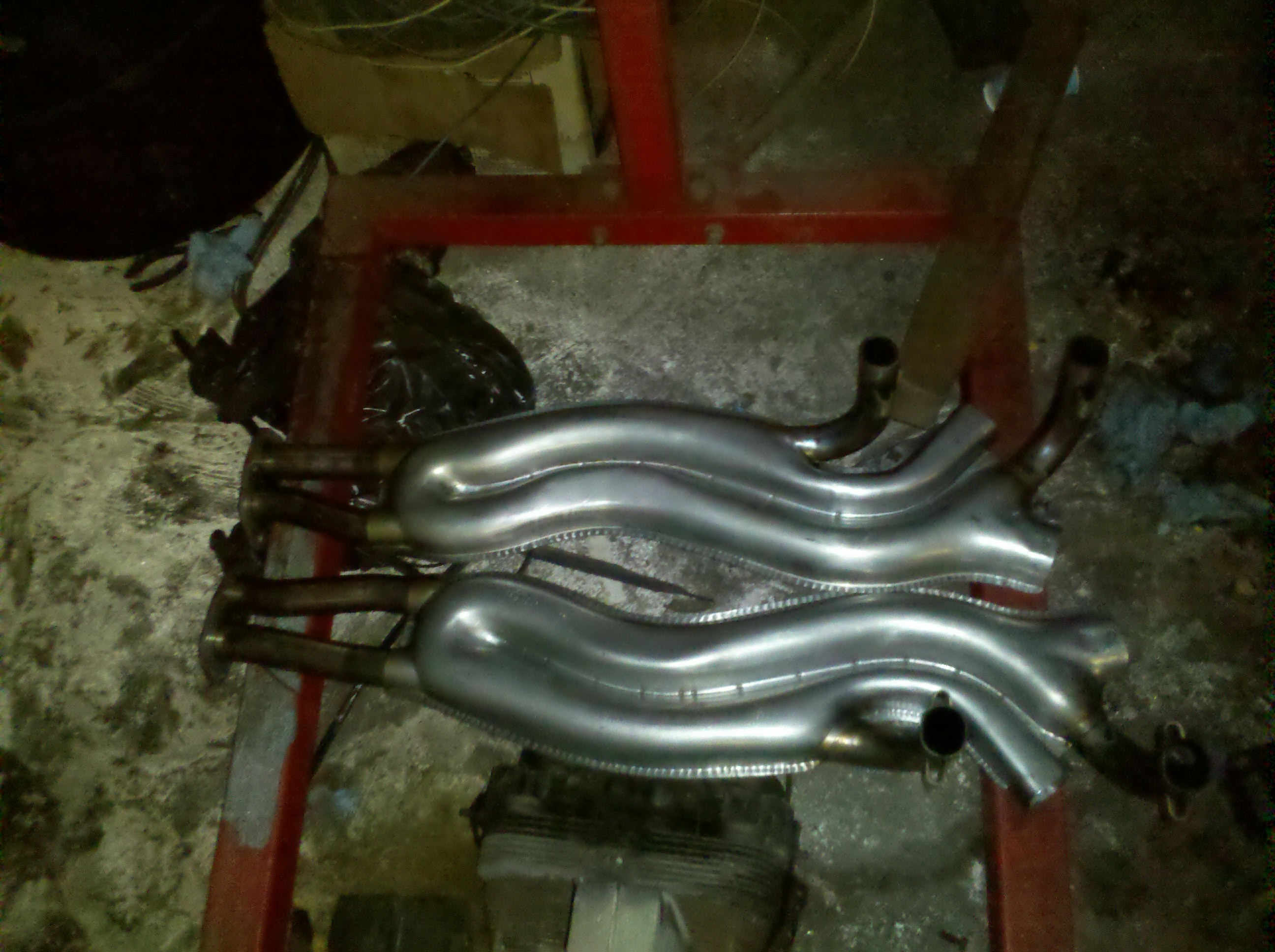

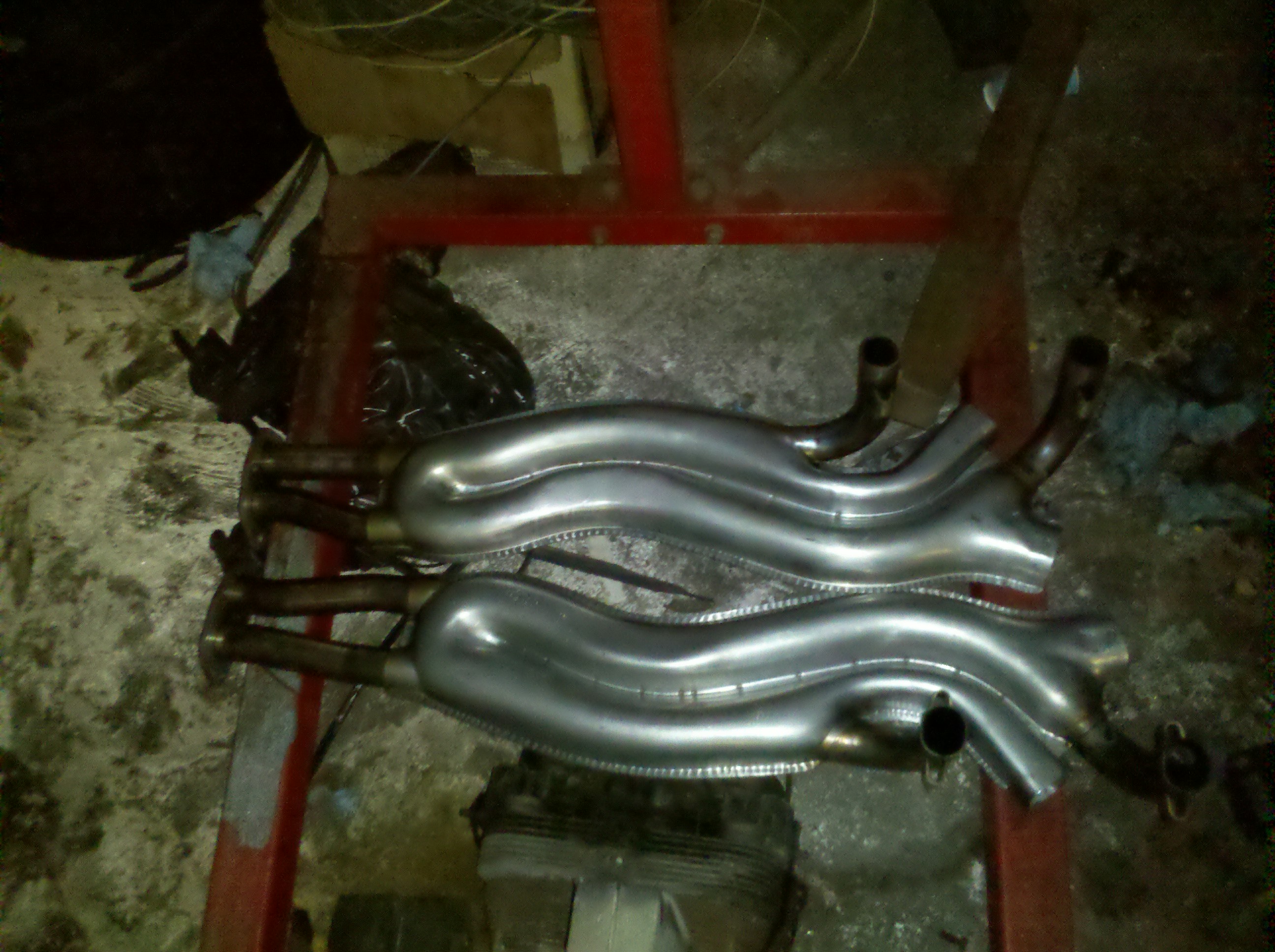

Heat exchangers
Heat exchangers
Cleaned and shined
Cleaned and shined

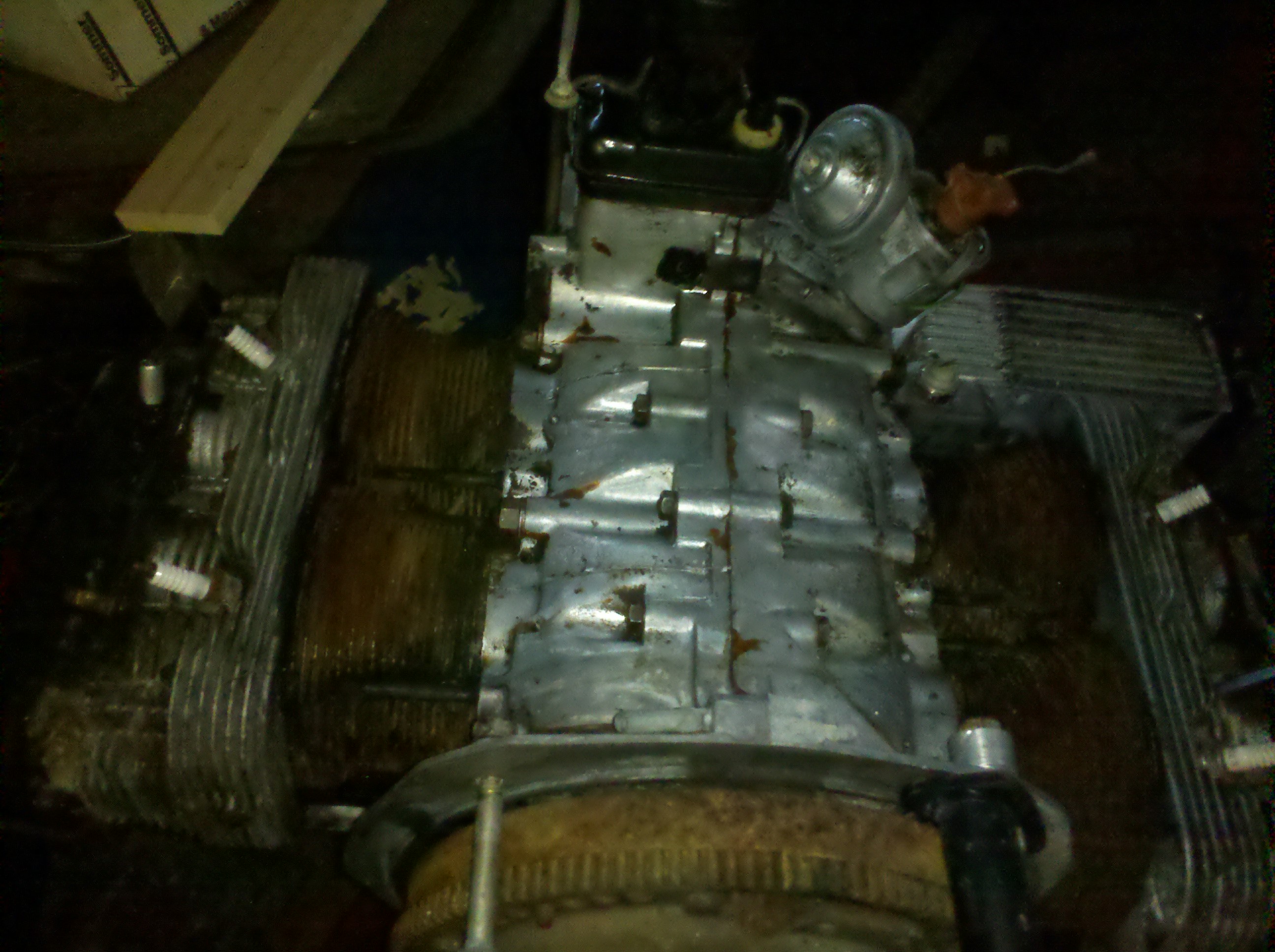

All clean ,rebuild next .even if I don't use them its still worth having ready on the shelf.

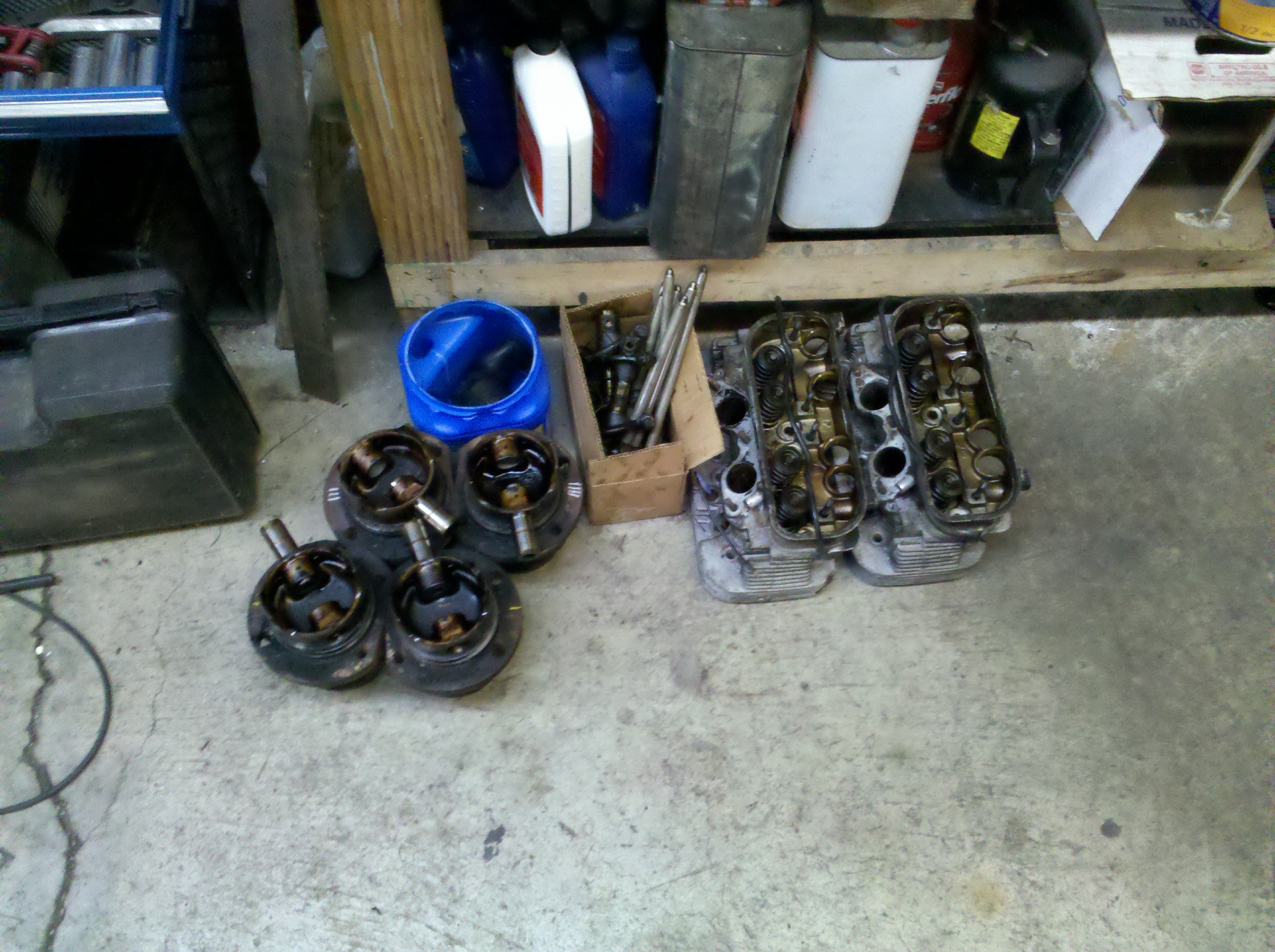

Currrent update ,heads are apart and new valves are lapped in ypon futher ivestigation I found the exhaust guides need replaced .so at my buddys shop I popped them out using a intresting way only can be used for removing.he had a special acessory for his air hammer that fit the guides and slowy pushed them out a real life saver ,I have new stainless vavles that I am putting in so. All I need is the guides and these babies are all finishd up.more pics soon
