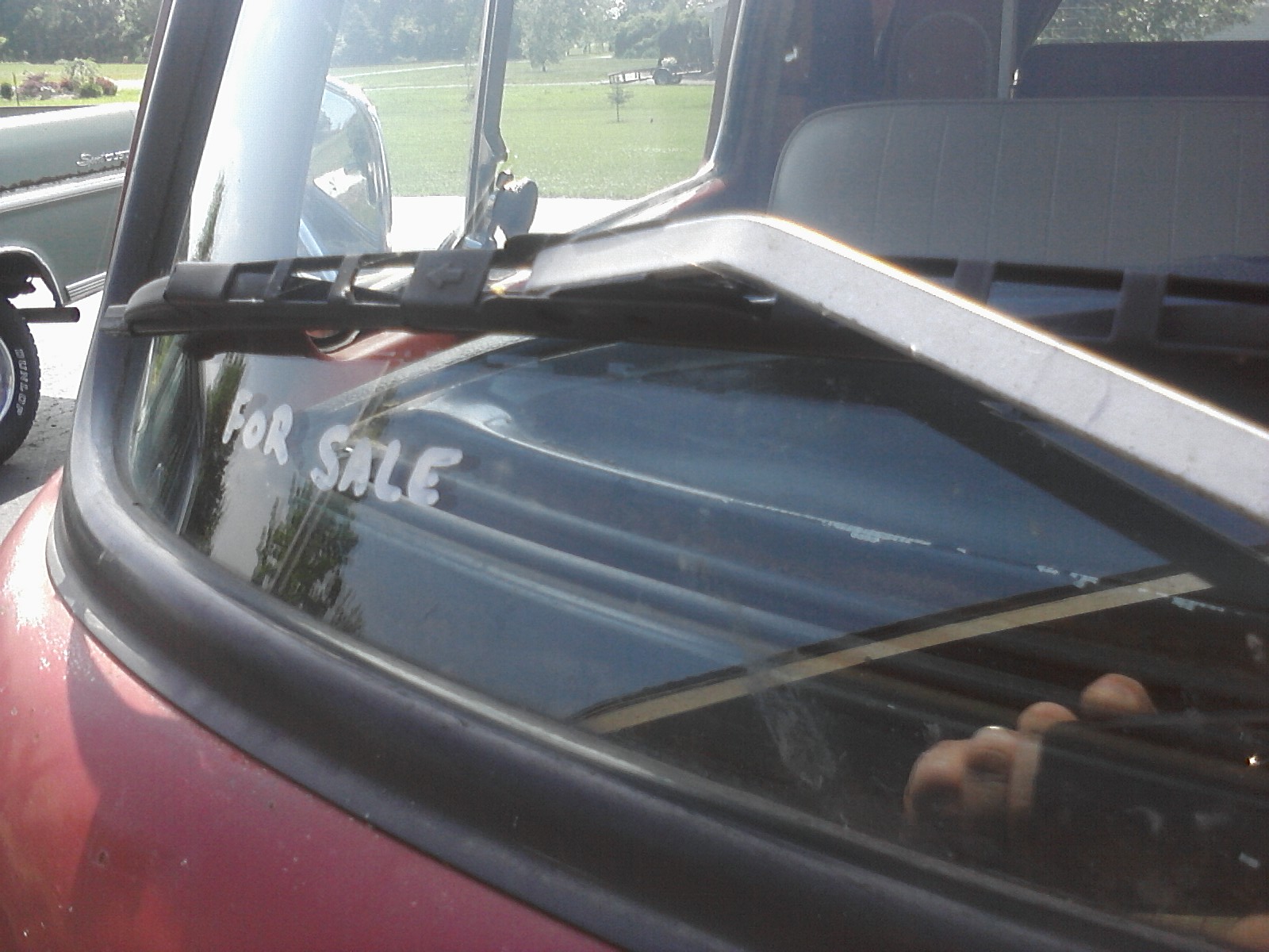

westy66 wrote:
Ron wrote:You should just go over to Kirk's house and take that red bus back. And tell him tuff luck buddy. :shock:
It's for sale..... I saw the sign :lol:
I don't know how you could miss that sign! :lol:
