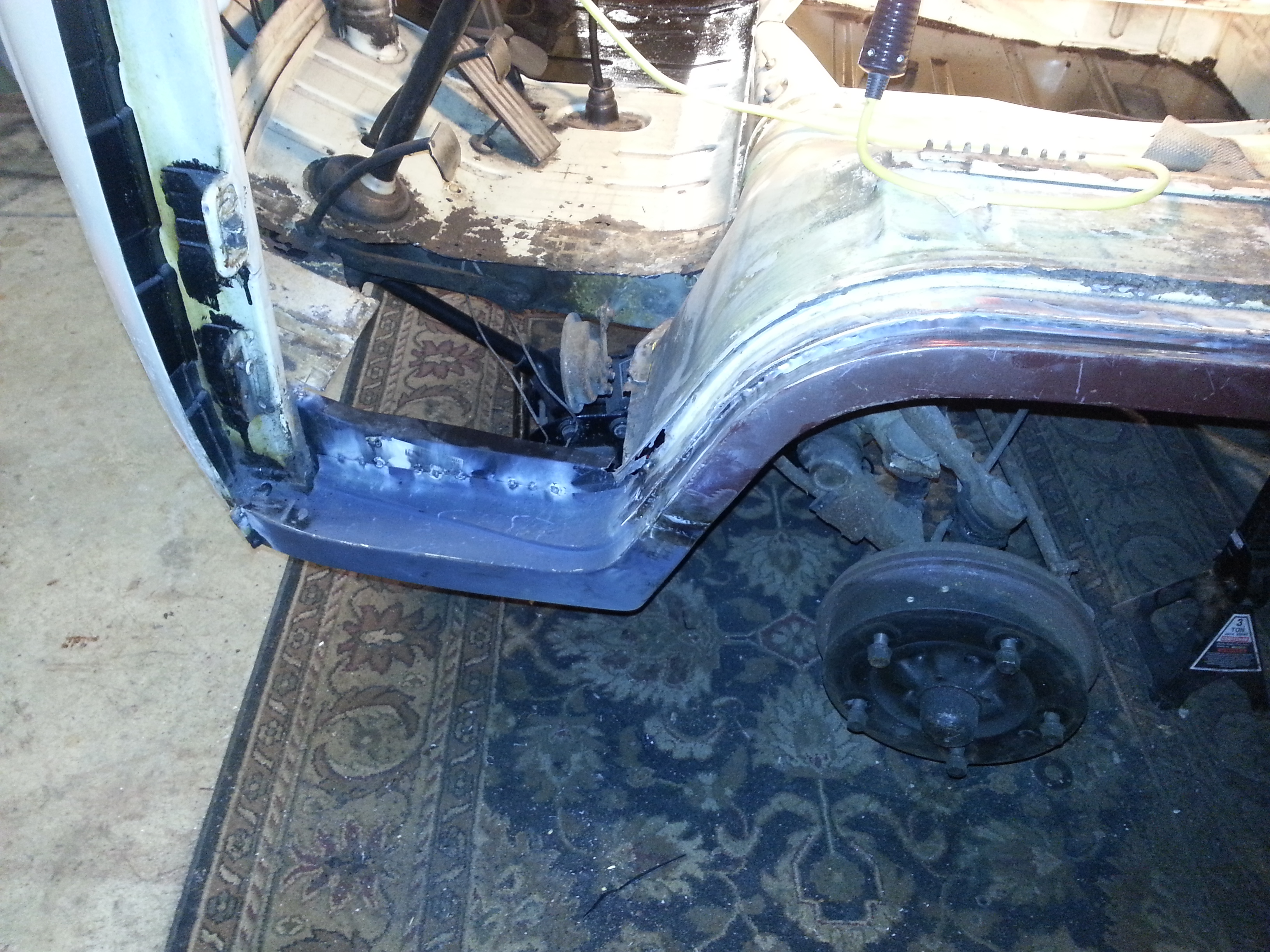

Today's work. I didn't buy expensive pieces. Used what I had laying around and David just worked with what I had. I had most of the rot cut out before he came over. Passenger side is mostly roughed in. I have to do the front valance, but That's down the road a bit. Going to fix the drivers side this week. Here is a couple pics.

Keep the pics coming Pat. I have similar issues on my 68 so this is a learning experience for me.

How is the frame on your 68' Ken ? The dog leg area metal wasnt to much . But the rear corners , man ! Im glad mine are good .

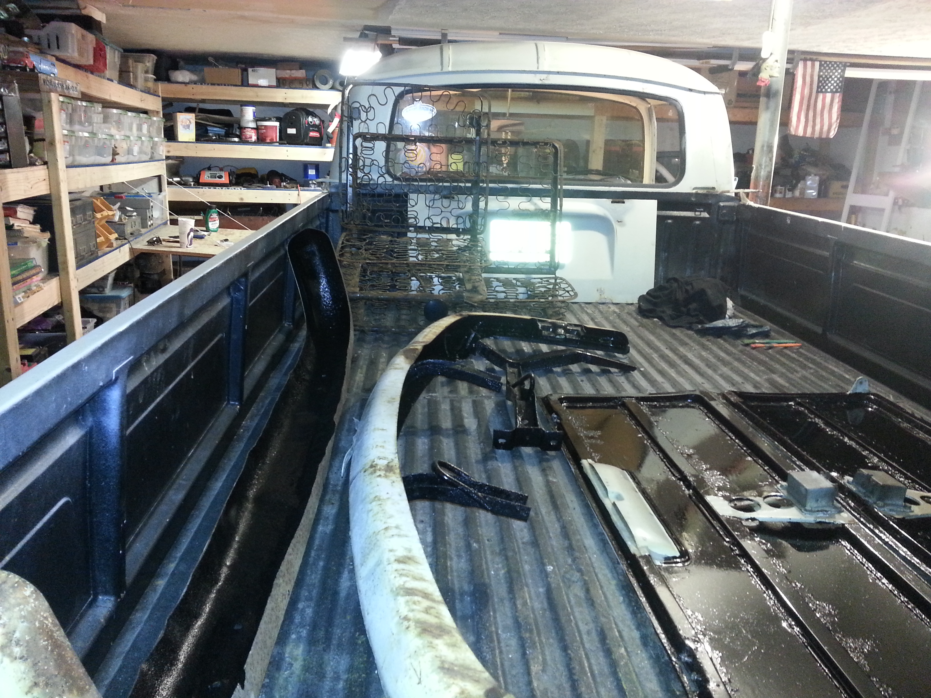

Some more headway was made on the truck today. I did a lot of POR 15 work ( in all the tracks were the door seals go and inside of treasure chest doors. Used one small container which goes a long way. Here's pictures.

Nice work Pat. That POR-15 is great stuff. Just don't get it on your hands or face!
Unless you're looking for a perfect show finish, home bodywork is certainly "dooable". It's messy and time consuming, but there are a lot of great products out there and plenty of "you tube" lessons for beginners like us. Cutting out that bad metal is key and it looks like you've got that handled. Josh knows a lot about the 3-M body work products so ask him. Some of those 3-M products, while a little pricey, are awesome. Keep at it and keep the pictures coming.
