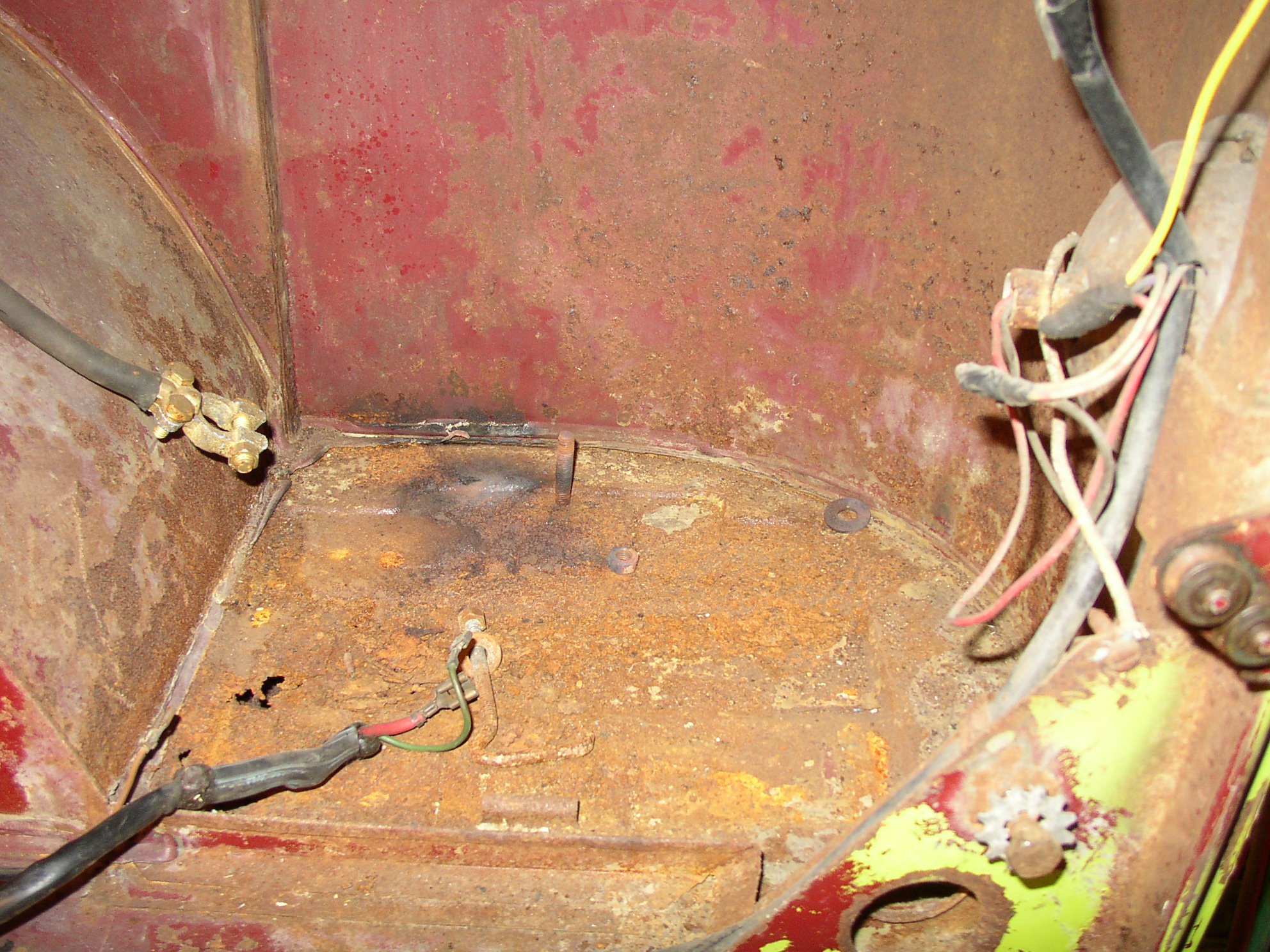

Even inside the battery tray area doesn't look horrible after sandblasting.
There was a mudflap screwed here with 3 sheetmetal screws. Is that OEM? The screws came right out, maybe that's what saved the corner.
It's getting a new tray, of course, along with the corner.
