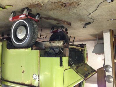

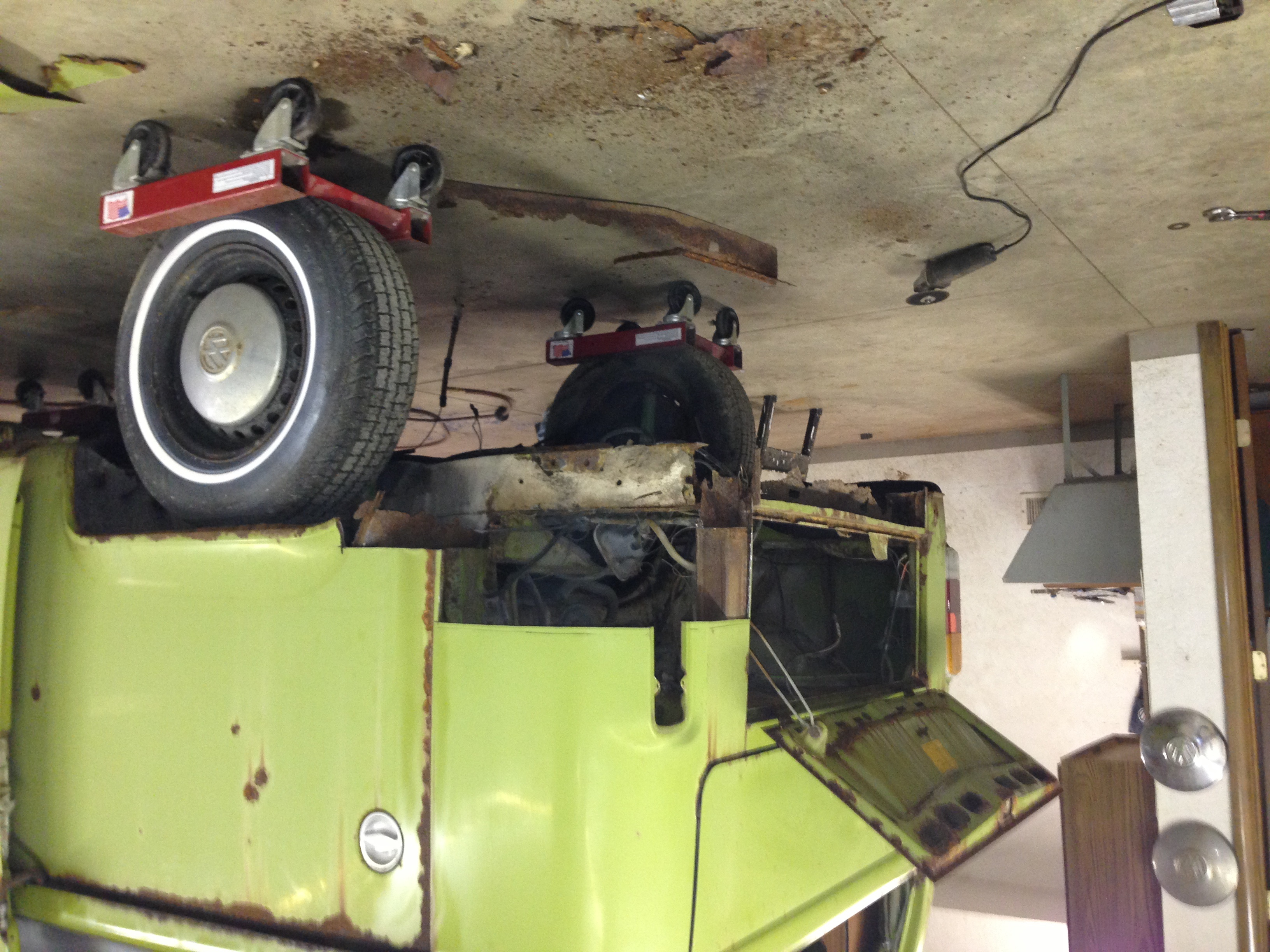

Made a lot of progress today on the body work. 90% of the undercoating is still there I had one bad area to cut out. I made the rear apron from scratch and part of the rear fender.

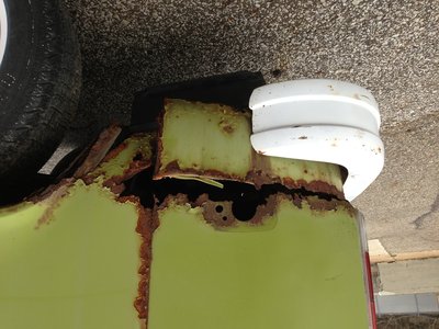

Cut out.

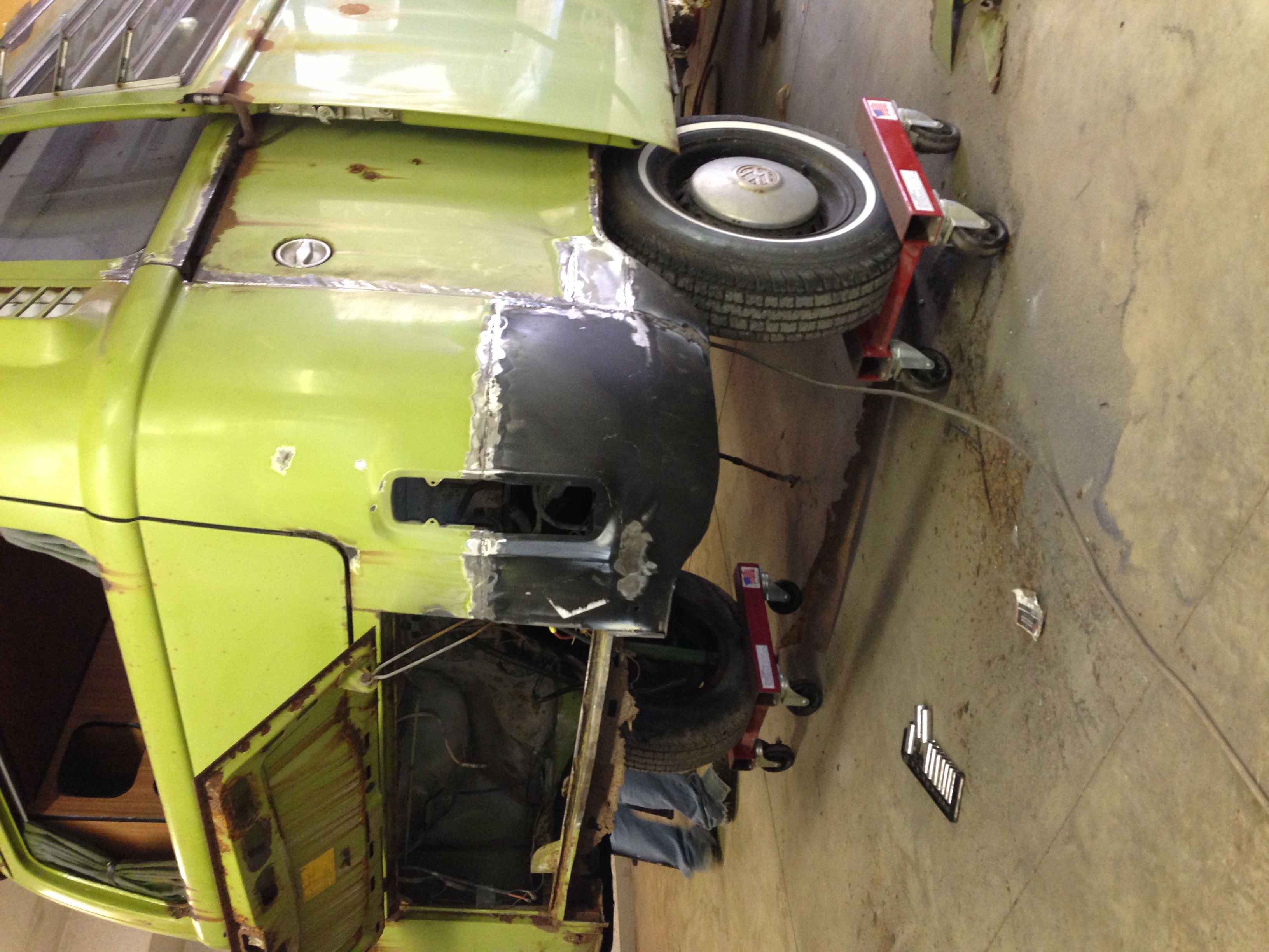

All welded in.
