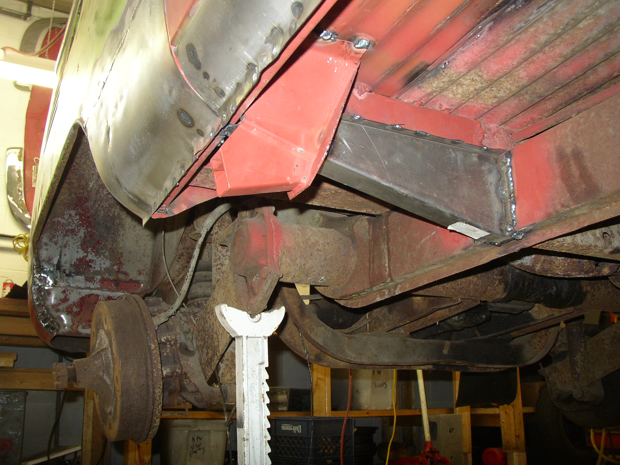

I was in Florida last week so nothing got done. I had some time this week, so I finished putting the outriggers and jackpoints on. I also took some wire rope and cleaned out the clutch tube, brake cable tubes, and throttle tube with a drill and brakeclean. I'll do the heater cable tubes later.
LR outrigger/jackpoint. I used Autocraft on the right side and "Brand X" on the left side. Sure hope I don't get a flat on the left side. The black ones feel really chincy compared to AutoCraft.

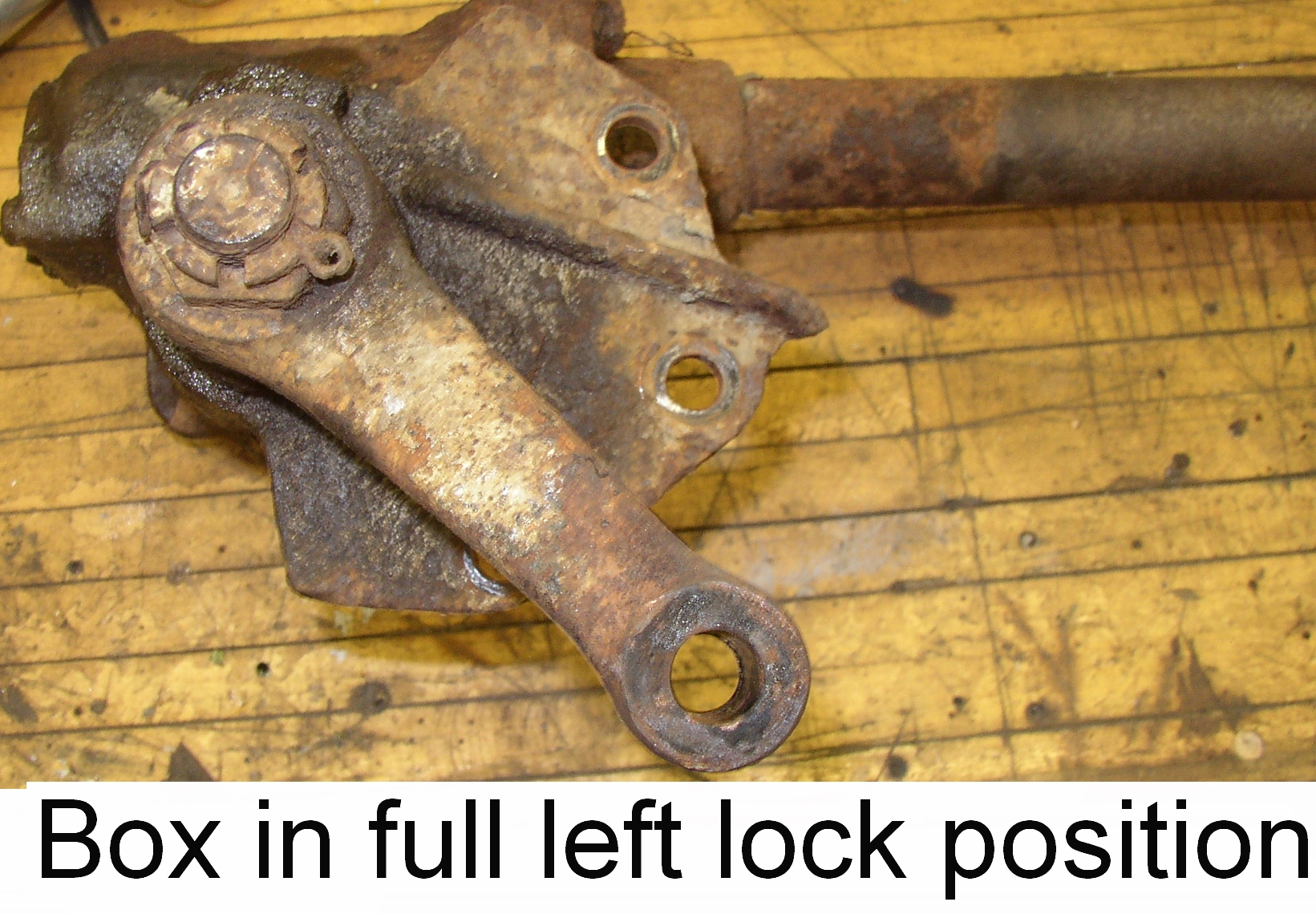

I pulled the steering box apart to make sure things were OK inside, and to clean the pitman shaft before putting a seal on it. I drained the oil which was really ugly with traces of water. If you guys haven't ever changed your steering box oil you might want to think about it!
I didn't know if the pitman arm was indexed onto the pitman shaft or not (most are) so I figgered I'd shoot a couple of reference pics of the arm at each lock point. Good thing I did, 'cause the pitman shaft is NOT indexed to the shaft.... :)
Once I got the cover off and looked inside, it was yucky but still usable after cleaning up with brakecleaner:
There was evident of water inside, but not enough rust to get excited about:
The seal itself (CR9710) I'm having trouble finding available locally, Napa's closest one is in FL. I'll try some other suppliers locally Monday before resorting to a VW supplier. In a pressurized application (power steering gearbox) I almost always replace the shaft because in the salt belt the seal surface gets rotted and the seal won't last. Being this is not a pressurized seal means it's not as fussy. Here's the shaft before cleaning it, the rust stains came out with 400 paper and the seal surface will be fine because it's not pressurized. I've changed hundreds of pitman shafts in domestic trucks and cars because of a rotted surface like this. With 1500psi behind the seal this shaft would eat the lip of the seal off in short order:

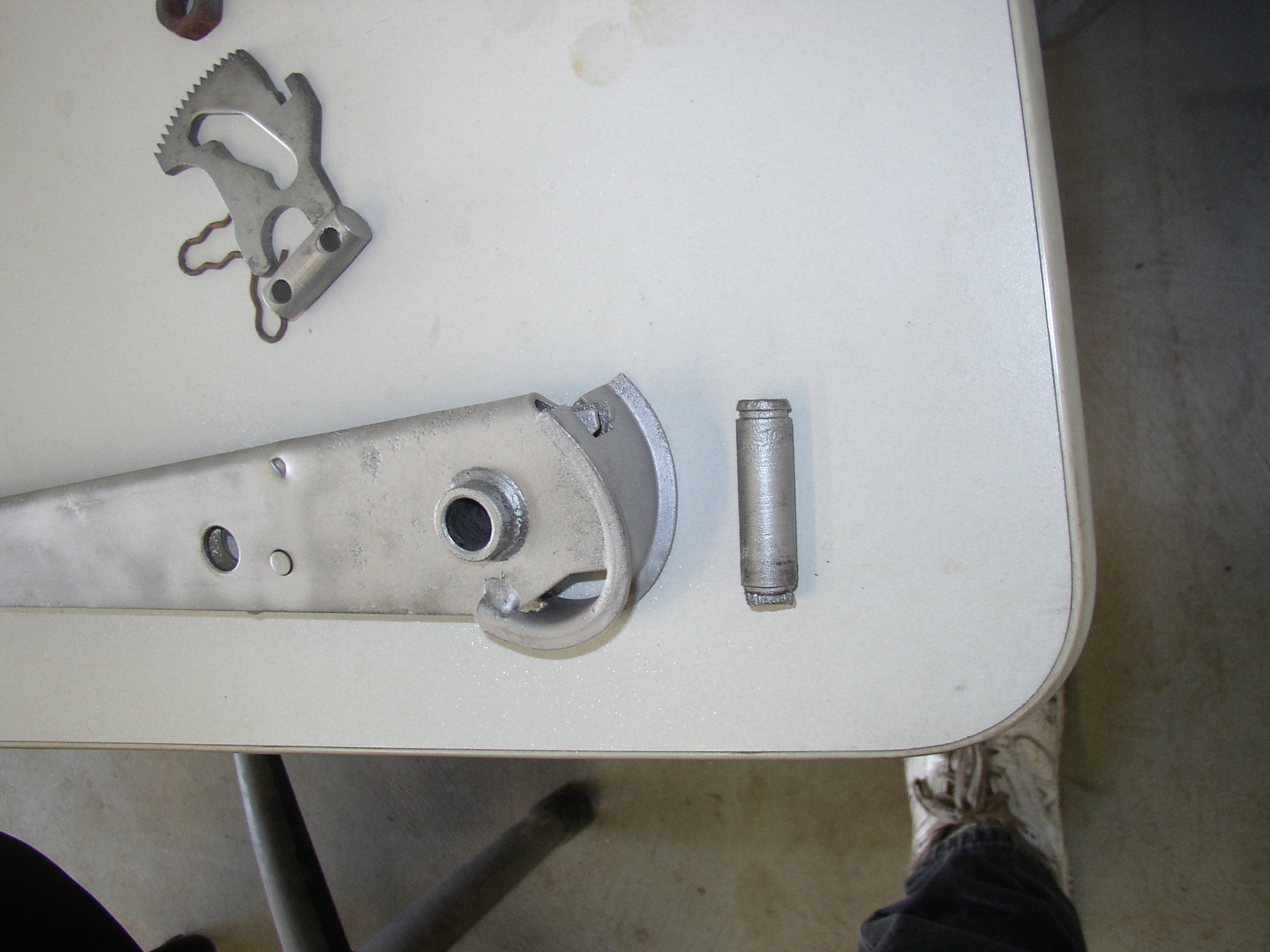

This little pin for the parking brake lever was a true MF, it took a couple of glow-twist-tug-pry sessions to get the little bastard out. On Samba it seems like they usually use a Sawzall or hacksaw to cut the pin but I didn't want to resort to that.
Oddly, once beadblasted, the pin falls right into the lever and is almost reusable.

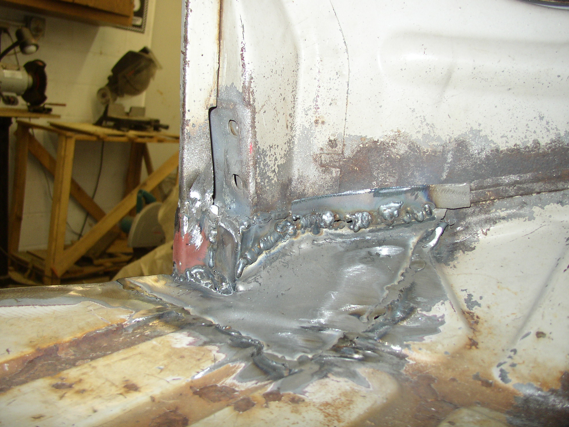

Left A Pillar with all of the bad stuff cut out. I also tented the bus again and sandblasted the areas to be welded.
Right A pillar with all of the bad stuff cut out, and the toe kick cut out.
Roughing in the right side "A" pillar metal.
That's the nose skin unfolded- it's not welded, it's CRIMPED onto the other piece all the way up!
Right side welded.
Left side, A pillar done, floor done, weatherstrip rail done. Not pretty, but functional.
