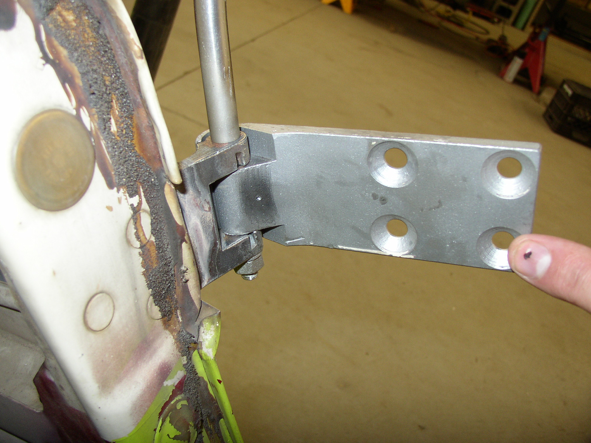

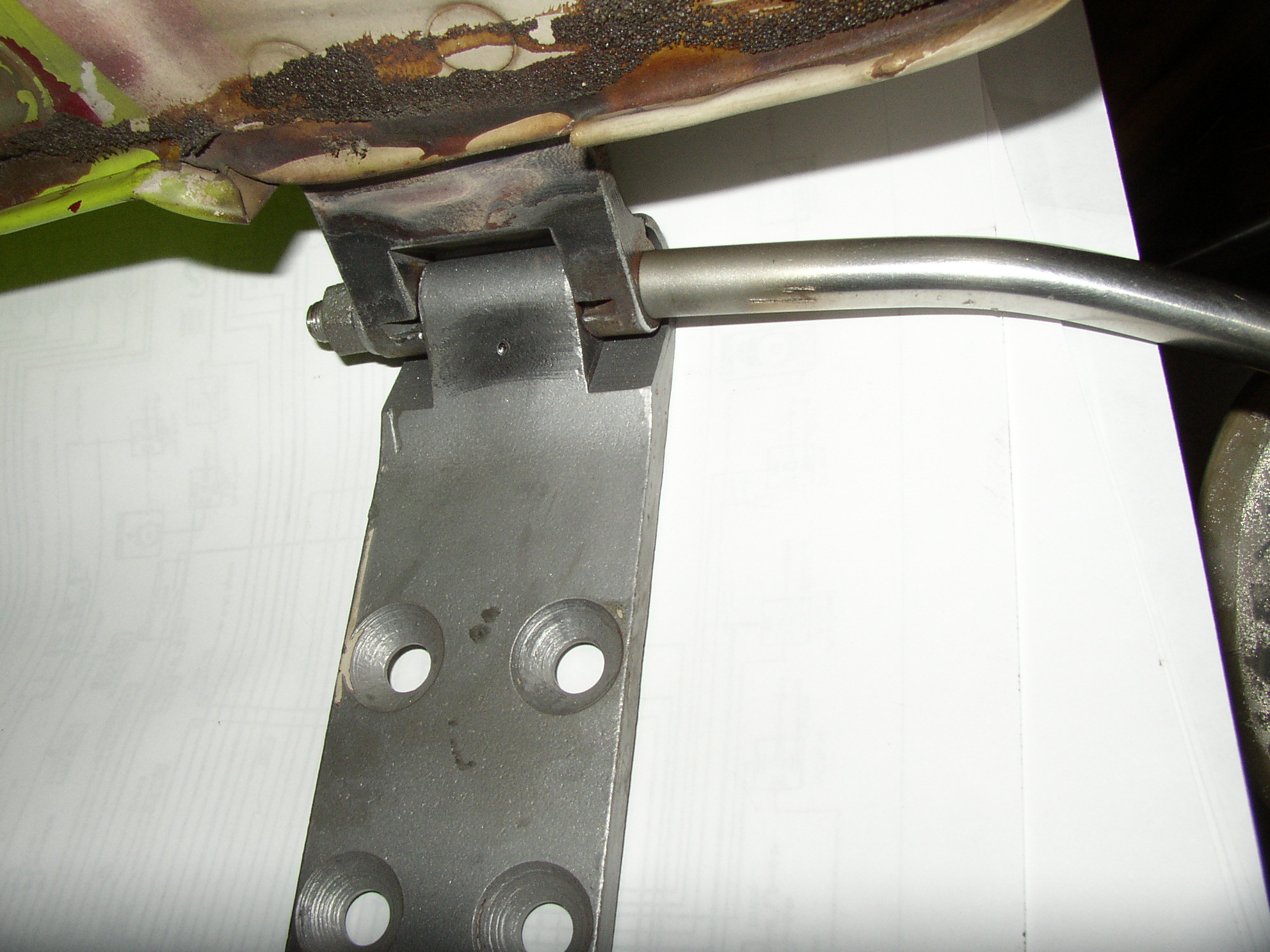

Lynn the JCW photographer came by to shoot some more, so I removed the doors and did the driver's door hinges. Pretty much the same deal as the other side, glow them, beat the pins out, clean/beadblast/ream, drill a lube hole, and assemble with a new pin and mirror arm. These were not as bad as the RF so I didn't have to braze them up and resize them.

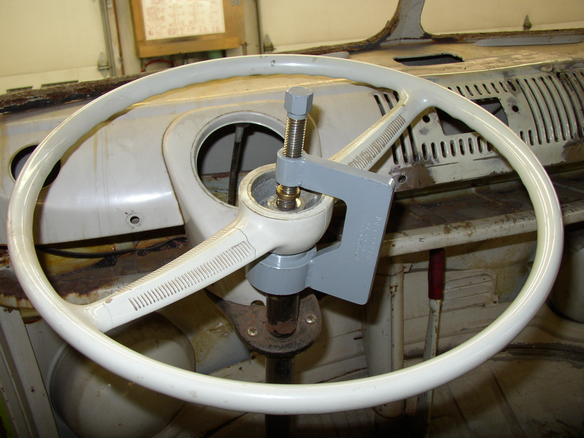

I pulled the steering wheel off with a borrowed puller (nice, eh?) and pulled the box out. It leaks so I'll open it up and at least reseal it if everything looks OK. I was fighting the brake lever pin with the torch and VGs but I didn't shoot any pics of it.

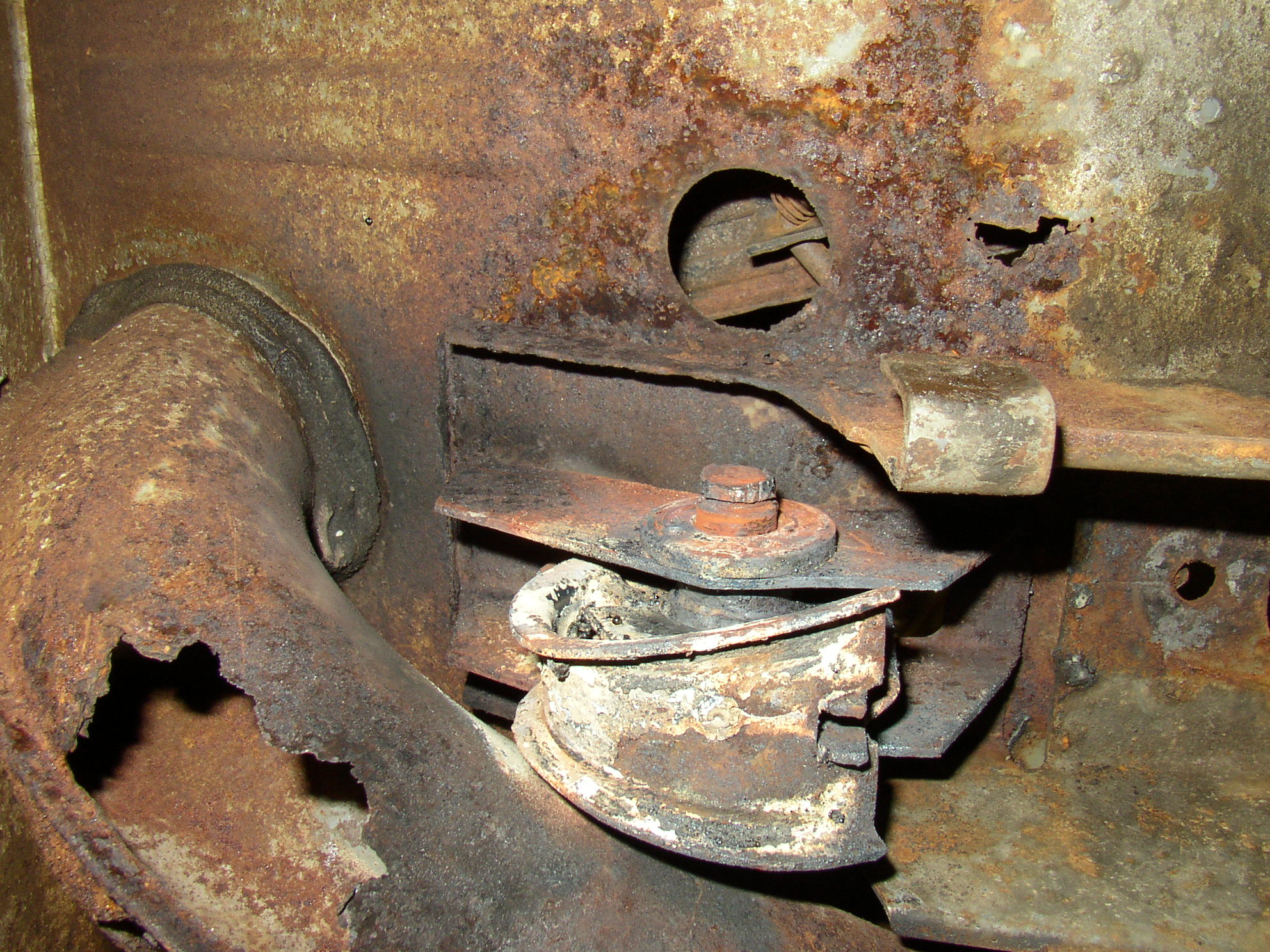

This shows the rotted apron, the heater tube which I'll patch, the leaky box, and general yech. This will make a nice "before" picture in a few weeks or months......

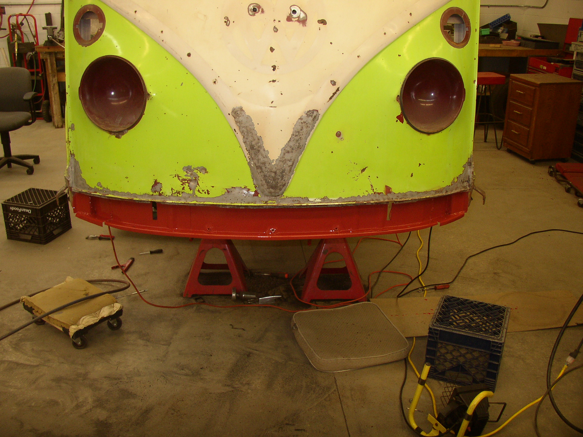

I took the column, package tray and doors off. Looking pretty empty up front right now, I can easily lift the front of the bus off the stands by hand. It's so light it's wobbly on the jackstands because there's not enough mass to keep it stable. I have a safety chain looped through the windows to an overhead beam in case I pull it off the stands while I'm working on it. Scary. :shock:
I'm roughly 180-190 hours into it, probably 3/4 of the way through the welding. I'm happy, and it's going quite smoothly in my opinion. Like I said previously, I'm revisiting skills I haven't used in decades.

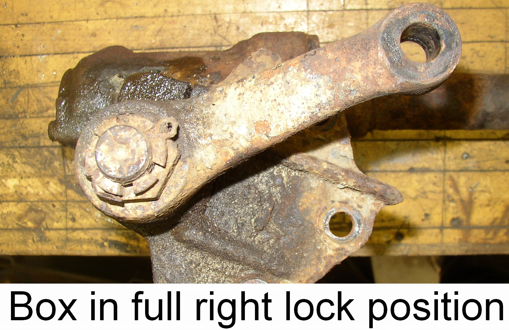

I didn't know if the pitman arm was indexed onto the pitman shaft or not (most are) so I figgered I'd shoot a couple of reference pics of the arm at each lock point. Good thing I did, 'cause the pitman shaft is NOT indexed to the shaft.... :)

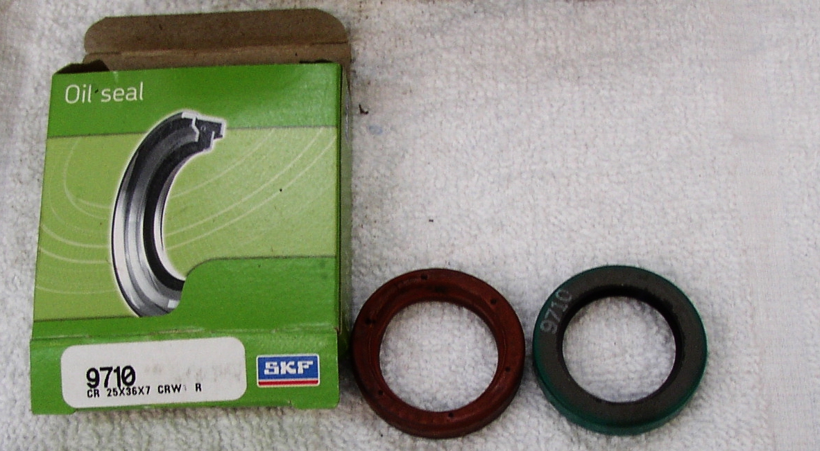

The seal itself (CR9710) I'm having trouble finding available locally, Napa's closest one is in FL. I'll try some other suppliers locally Monday before resorting to a VW supplier. In a pressurized application (power steering gearbox) I almost always replace the shaft because in the salt belt the seal surface gets rotted and the seal won't last. Being this is not a pressurized seal means it's not as fussy. Here's the shaft before cleaning it, the rust stains came out with 400 paper and the seal surface will be fine because it's not pressurized. I've changed hundreds of pitman shafts in domestic trucks and cars because of a rotted surface like this. With 1500psi behind the seal this shaft would eat the lip of the seal off in short order:

I cleaned stuff up and resealed the steering box. Local bearing places did not have the seal in stock and wanted to charge me freight to get it in, so it was cheaper to buy it off of Ebay for $12 delivered. Strange how that works......

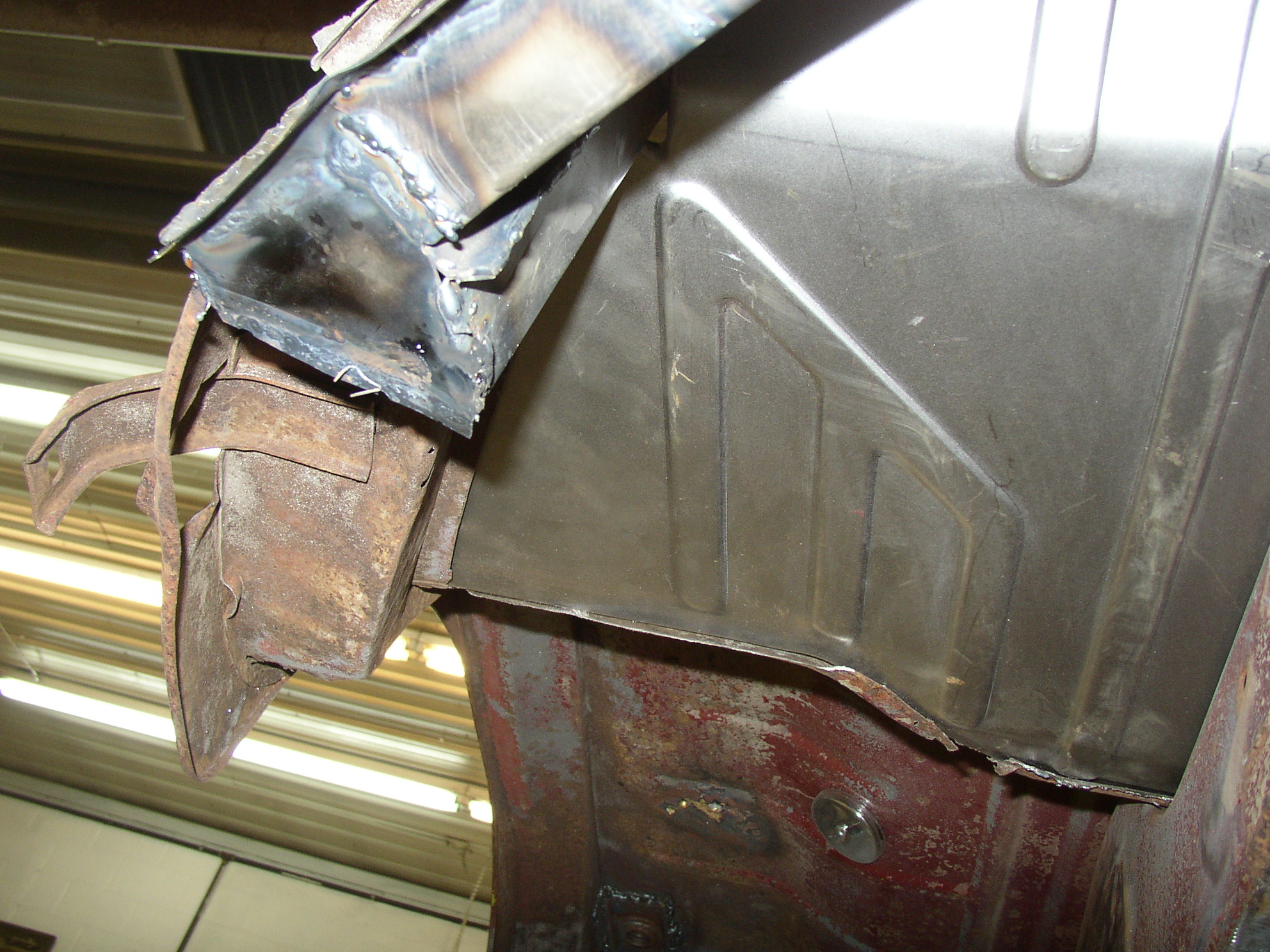

Left A Pillar with all of the bad stuff cut out. I also tented the bus again and sandblasted the areas to be welded.
Right A pillar with all of the bad stuff cut out, and the toe kick cut out.
Roughing in the right side "A" pillar metal.
That's the nose skin unfolded- it's not welded, it's CRIMPED onto the other piece all the way up!
Right side welded.
Left side, A pillar done, floor done, weatherstrip rail done. Not pretty, but functional.
I actually have the whole inner valance welded in and it went easier than I thought, but I didn't shoot full pics yet. The AC piece fit fukking perfect.
Next- right floor. The AC panel sure fits better than the black generic POS I used on the left side. :roll: That should go quickly, then the lower front outer valance. Tip- buy the lower A pillar pieces unassembled. If they're assembled and welded (which a lot of suppliers do) you can't install them with the nose skin on. I got lucky by chance and got them unassembled. 8-)
