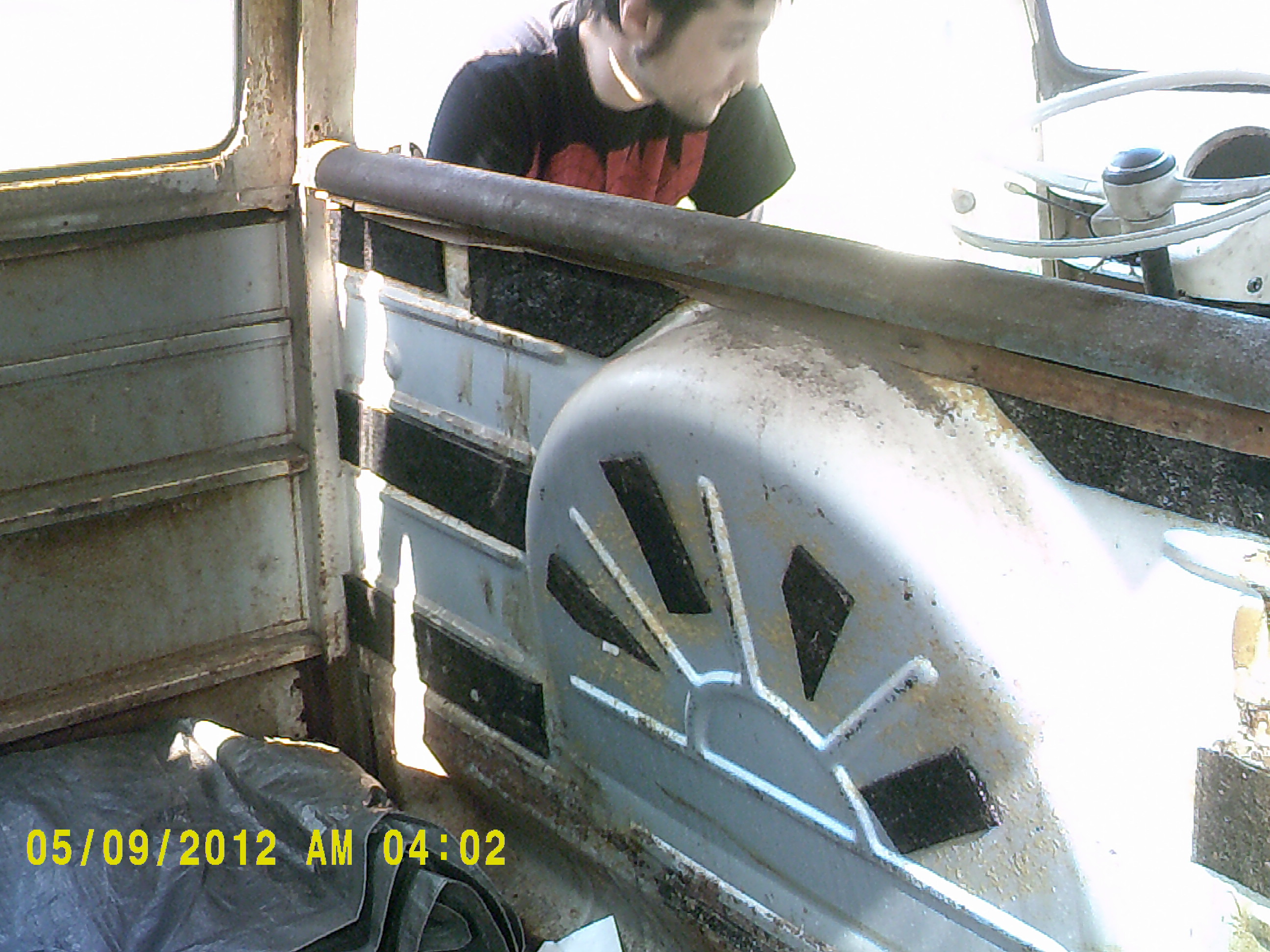

front interior
There is a lot of sheet metal to do, then on to mechanicals

Caramel interior, that usually came with a Mango, not sure what else. You have a picture of the M-Code plate?

The Interior panels have been stripped out, bagged, tagged, and put into deep storage. I never throw away anything I find in the vehicles, no matter how crappy or garbage like it appears.

Interior panels coming off, every last piece is catalogued, wrapped in plastic, and put in storage
Panels gone, my brother in picture has been a big help with everything
