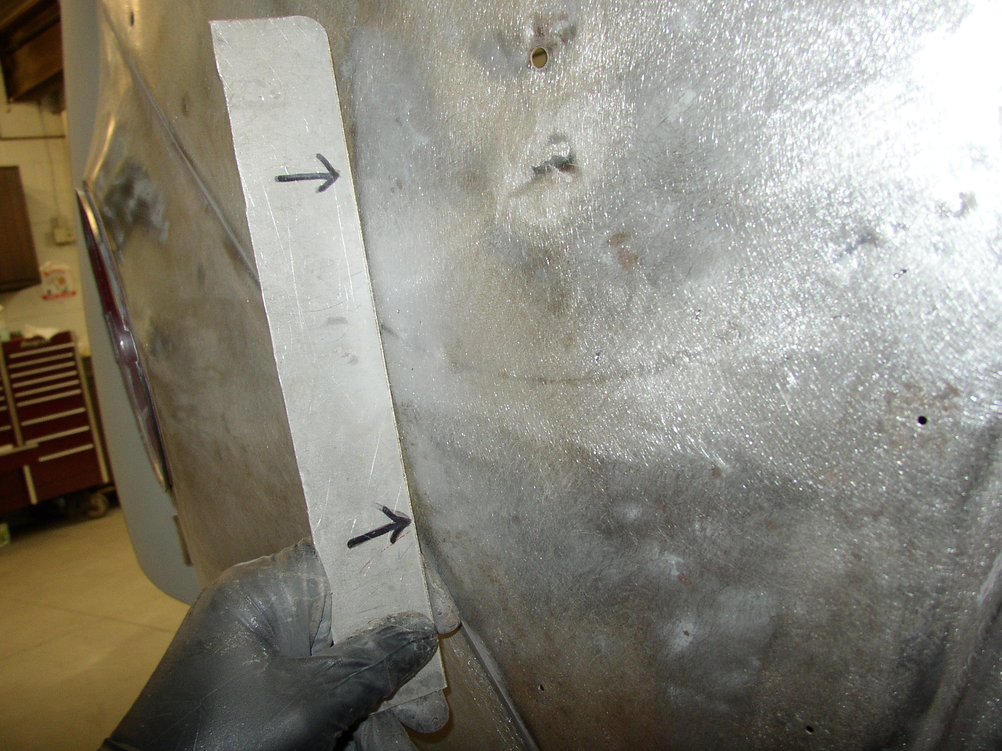

I did use a stud gun to pull several minor dents out of the nose of the bus. This is a cool tool- it welds a nail to the skin, which allows you to pull the dent out when there is no access to the rear side. I'm thinking this dent is from someone bumping the front-mounted spare tire.
Once the nail is secured, a hand puller can be used to pull out the low spots along with a body hammer to lower the high areas around the dent.
If this is not successful, a slide hammer can be called in to provide more brute force.
The results were terrific- here’s a straight edge showing the dent is gone and the correct crown is back in the metal with only a super thin skim coat of filler needed. This one came out so well that high build primer might be all it needs. I use a straight edge as a cheat constantly because it's a lot better than my eyes or fingers.

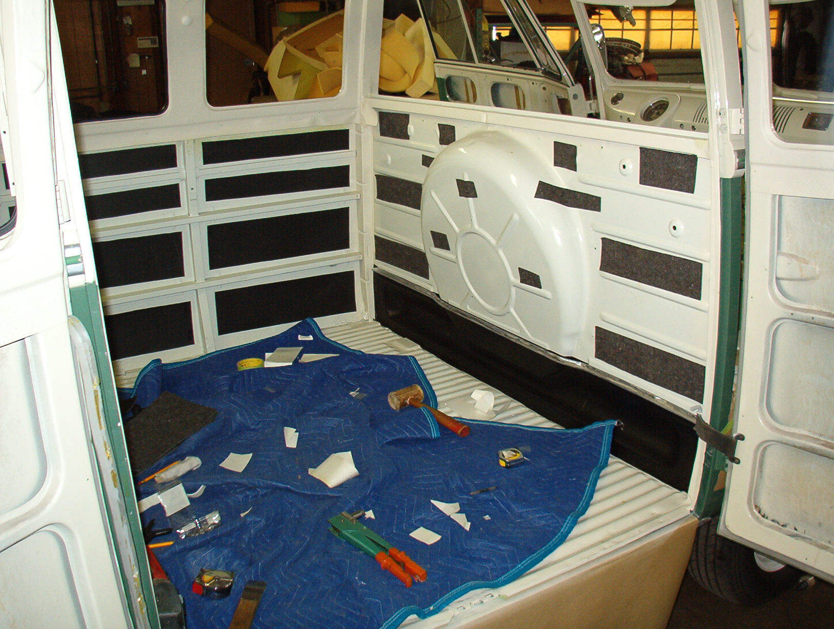

Bruce,here's somepics of one I did a couple of years ago. although this was a non walk thru, most of the holes in your pic look symetrical.

I like what I see in those pics. How did you fill the window openings- is that cardboard? I'm thinking of thin cardboard panels cut to fit the window openings and a million little magnets to hold them in place so I don't have to worry about tape. Once the inside is painted, flip the panels over to keep the paint from the inside as I'm doing the outside......
Nice workmanship. Solder. Blanket on the floor. Sound deadener.
I will be asking a lot of questions since you BTDT.......
Yep,cardboard panels. I used tape,the correct good stuff,but whoever did the body and paint job did little or no proper prep in the window recesses. When I pulled the tape,well you guessed it,bare metal was what I was looking at.
