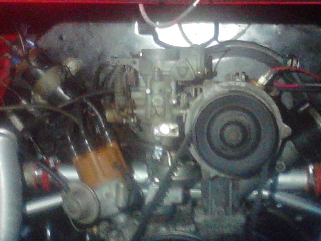

well thats the BIG problem. last month it had a good running 1600 duel port in it and now its in a few to many pieces..I found .069 end play on the crank so my brite idea turned into a scramble to hopefully at least get a couple months of driving in.. I should have at least drove it a couple times.. my luck the motor probly would have blew itself apart... :shock: :cry:

took the bus down the road today after fresh rebuild.. :D :lol: :D thank you RIS for the cylinder head work and advise. :D duel port thank you for coming out to help with the issues I had...I could not have been able to do It with out you guys.... :D :lol: :D

I went to Ed's to take a closer look at his rig yesterday and lend a hand getting it running. We worked out a few minor details in the engine bay but still struggled with a wicked lean miss that could be a vacuum leak or bad carb. He left a message on my phone today that the carb had junk in it and that took care of the problem.

bus is on the road but only little spirts..Im not sure if I have a charging system that works right together.coil gets super hot it will not stay running it idle after warm up and a few miles of road.runs good at speed get to a light stalls wont start... in need of mental assistance.......ed.....
