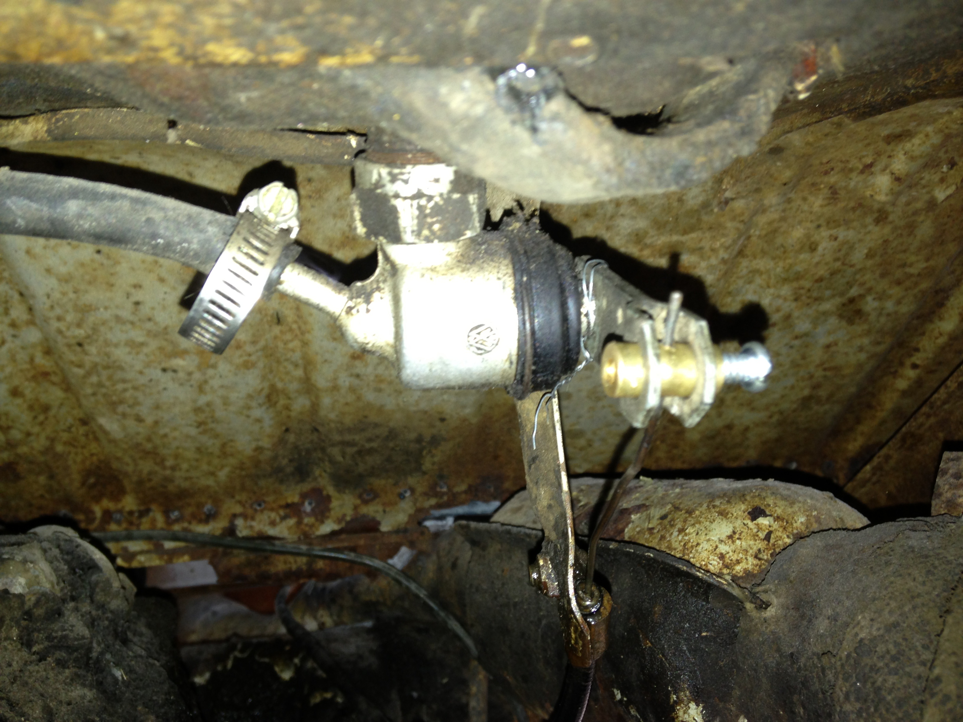

Got an hour in tonight. Have other stuff to do so Couldn't work as long as i would like, plus i had to run to get new fuel line. I picked up some fuel injection line rated for use with ethanol. $50 dollar lesson learned.
Thats what i like about this site, guys like W5, Chuck, and toolbox will just tell it like it is, without the sugar coated fluff.
Granted it is not the stuff TB said to get, BUT as long as it gets me through till next summer i will be a crappy hamper. I will ultimately get the multi fuel hose for next year.
X
I also looked through my misc. stuff and found the arm for the fuel tap, but nothing else. I used a cable stop and it seems to have worked.
Stupid question time. Is the position it is in now the main or reserve? It appears to be a VW and not a WW if that makes a difference
X It is "up" if you cannot tell.
and again thx toolbox for pic and guidance
PS the pic is before i changed fuel line.
Re: 1961 Microbus
I think forward is reserve,if I remember correctly,I do remember having to put a bow in the cable(like the clutch cable) in order to get full travel of the lever. In other words,don't cut it to short (like I did)
before you are sure you get full travel of the lever.
