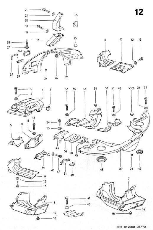

got 6 hours in yesterday. new total 147
stripped and painted some engine tin, changed fan shroud, installed flaps and stat, wire wheeled and painted heat exchangers. changed and gapped plugs, changed wires.
engine is in.
still need to install muffler and heat exchangers, plumb fuel, and connect electric lines.
then tune up, adjust valves change points rotor cap condenser, set timing..........
anyone have a set of bottom tins for a 1600?
#6, #9 and #10

The engine is in? I'm thinking the motor is coming back out to change those tins.....
Re: 1961 Microbus
Heat exchangers are still off, they go under jugs and screw in from bottom.
No?
Posts: 909
Re: 1961 Microbus
Mike Kever Kombi wrote:Heat exchangers are still off, they go under jugs and screw in from bottom.
No?
From the top, depending on the front tin might be covered by it too.

If you use the correct tin from a Thing or industrial engine this is OK. You lose a lot of cooling air if you just add Jtubes with the stock tin designed for heat exchangers.

Mike, I am sure I have a set or two of the tin you need, and you are welcome to it. I will double check when I get home tonight.
Re: 1961 Microbus
That would be great. Let me know what you come up with.
Re: 1961 Microbus
ive got a set they are pretty crusty thou.Im sure the last thing you want do do is clean them up.. they are only good for a last resort! :roll:
