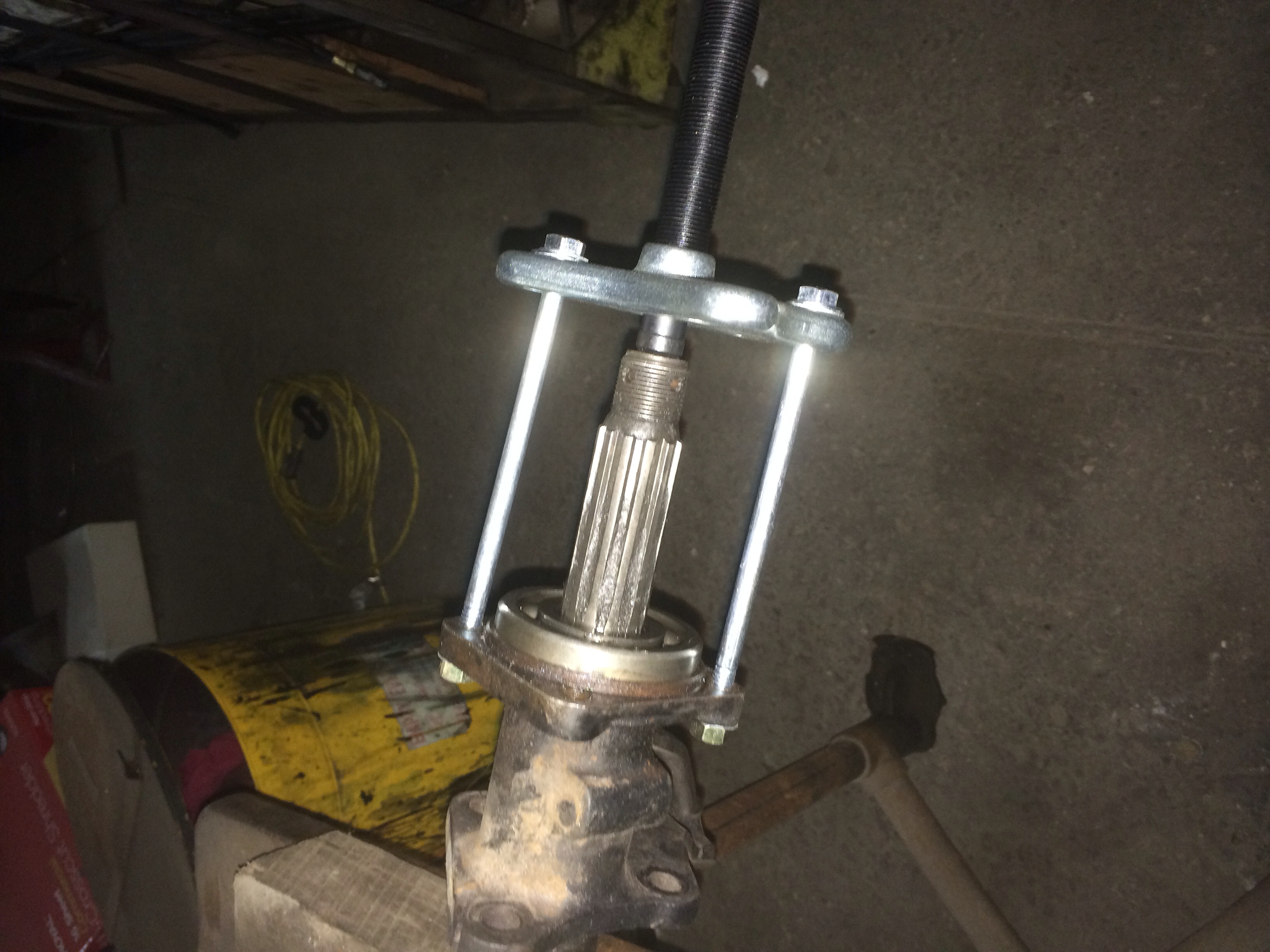

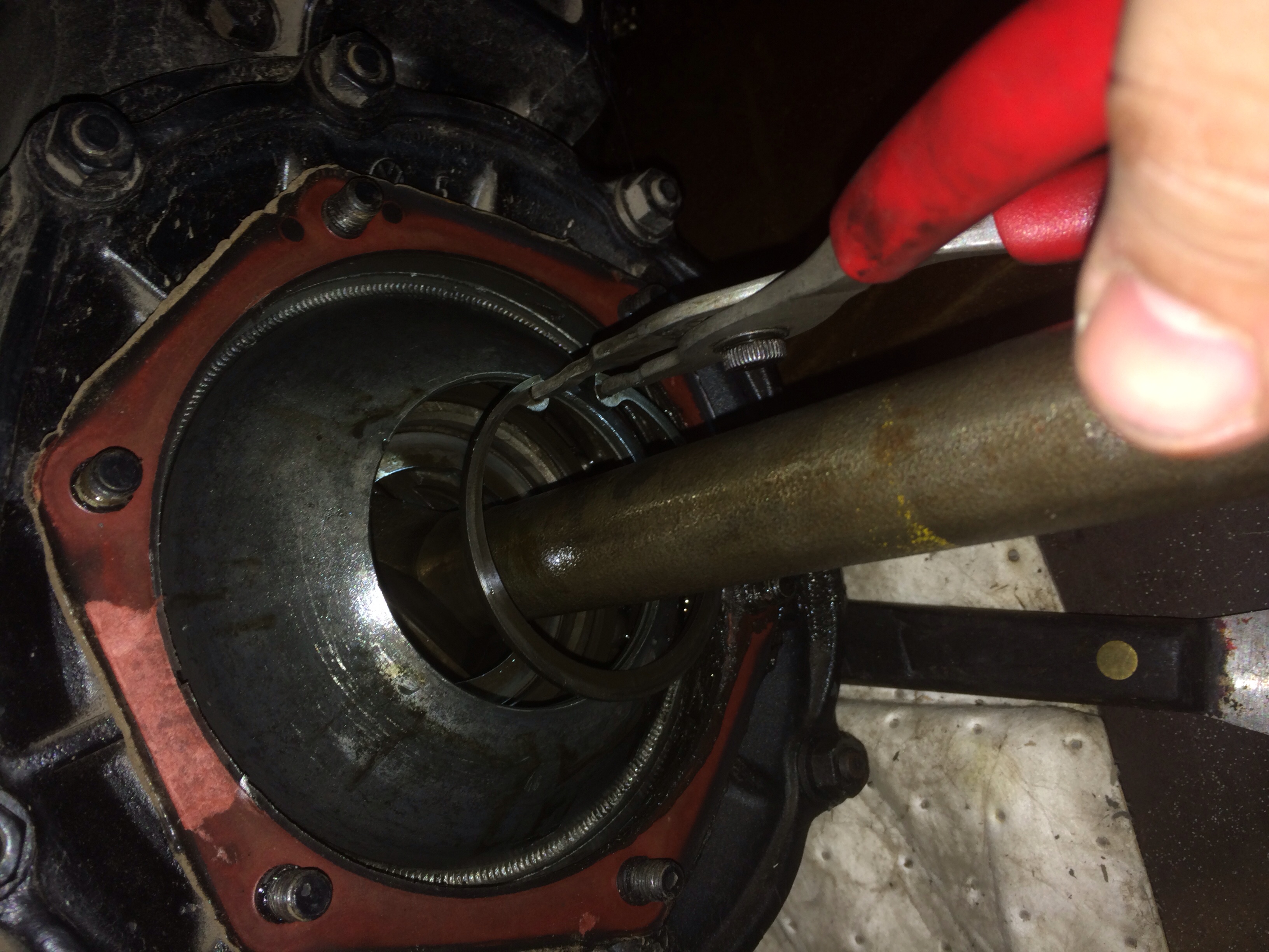

So do to several work projects I haven't been working on the bus much but I have a little break now so I got cracking again. I decided to hold off on the new wiring harness until i get the bus back on 4 wheels. So with the new goal of getting 4 wheels on I started by pulling the stock beam off and installing the new W5 beam. Next I just wanted quickly prep the straight axle trans to be put in with a few new gaskets, bearings, and a quick parts inspection. I bought a cheap universal puller from HF and it worked well to pull the bearing and axle tube off. Then I fought with those PITA snap rings that hold the axle into the diff for a few minutes and now I can start cleaning and painting things.
Pulling the axle tube and bearing off together.
The snap rings can be a frustrating and painful things. If things dont go well walk away for a few minutes! I also feel propping up the axle to keep it level helps.
Sometimes the axle carrier comes out with the axle. Others you have to wiggle out by hand.
