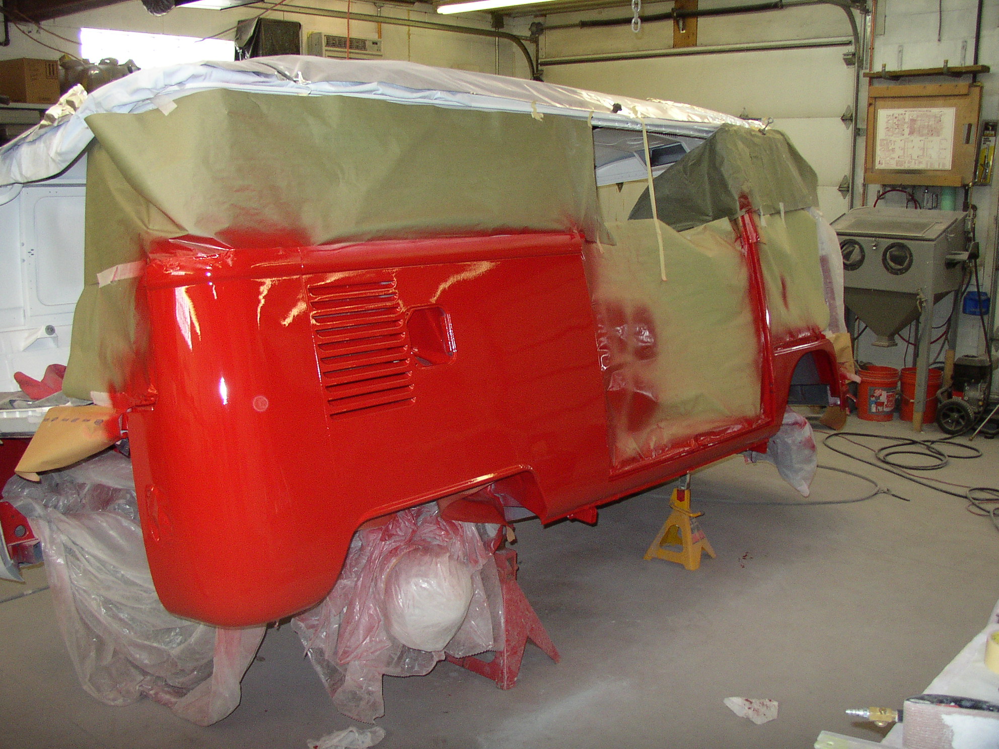

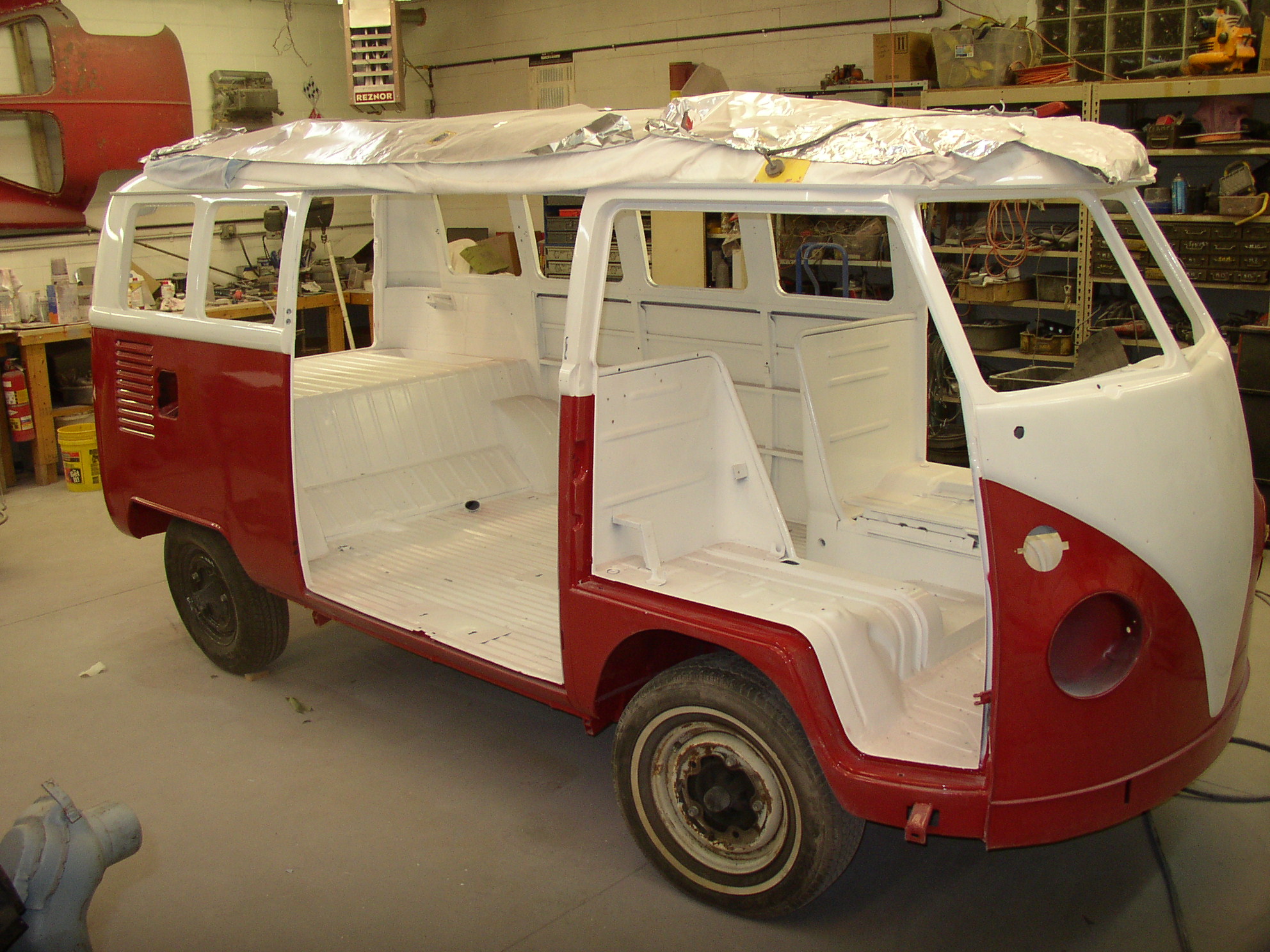

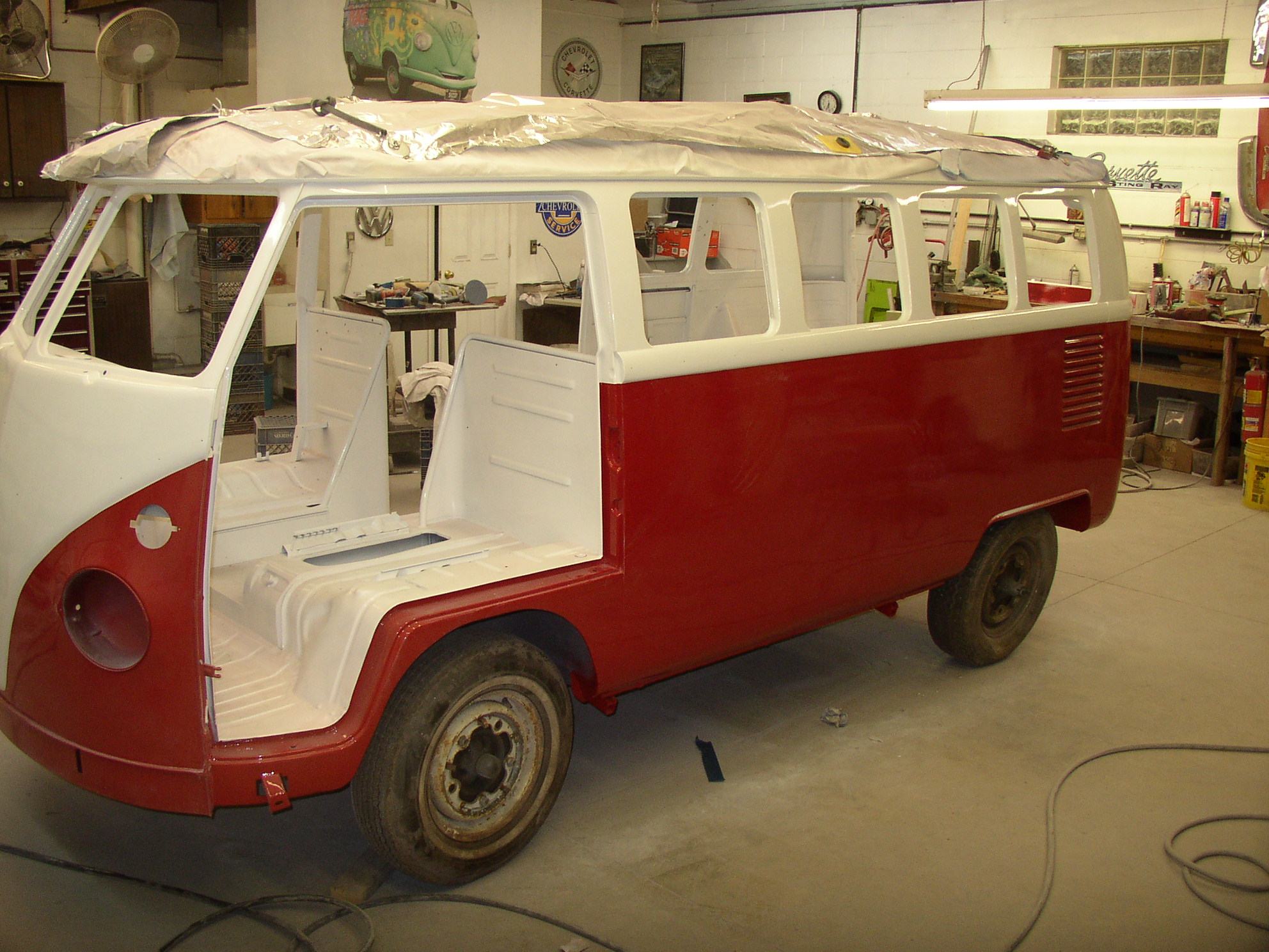

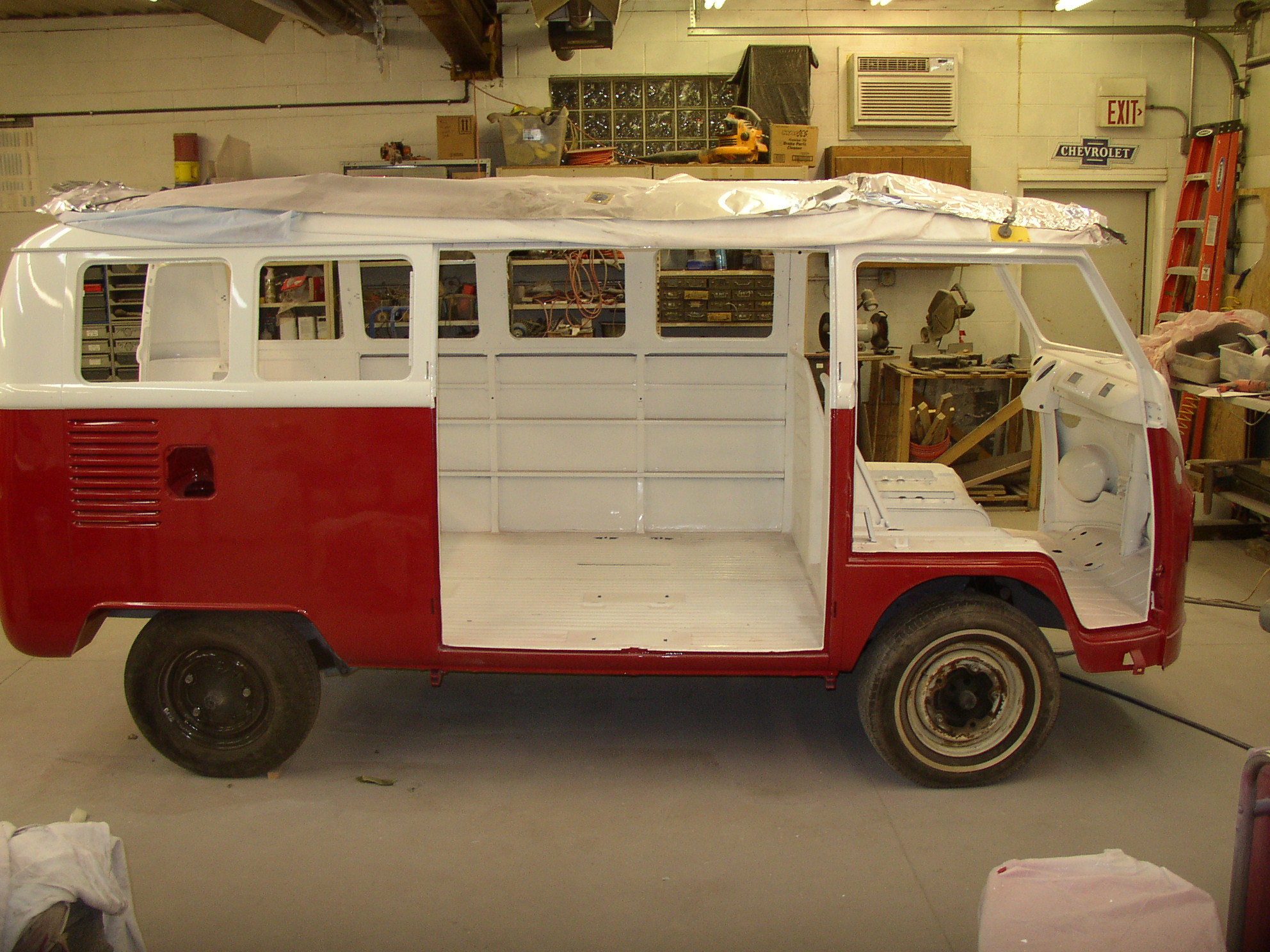

I finished the paint today, and it looks really good. It's starting to look like a bus again. I'm happy!
