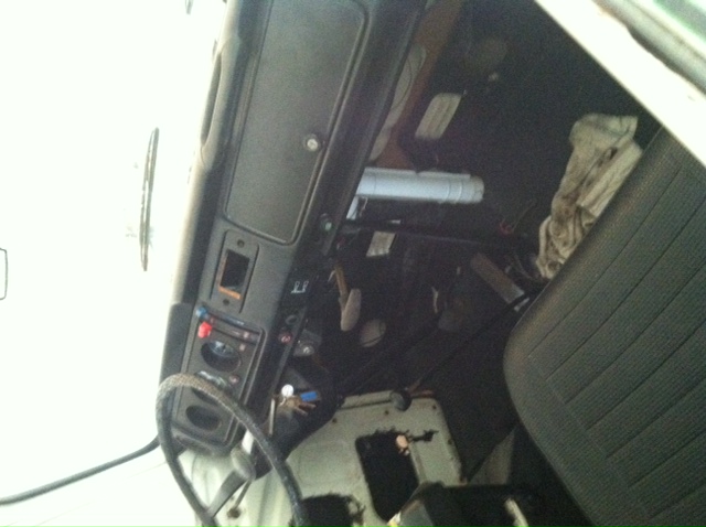

Thought I better show some pics of the Parts Camper
Cabinets are in pretty good shape. Lots of parts if someone is interested.
