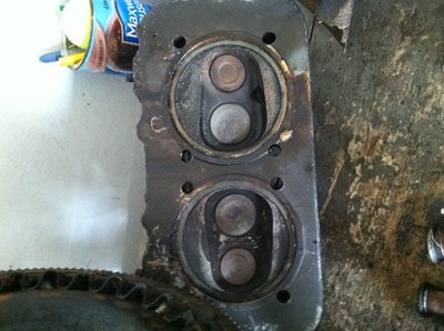

Well the heads are off and look great!
And we know there is still a problem because we only have about 30 degrees of rotation.
Well the old Frau is pretty krank (sick)
She has a broken lung.
The piston appears to pivot slightly, yet free on the wrist pin.
The other three pistons move.
I think the old gal has reaaly stuffed the connecting rod.
But why???

In your second picture of the heads,the cylinder on the right looks to have had some fairly serious 'blow by", that is leakage between the head and the cylinder mating surface. also,that exhaust valve looks to be beat into the head. this was not uncommon on the 2L engines which ran low octane fuel.
The valve seat would beat into the alum head and eventually come loose. If you plan on using these heads,I would take them to RIS and have them worked on.

Hi Bill
I figured a valve job would be an a normal thing to do since I had the heads off.
Any idea on the internal problem?
