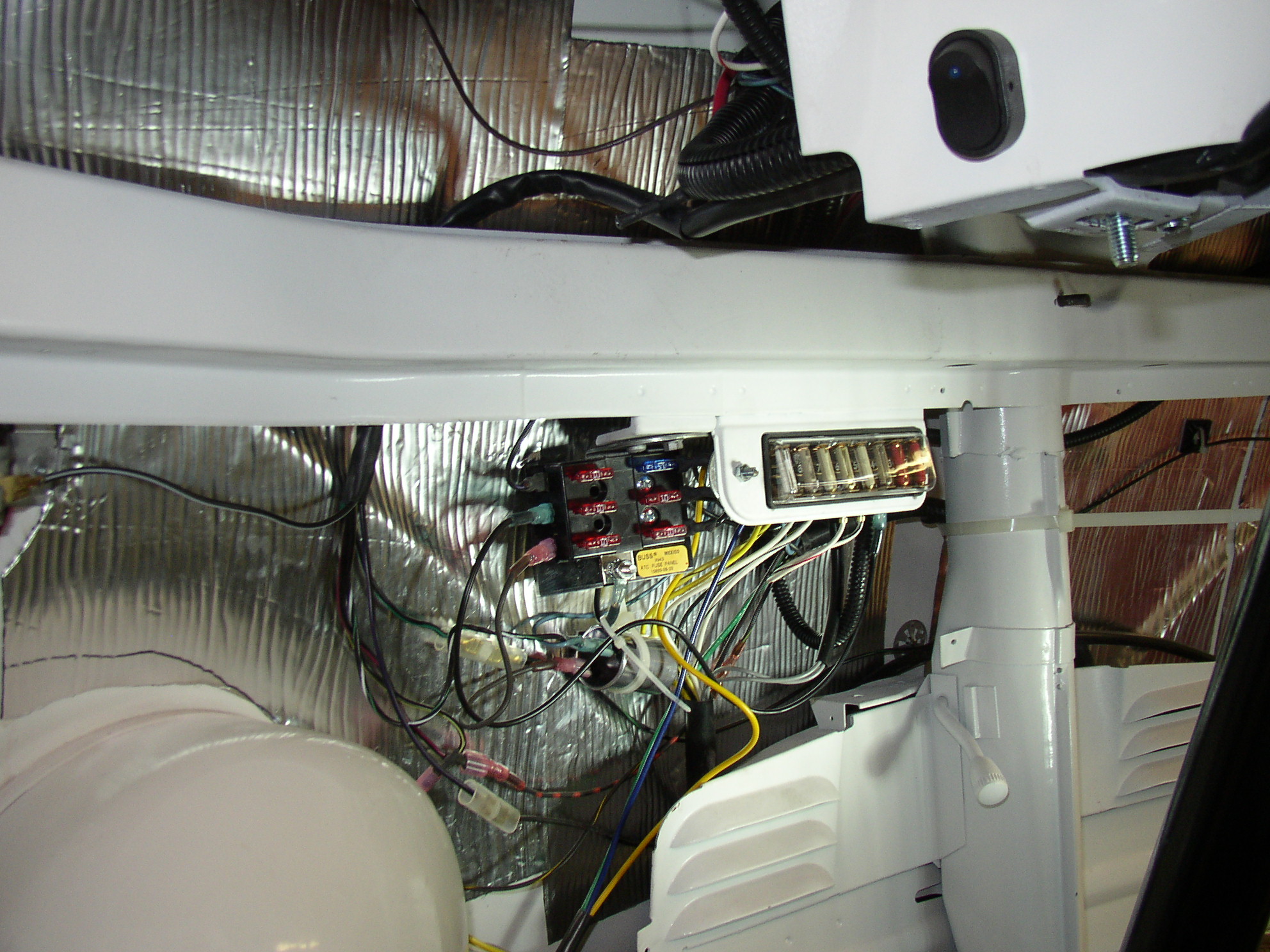

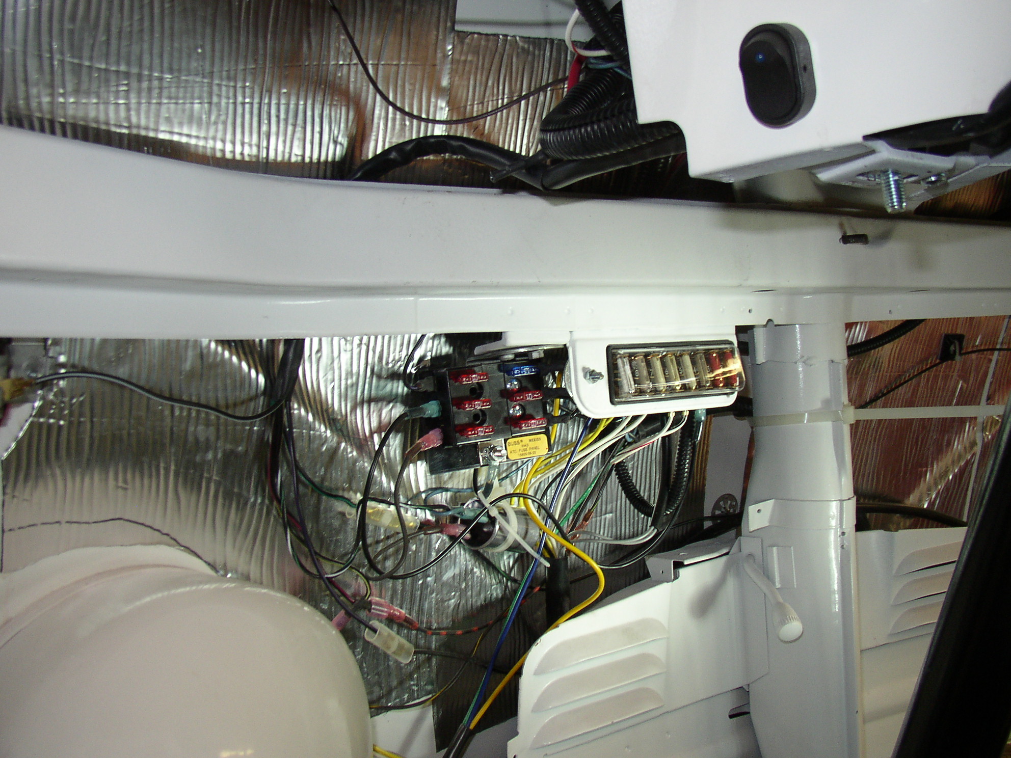

I don't like the way VW runs the power lead to the fusebox, then to the HL sw, then finally to the ig switch. I soldered a three way split into the wires so each of those items is fed directly from the 10ga feed wire and put heat shrink tube over it. Remember this feed has a 40amp MaxiFuse in it for protection in the back of the bus.
This now feeds the ig switch directly. I put heat shrink over a lot of the factory terminals and use almost all sealed connectors even though they're not exposed to the weather. The shrink connectors give a much better mechanical connection resistant to vibration. The fuseboxes (yes, two) are installed but completely detailed yet. I'll shoot better pics once it's done and put them up. It looks kind of crappy right now (you'll remember from Bill's pics with the test light :shock:

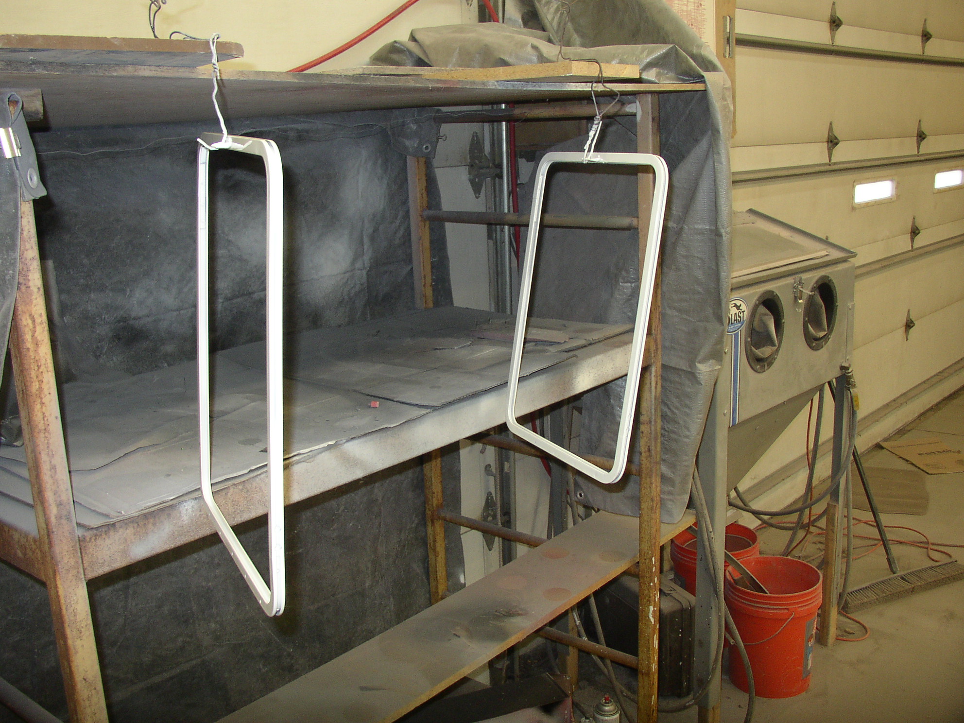

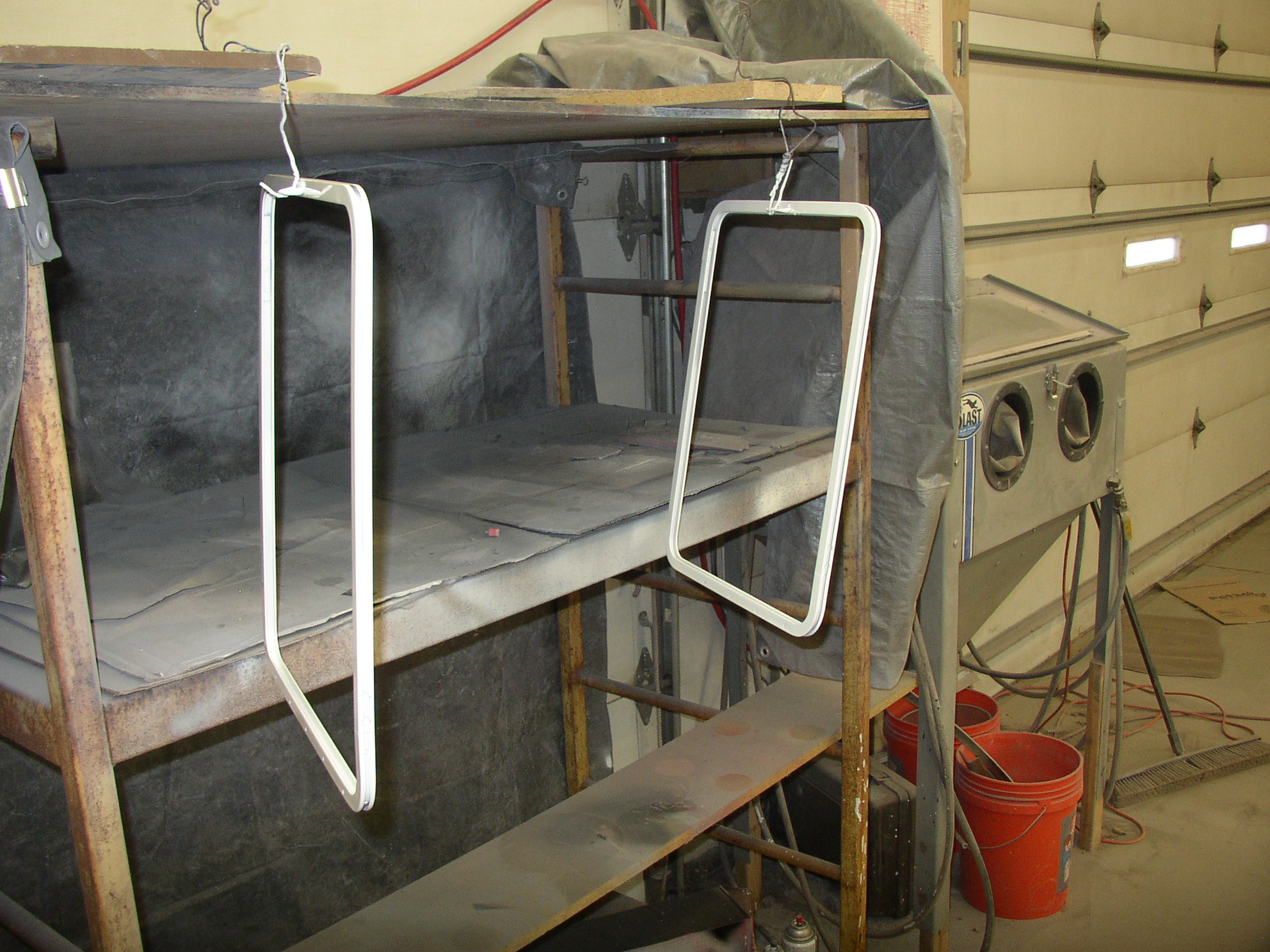

Here I'm painting the frames with the same PPG paint I shot the upper part of the bus with. That's a Parma Spray Booth ducted outside with an exhaust fan. :) Painting those things is probably the worst- trying to get all of the inside and outside surfaces. Powder coating is another option but the added thickness makes them a lot harder to assemble.

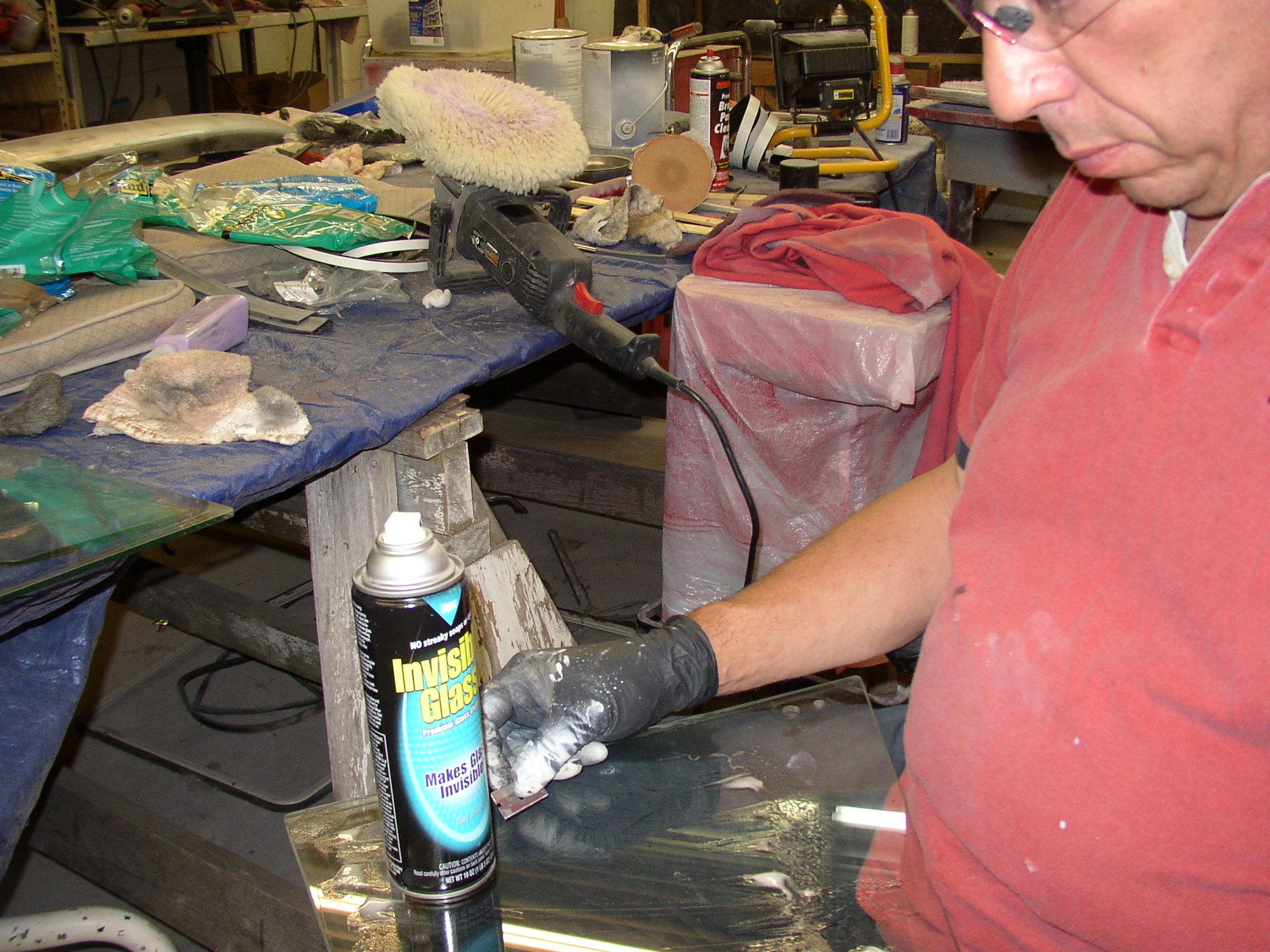

Getting ready to assemble, it's pretty straight forward. I just don't like doing it. I cleaned the glass per Lurch's advice with (???) glass cleaner (no ammonia) and 0000 steel wool. I then ran the buffer over them (the big one that I buff the paint with) with some fine compound, you can feel a big difference between buffed and unbuffed glass with your fingers.

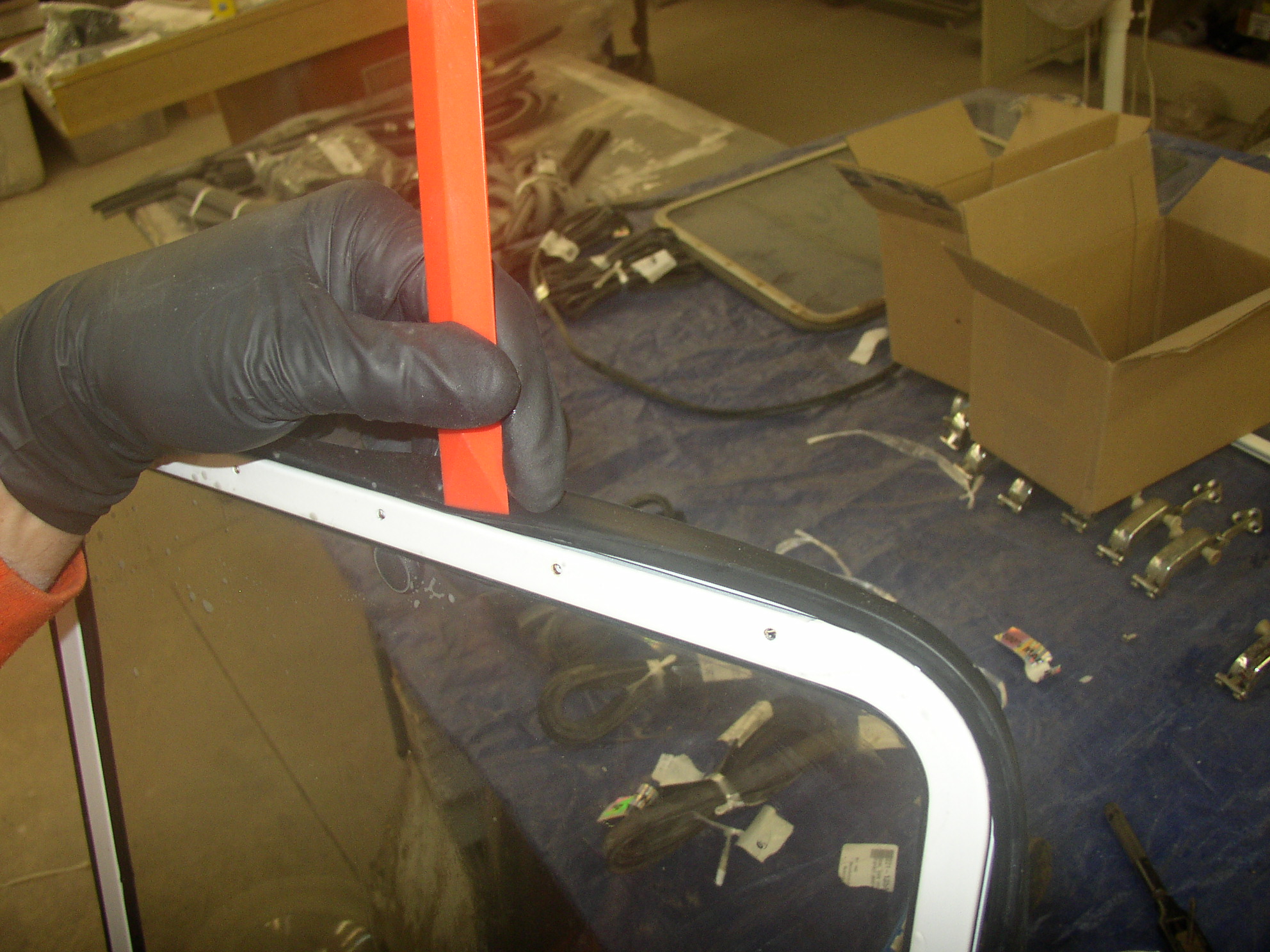

Putting in the outer seal in the frame was easy, but a plastic gasket scraper made it easier. The screw holes visible just under the scraper are the ones that were just a bit sloppier than OEG. Once again, Windex was my only lube. (as Lurch cringes....) From here it's just a matter of pushing the assy into the bus and screwing in the screws. A little kid could do it.

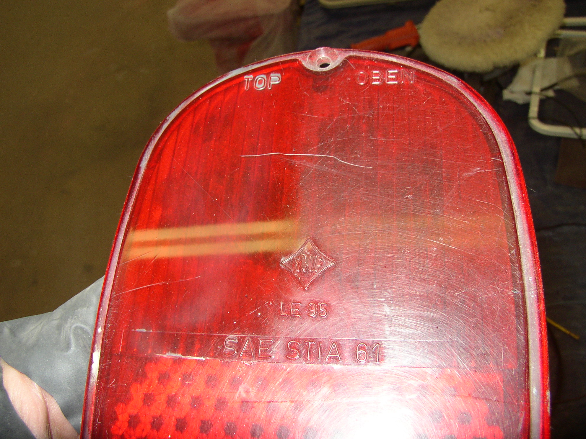

The buffing wheel came in handy for dozens of small parts. Switch bezels, light bezels, even the taillight lenses responded greatly to a spin on the wheel.
Here's half of a lens done showing the difference between old and new. Amazing!

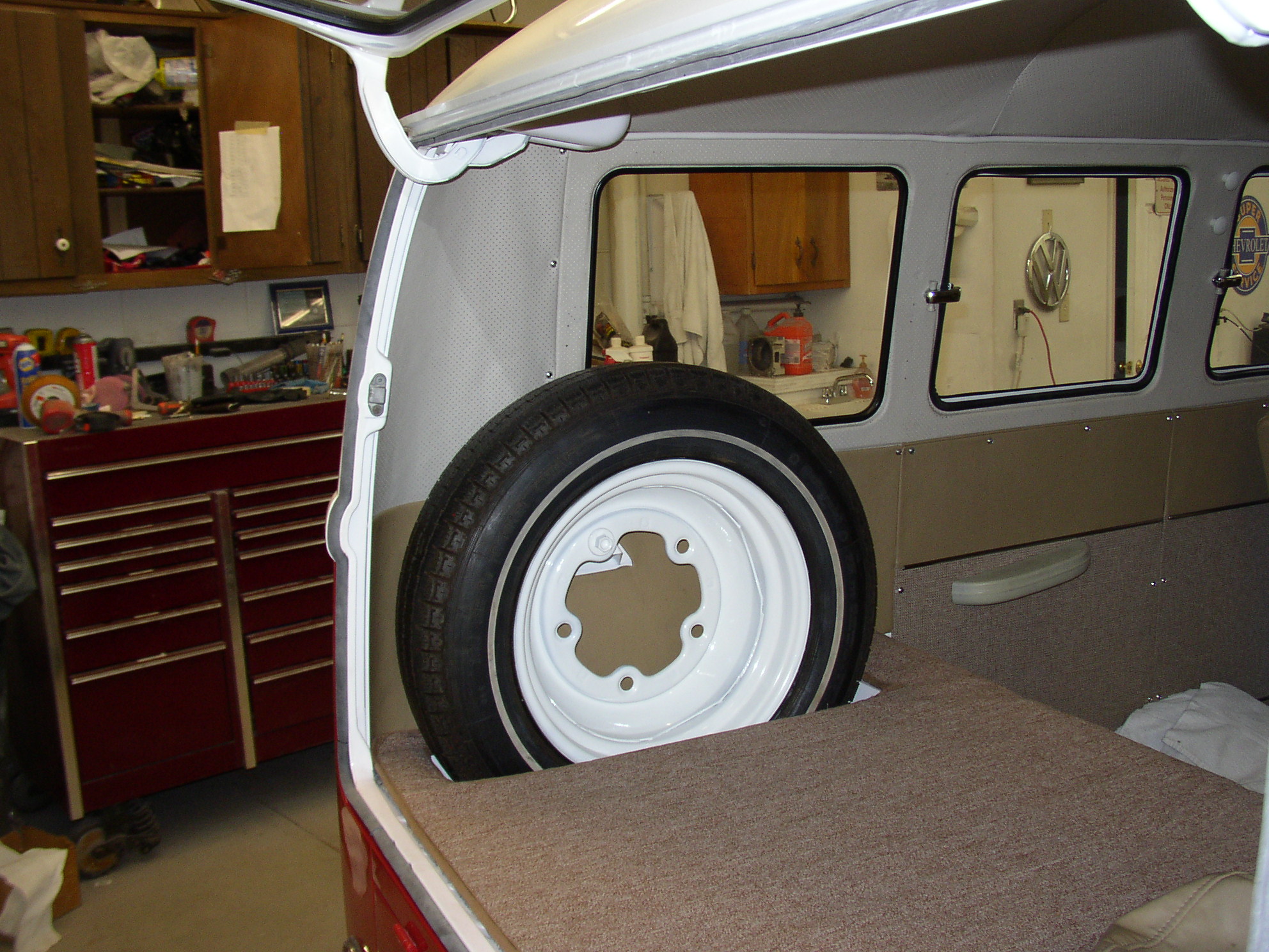

Spare tire, jack etc.

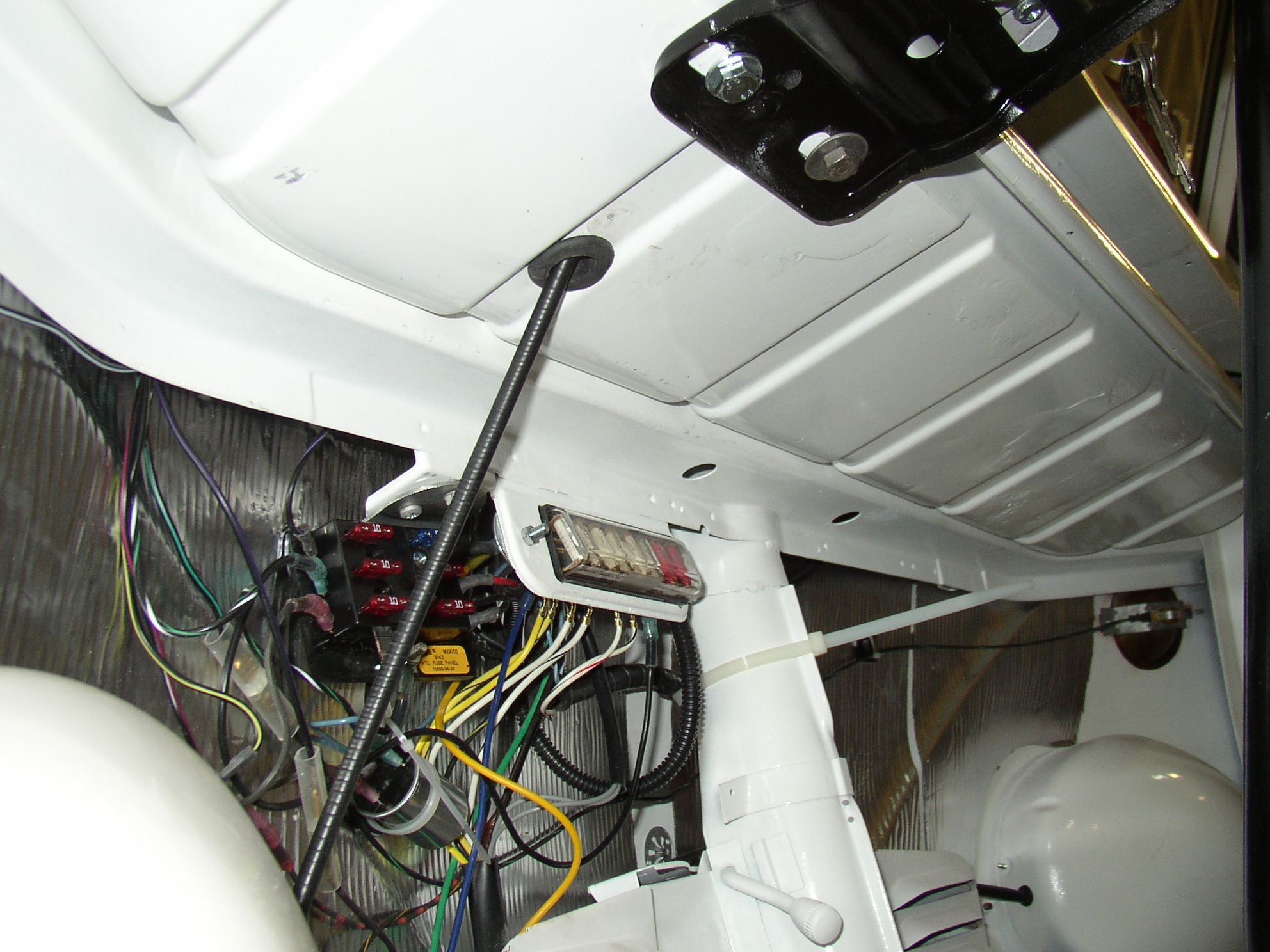

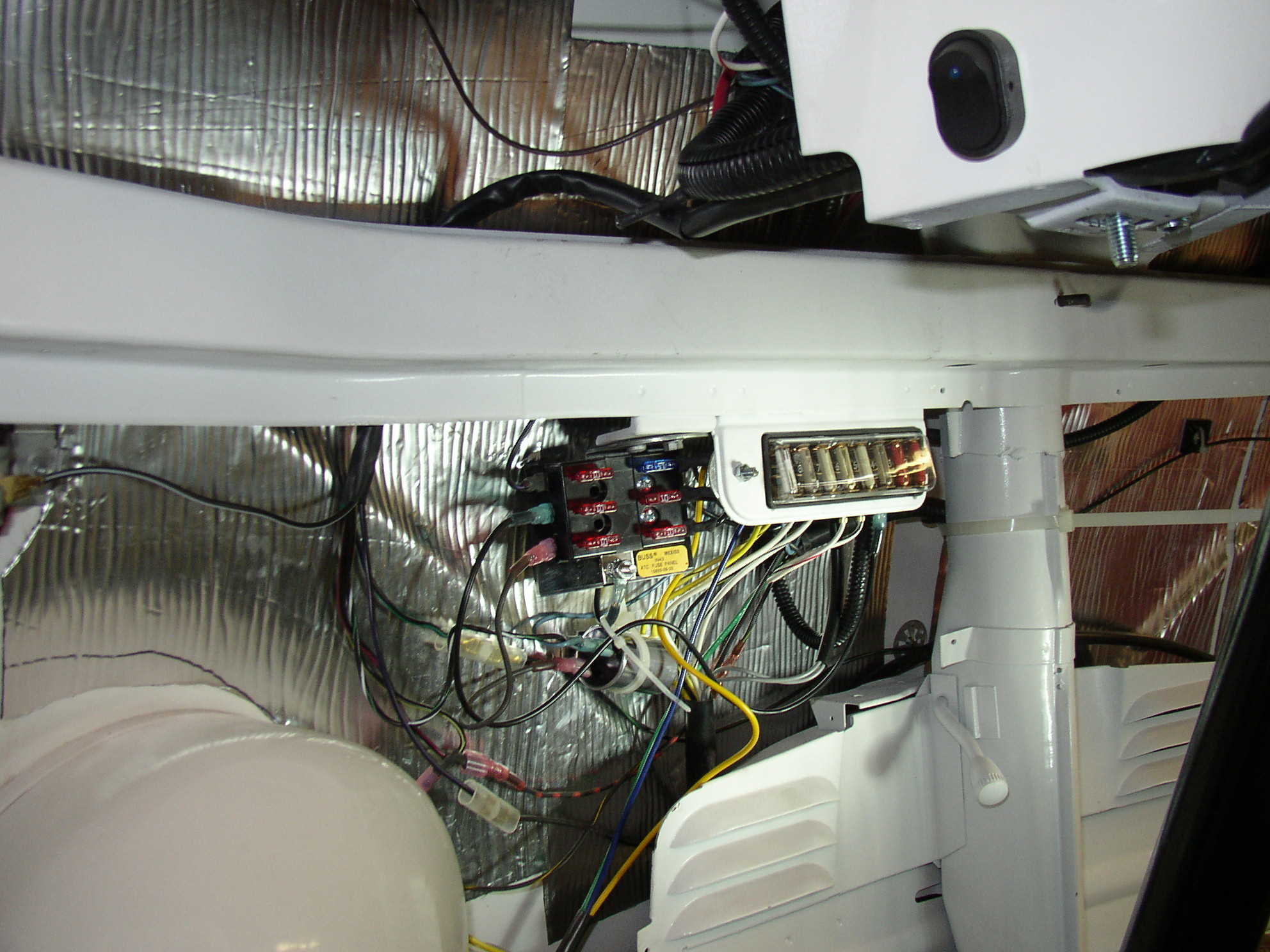

I finished the dash wiring and did what I could to clean up how it looks, but you just can't make these look pretty using a factory harness.
I cut a hole in the kick panel for the second fusebox and mounted the kick panels. I also cut the hole bigger for the speedo cable and put a grommet in, this allows me to remove the dash tray without completely removing the speedo cable. Obviously, I also installed the speedo cable so now the speedo works fine.

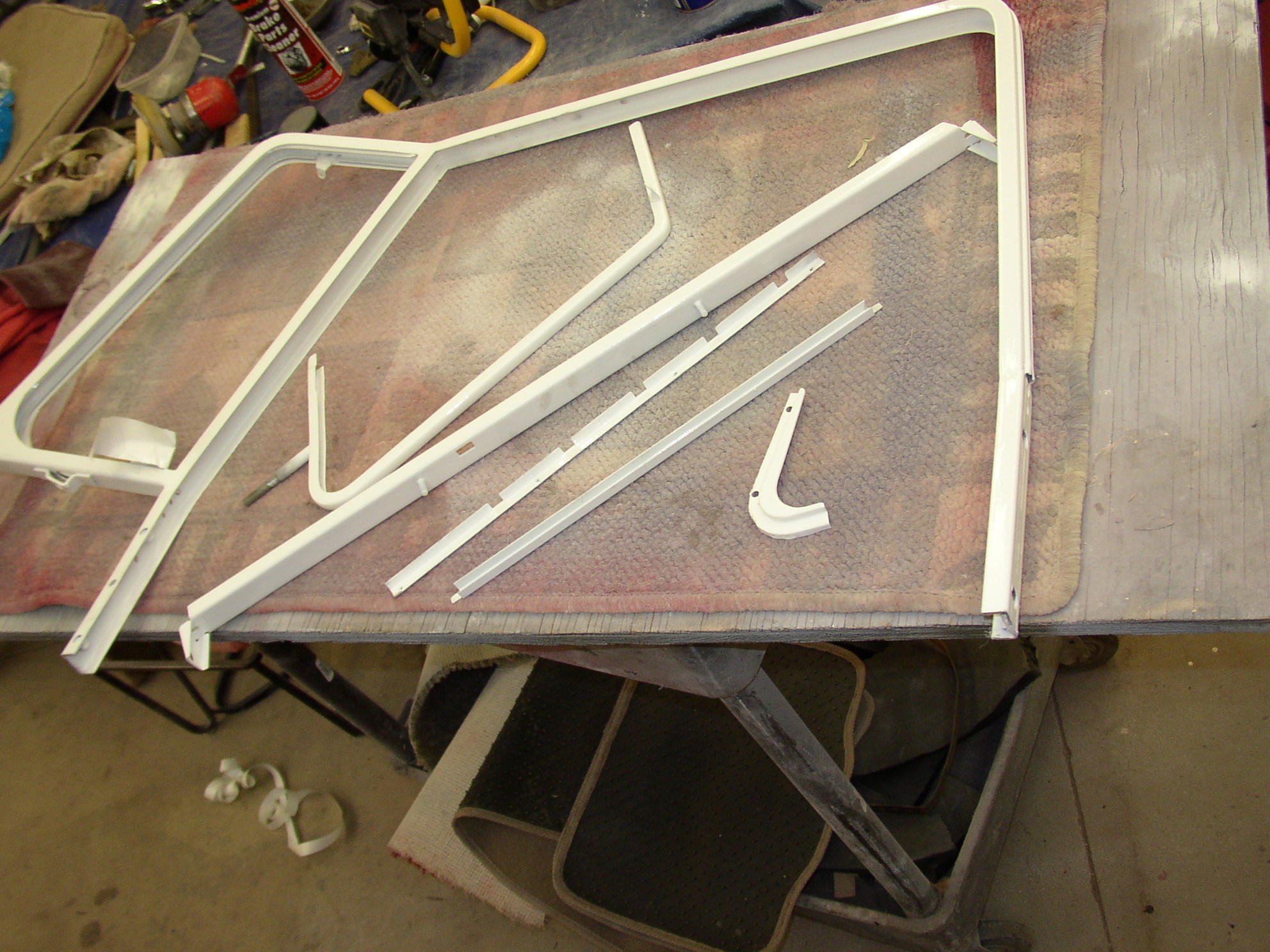

On to the RF window frame. Disassembly was rather easy but I did have to torch some of the small screws.

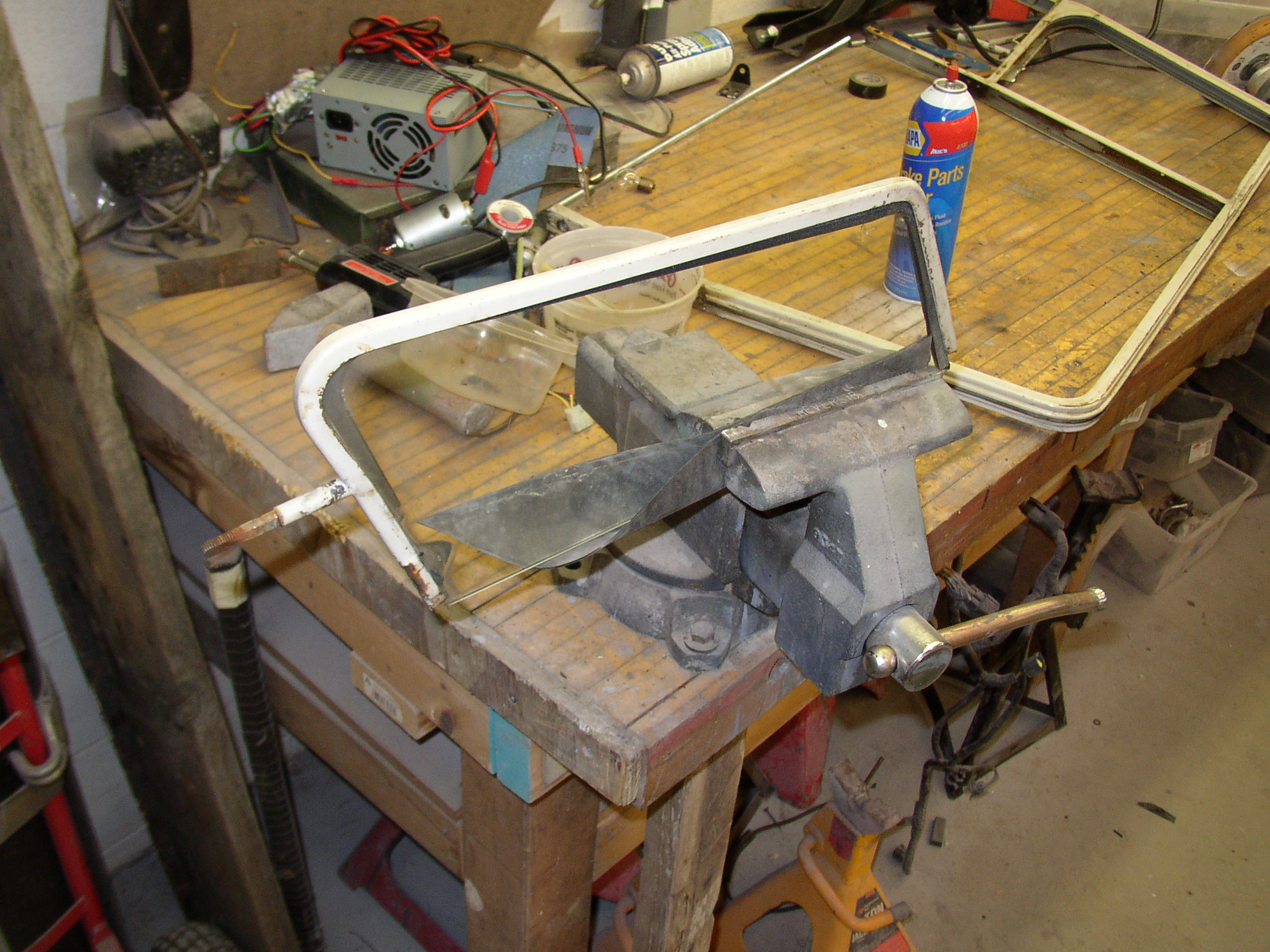

Put the vent window in a vise with rubber and pry the frame off of it.

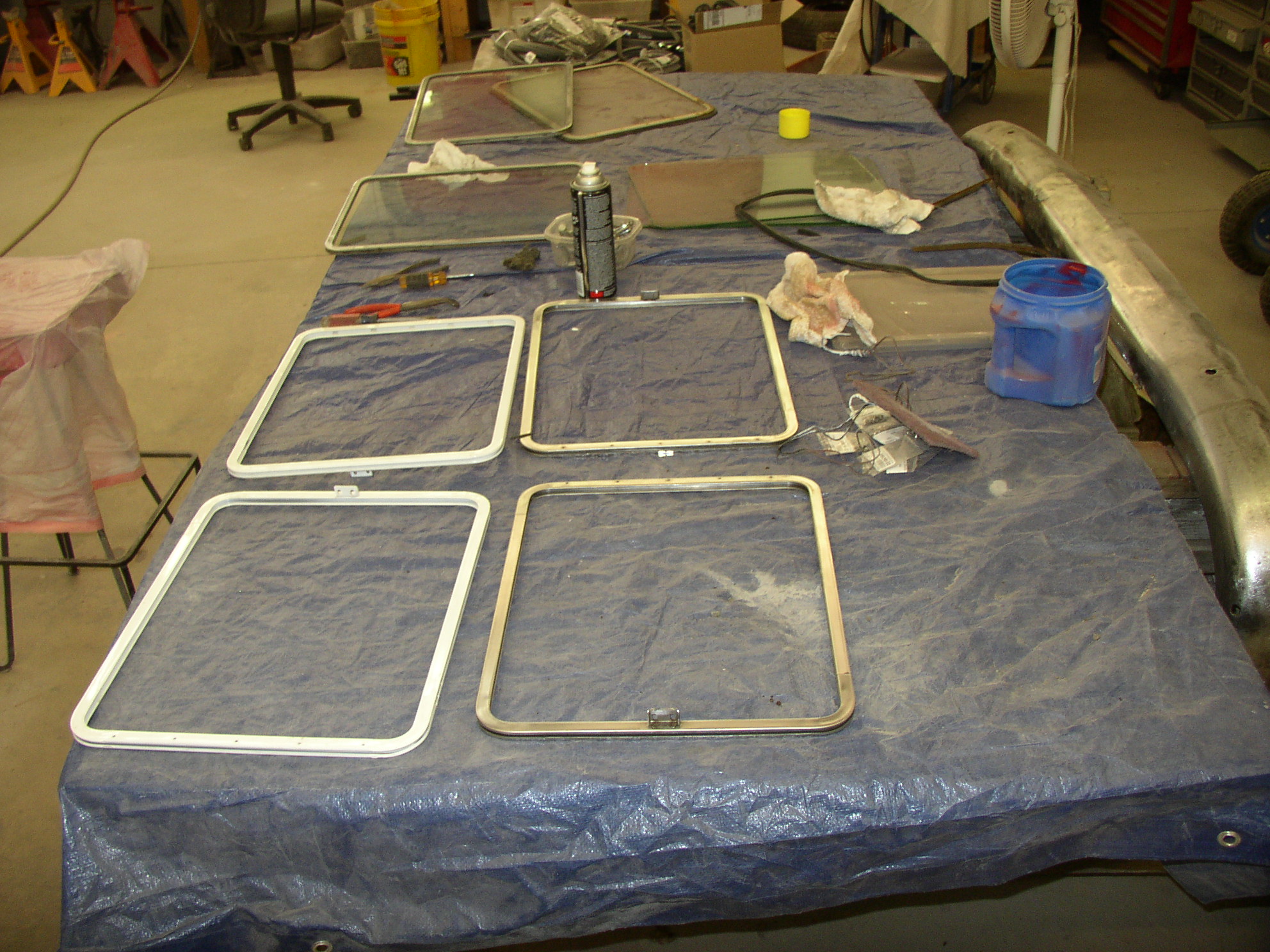

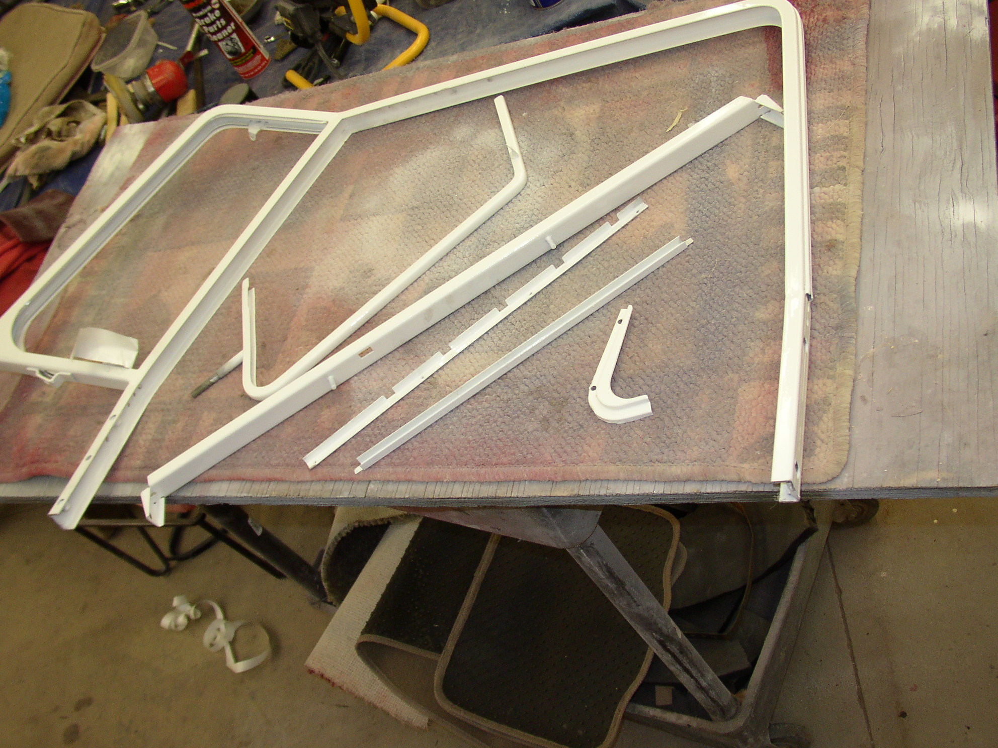

Clean and paint all of the stupid little parts. Frames are a pain to paint because of all of the sides and edges.
Here it is partially assembled.

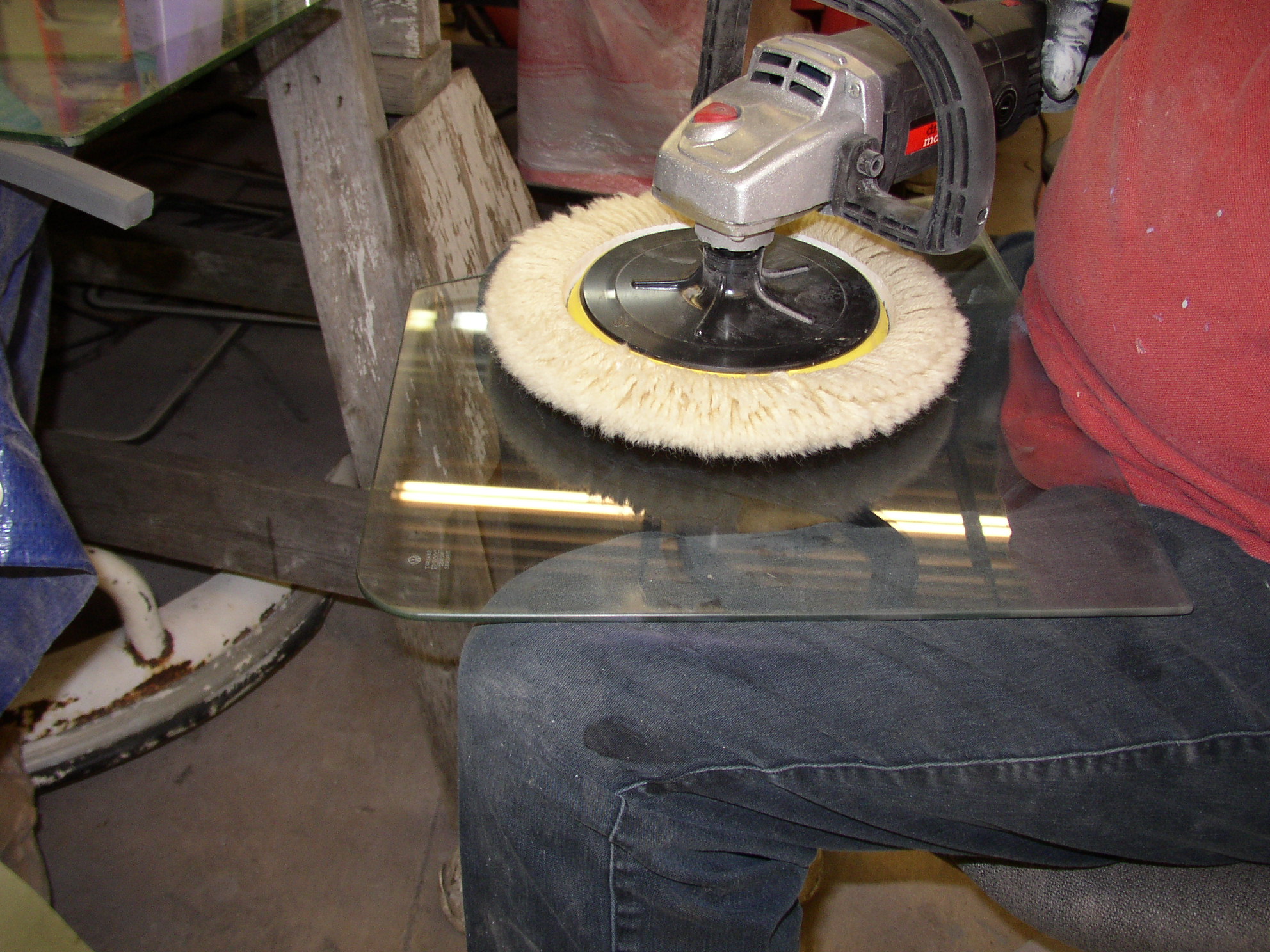

This "13 window" bus actually has 17 pieces of glass to clean 50 years of grime from, and it don't come off easy. First, a razor blade and window cleaner
Then 0000 steel wool.
And I ran the buffer over the glass with fine compound to give it a nice shine. I have hours and hours cleaning all of the panes (pains).

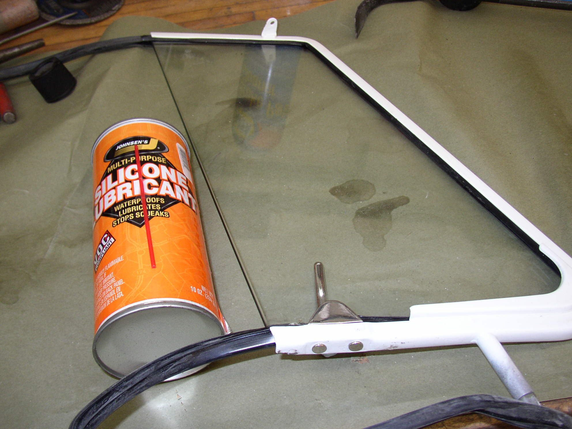

The vent glass went right in with silicone- only light pressure needed. On Ed's and Lurch's advice I used an extra popout glass seal.

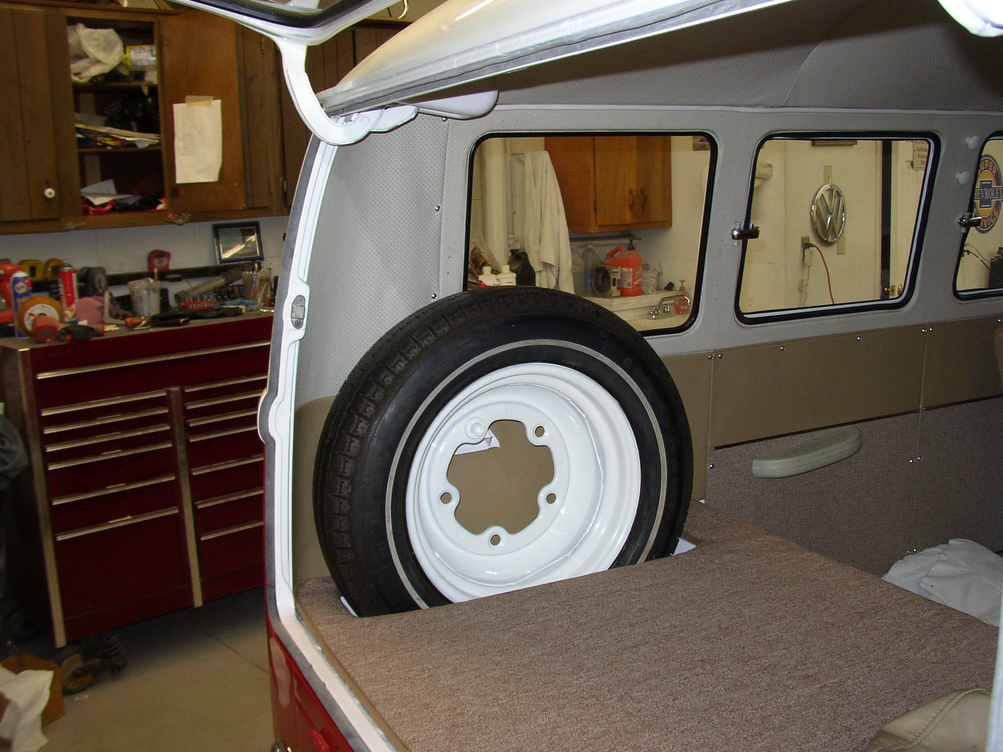

Sean donated a spare tire, cleaned up and painted it looks great.

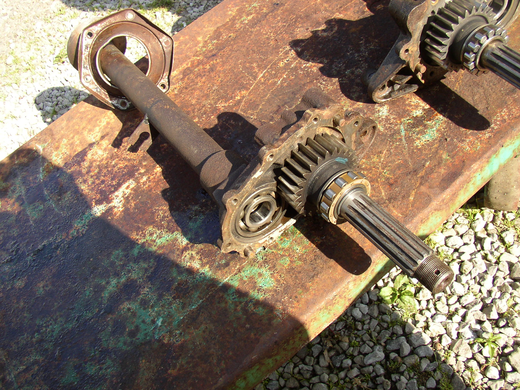

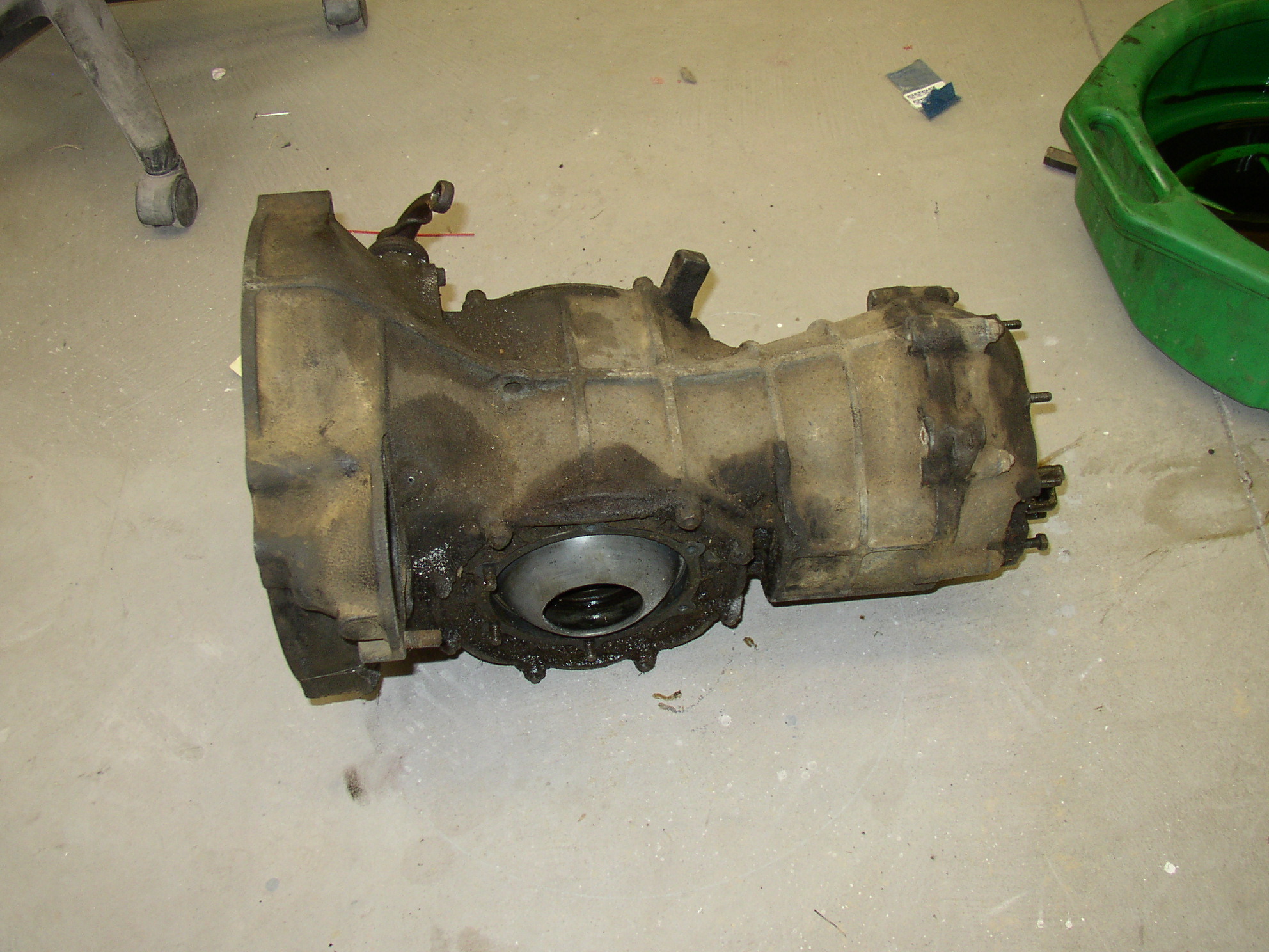

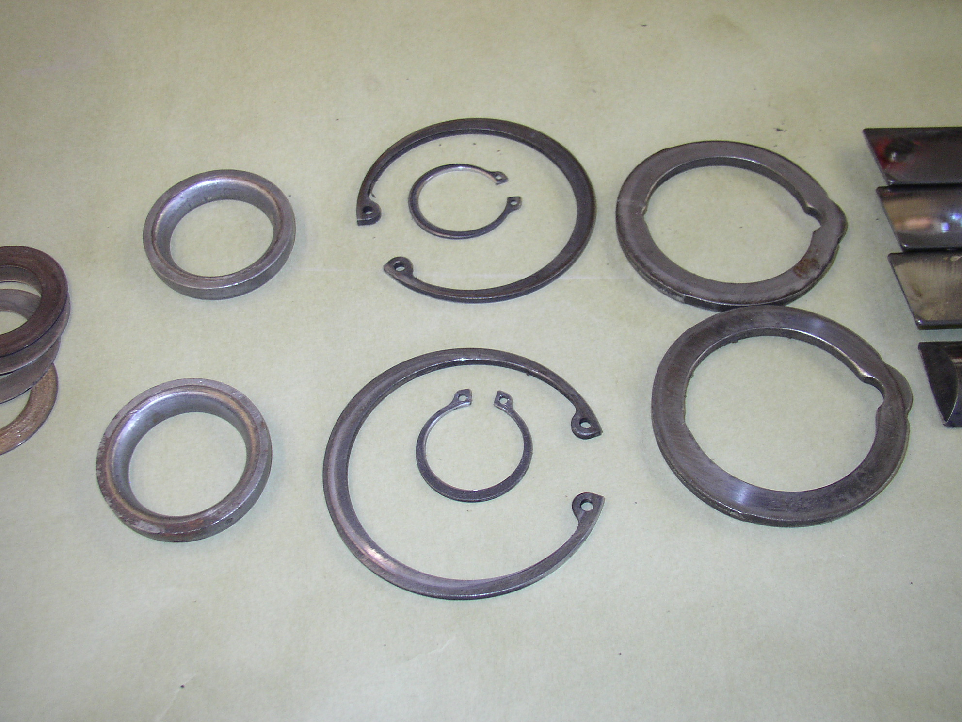

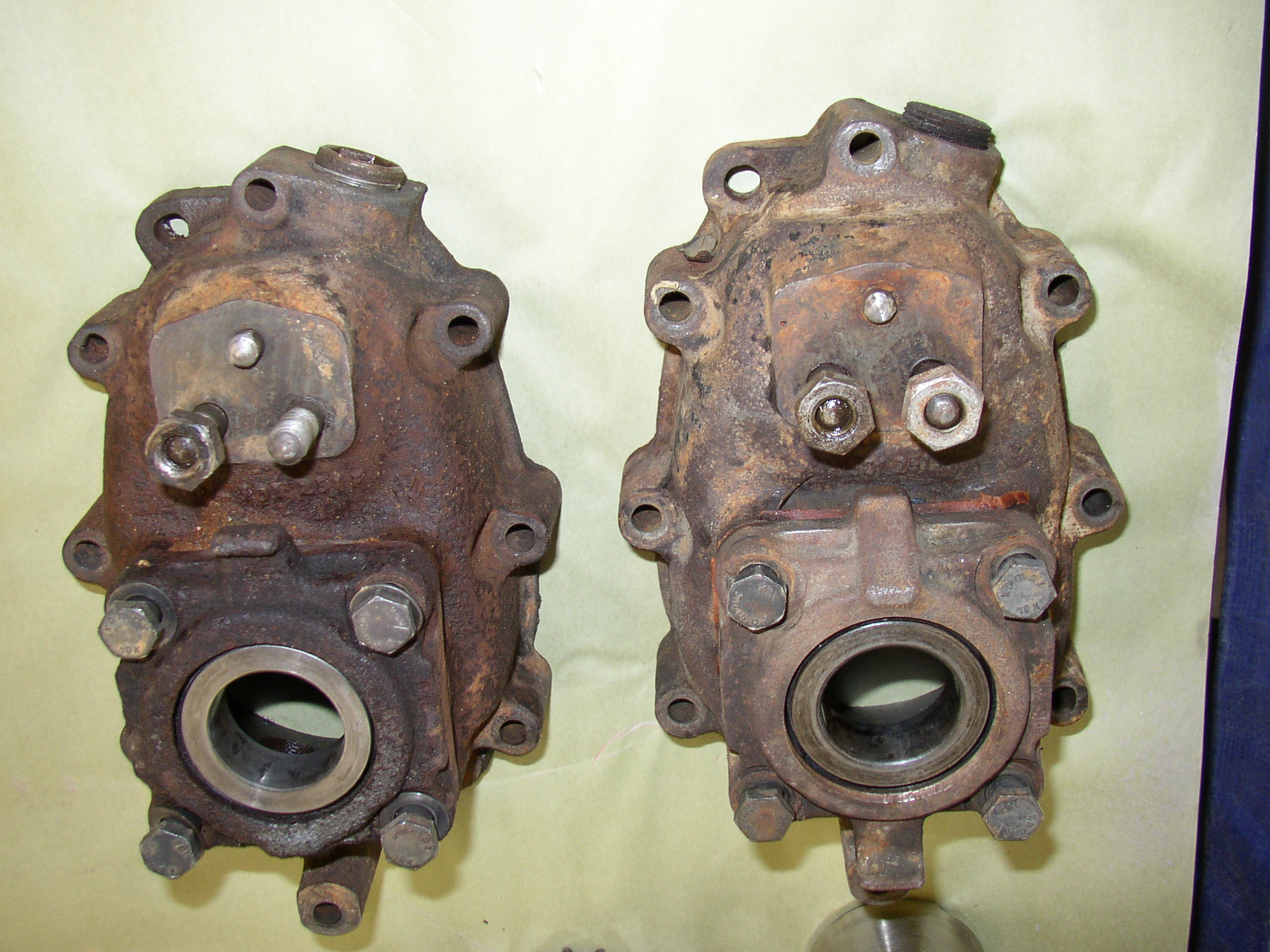

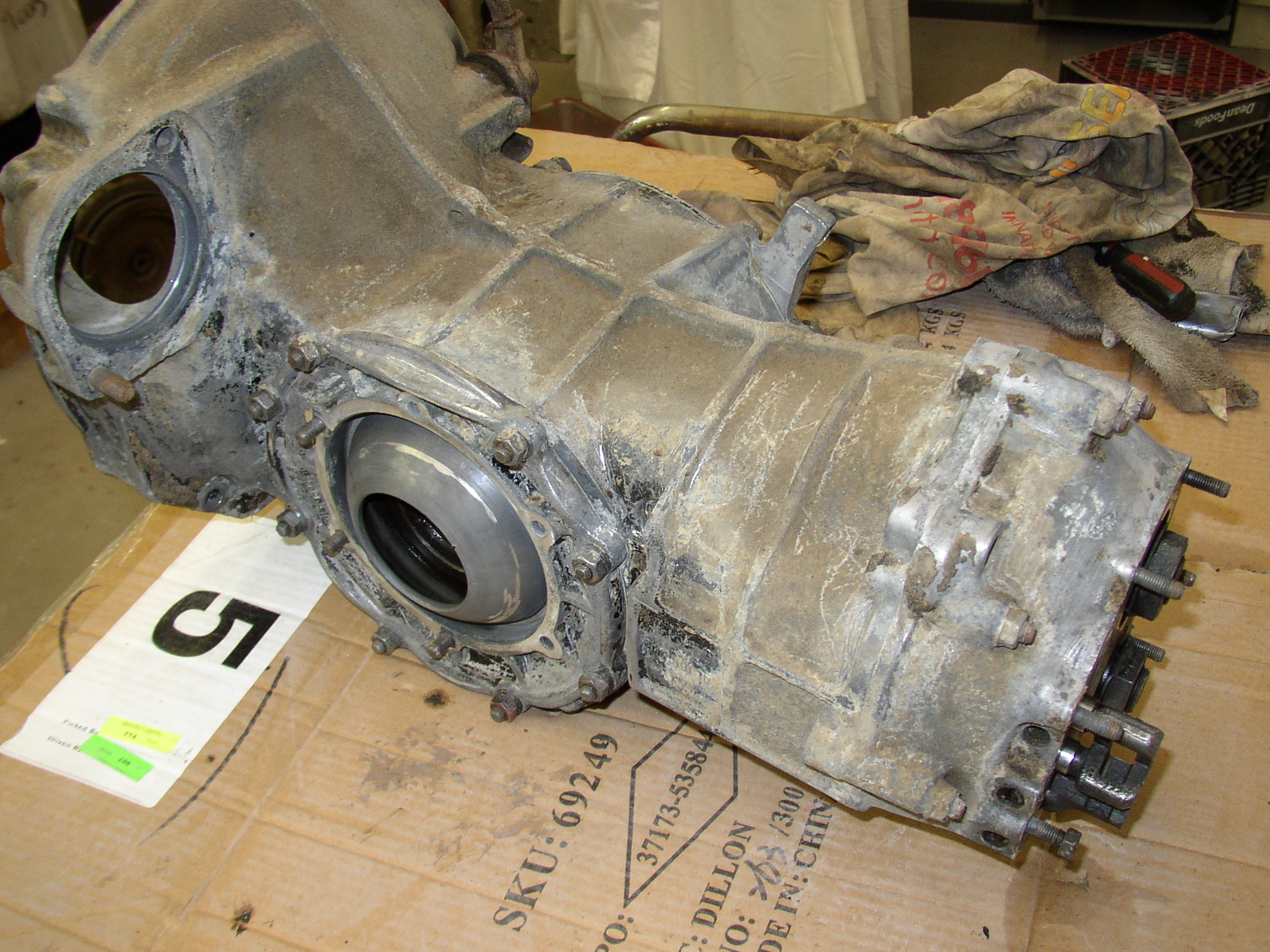

I bought a spare "supposedly good" (?) tranny last year with the axles off, now I'm trying to make this basket case a tranny again. :roll:
Fugly dirt
I spent hours cleaning the grime off the housing, I didn't want to pressure wash it for fear of water intrusion. The good news is that it came from a southern bus, no salt rot at all on the bottom, and a mixture of Georgia red clay and sand stuck all over the case. Tedious time with a scraper, solvent brush and brakeclean to finish it off.
Does anyone know were to buy the axle tube retainer O-rings? (not side cover O-rings) These don't come in the tranny gasket kit and WW doesn't show them. Also, where do you buy tranny inside parts? WW only shows really early tranny parts.

Sexy....'cept for that auxiliary fuse block ;)
Really awesome work Bruce. It looks spectacular.
I'm very impressed with the detailed "up front" electrical work and would like you to elaborate a bit more on those improvements if you get a chance. Maybe an COVVC newsletter article? Or just post something with a little more detail here.
The "fusing" of differing parts of the bus electronics is interesting, but beyond my comprehension. Nevertheless, I'd love to learn.
Tranny parts........there is a guy in pa. geno boyd, I delt with him a few years back he is pretty reasonable. get on thesamba..
seller name genoboyd..he treated me well, you may find what ur looking for...I just checked he's still selling parts on there...

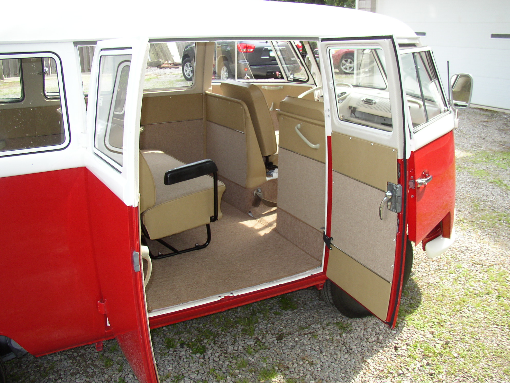

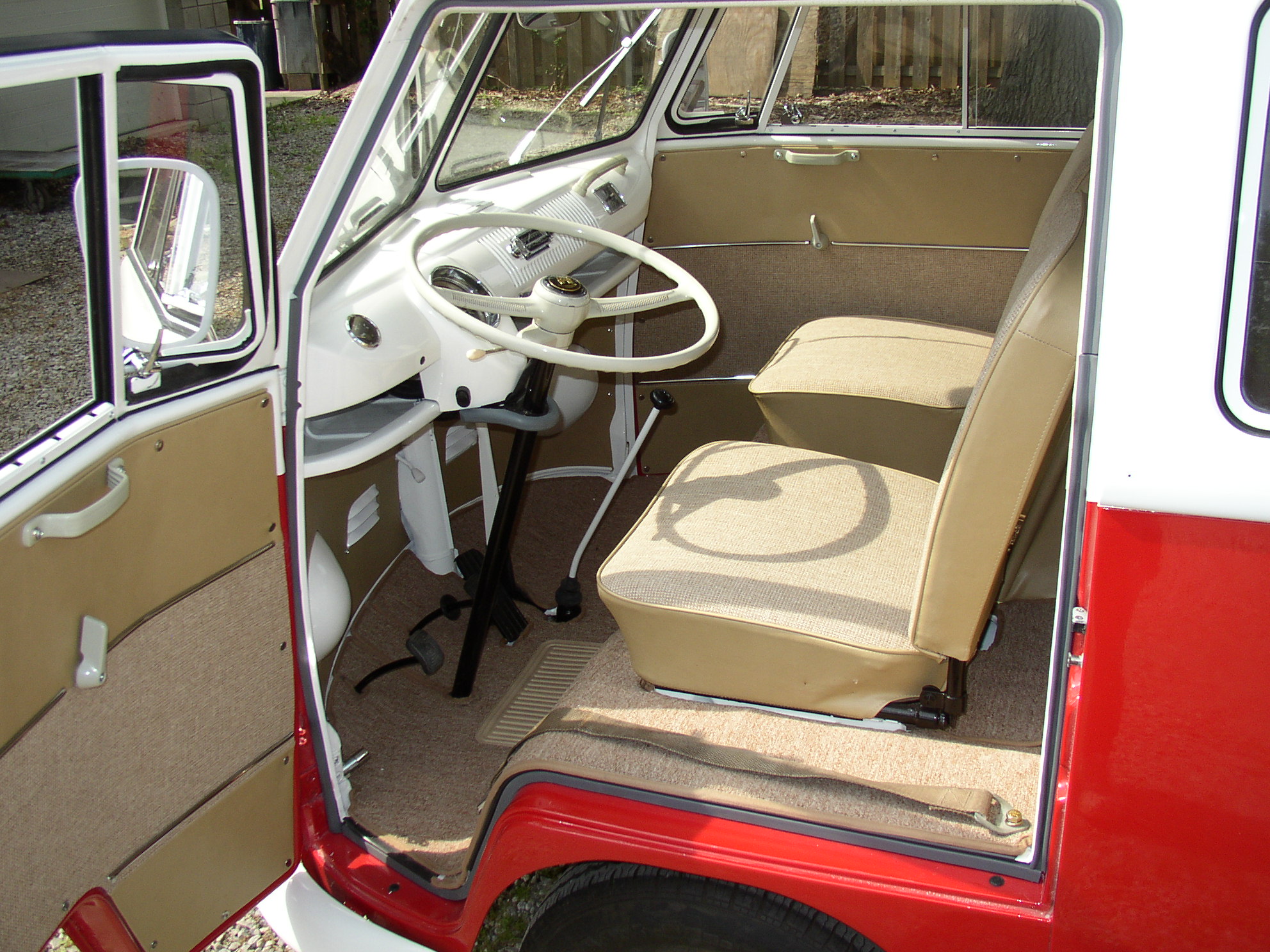

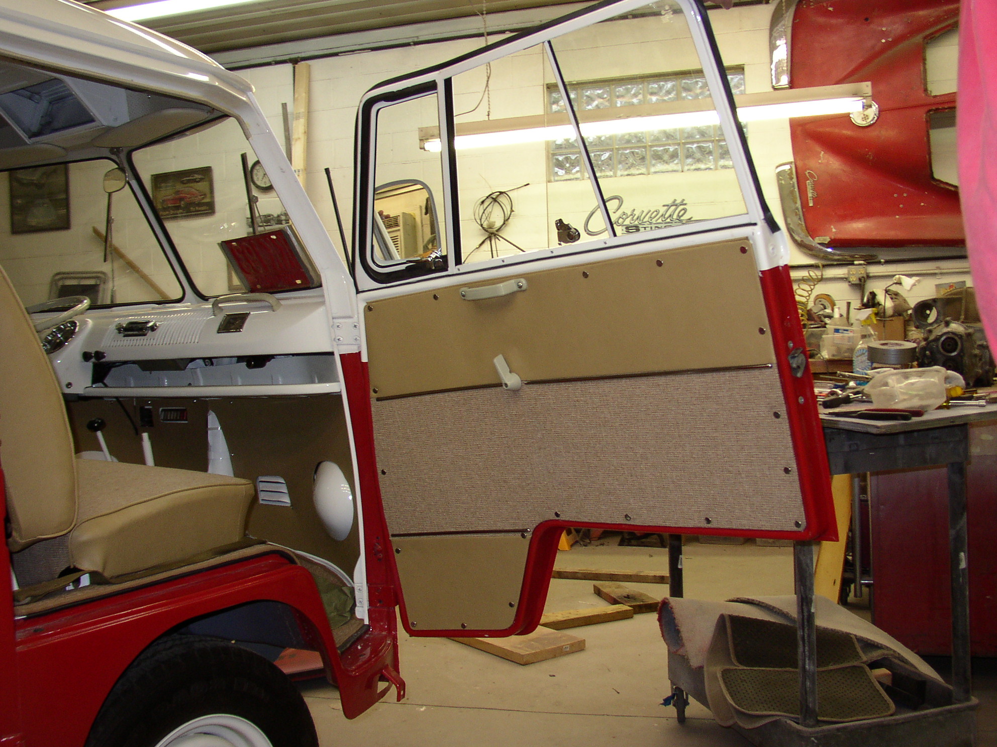

I've done a few things, time for an update. Many of you have seen the bus lately at cruises and events but not everyone. First of all, I completed painting the LF door window frame and installed it, which went much smoother than the RF for obvious reasons. I installed the door panel which also went much smoother. I also installed the weatherstripping around all doors.

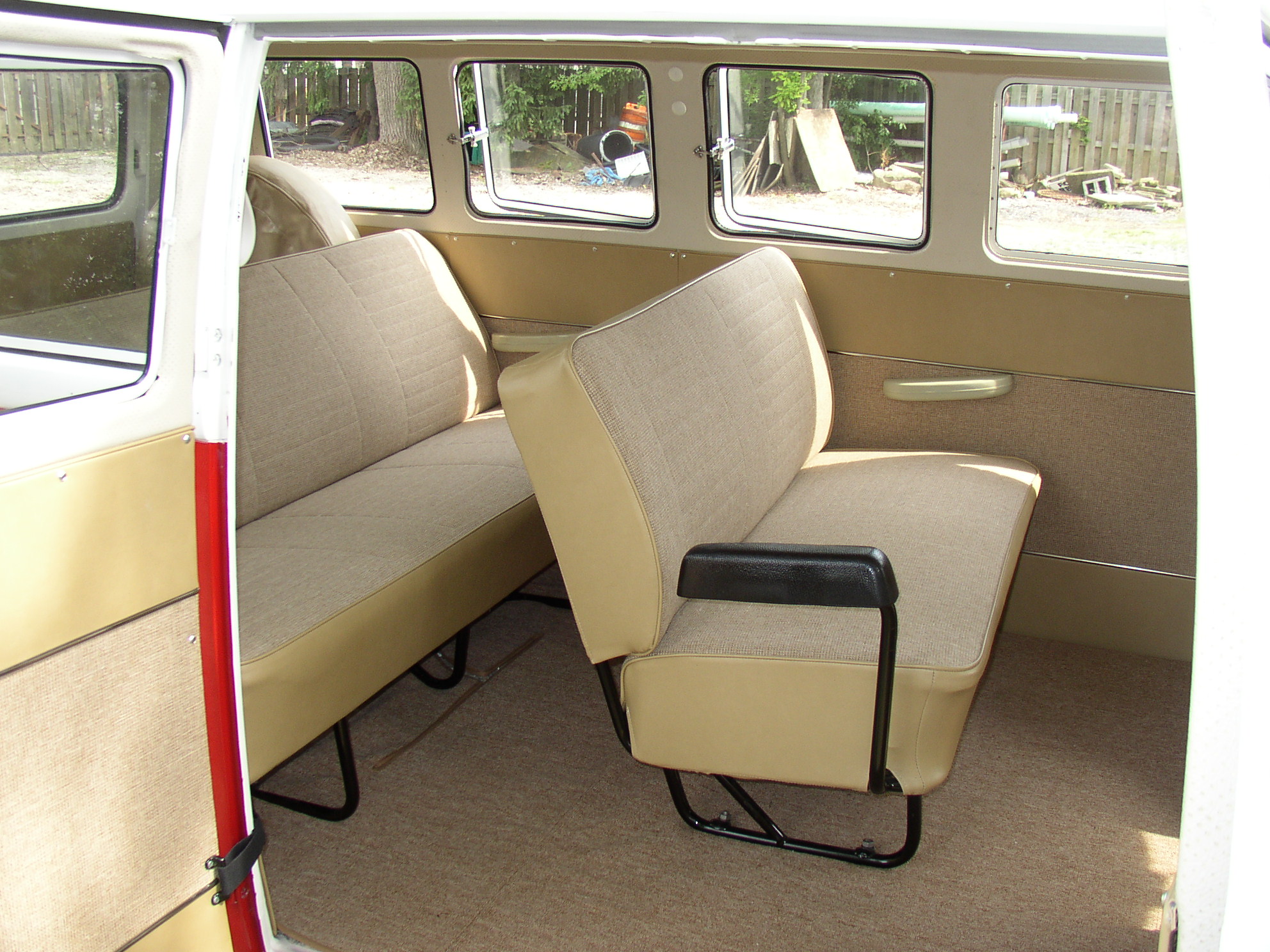

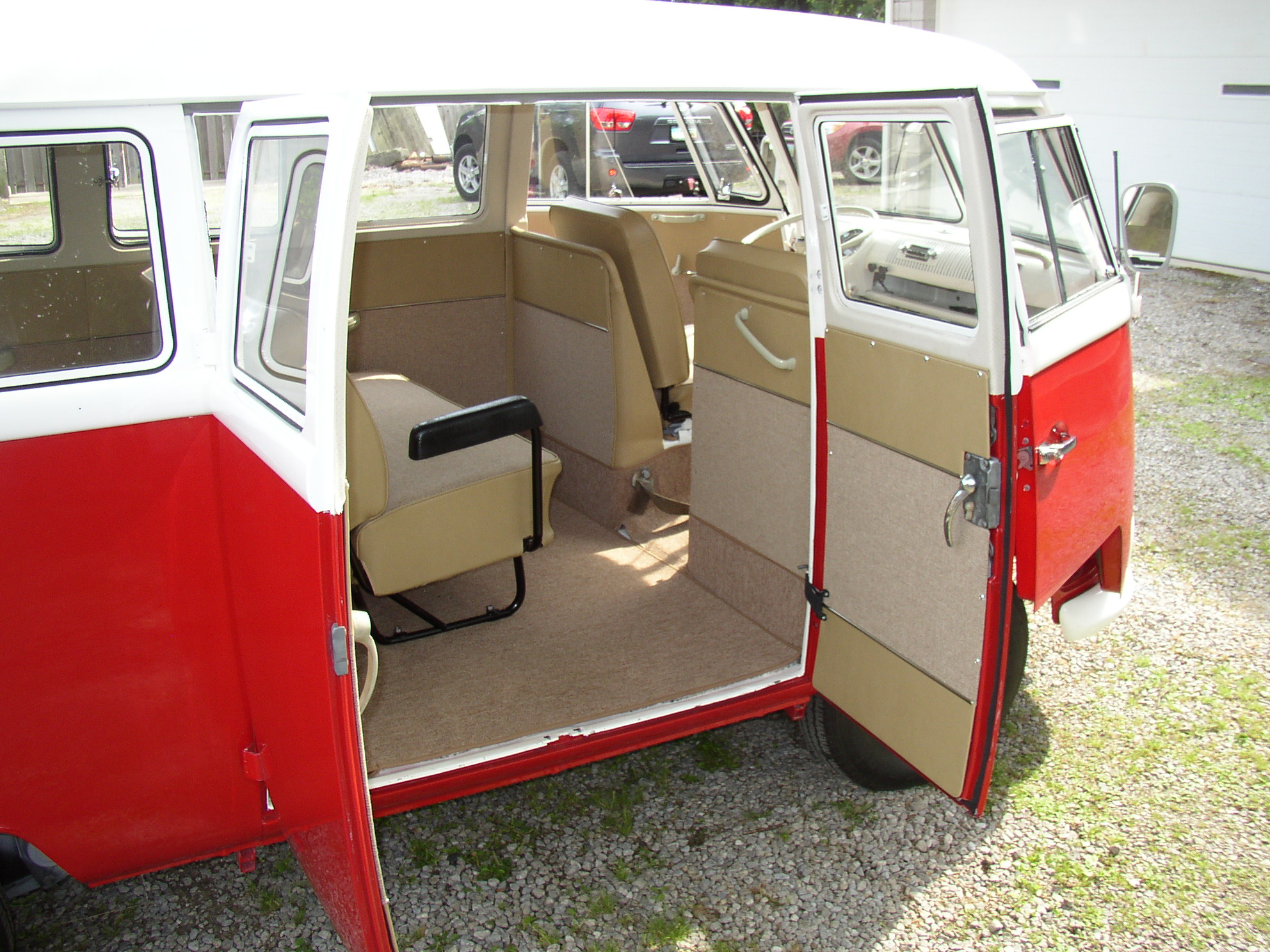

The interior is looking quite nice.

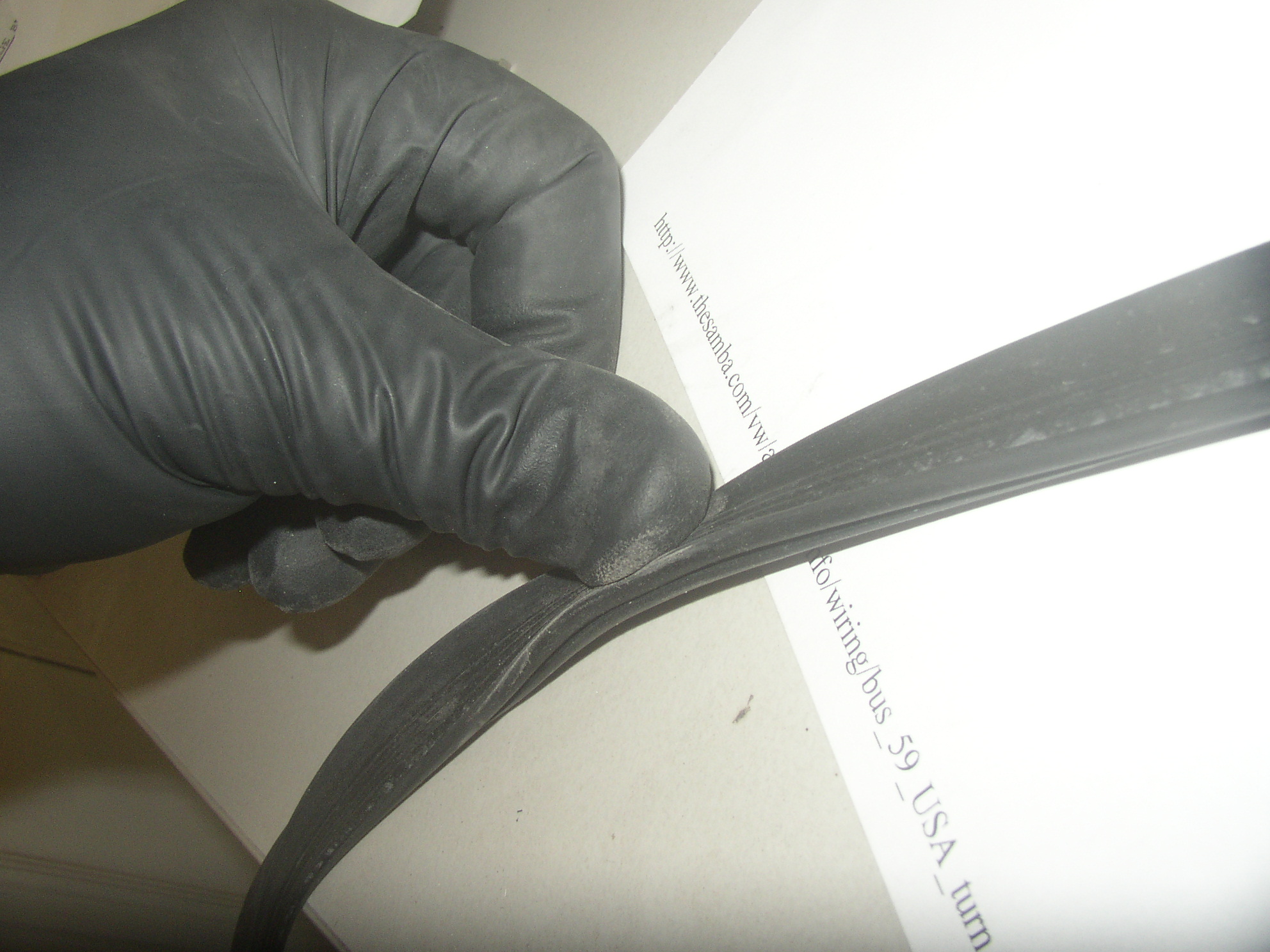

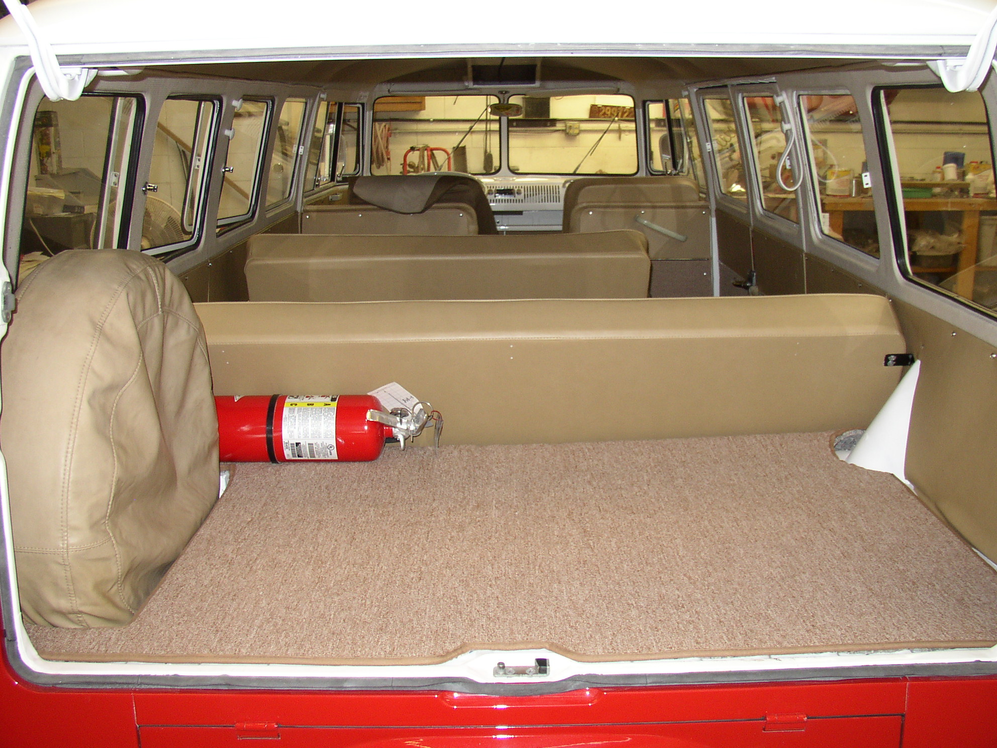

The weatherstrips from WW for the front doors, rear hatch, and engine lid all fit perfectly. The weatherstripping for the cargo doors was too thick and skewed the door alignment so badly I had to remove it and use Home Depot generic stuff, which actually fit quite nicely. The Samba guys bitch about the same thing.
The rear carpet is finished off and the rear seat installed, I found out the hard way the seat back has to be installed before the seat base. :oops:

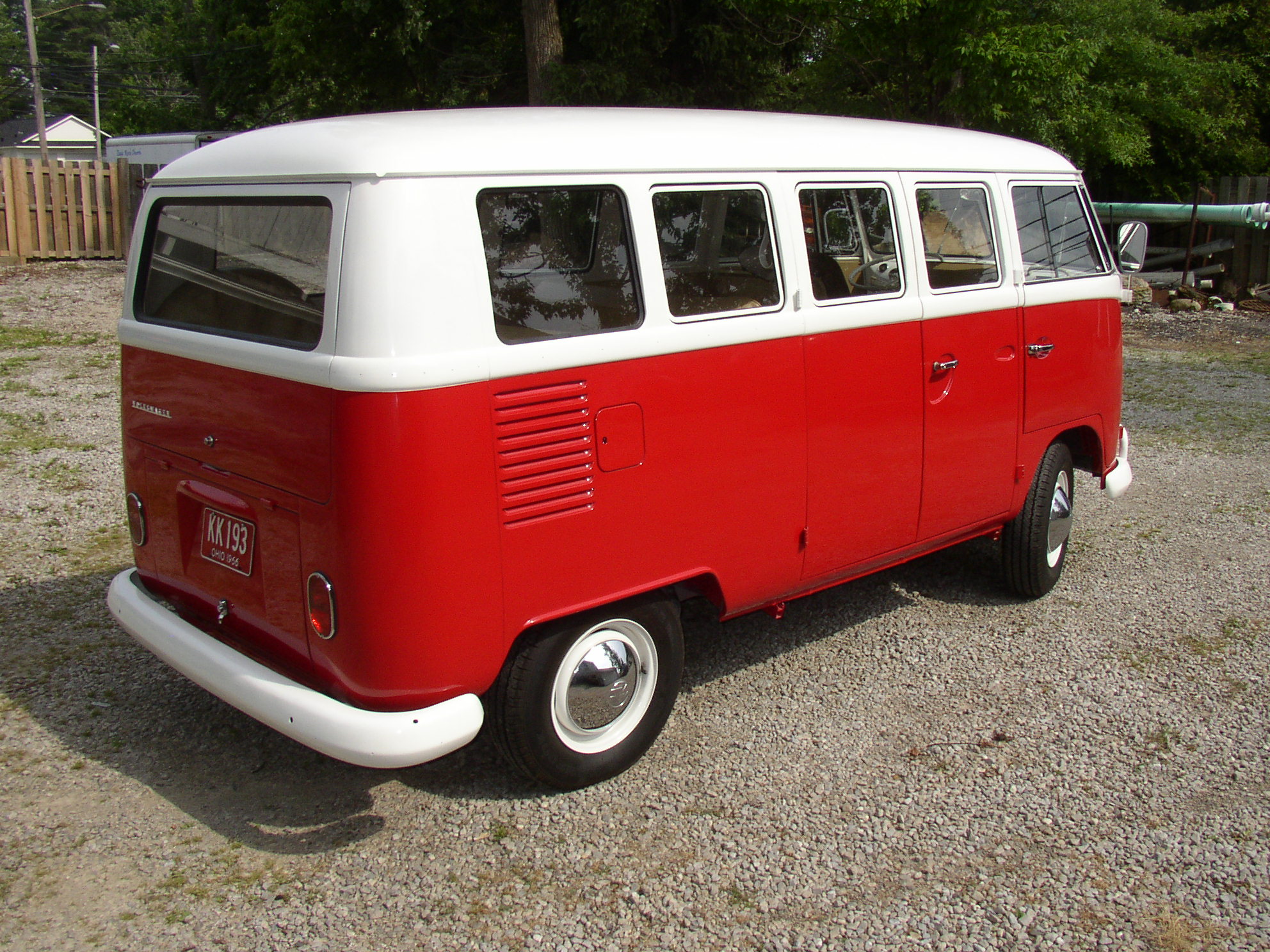

I straightened, mudded, painted, wet sanded and buffed the front bumper, and installed it.
Ditto for the rear but sans overriders and towel bars, I bought those new and they just arrived and have not been painted yet.
It's about 95% done right now with mostly trim left to do, I bought the RetroSound $159 radio with MP3 player but have not installed it yet. Still struggling with the 3 speed and a Rancho box with a 5 year guarantee for $699 is sounding better every minute. It drives very nicely but I still don't go much over 58-60 on the highway as the engine is really twisting, and going from a 4.37 to a 4.12 would help that a tad. The extra insulation really paid off as it is really quiet to ride in until you're up to speed on the highway. I'm probably about 950 hours right now and amazed how close it will be to an even grand for completion.
