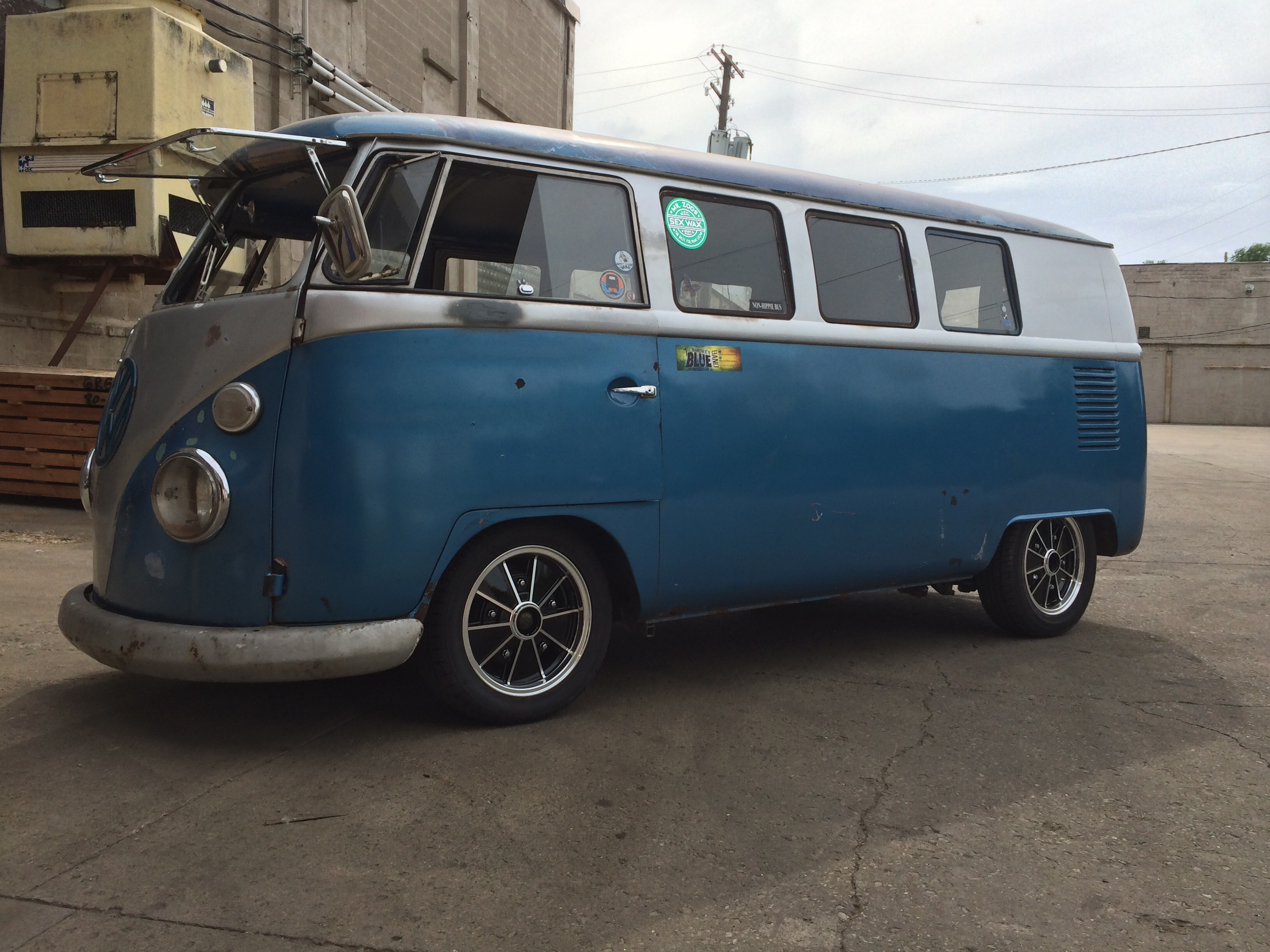

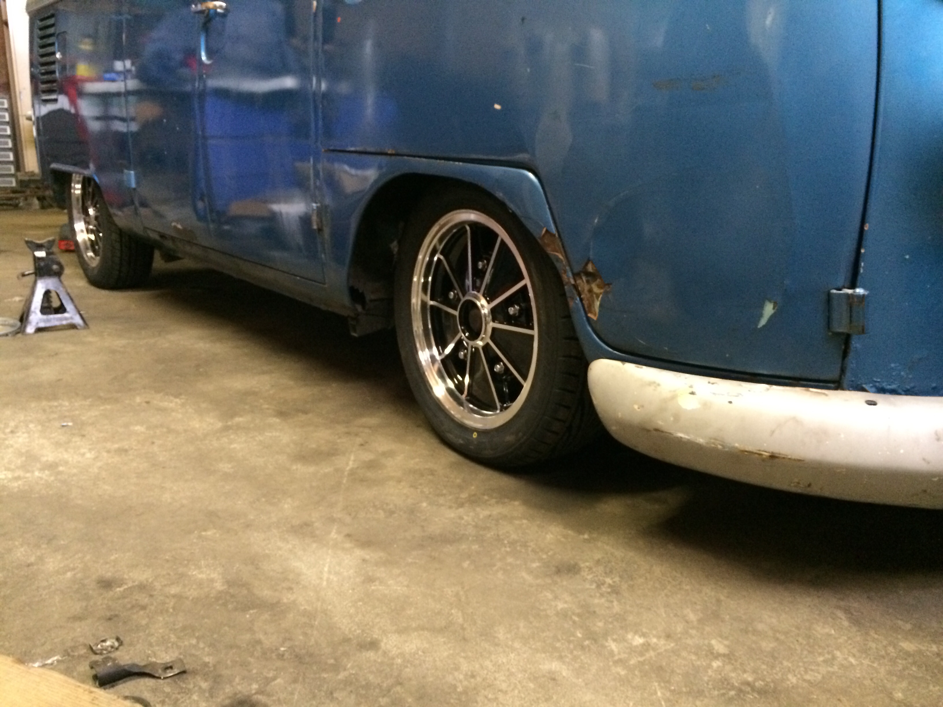

Well, its been a busy couple of weeks. I did alot of work but didnt document much. But today I finally hooked up the battery and started testing my rewire job... Nothing smoked or melted!! :lol: . I have turn signals, headlights, and oddly instead of 4-way hazards, I have 3-way hazards. The drivers front turn signal doesnt flash with the hazards. Idk why, will have to look at it. And no brake lights but I didn't bleed the brakes yet so hopefully that will solve that (or a new M/C switch). And the old girl is a little closer to the ground now.
Stock T2 front KYB gas-a-just in the rear, and EMPI 9650 oil filled shocks up front. I think my front tire choice will be a little to tall and rub but only a road test will tell.
Now my roof rack can stay on in my garage :)

First road test today and wow! Does this bus cruise! Didnt take it on the highway yet. Will do that tomorrow. Thanks to WSD for helping bleed and adjust the brakes up.
