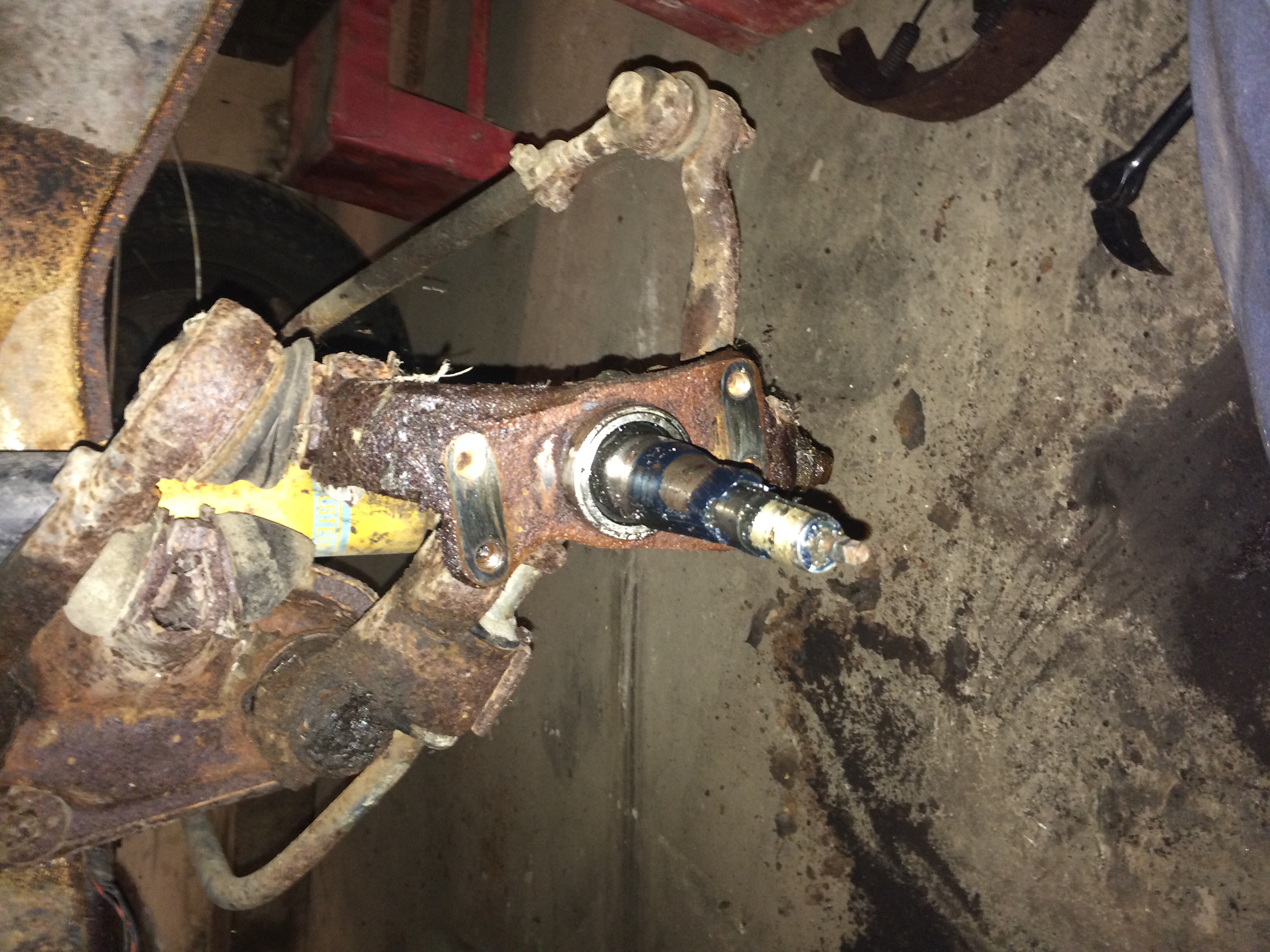

Also, bay window tie rods are supposed to be straight and not slightly bent right?
