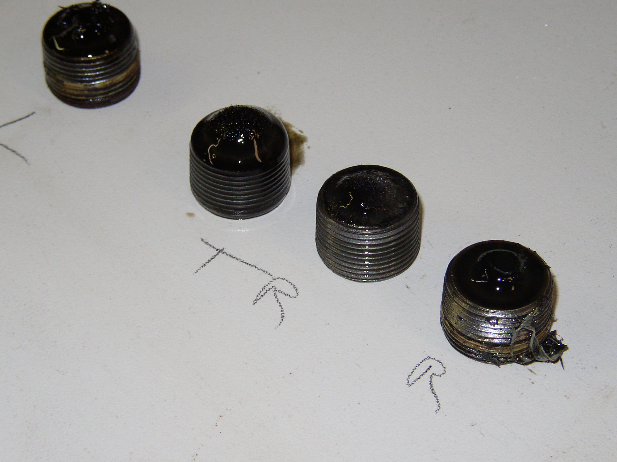

I put magnetic plugs in the RGBs, that's a lot of fuzz for 2000 miles. I'm thinking the left RGB has some big problems.... :roll:

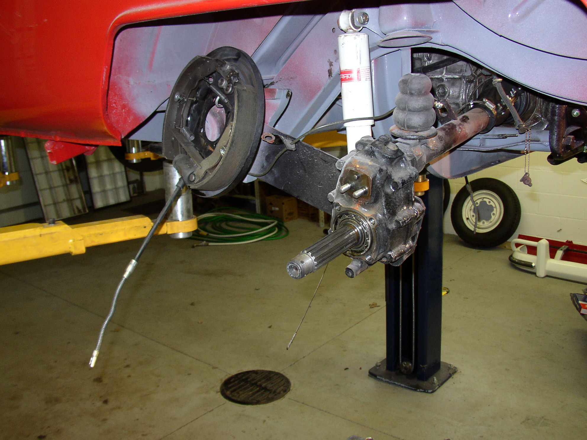

I was thinking I'd have to undo brake cables and hoses, but no- unhook the cables from the levers:
Pull them out of the backing plate...
Unclip the brake hoses from the axle tubes....
Pull the one bolt from the brake line retainers on the RGBs...
Simply pull the backing plate over the axle stub and hook it up with a bungee hook on the torsion tube.
Unbolt the starter, leaving the wires in place and bungee it to the crossmember. Hmm, did I unhook that battery cable?
OK, the mounts, shifter, ground strap, and everything is disconnected, pop it loose with a prybar and it's just sitting there looking stupid right now.
Place three carts, drag it onto them, and roll the carts back
Ta Da! Exit, bitch.

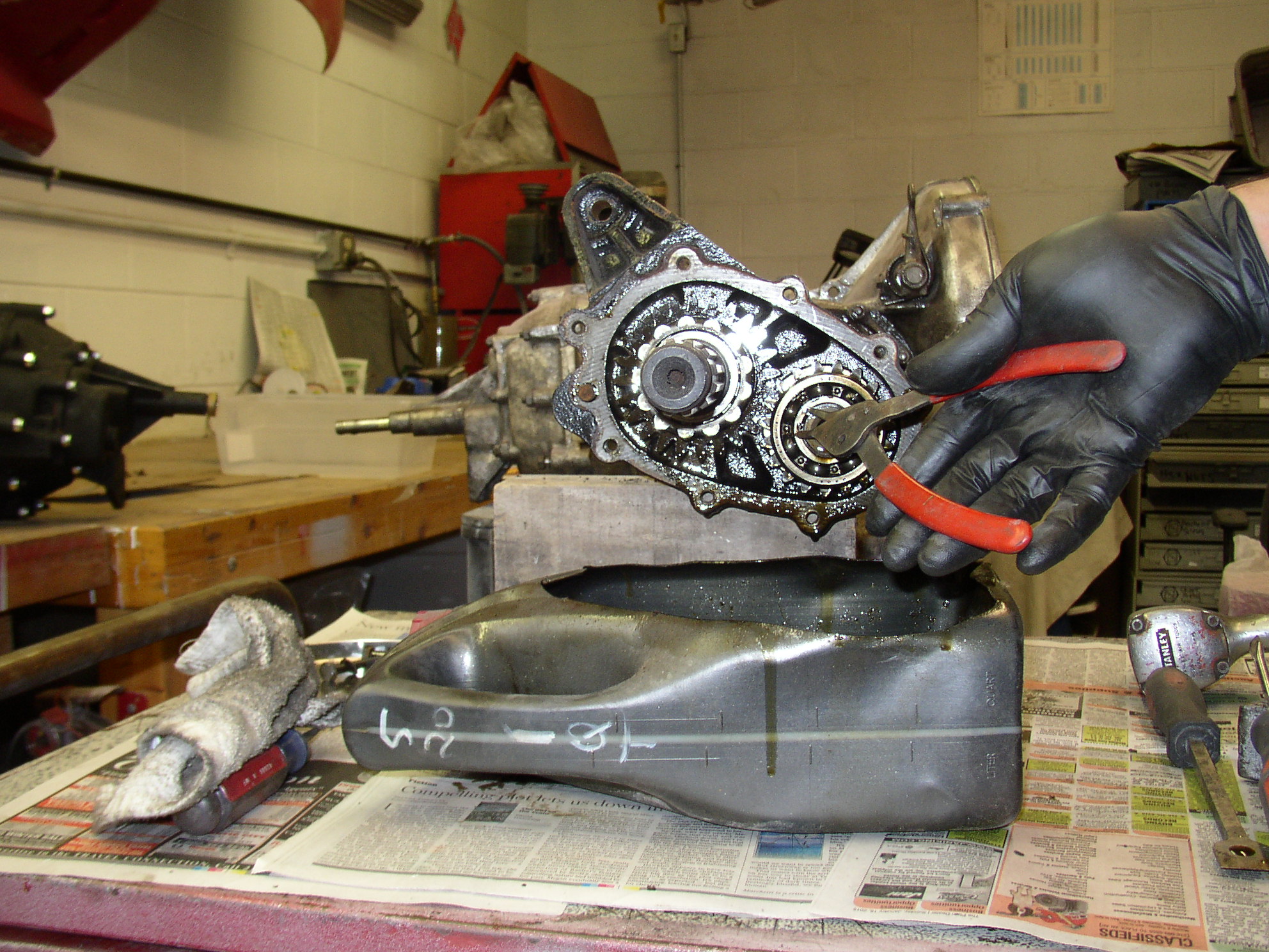

OK, tranny’s out, time to swap the axles onto the new trans from Rancho. First, set it up where you can work on it, I use a cart and a block of wood to raise the hub. I used the Bentley as a guide to do this so it’s pretty straight forward but I don’t have the 5 grand worth of specialty tools that it calls for.
Zip the bolts out and use a soft hammer to break the seal and walk the outer housing off. The outer axle bearing is a mild press fit into this housing so it won’t slide off.
Once the housing is split, there’s a snap ring on the axle end that must be removed.

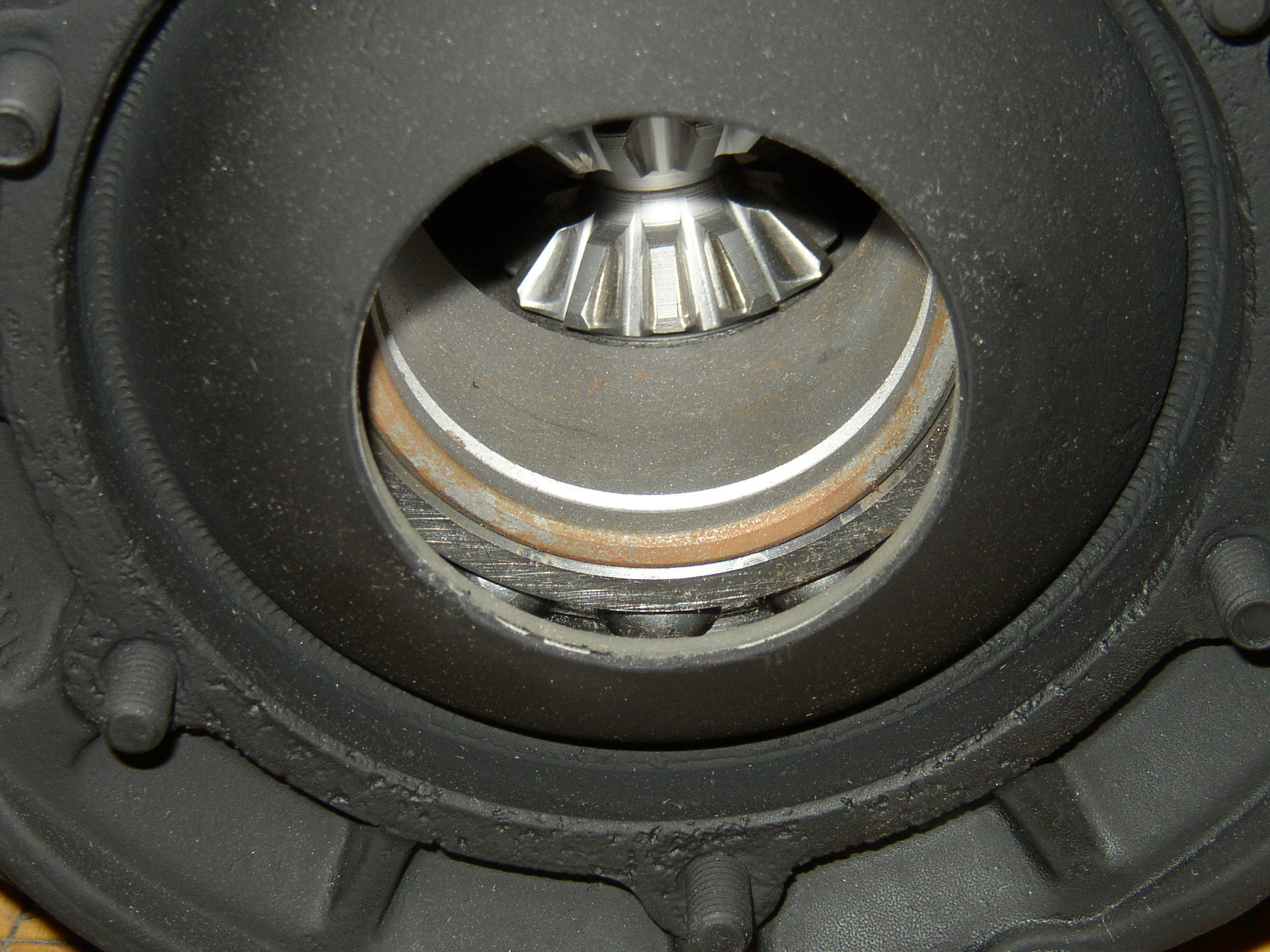

You’ll notice there is a stack of gaskets between the retainer plate and the side cover of the trans, this is for setting the end play/drag of the axle tube, more on this later.
This was the other side- the frigging plastic shim/thrust bearing was missing in the trans! It should have made a clunk on turns and maybe shimmied or wandered going down the road but I never noticed it. The thrust shim is a spare I ended up using.
So how do you decide you need 4 gaskets when the end play is 1/4"?

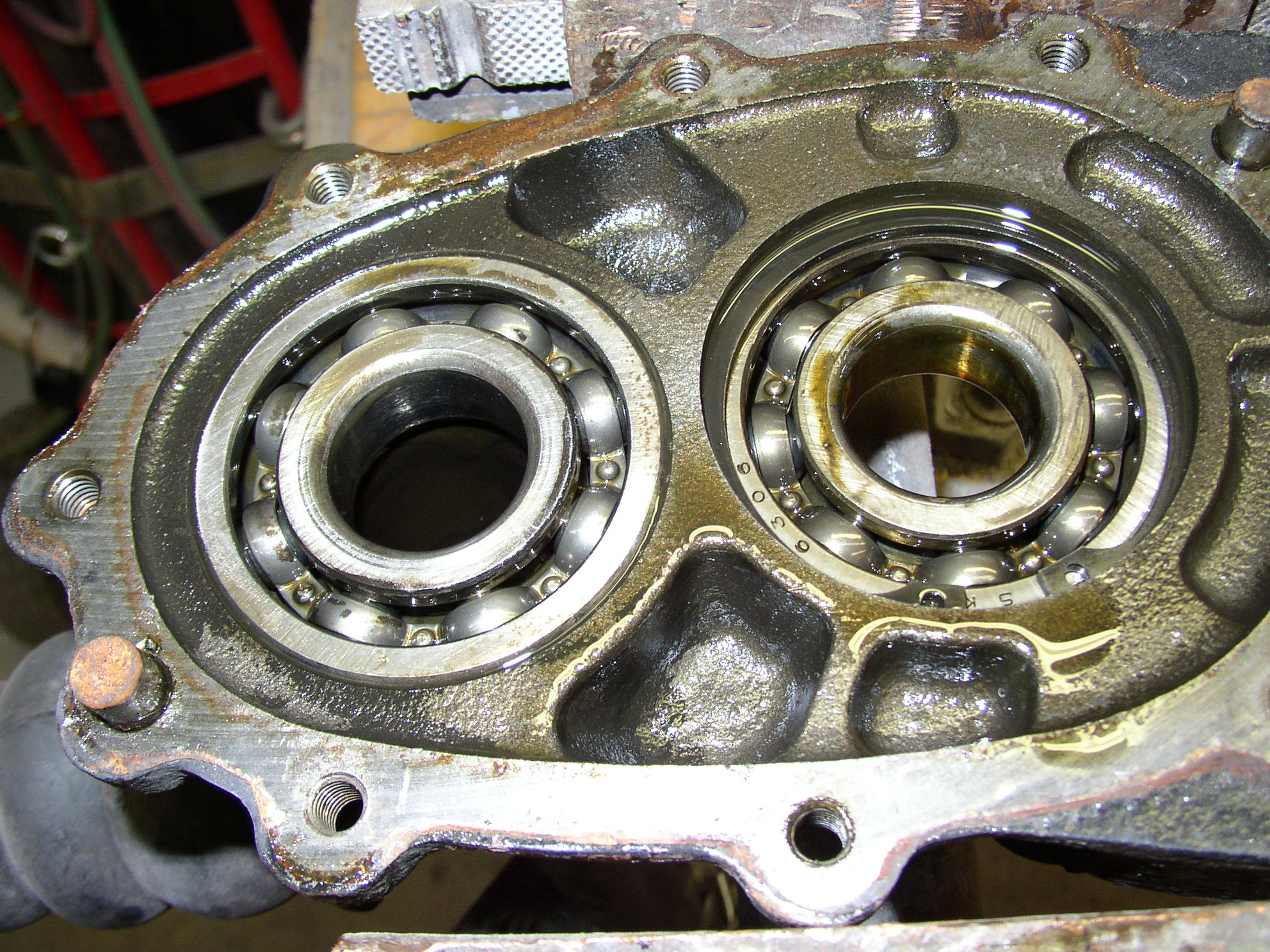

I cleaned all of the bearings I had (3 sets) and picked the best ones to use. A whole bunch didn’t even make the “maybe” pile, the races were pitted quite bad.
Here’s a pitted one.

Check the side gears for cracks and the fulcrum plates for wear, the spec is .012" max, I could barely get a .006" feeler gauge between mine.
Put the axle/side gear/fulcrum plates into the tranny.
and lock ring.

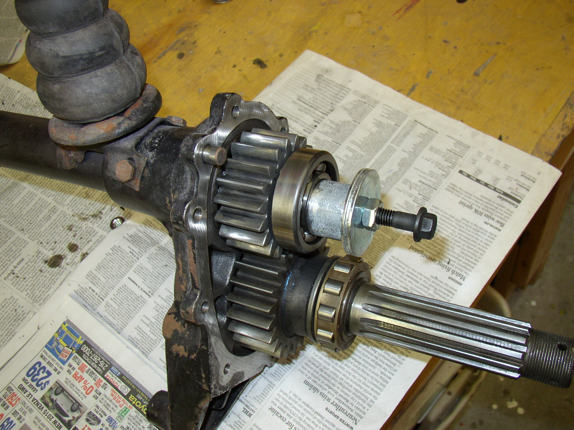

Slide the tube in place which already has the inner axle bearing pressed into the tube and start knocking the bearing onto the axle shaft. It's a slight press fit.
When it stops with a hammer use a piece of 1" electrical conduit, fender washers, a long 10mm bolt and nut to pull it into place.
The gear is a slip fit.
Pull the outer axle bearing onto the axle using a piece of conduit, bolt, nut, and washers.

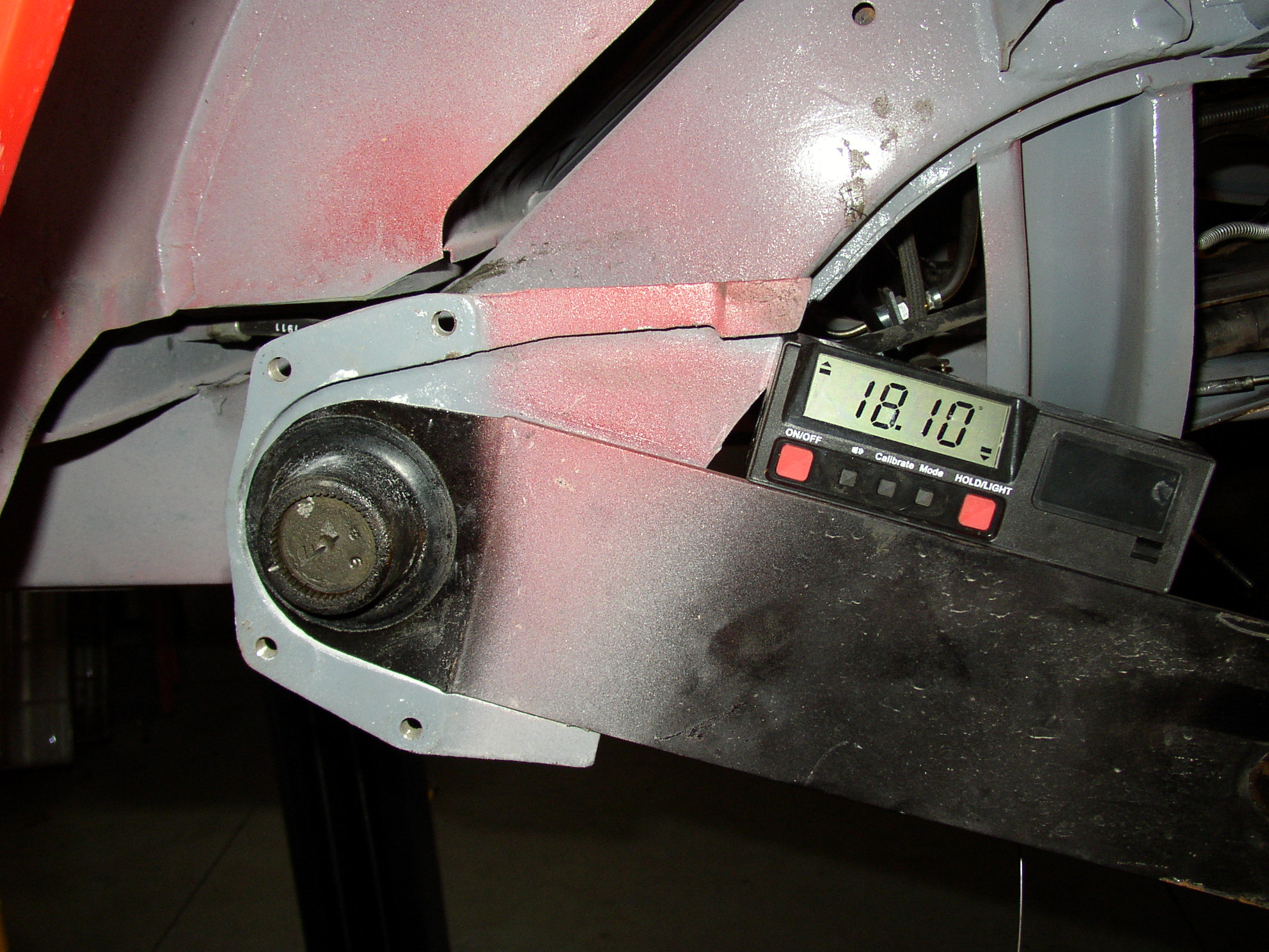

I'm going to reset my torsion bars a bit because I have about 3-4 degrees positive camber on each rear wheel.
Pull the cap to find the torsion bar walked out and was rubbing the cover.
That might be my weird squeak.
Pop the bar over the bump stop.
I used to use one of these....
But recently stepped up to a digital version for $20 from Fleabay.
Look at the handy dandy chart that Tom at ECC linked me.
Let's lower it about 2.9*, which should change my camber about 2.5* if my calculations are correct.
Repaint the parts and put it together, repeat for the other side.
