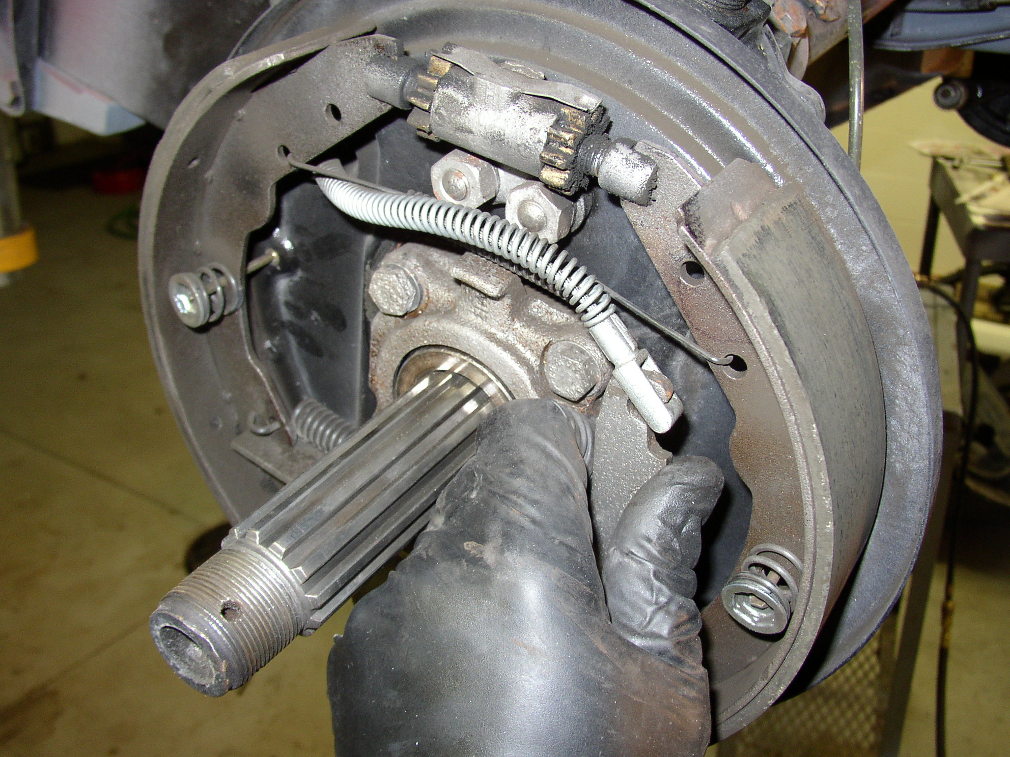

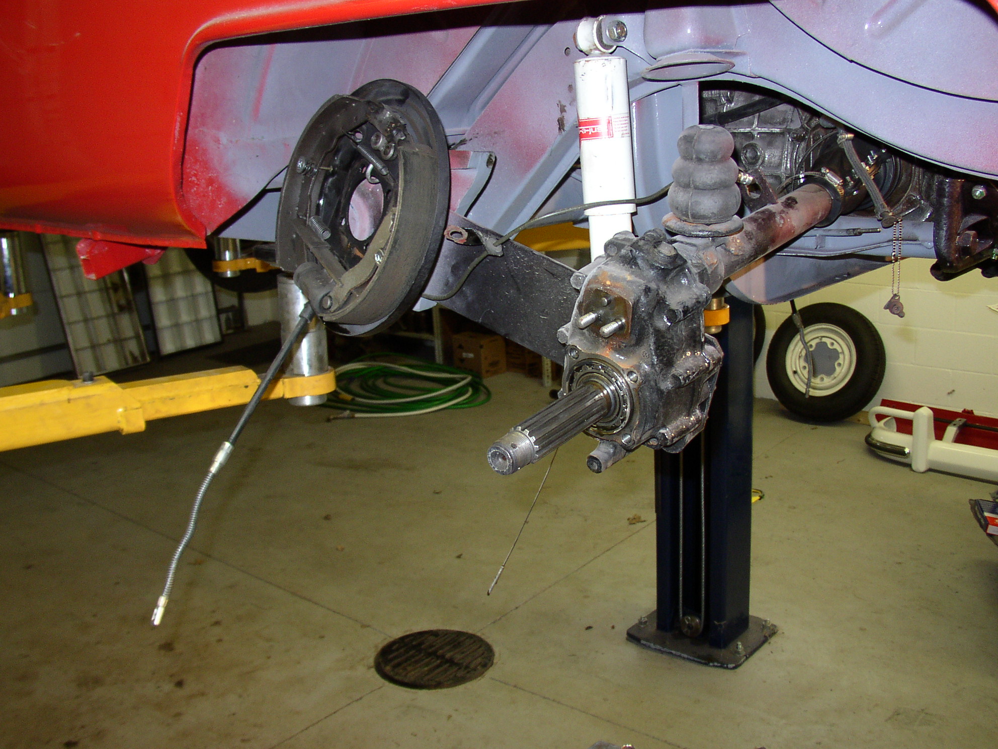

I was thinking I'd have to undo brake cables and hoses, but no- unhook the cables from the levers:
Pull them out of the backing plate...
Unclip the brake hoses from the axle tubes....
Pull the one bolt from the brake line retainers on the RGBs...
Simply pull the backing plate over the axle stub and hook it up with a bungee hook on the torsion tube.

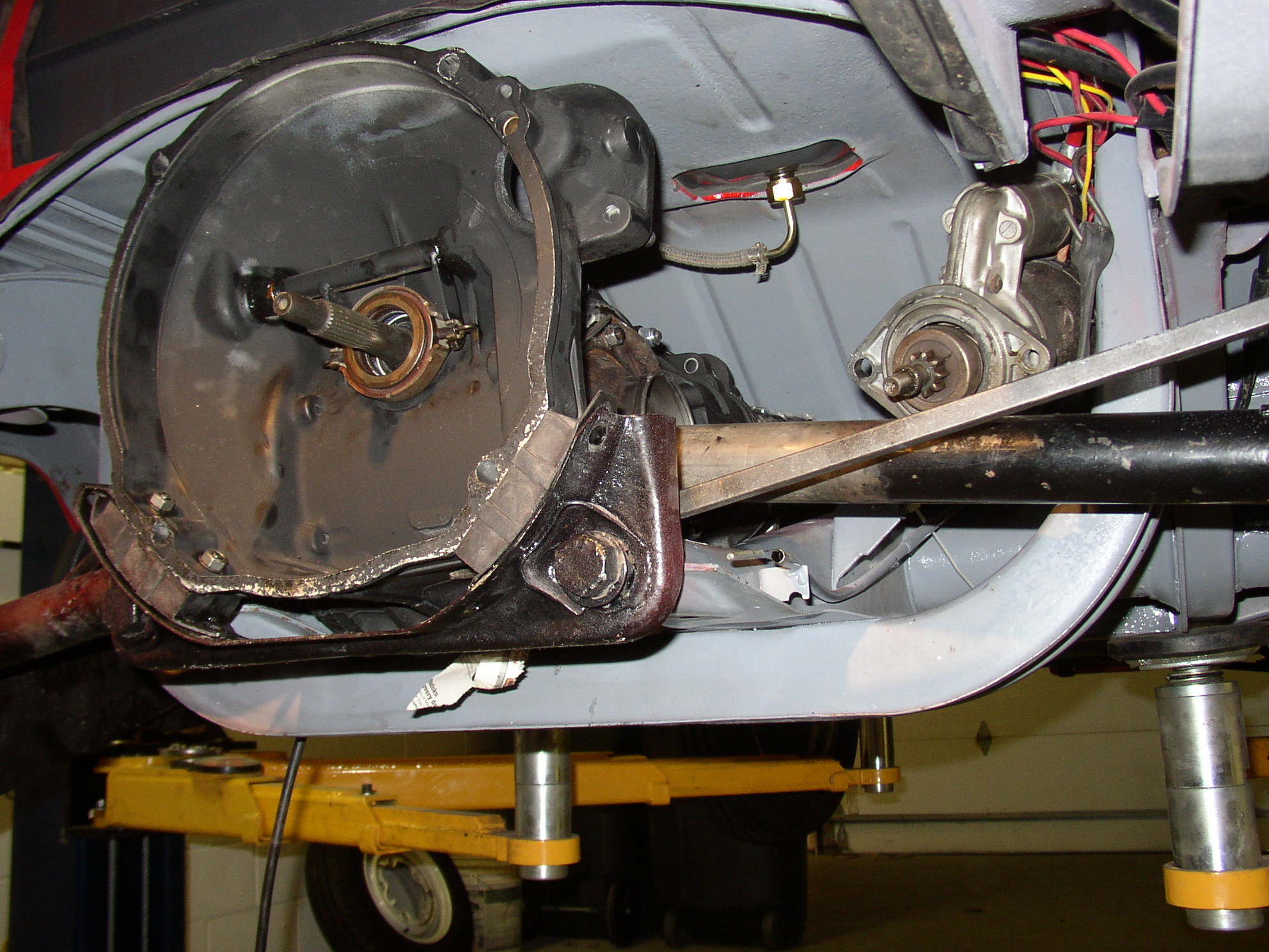

Unbolt the starter, leaving the wires in place and bungee it to the crossmember. Hmm, did I unhook that battery cable?
OK, the mounts, shifter, ground strap, and everything is disconnected, pop it loose with a prybar and it's just sitting there looking stupid right now.
Place three carts, drag it onto them, and roll the carts back
Ta Da! Exit, bitch.
Having everything organized should make installation easier. This is like working on a brand new car- 2.5 hours to get the motor and tranny out and that was taking my time, if I hustled I could have done it in half that time. It should only take 2.5 to put it back in, right? ;)

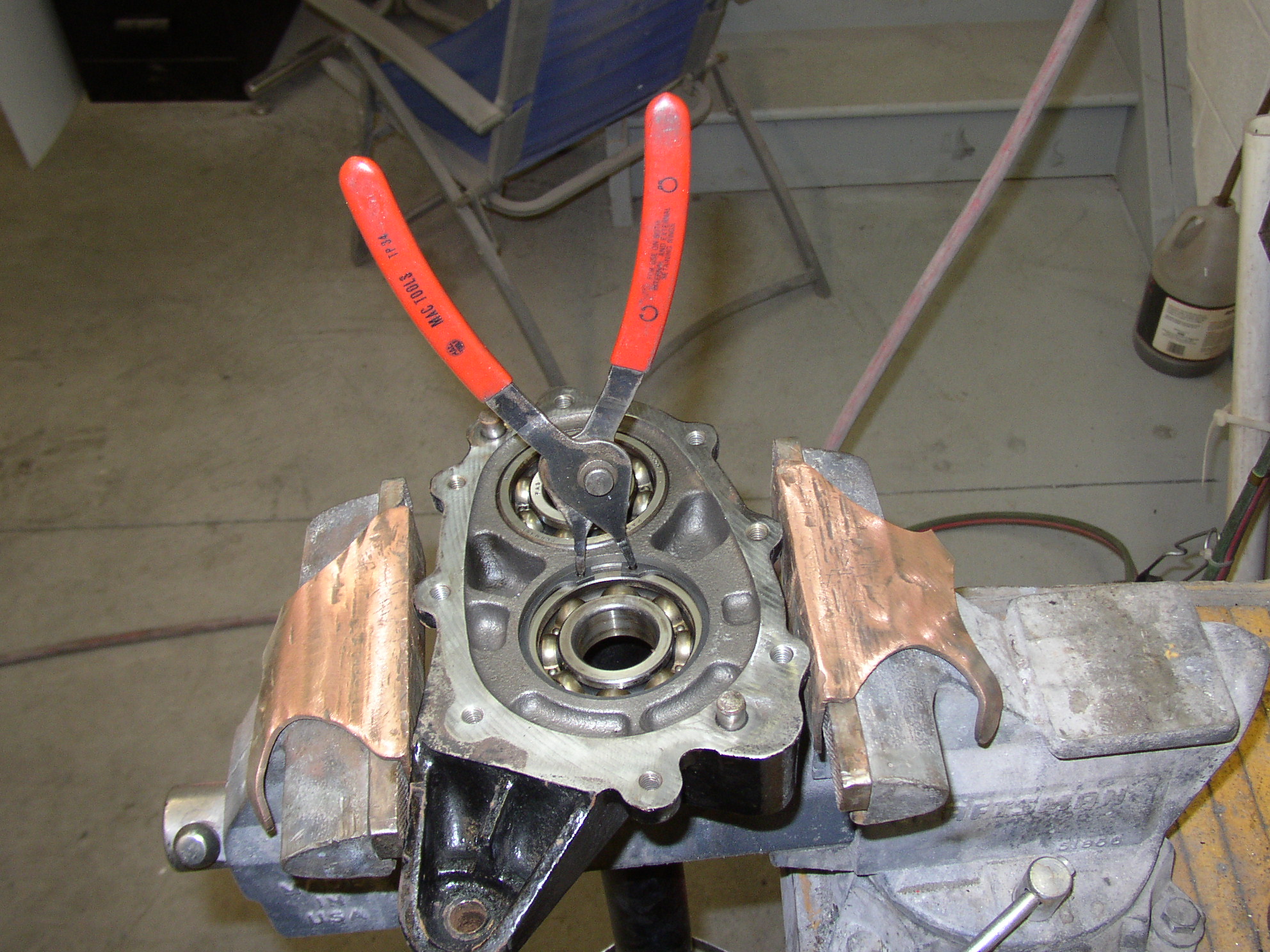

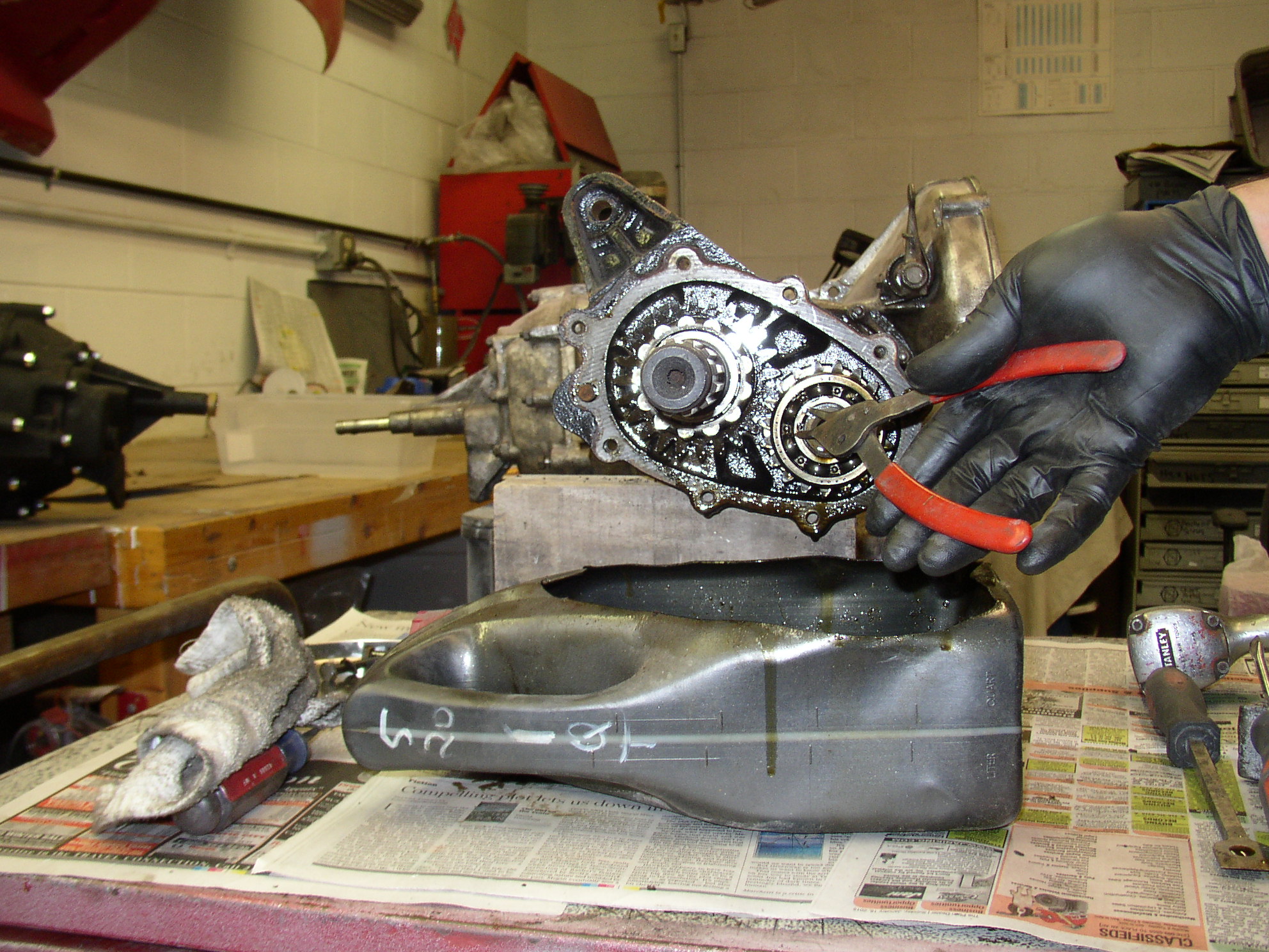

Once the housing is split, there’s a snap ring on the axle end that must be removed.

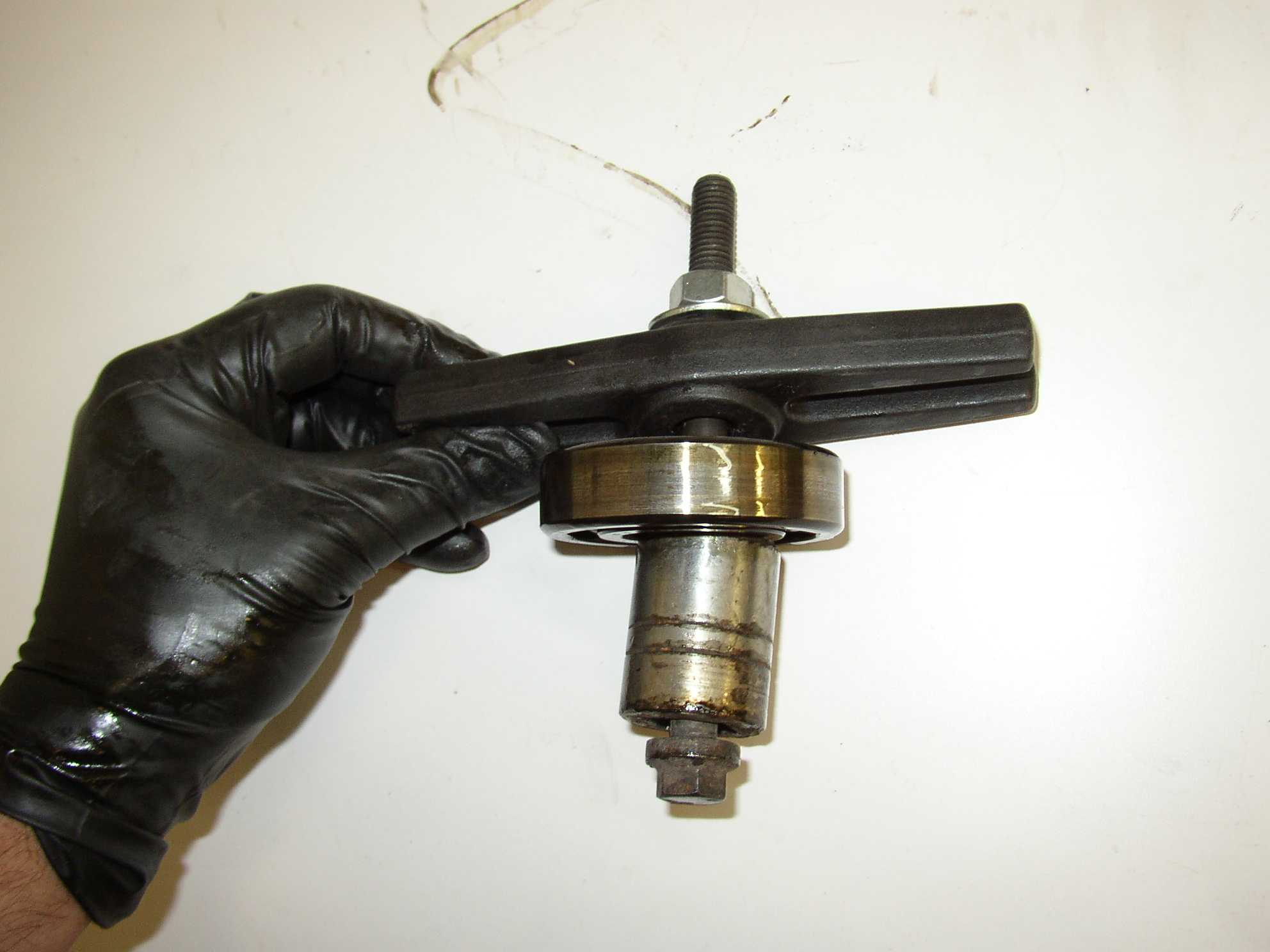

Then the outer axle bearing is press fit onto the axle, I set up a puller to get it off.

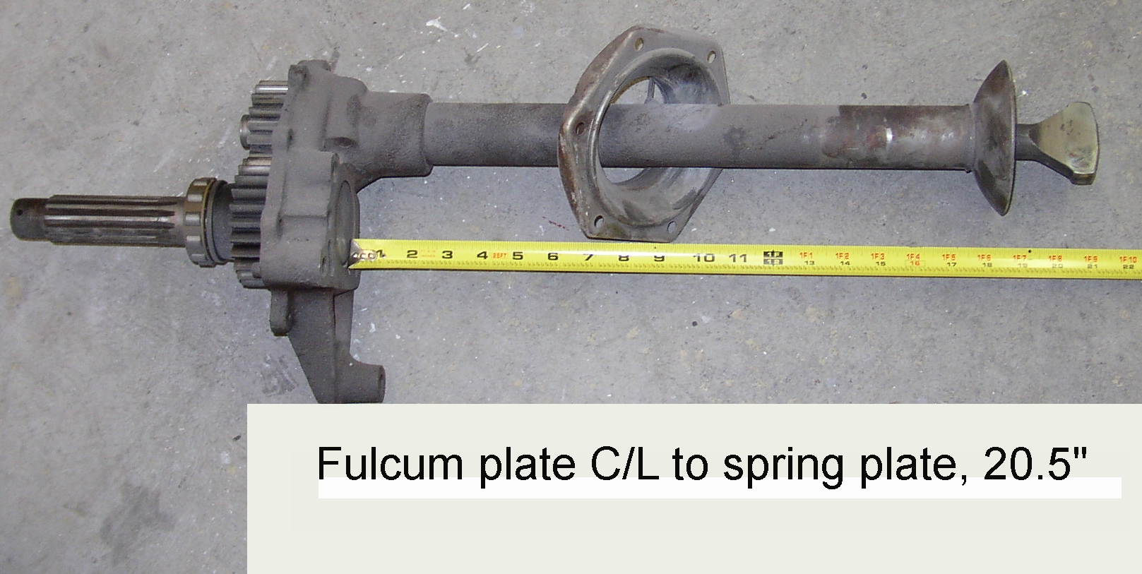

You’ll notice there is a stack of gaskets between the retainer plate and the side cover of the trans, this is for setting the end play/drag of the axle tube, more on this later.
This was the other side- the frigging plastic shim/thrust bearing was missing in the trans! It should have made a clunk on turns and maybe shimmied or wandered going down the road but I never noticed it. The thrust shim is a spare I ended up using.
So how do you decide you need 4 gaskets when the end play is 1/4"?

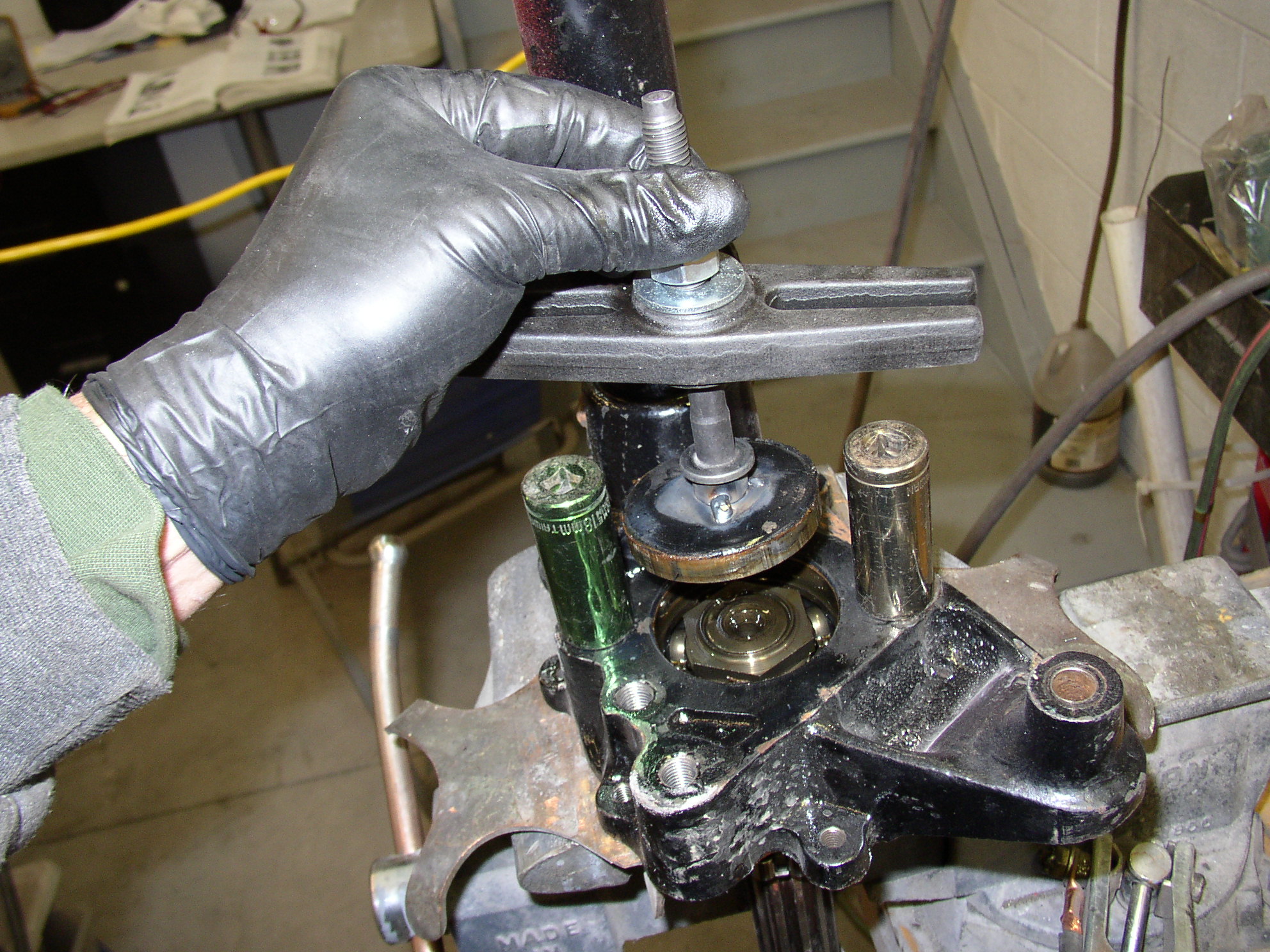

Set the axle tube in a vise and remove the freeze plug on the back of the stub axle. This requires welding a nut or bolt to the plug and extracting it with a puller. Tighten the nut and it pulls the freeze plug out. Use a whizzer wheel and grinder to seperate and clean up the freeze plug for reuse.
Once the freeze plug is out there will be a large retainer nut on the back side of the stub axle, use a center punch to uncrimp the retainer crimp that locks it in place.
Then you’ll either need a 1 5/8” socket or a special 4 tab socket, depending on what your axle has to remove the nut.
Use a hammer and soft punch (this is a bar of copper) to knock the stub axle from the bearing.
Flip it over and remove the snap ring from retaining the bearing, and remove the bearing.
It’s a slip fit.
The stub axle prevents you from removing the outer axle bearing. Once the stub axle is gone you will have access but it’s a press fit. I used a ¾” socket of the appropriate size, slid through the axle tube, with a long bolt slid through it, and a puller to extract the outer bearing.

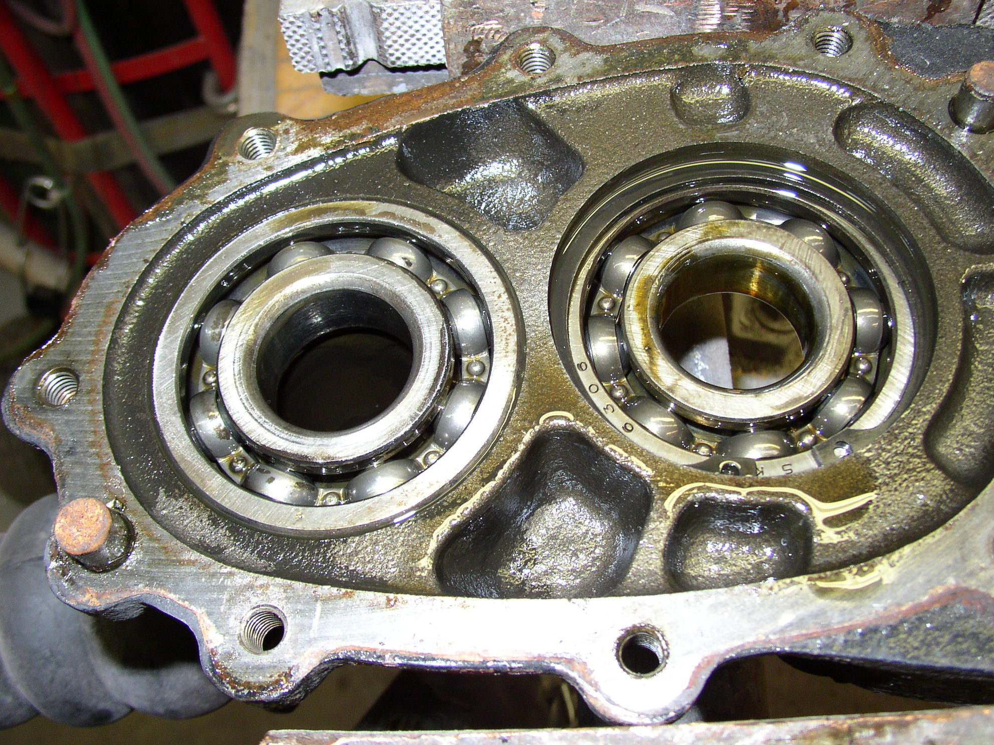

I cleaned all of the bearings I had (3 sets) and picked the best ones to use. A whole bunch didn’t even make the “maybe” pile, the races were pitted quite bad.
Here’s a pitted one.

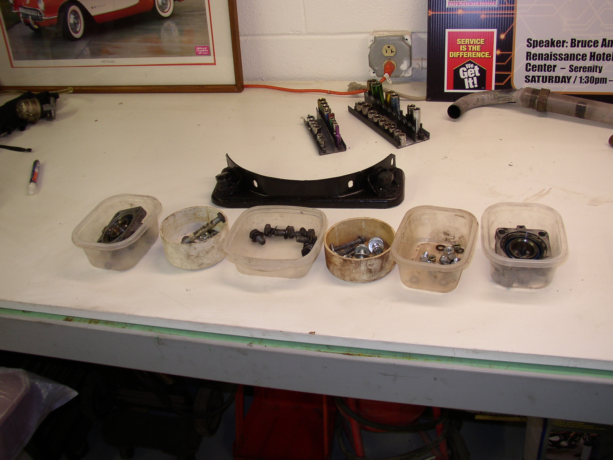

Get your shit in one pile.
