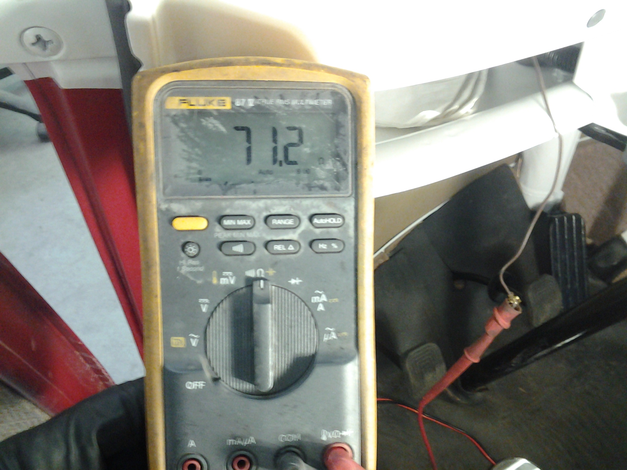

I'm still using a 6v gas gauge on a 12v system, and Samba guys say you can use a 6v gauge forever on a 12v system, but I'm just not like that. I wanted to put a dropping resistor in the fuel gauge power feed. I read the amperage it pulled (76ma) on 12v and used Ohm's Law to figure the operating resistance at 12v, which was about 165 ohms. (12.6/.076=165.78) That meant if I put a 165 ohm resistor in the feed it should drop the voltage in half.

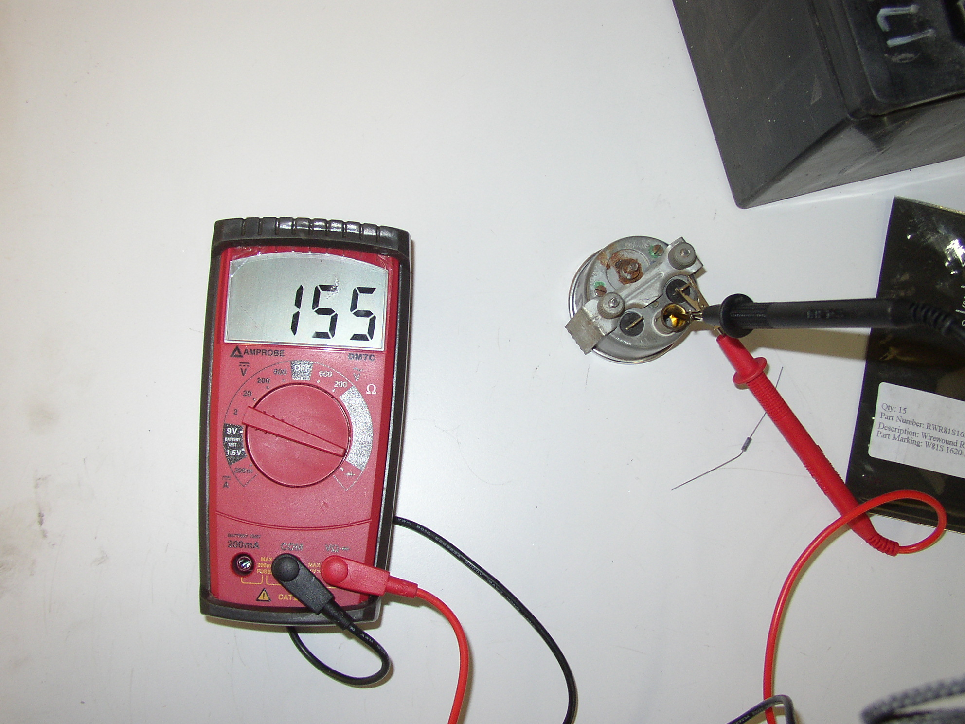

I bought a pack of 162 ohm resistors from Fleabay for a few bucks delivered.
Testing on the bench showed dead on- the resistor in series gave an operating voltage of 6.25v with a fully charged battery at 12.55v on a spare 6v gas gauge.

The measurement I took at the gas gauge for current flow is super tiny- 76ma (76 milliamps, which is 76- 1/1000s of an amp or .076 amp) is not enough to even make a taillight bulb glow dimly.
