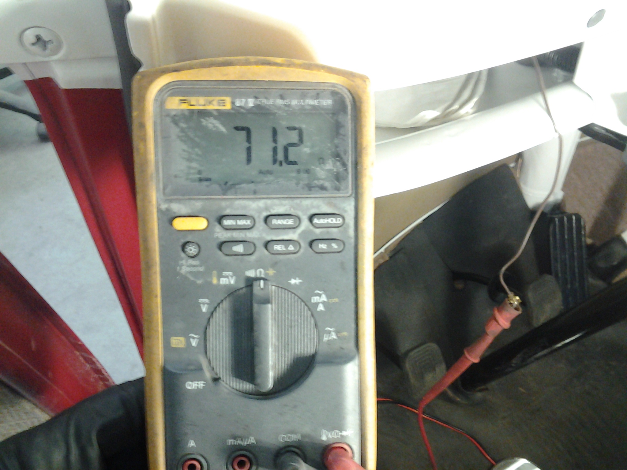

Well, let do some diagnostics before slamming parts. The gauge barely moves when I turn the key on and stays at the bottom even when the tank is filled. Let's see what the resistance of the sender is.
Hmm 71.2 ohms, which means the float is on the bottom. Not another sunk float?! This will be the third in two years.

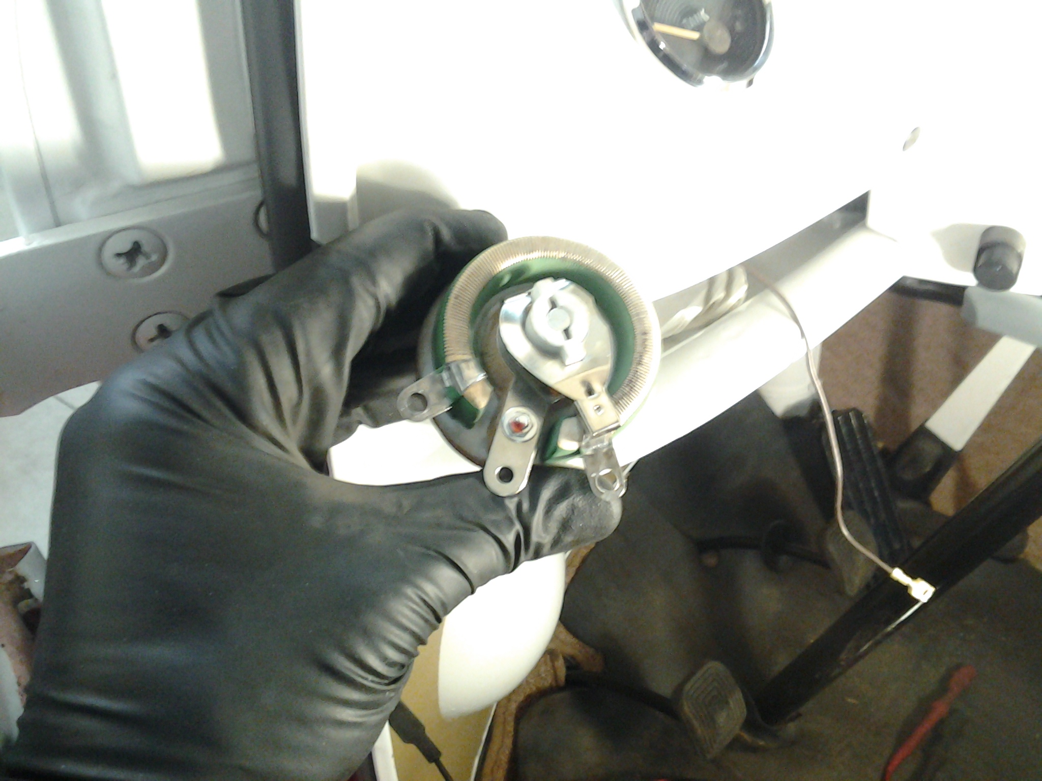

Let's make sure the gauge is working correctly. I have a variable poterntiometer that I use for testing fuel gauges, it goes from 0 ohms to 300 ohms.
I hook it up to the sender wire and ground and give it a twist.
https://www.youtube.com/watch?v=vI5Gx3xf1R8
It works great, so the phucking sender took a dump again.

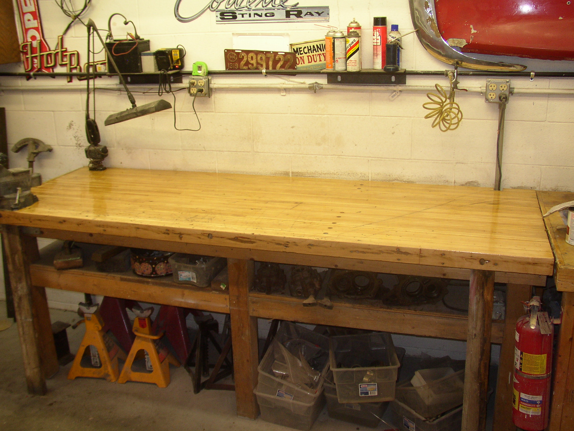

While waiting for 6V parts, I decided to refinish my workbench. It's an old bowling alley chunk, probably maple about 2" thick. Belt sand, D/A, and 4 coats of poly for that wet look. I'll probably skip the wet sand, buff, and wax. I figured if "L" can do it, so can I.

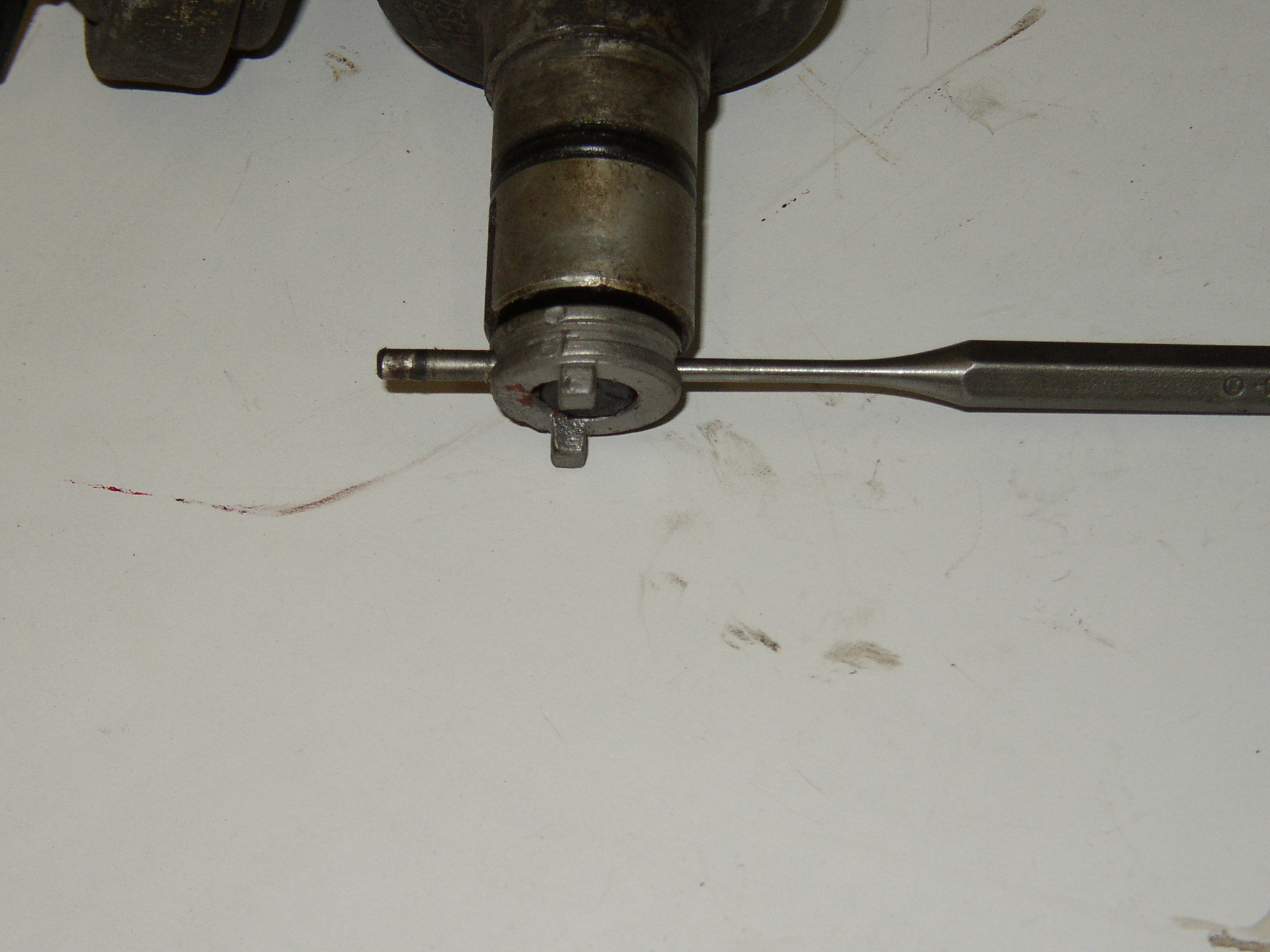

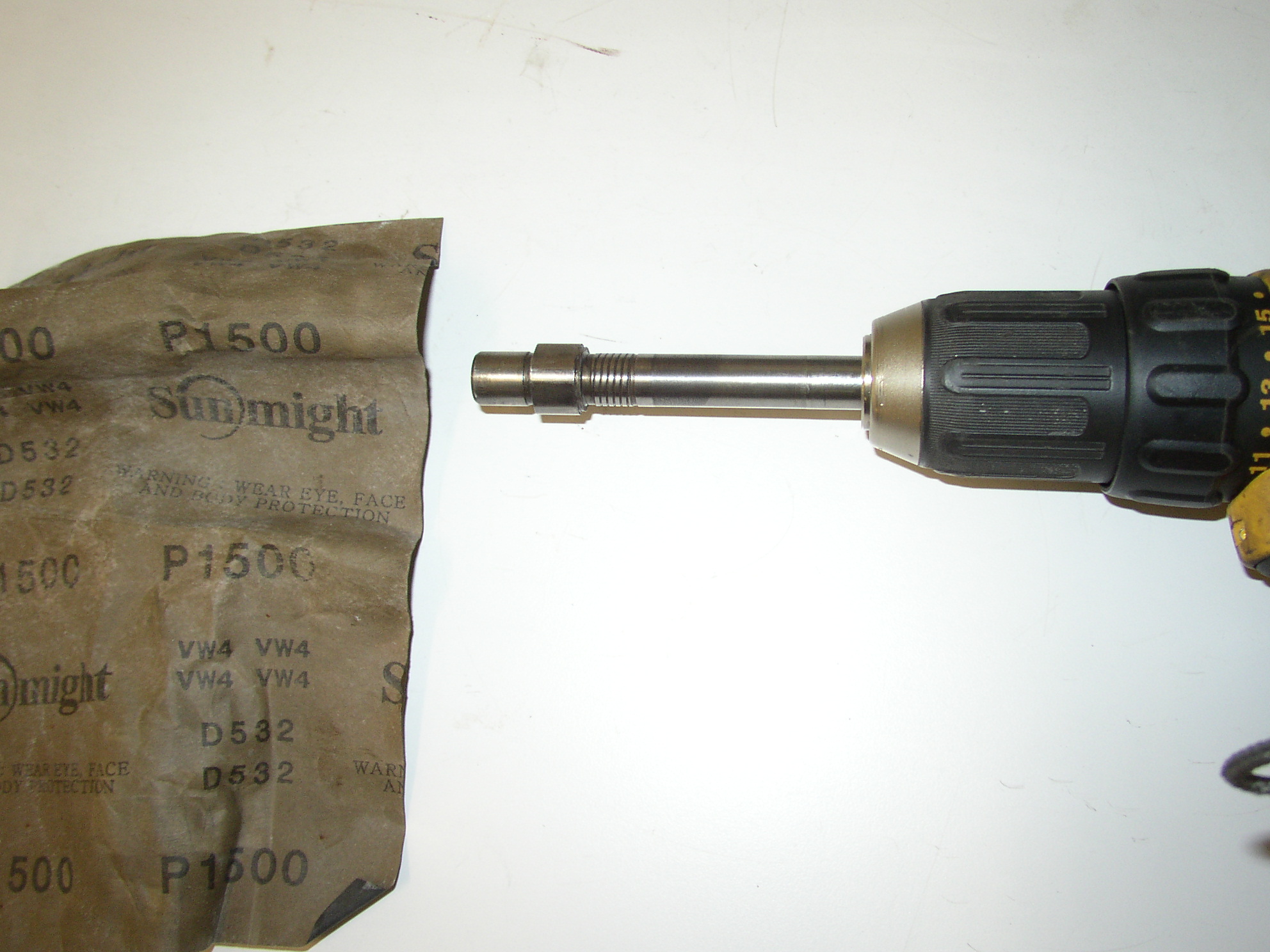

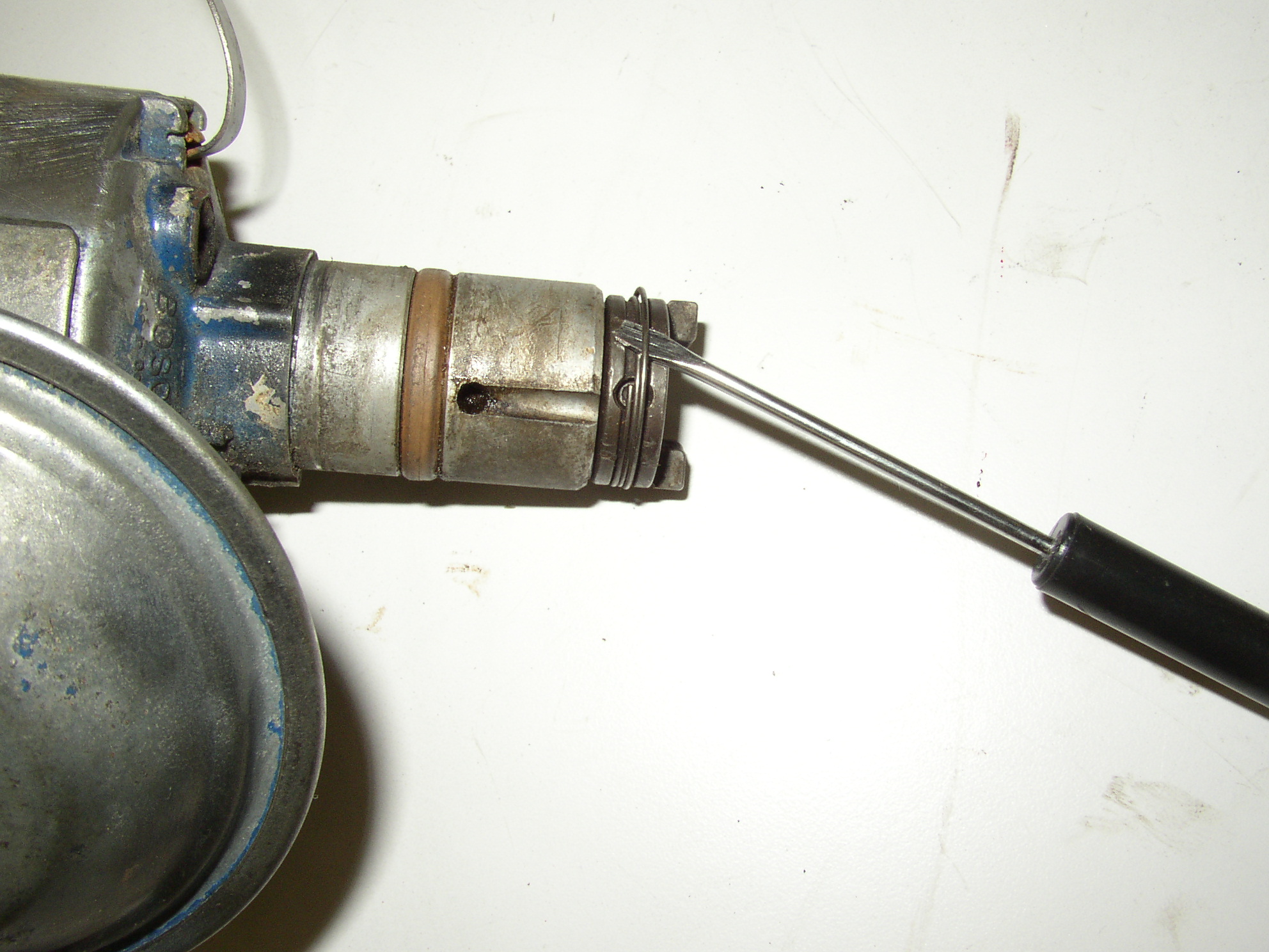

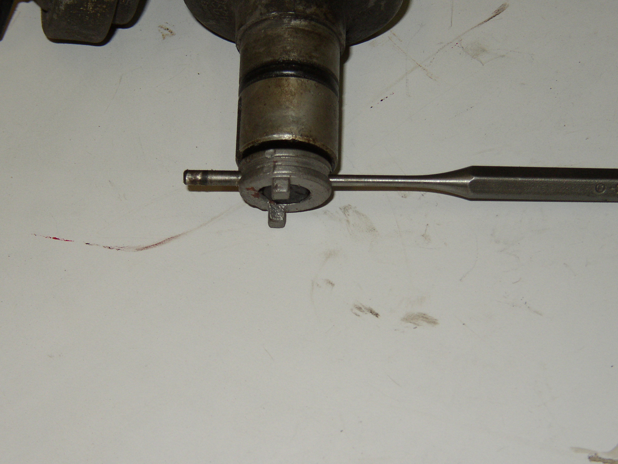

The Samba gang (including Glenn, "Mr 010") seem to think that the '66-67 Beetle dist 0231137011 or 0231137009 works best with the 30PICT carbs that they "say" work best on a 1500/1600SP. I bought a couple of those distributors, went through the best one quickly and installed it. The best one was dirty and didn't spin really free so a quick go-through was in order. Being that it's vacuum only advance, pulling it apart is super easy- pop off the spring clip,
Punch the pin out (I did that in a vise, this was just for the pic),
Pull the shaft out which looked grungy. (no pic) Chuck it in a drill and wrap it with 1500 sandpaper to clean the bearing surfaces and cam lobe, it now looks like new.
Take a wire brush and clean the bushings,
Clean in solvent (don't get it on/in the diaphragm if you didn't pull it off) and reassemble with some lightweight lube on the bushings and cam. It's oiled by the engine so long term lube is not important. If it had centrifugal advance, cleaning and lubing that would be important but this one doesn't.
Put new parts inside, install into the engine and set the timing.
I now have 200+ miles on it and really don't notice much difference between the H30/31 carb with a SVDA distributor, the new 30PICT/SVDA and 30PICT carb and vac only advance. But, you know, if they say it on the Samba, it has to be true.
