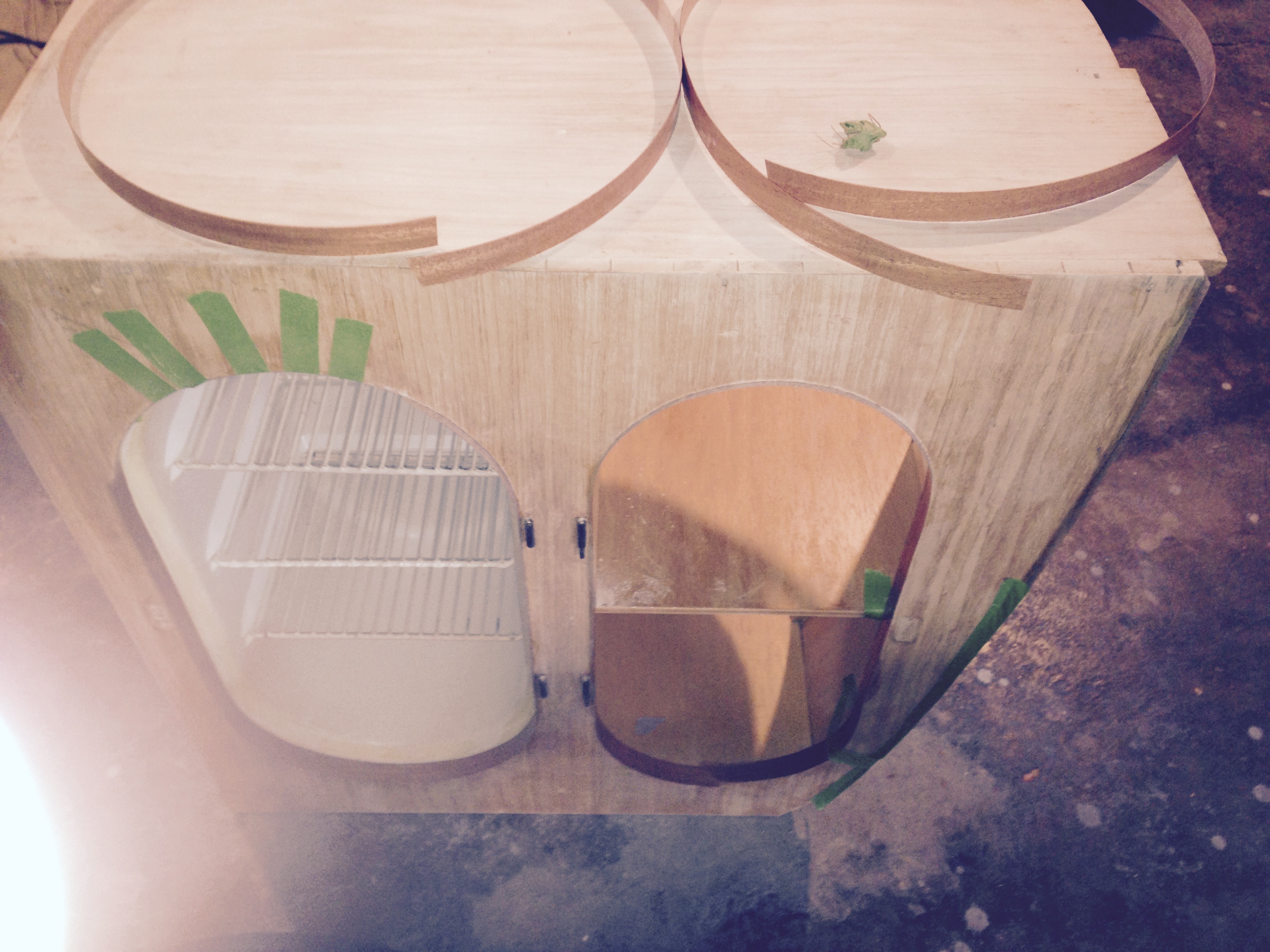

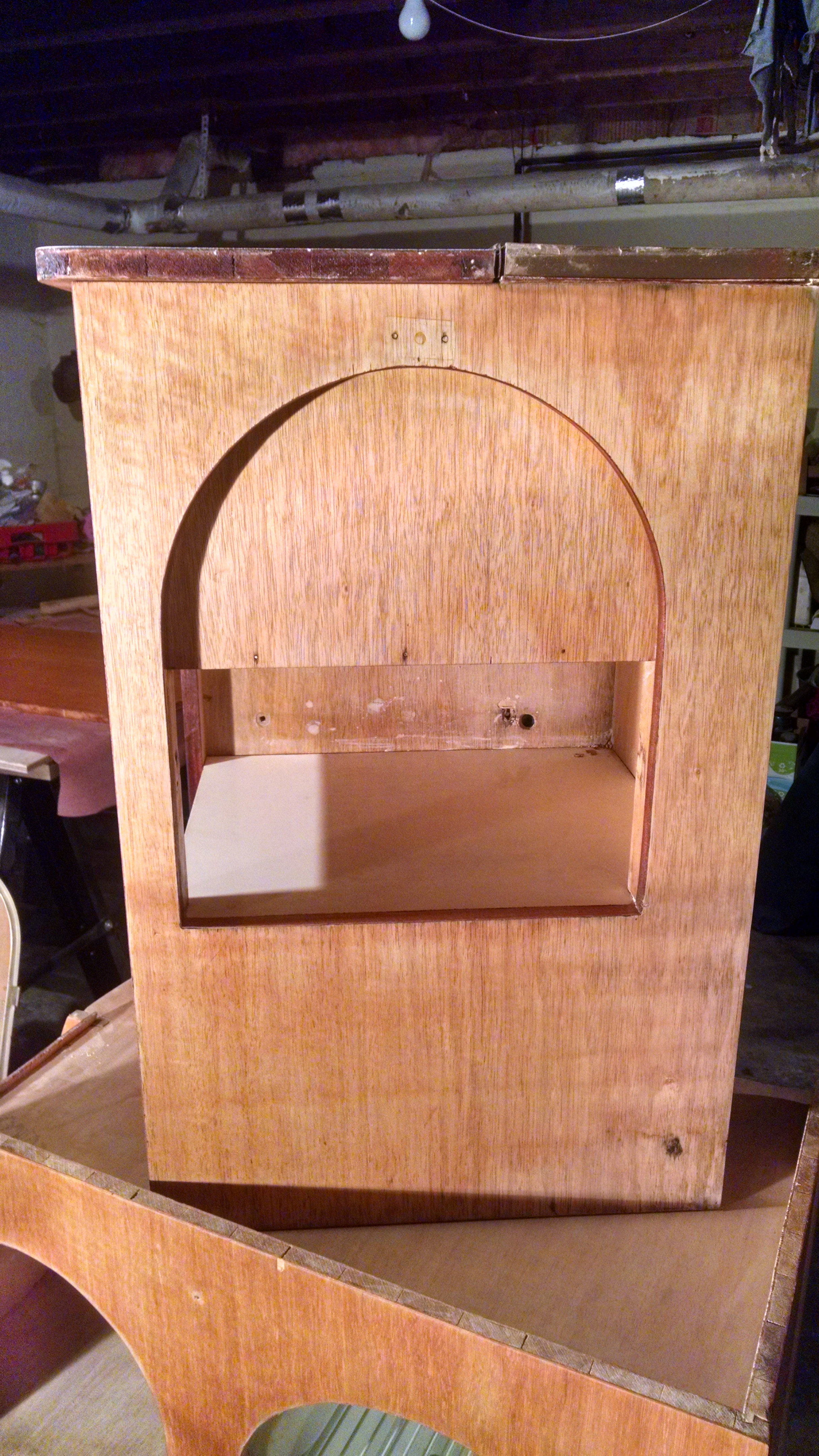

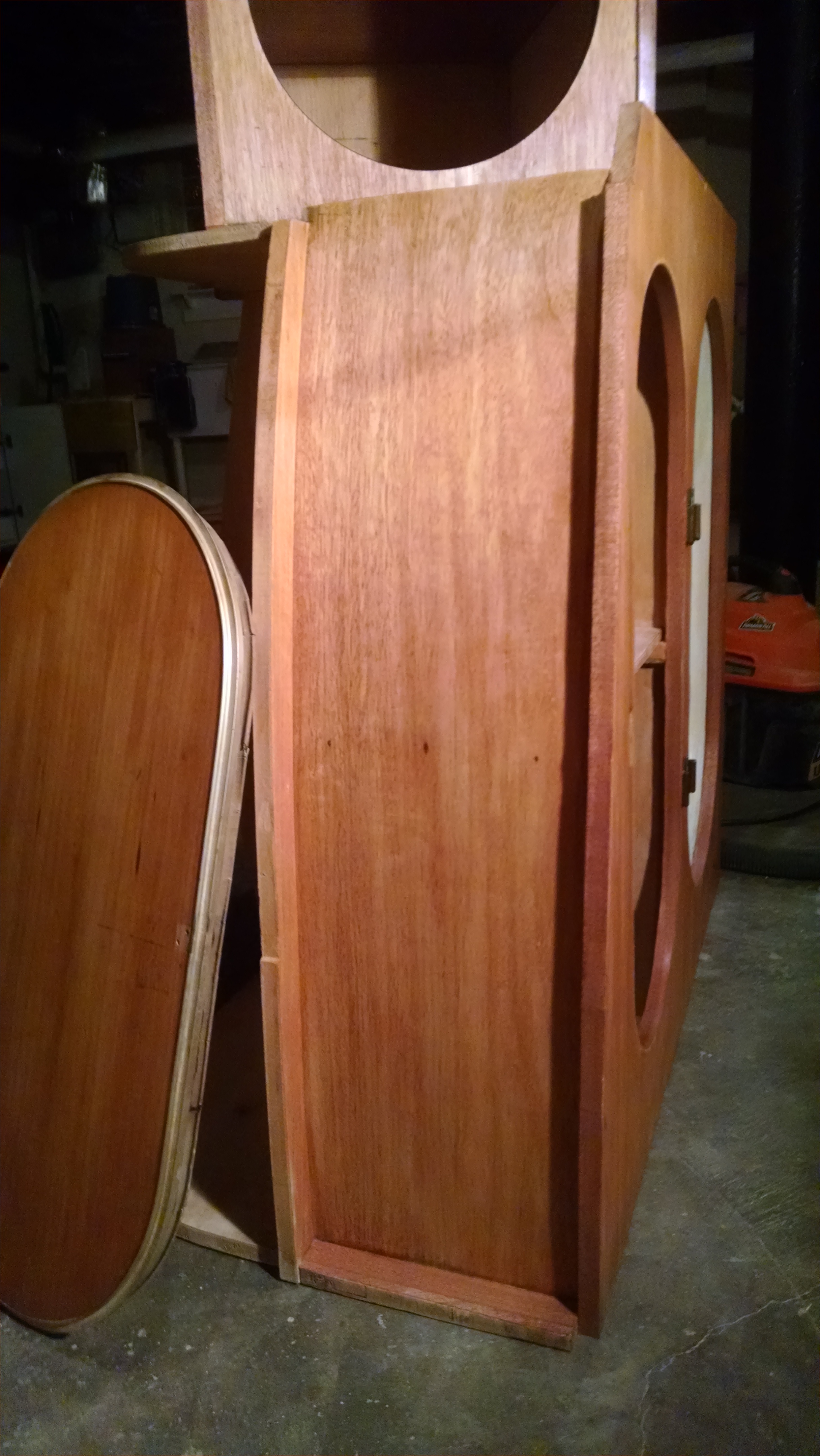

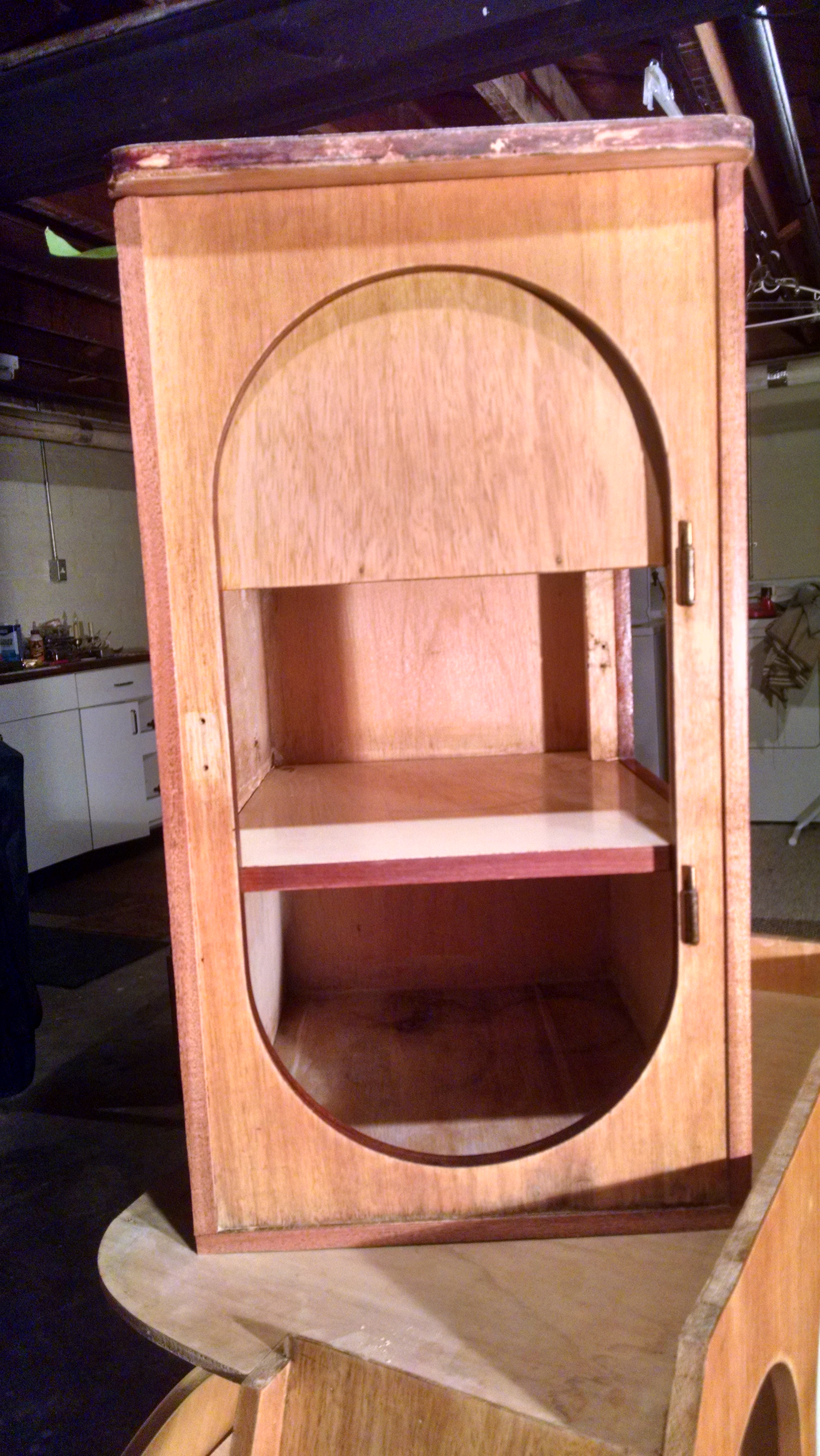

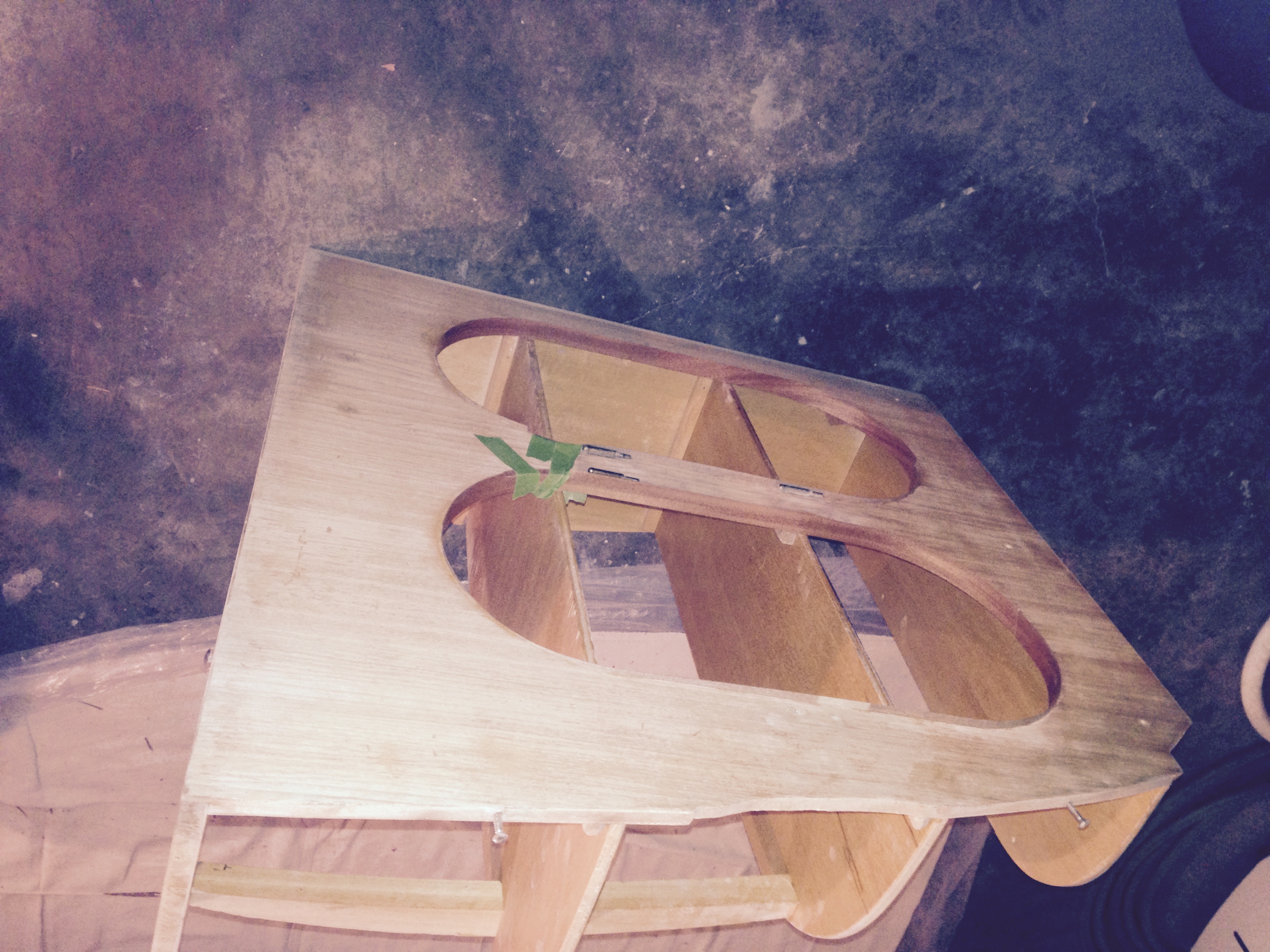

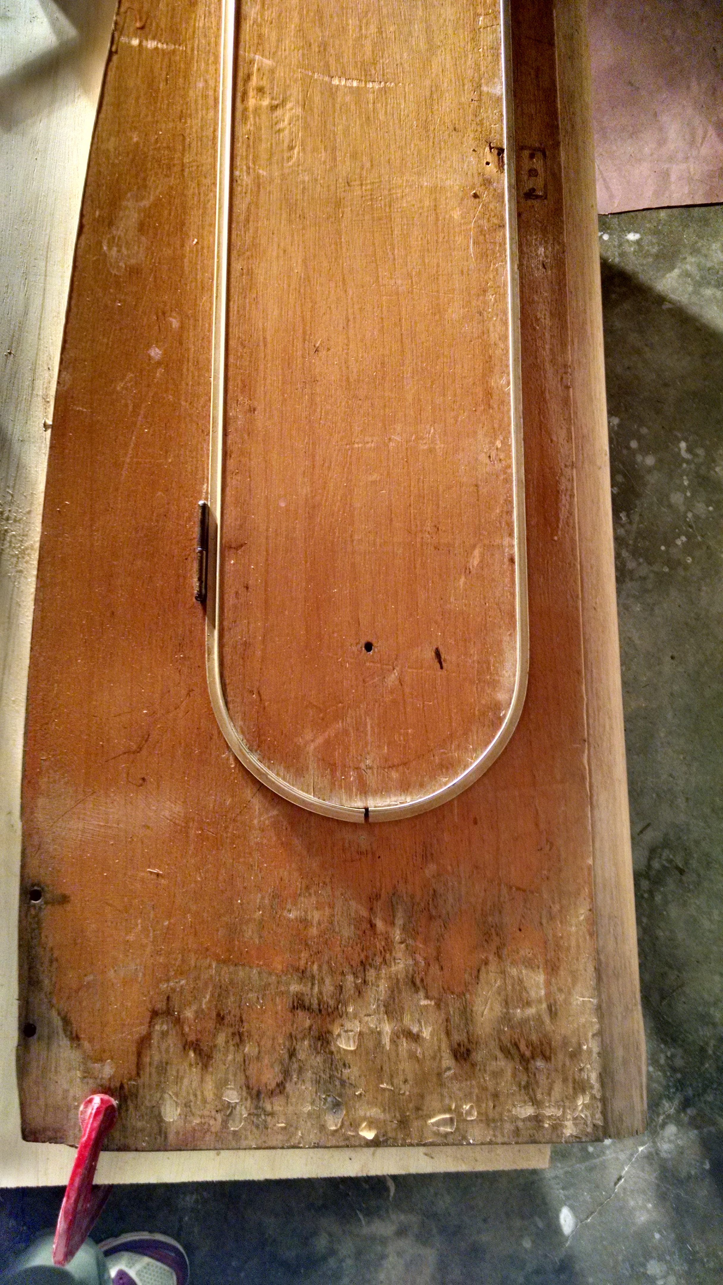

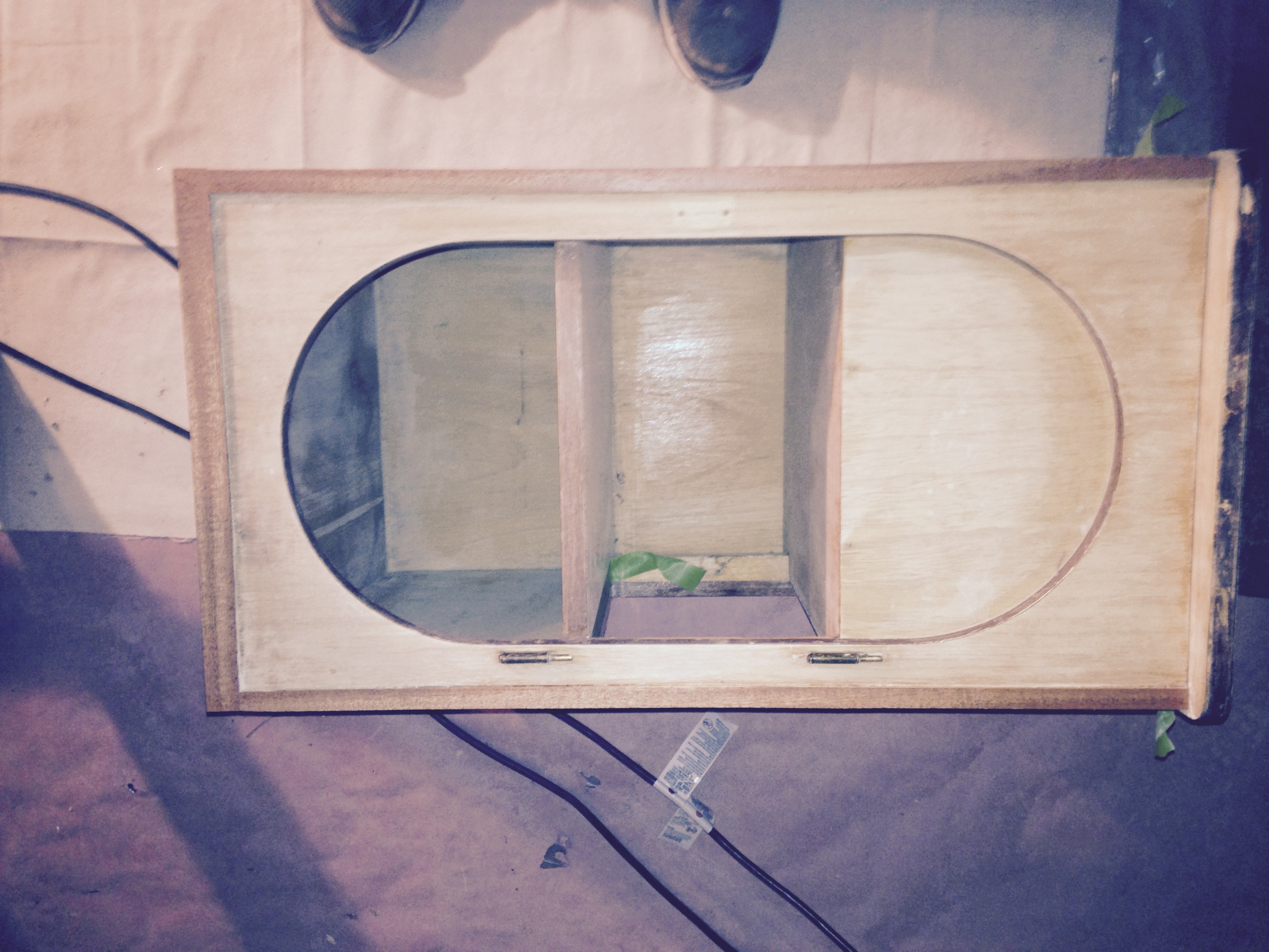

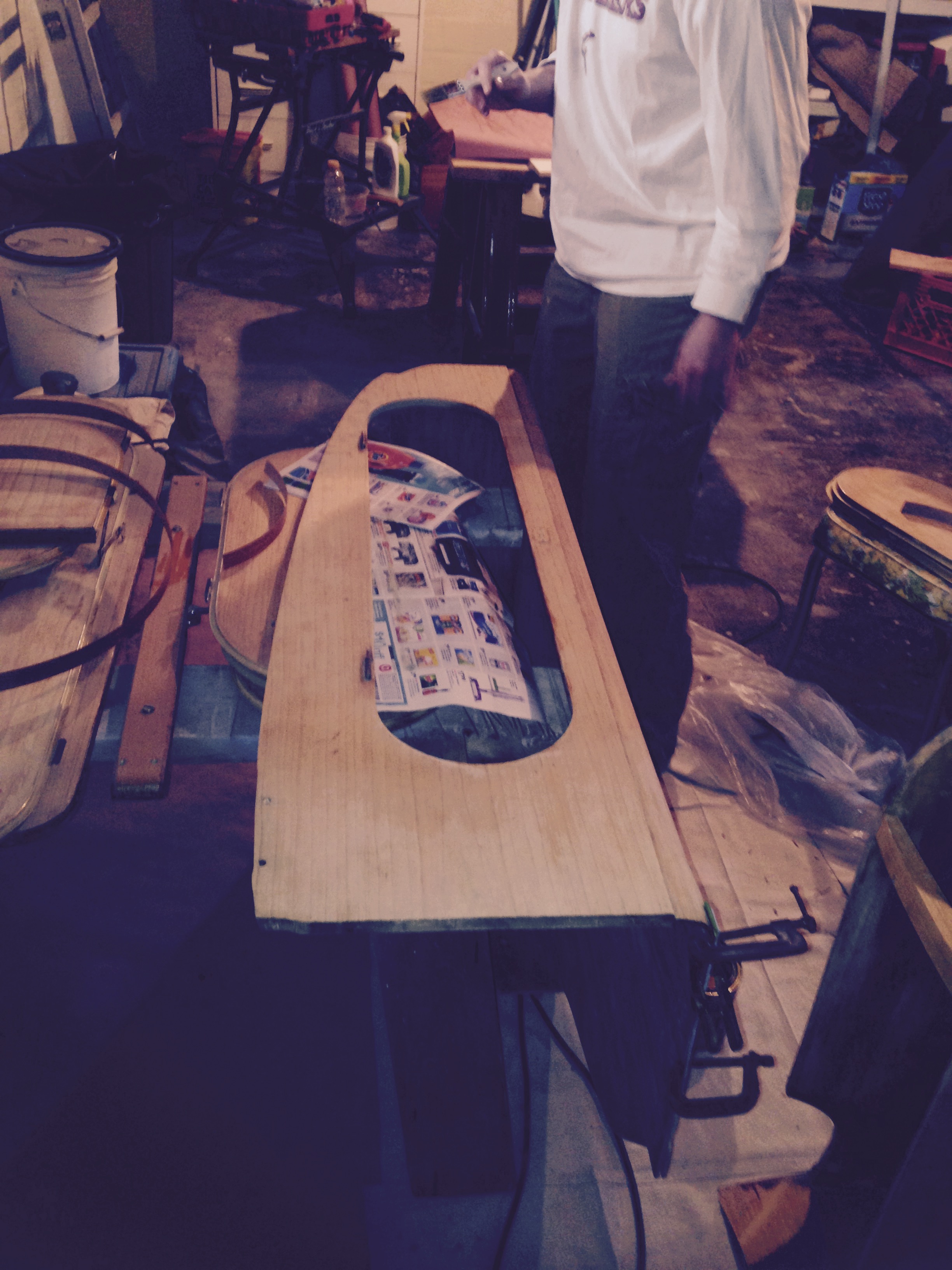

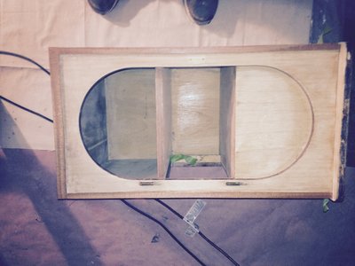

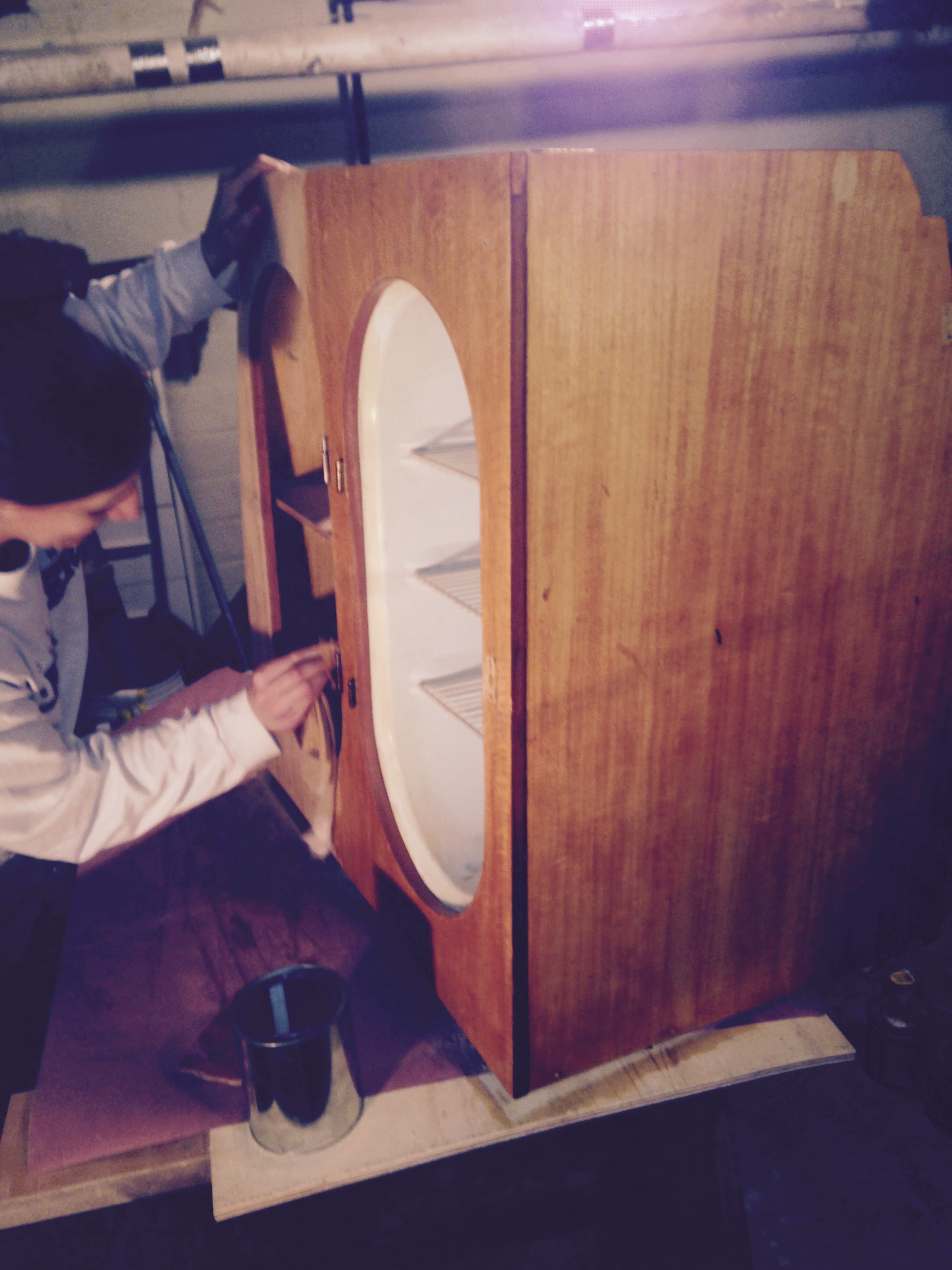

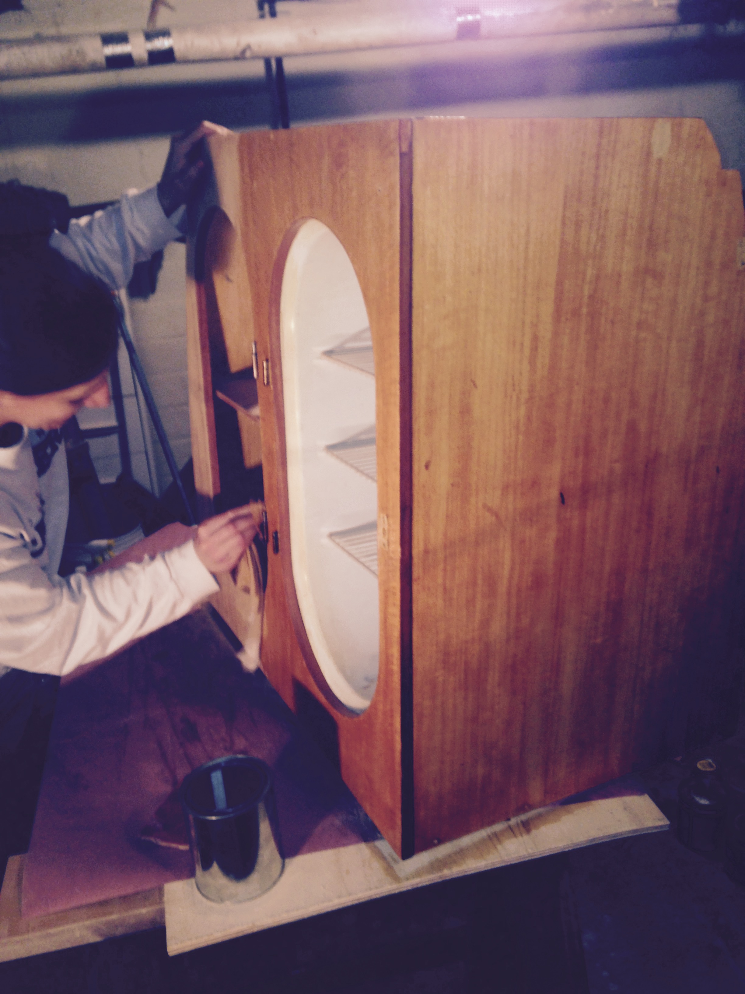

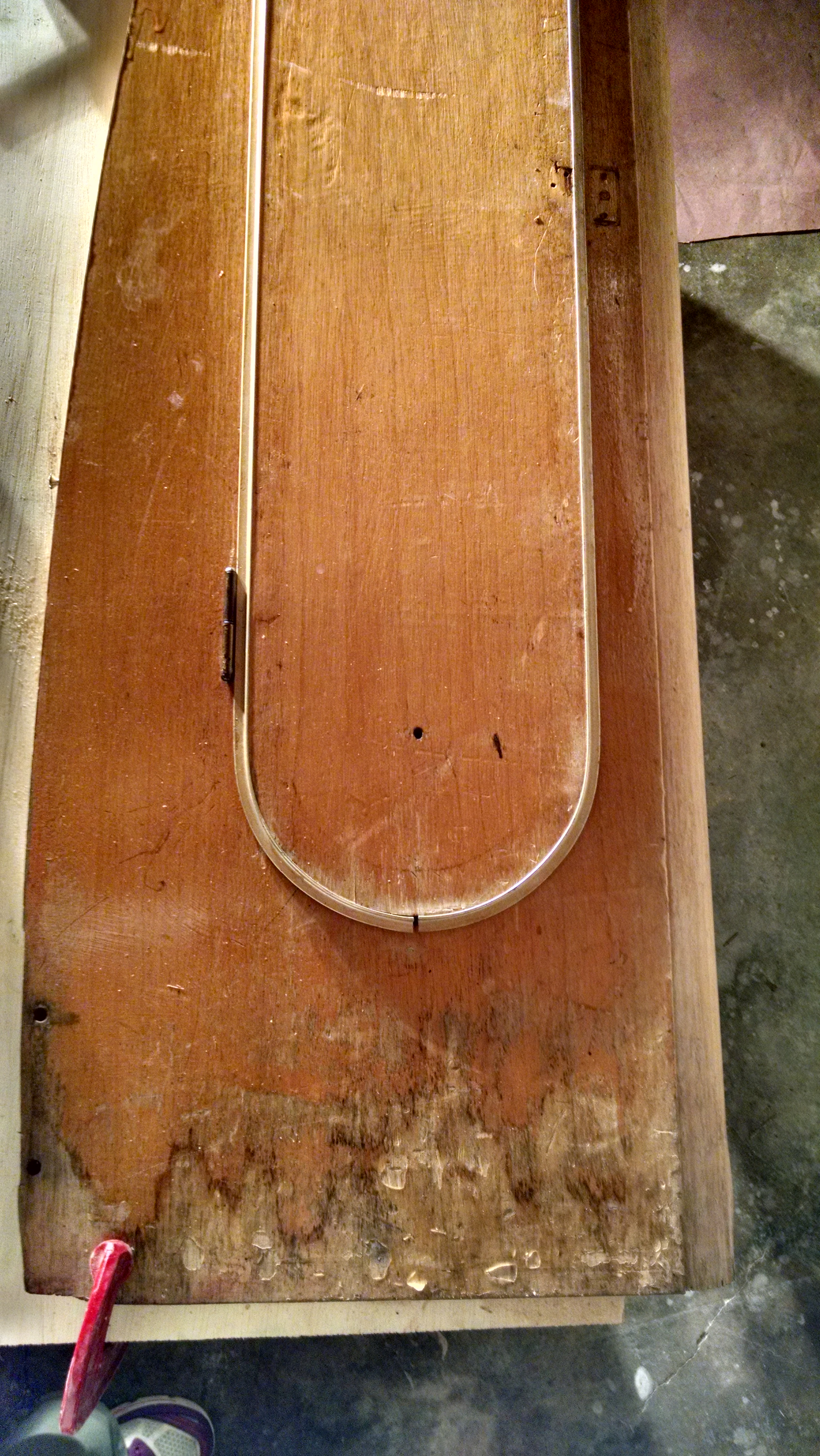

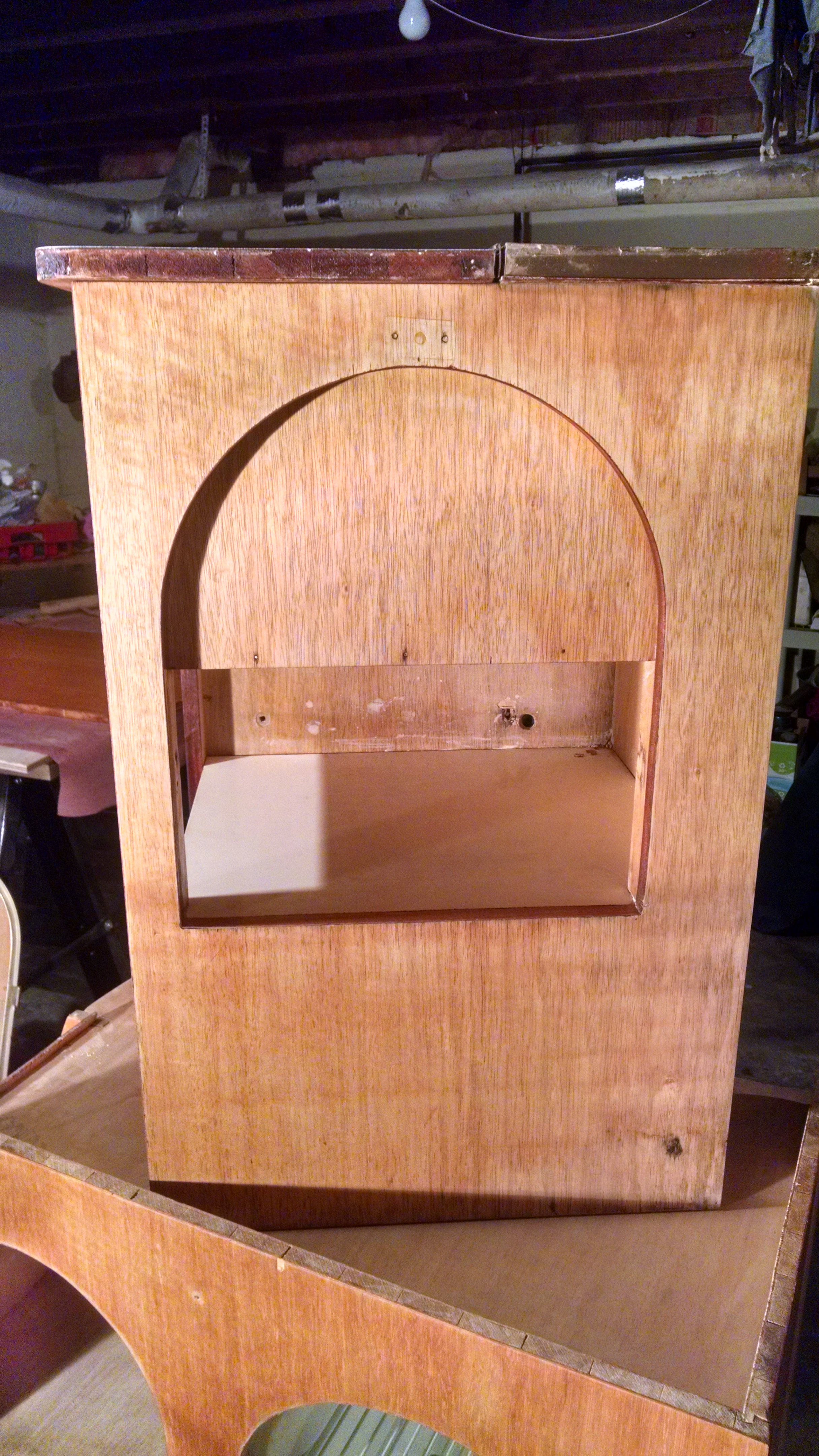

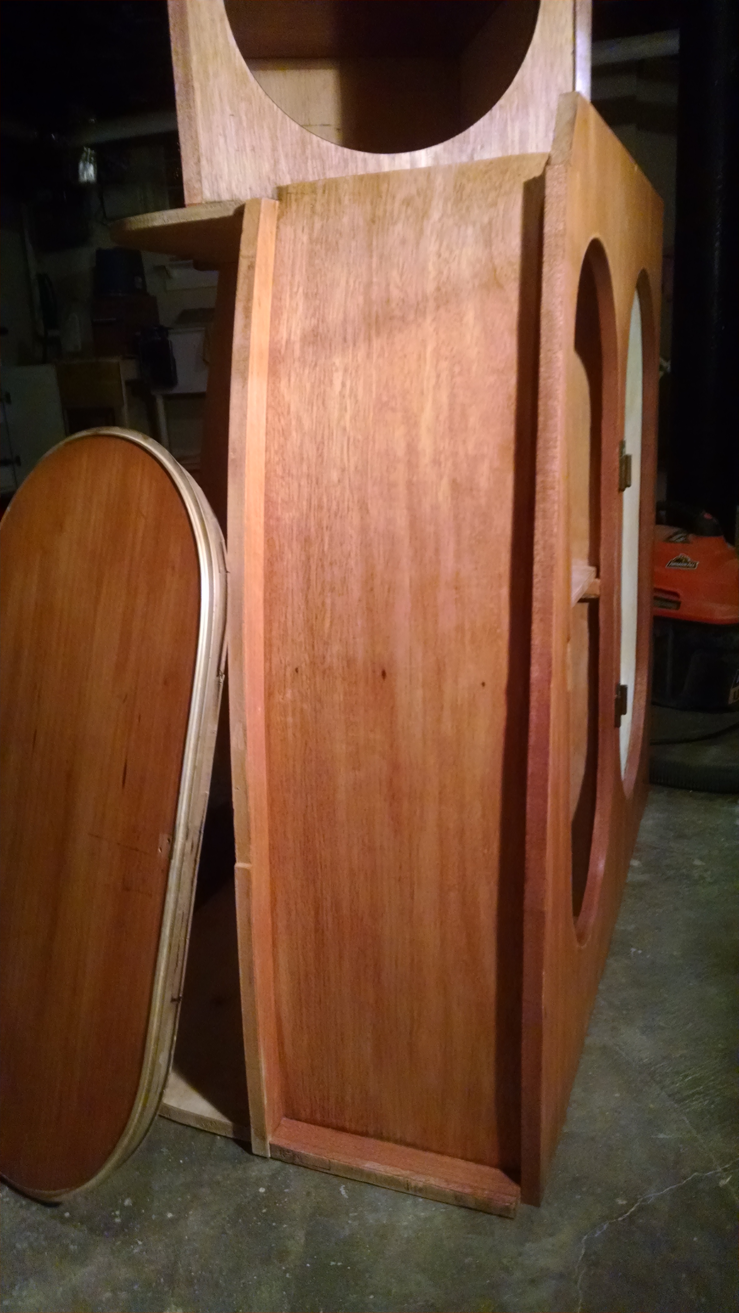

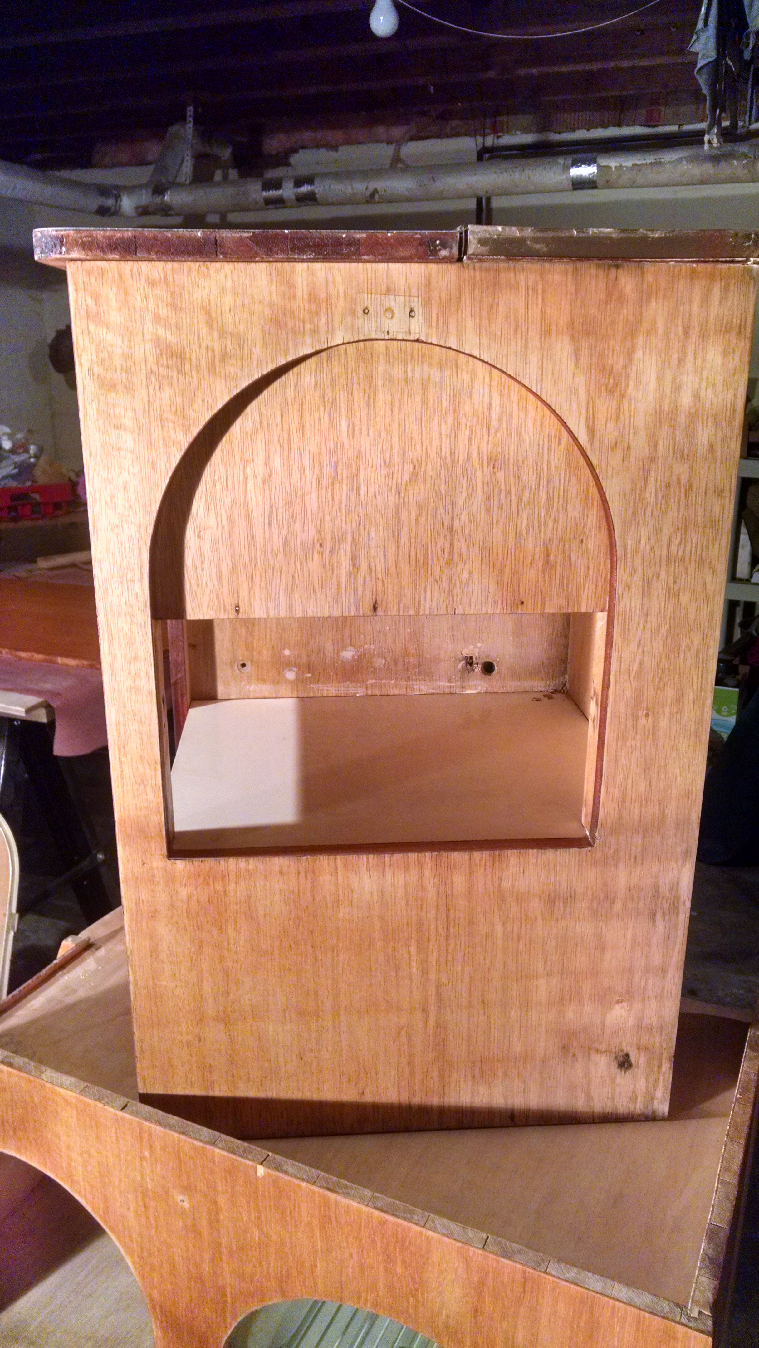

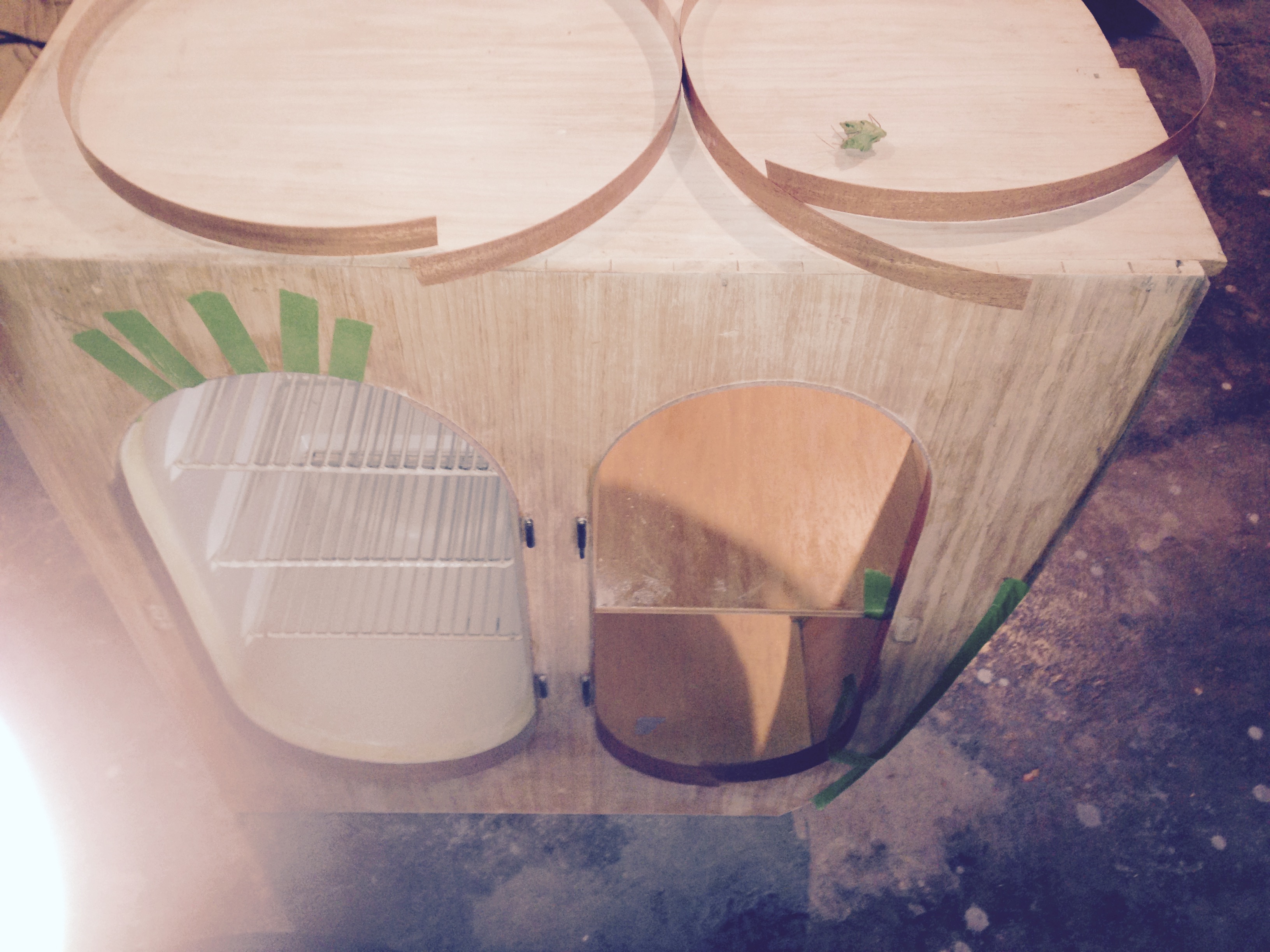

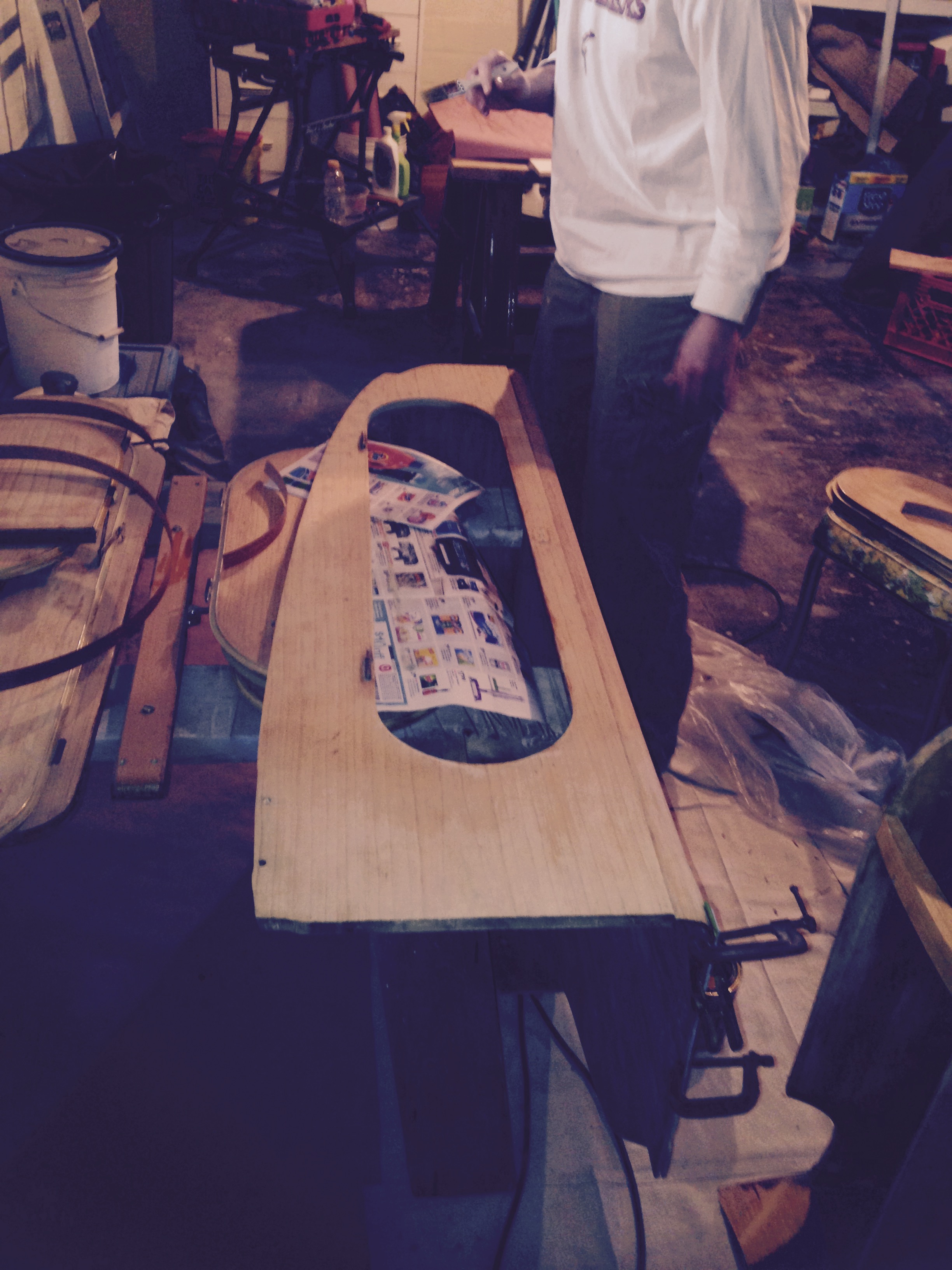

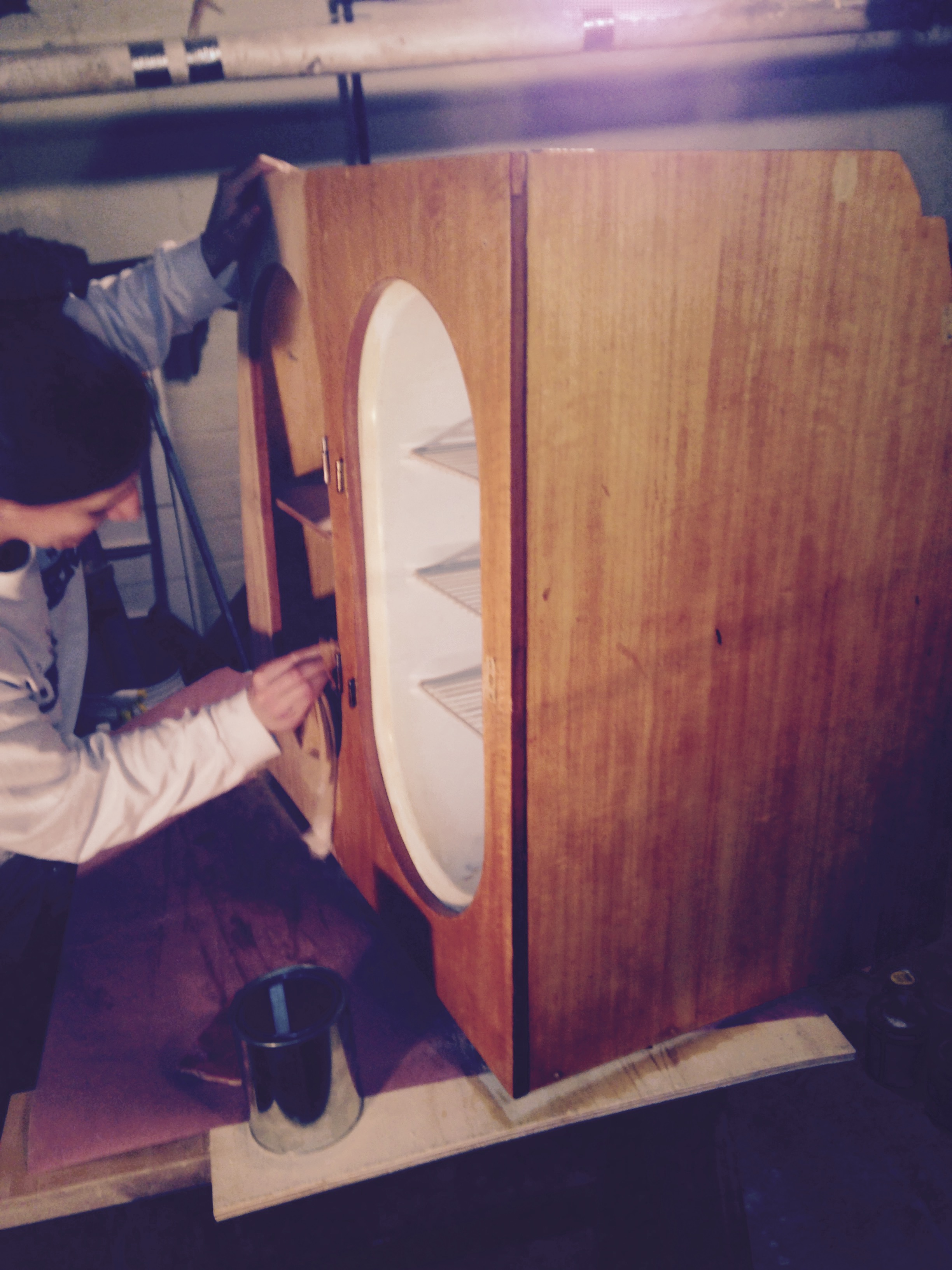

Here's an update on the cabinet work...
I finished stripping and sanding everything to get the clear coat off. Then I bleached out the areas where there was water stains and cleaned all of the mold off the bottoms and backs. I bought some edge banding and replaced it where it was either missing, or severely damaged keeping the original in as many areas as possible. I had some help with the installation of the edge banding because I had never done it before. I then put a coat of natural stain on everything (well, I will finish that tonight) to bring out the natural grain and color of the wood.
Here are some photos of the progress...
Reminder of the Wardrobe - Before (Main Reason for Starting This Little Project)
Wardrobe Stripped and Sanded
Installing Edge Banding
Edge Banding Trimmed
Staining Cooler Cabinet
Wash Basin Cabinet Facing Rear
Wash Basin Cabinet Facing Cargo Doors
Cooler Cabinet Facing Rear Hatch
