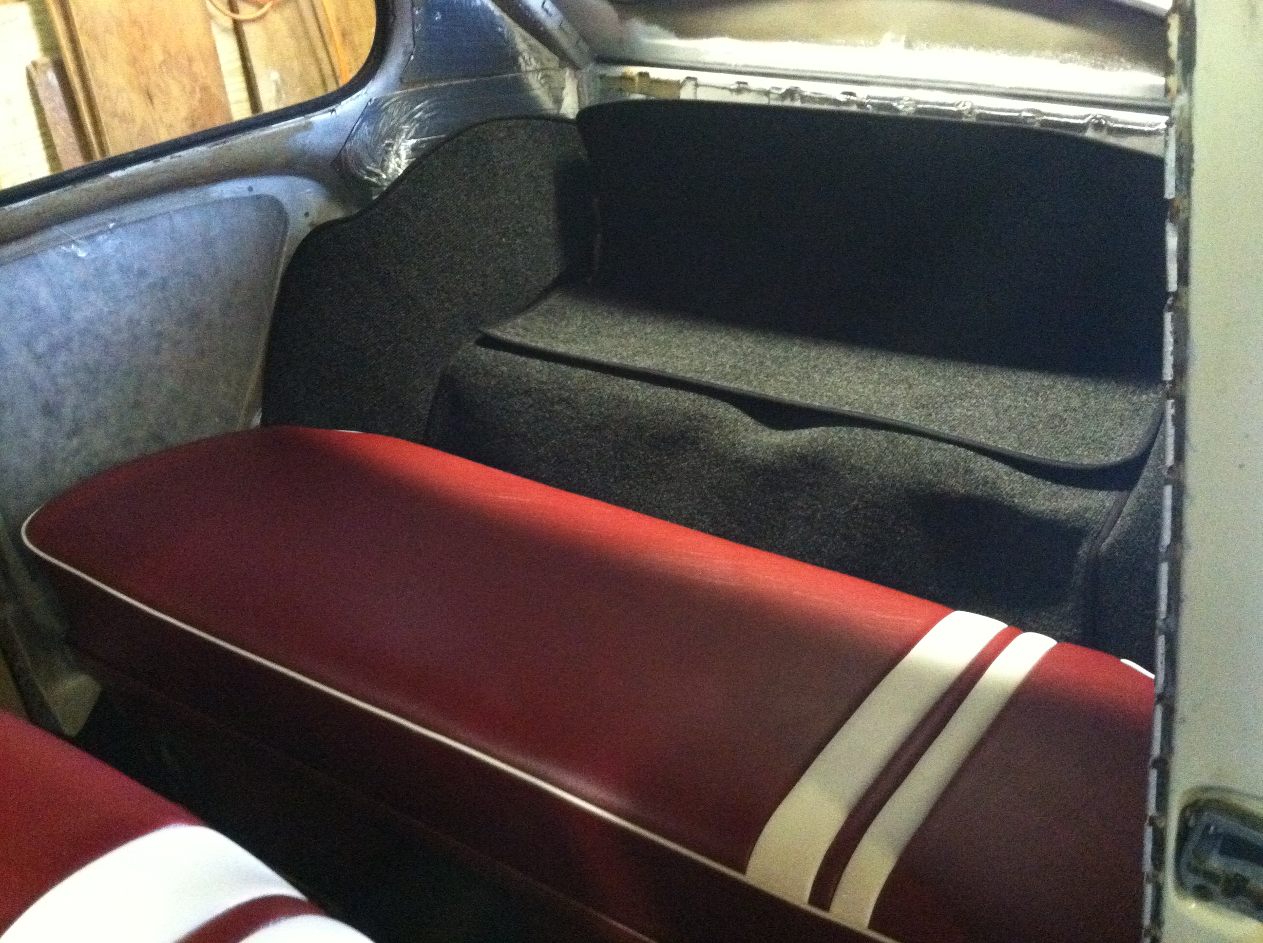

An update on the beetle. I've been cleaning everything I can get my hands on. I've replaced the rubber seals that don't involve taking the body or its parts off. Waiting on the rest of the interior to be made to button that up. Carpet is being installed on the back seat back and then door cards. Headliner and a 12V conversion is still on the list. At least I can drive it with the seats installed. Hope to make a trip to Berea to meet Bruce and see if we can hook it up. Can't wait to get on the road.....I can feel spring in the air, not really, it's still super cold out today.
12 volt conversion coming soon. Until then, tightened the belt and what a difference it made. Also went around and snugged up every bolt I could reach. The back carb bolt was loose, I could swear it runs better now its tight.
The seat back is being fitted with the carpet and new strap. Door cards still need to be made. Next is the headliner...not looking forward to that but getting some help from Russ Upholstery.
New seal around the hood and new carpet to replace the hard cardboard.
Newly upholstered seats from Russ Upholstery. Super sweet job.
