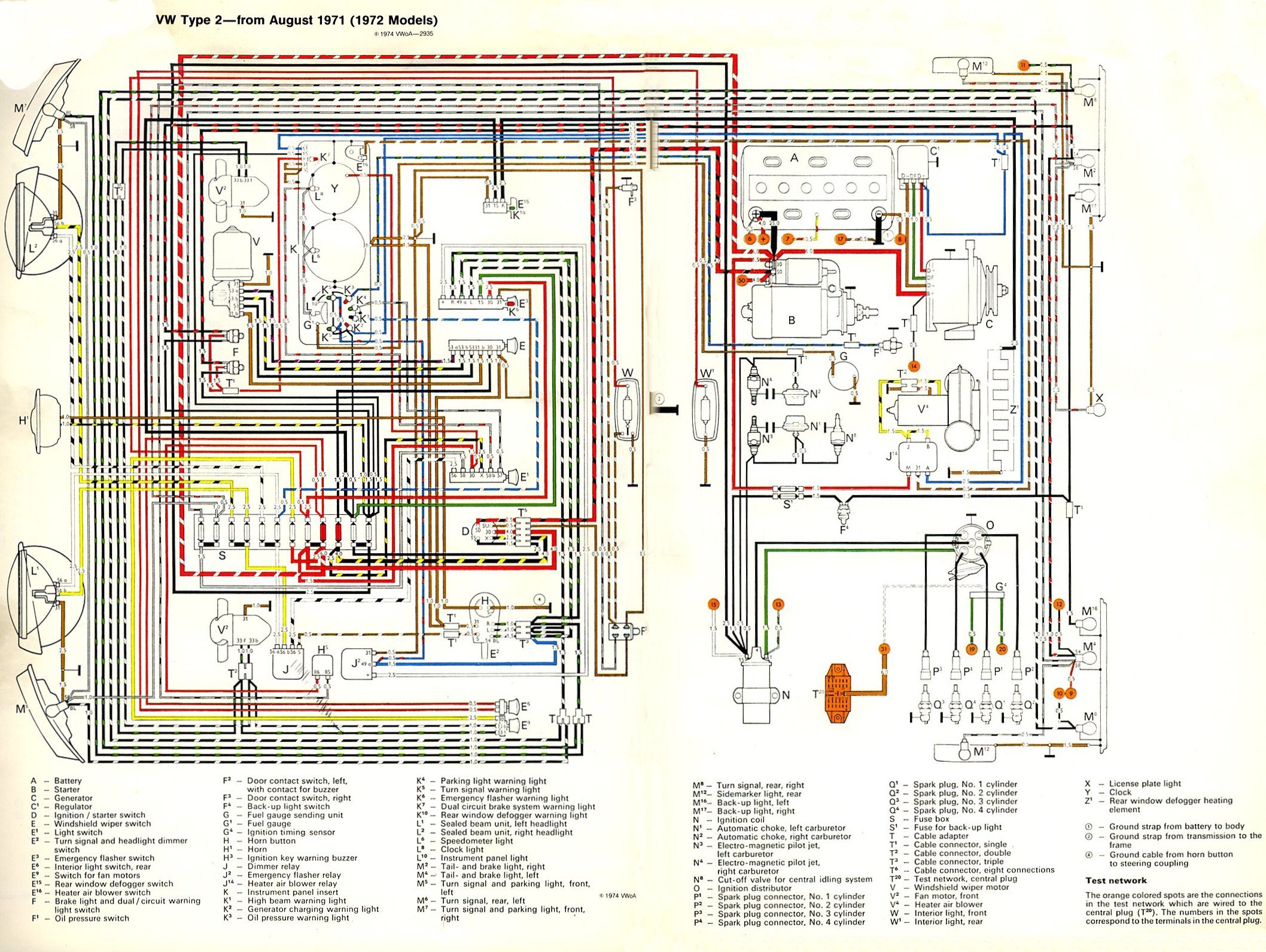

Which switch does your truck use? the one with a pigtail or the one that has blades for a connector? If it is the earlier with pigtails, use the 72 wiring diagram.

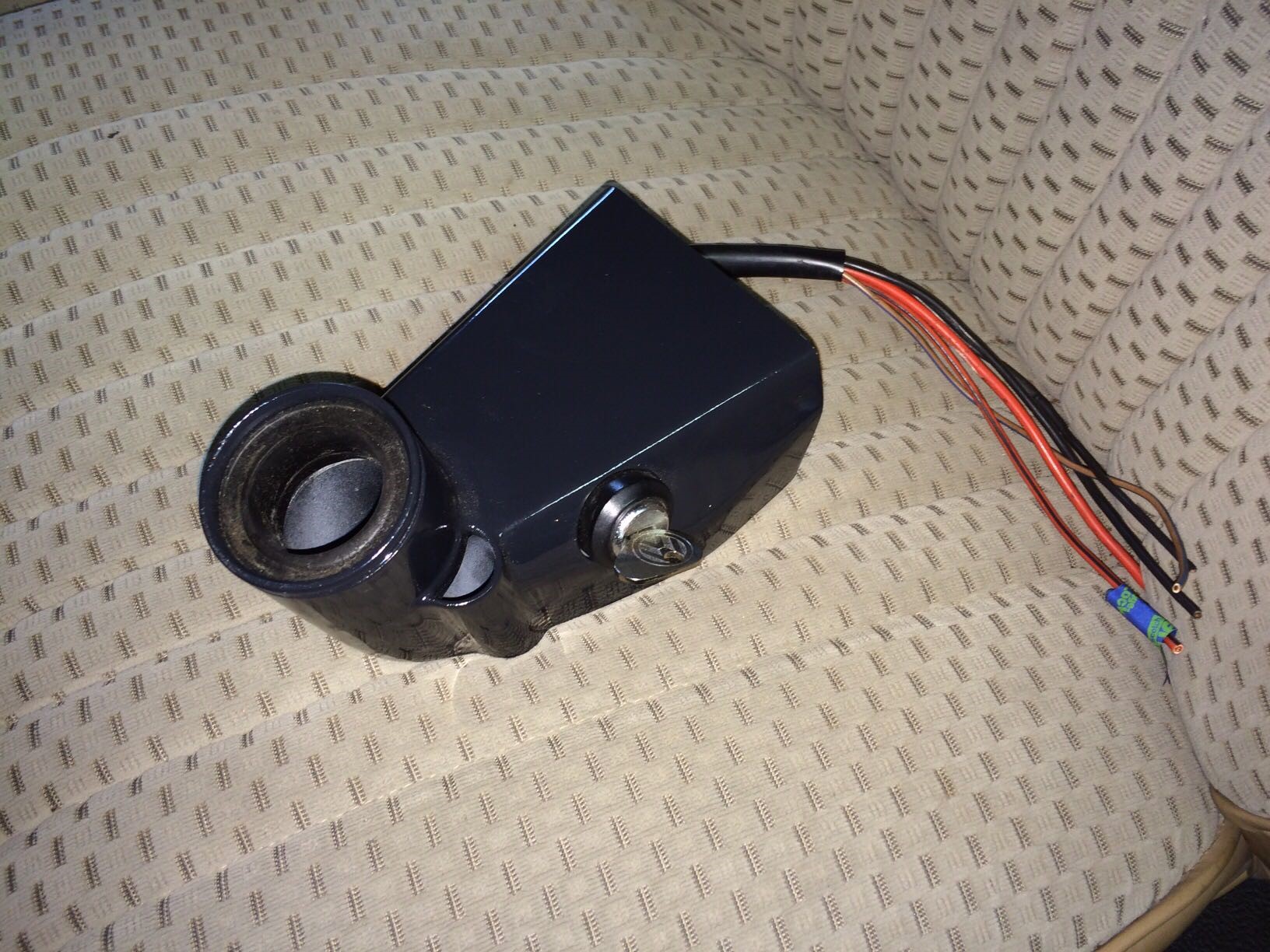

Posts: 245
Re: 1974 Double Cab Project
It uses the pigtail, the switch itself does not have any blade connectors. The wires are soldered directly to it. Below are some photos of it.

Posts: 906
Use this diagram
Click it for a big version
Posts: 3969
Is that the new switch in the housing or the original?
Posts: 245

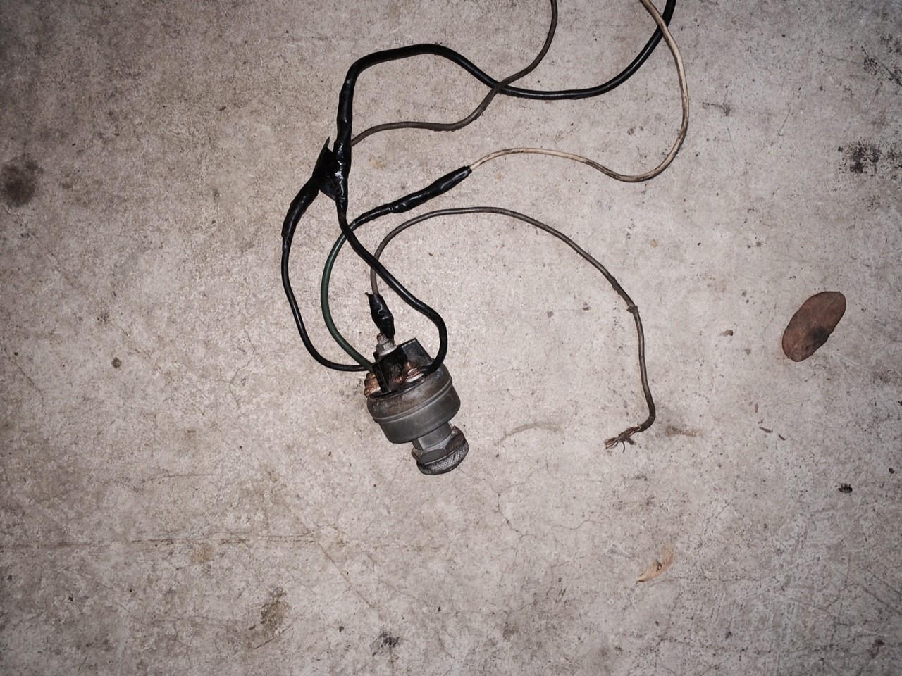

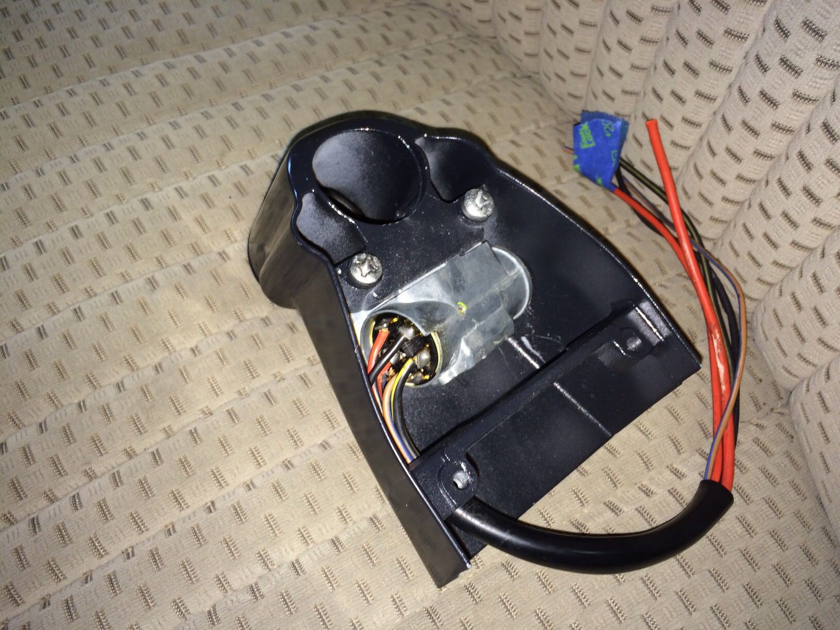

It is the new switch. The bus did not come with an original one. It looks like they removed the switch and then tried to get the ignition cylinder out by drilling holes in the housing. After that they gave up and mounted a generic three terminal switch on the dash (one terminal had 2 wires connected to it). Original wiring was nowhere to be found. Have been piecing together correct colored wires from old harnesses I have salvaged from other buses.

Ignition housing the bus came with.

Ignition switch that had been mounted on the dash.

Toolbox, thanks for the wiring diagram. It seems to more closely follow what I am seeing in the remnants of the bus's wiring after I have removed the add ons and splices. Though the wiper switch is mounted on the steering column and there is an 8 terminal connector that some of the wires go to. It definetly solves the mystery of where the brown/ blue wire goes. I guess the differences are because it was a non US model?
Posts: 906
Rob wrote:Toolbox, thanks for the wiring diagram. It seems to more closely follow what I am seeing in the remnants of the bus's wiring after I have removed the add ons and splices. Though the wiper switch is mounted on the steering column and there is an 8 terminal connector that some of the wires go to. It definetly solves the mystery of where the brown/ blue wire goes. I guess the differences are because it was a non US model?
Probably need to use both diagrams to figure it out.

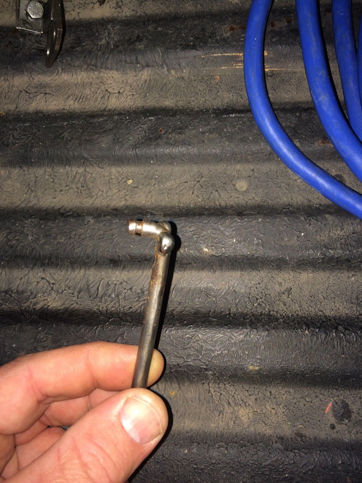

Still piecing back together the wiring. Currently waiting on a few parts to come in namely a headlight switch and a emergency flasher switch before finishing with that. In the meantime I have been cleaning and painting the foot pedals, e-brake arm, gear shift, steering column bracket etc... Also the gas pedal was pretty sloppy and would occasionally stick. Taking that apart I found some curious welding work. Now I know why they did it, to keep the pedal rod from going through the elongated hole, but they had to have known what it ended up looking like. I just could not drive around knowing that was under my foot :o
Picture speaks for itself
Elongated hole in the pedal
After castration
After castration
