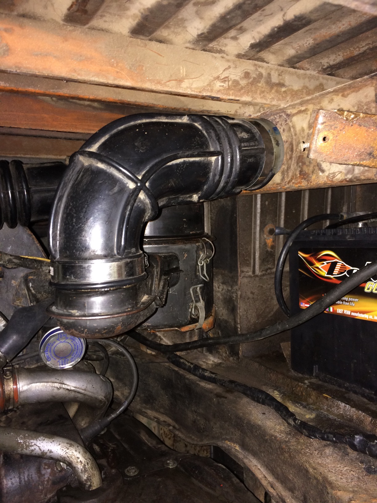

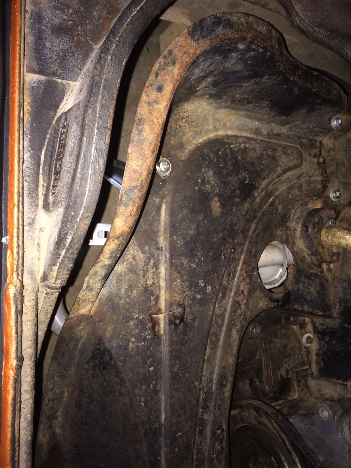

Here is the air cleaner reinstalled with it's new/used clips and flap. The breather hose to the oil filler neck was missing and the closest one I could find at the local auto parts store was this radiator hose. The original must has been preformed with a bend in it. It has to make such a sharp turn at the fan shroud hose outlet that it kinks, so still looking for another solution there.

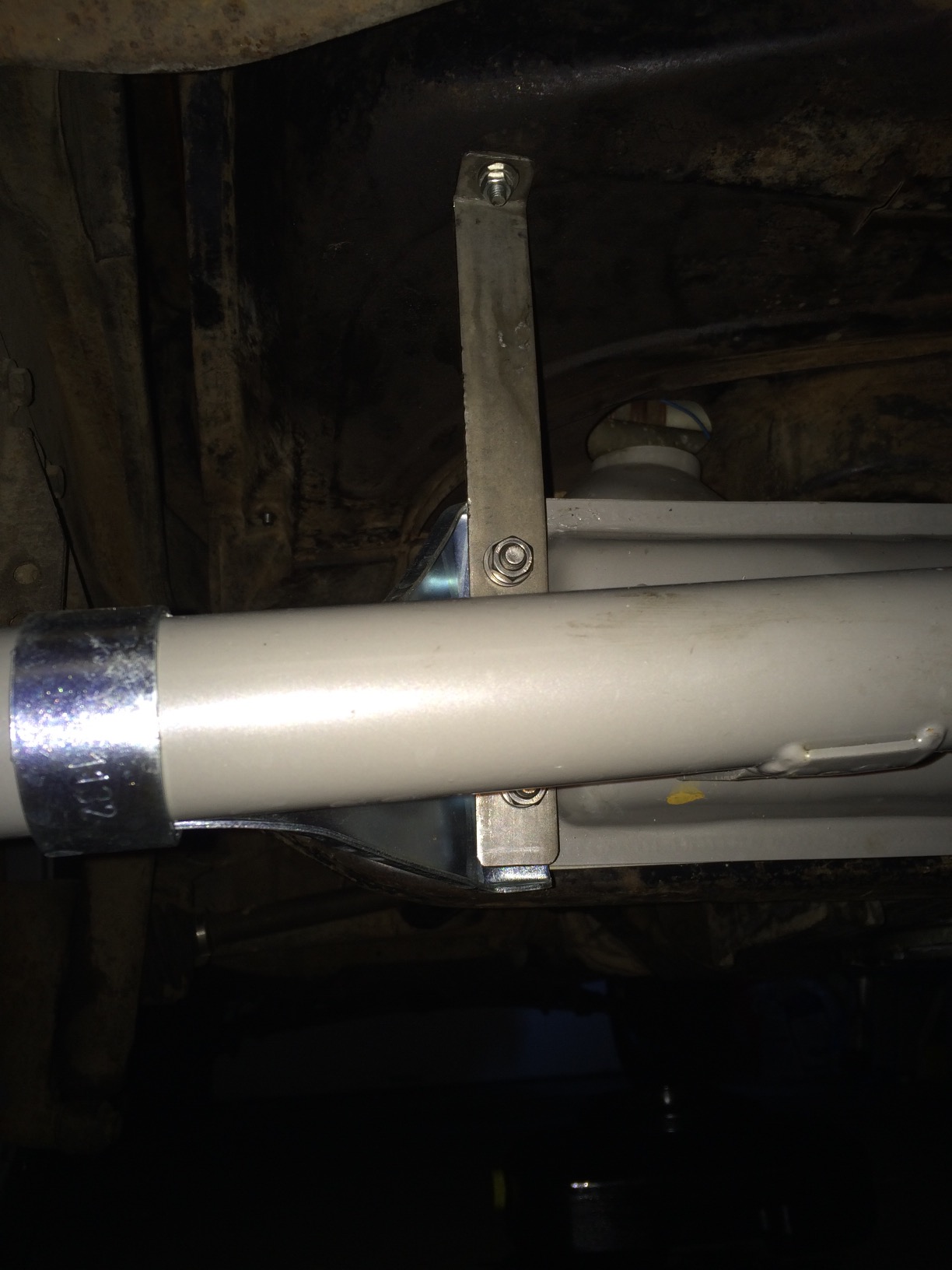

I worked on the engine this weekend, replaced the vacuum canister on the distributor, replaced and adjusted the points, replaced the spark plugs and plug wires. Replaced five of the studs for the oil drain plate. Waiting on a new metal fuel line to come in, currently it has a soft fuel line coming through the tin into the compartment. Repaired several wires to the coil, carb and alternator. Also replaced all the missing screws in the engine tin, it only had about half installed. I noticed that the large breastplate had trouble holding itself up level with the lip in the engine bay that the foam seal attaches to. At first I thought maybe the foam seal helps hold it up but that would still put a lot of stress on the tin and there is some stress cracking evident from years of flopping around. I found some additional holes that must have had brackets going to them and they lined up with the corners of the muffler. Searching online I could not find any photos online to confirm the actual existence of the brackets. At any rate I fabricated some simple brackets, used the tailpipe bracket bolt holding slots to attach them too and it seems to work well. My guess is when they made the muffler they did not reinstall the original brackets as the homemade muffler had nowhere to attach them too.
