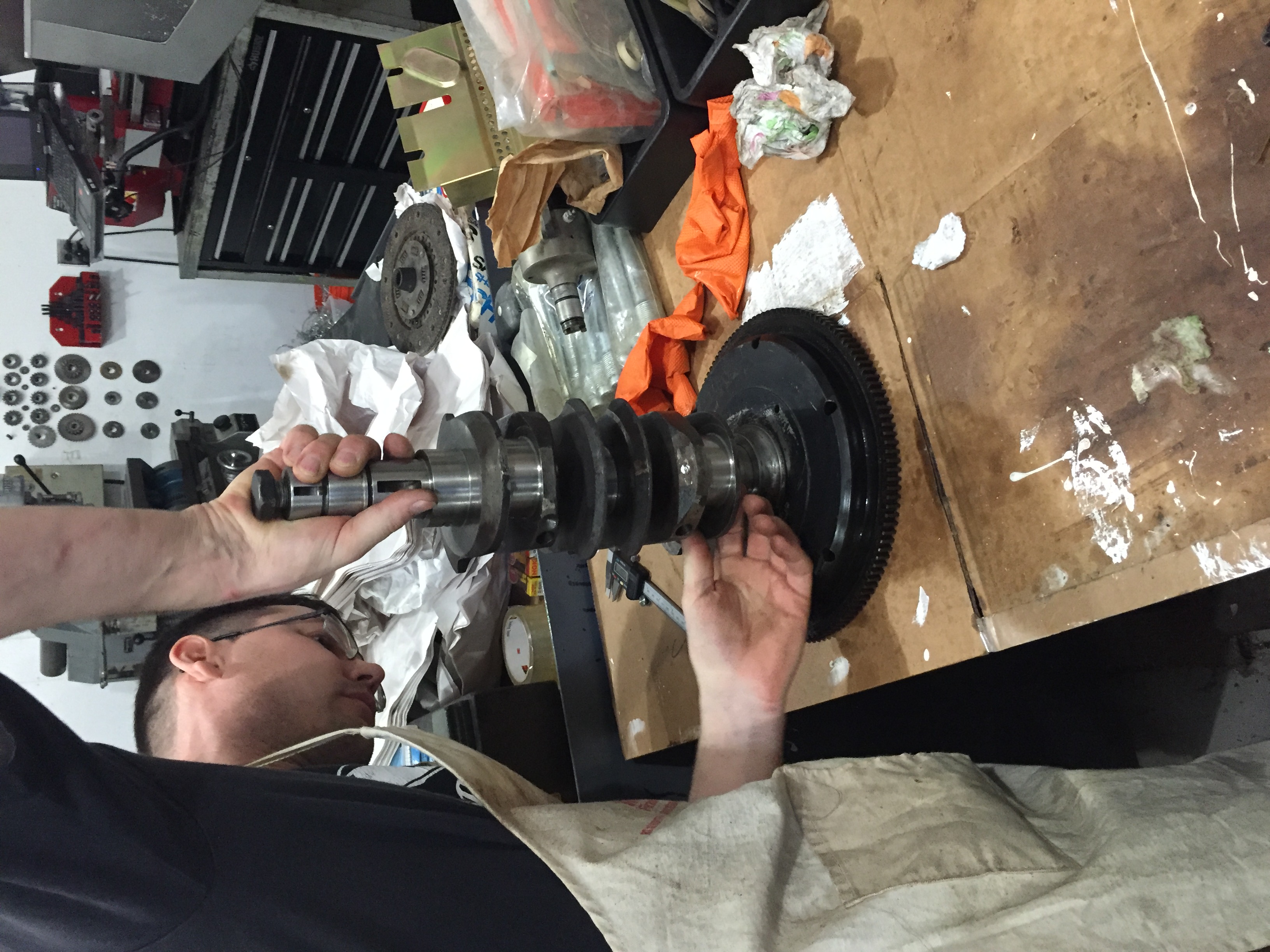

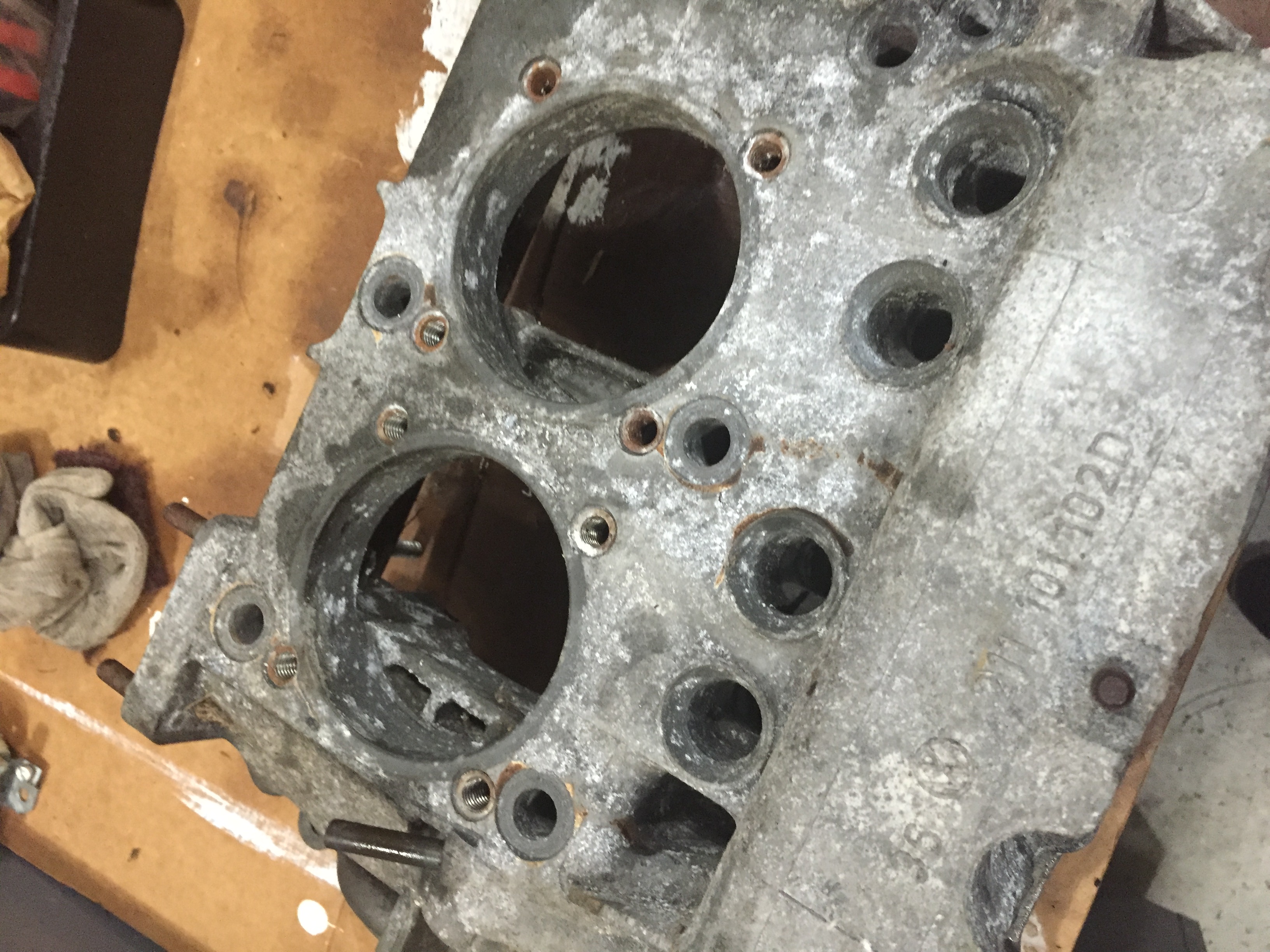

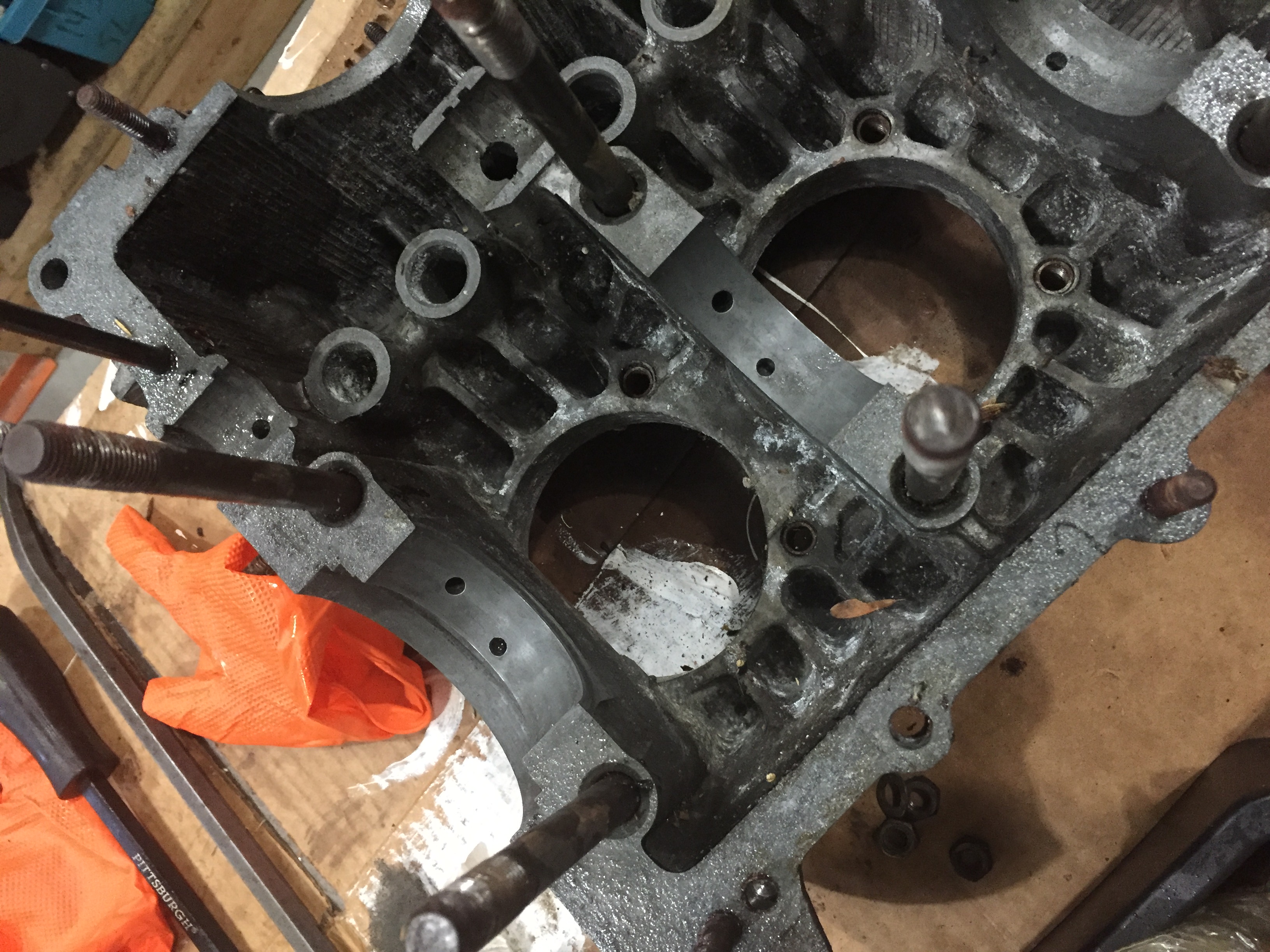

a friend and I went to rescue some VW parts from a garage in Ashland today. The start of a new engine for the beetle starts today. Heads, case, rods and lots of assorted parts to start the journey to a fresh build.
Re: Trailmix Beetle
Look at you go.
If that case checks out, I would build that in to your "daily driver" motor. Pull the one that's in there now, throw it on a shelf, and use that as your "back up"
Ashland is a lot closer than Ontario, if I recall correctly.
Nice find Keith. I think you will find, that's how things usually work In The VW world ;)
Re: Trailmix Beetle
If that's your crank on the table,it looks like a counterweighted one :) sweet.
Posts: 1383
Re: Trailmix Beetle

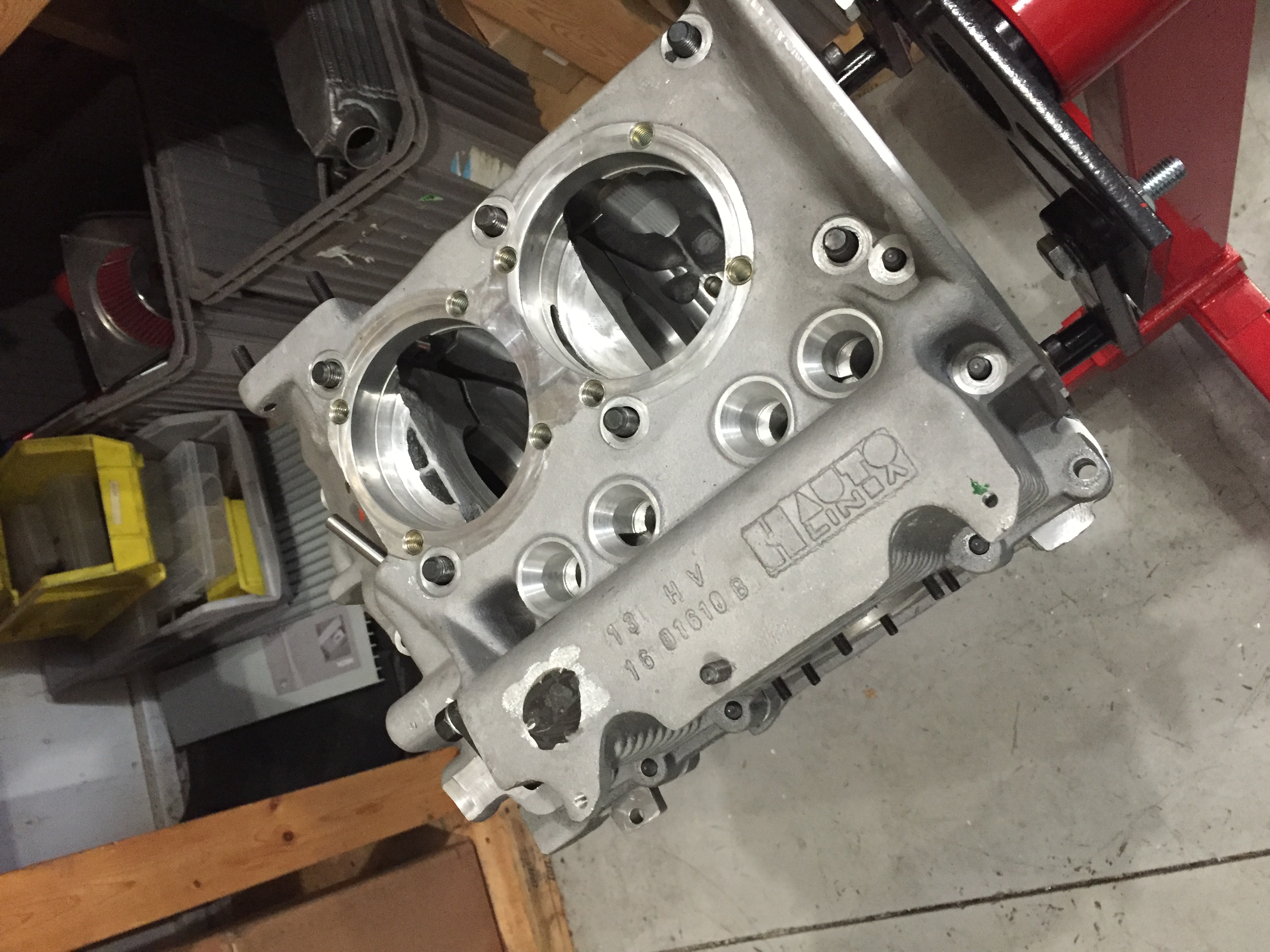

The rear main on that case looks nice, no wear visible in the pic. WTF! How come you didn't have to massacre 4 motors like I did to find one!
Looks good, have you decided on what's going inside? Stock 1600 or something fun?

Actually, we're not exactly sure what to use yet except the heads. The two German cases are in excellent shape and the one is checking out to be a rare find.
He may sell a lot of the parts on the Samba in favor of gathering better ones new but the parts are in super good shape.
Mild daily driver is the focus.

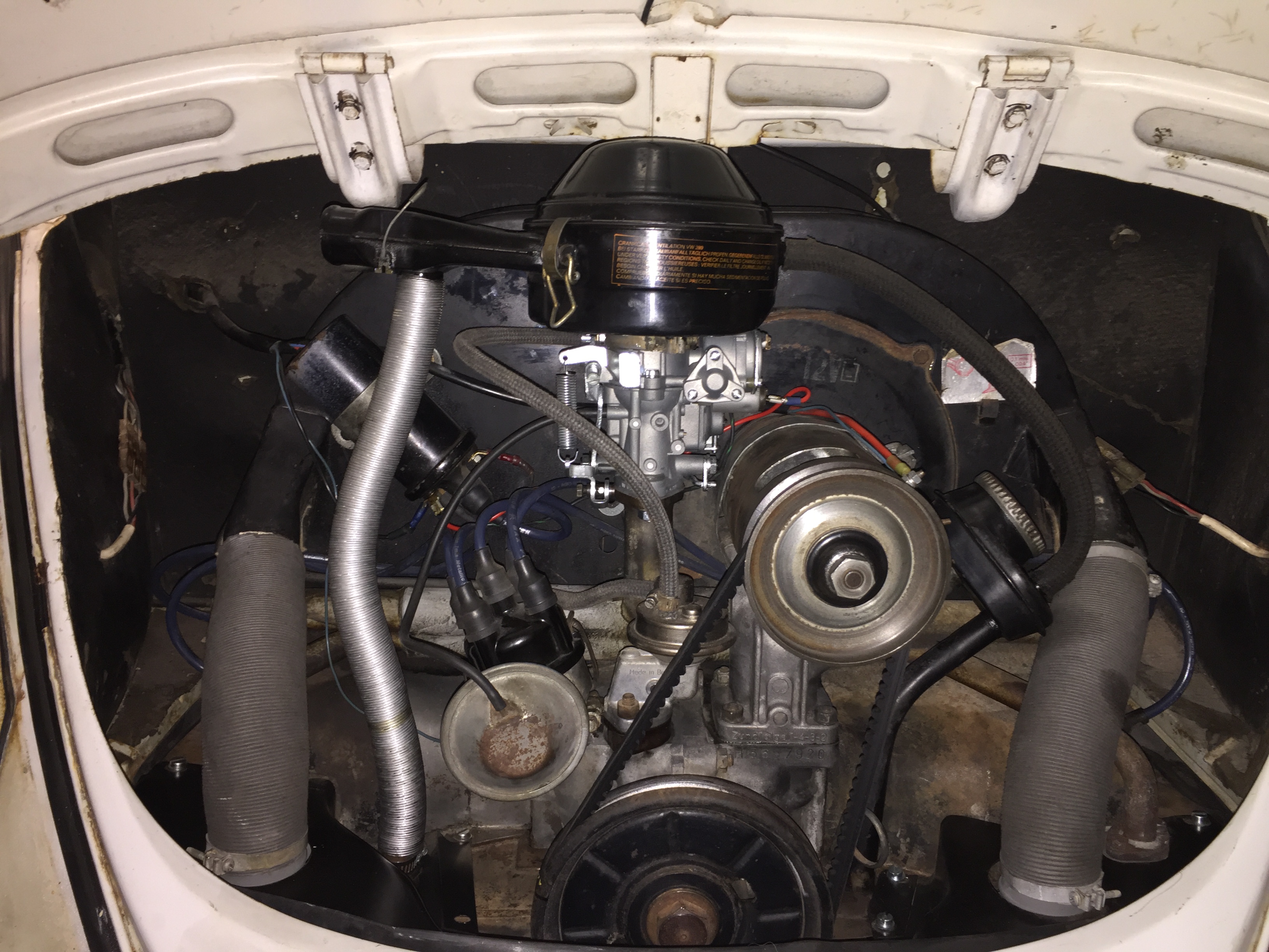

I learned a lot about super high performance VW power today. The pic of the case is NOT mine! The pic of the engine bay is my current set up.
Re: Trailmix Beetle
Do yourself a favor and get rid of that braided fuel line.
I have some of the correct line in small quantities.

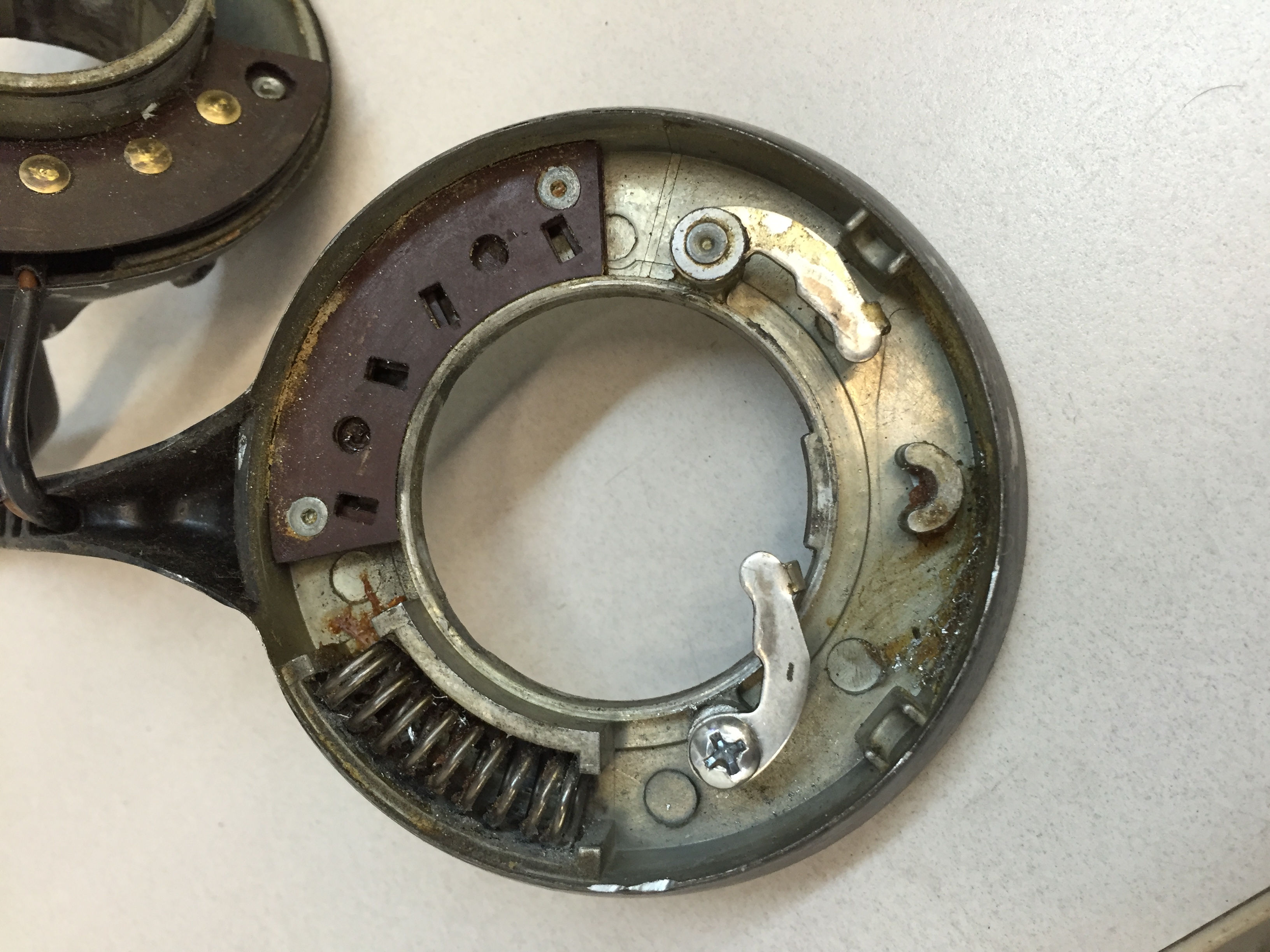

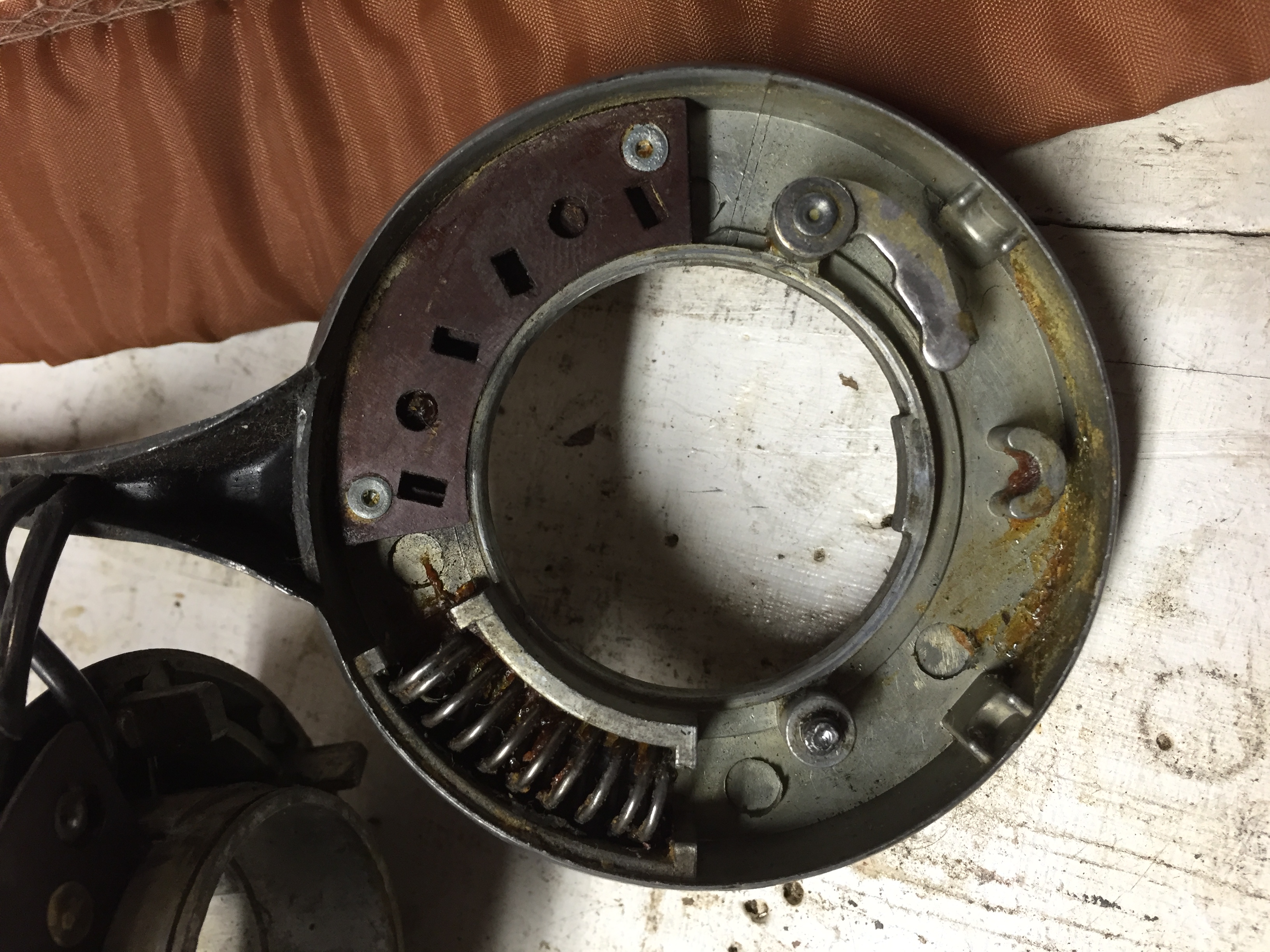

Working on the steering column today with a steering wheel resto and wanted to fix or replace the headlight dimmer switch. After watching a few videos, I thought I had it down pretty good. Well I did but it seems that mine is a little different. I got it apart and was mocking up the reassemble to make sure I knew where everything goes. I guess I moved everything a little too much and broke off the left arm that holds a spring connected to the right arm. Well, it seems there is no fixing it unless someone has a brilliant idea. These assemblies are VERY expensive and buying one right now is not in the cards. I'm looking for some help.
It's the post that is on the bottom left of the pic. The one on the right has an arm attached to it. It's riveted on.
Re: Trailmix Beetle
Call me and/or bring it over this weekend if you have time. I can see if I have anything in my pile, or we can see what we can do to make it work until such time that a new assembly is in the cards.

Hey Now! Bruce gave me a call and invited me to his VW kingdom to check out my problem. Talk about service. Thanks Mike for the offer as well. You guys are super awesome.
It didn't look good because there wasn't enough of the pot metal post to do anything with. So the decision was made to grind the post down to drill and tap for a screw. All went very well and Bruce saved the day. I will continue to resto the rest of the switch cluster and steering wheel and reassemble tomorrow.
The pic is what it looks like now. I don't think the screw head is going to be in the way of anything. It is very solid and will hopefully last a long time.
