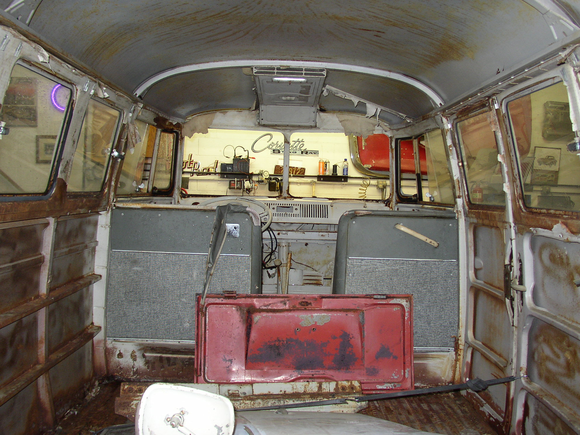

Probably a restoration, stock height, kind of a shame since it's got nice patina (if you're a patina guy). SWR/BeigeGray, just what LO needs, another frigging red/white split. Will probably lose the Porch disc brakes (seller says) but it looks Bay to me with BJs. Supposedly those are Porch wheels, too. Was on Samba in New Castle, PA, listed Thursday night, I was the first to call. A Texas bus with a Texas title, it still needs rockers and outer floors. Roof has surface rust but no rot. Missing lots of parts but still a very restorable bus, better than most and better than my '66 was. Super nice nose and inner/outer front valance are solid. Seller threw in an extra driver's door since that one is bent right by the handle, not an easy fix. Door appears to be early icepick and I don't think they interchange. Engine lid looks perfect. Mild sideswipe on the left side but not major, overall a very straight bus. Motor is supposedly original to the bus, an H case that's been sitting outside uncovered. :roll: Sounds like I'll be cutting more jugs and rods getting that one apart. Big nut has the input shaft loose falling out so it's probably junk, too.
Missing:
Rear torsion bars (found, I think)
Rear spring plates
Front axle assy(?)
All seats

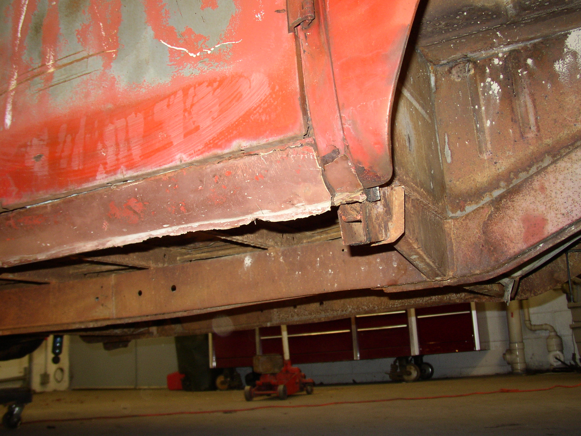

This bus is on my “To Do” list with very little time this year dedicated to it. I’ve been hitting the swap meets pretty hard getting parts assembled for it, and have little to show for actual progress. I thought I’d post this up more to inspire me that show you:
Jack it up, pull the PO’s casters off, and start cleaning the rear undercarriage. The Texas baked on crud is the most durable material I’ve ever dealt with. It has taken an air chisel to get through some of, it’s been baked so hard and so long. The good news is once the crud is chiseled off much of the original paint is there and no rust.
Bought these last winter in FL:
Step 1 is to get the suspension on it so I can roll it outside and sandblast the bottom and weld areas. I’ll rent a commercial compressor to power my blasters.
Wide Five helped me out with the torsions, which were missing:
