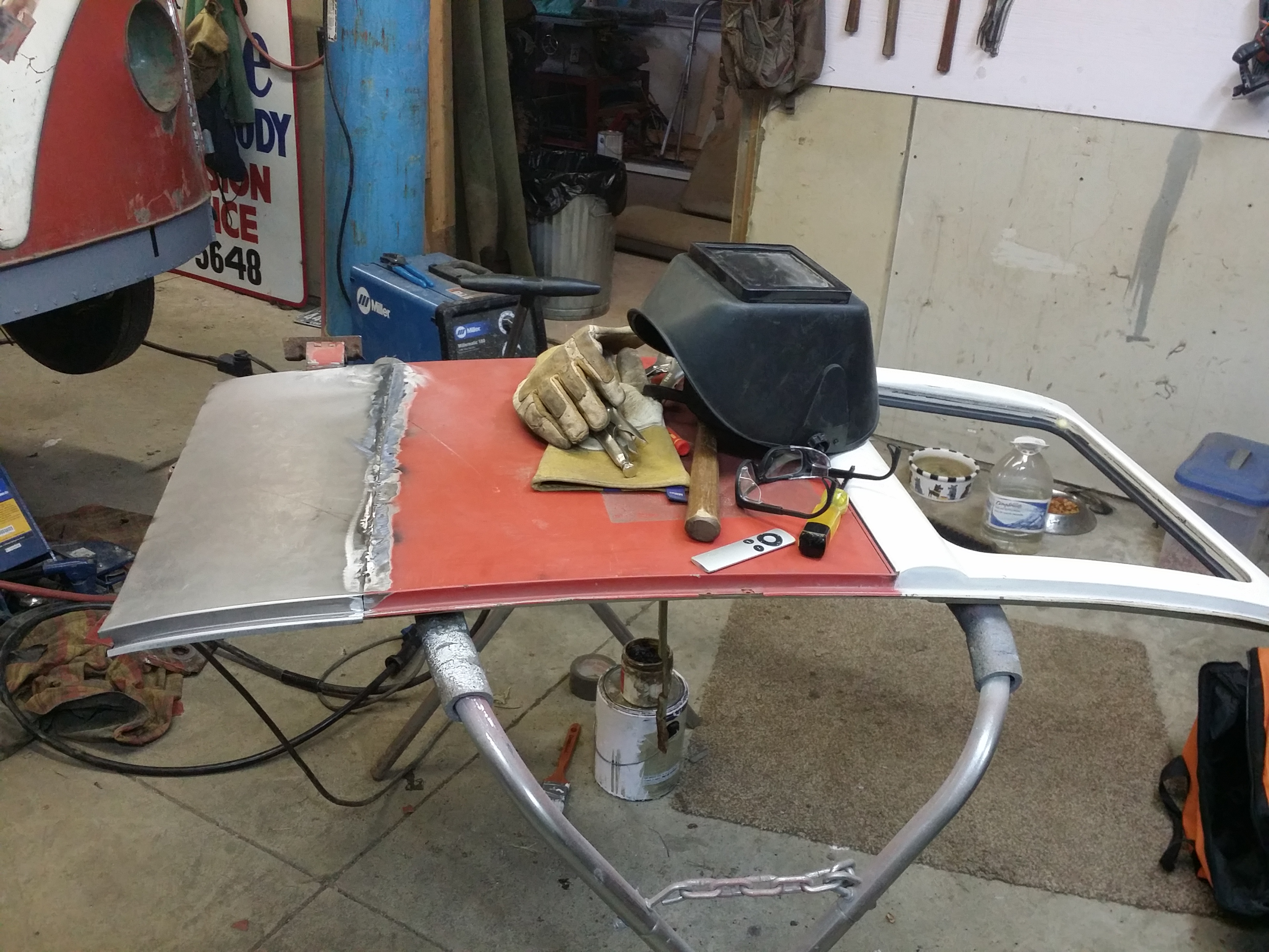

A couple of weeks ago I was bored and not feeling too bad so I thought I would pick away at something on the bus
I figured the cargo doors were something I didn't have to contort my body too bad to work on so I began with those
I stayed old school and did not use any of my auto darkening helmets between the new bifocals and no auto helmet there was definitely a learning curve again. It didn't go to bad so I decided to lay out some of the metal that I knew I want to do

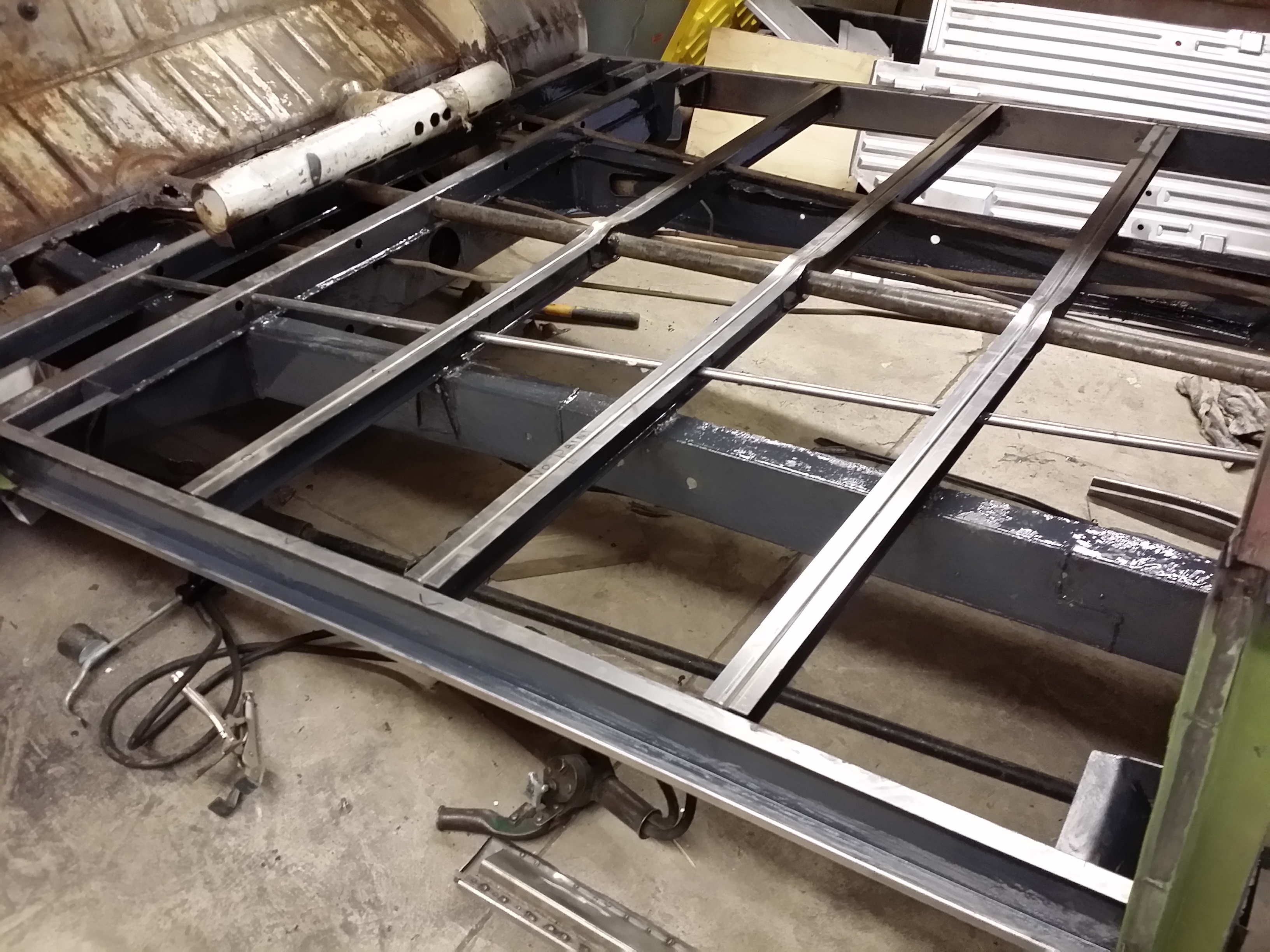

I originally planned on doing like most and not replace the whole tophat ..only the outer edge that is rotten but as I looked at it I thought it may be easier to replace it all..since I had some left over AC metal
Take a look at where the 3rd I beam should be ..there is a tophat there.. strange to me maybe its a 67 only thing
Anyways I took some measurements and started cutting then laid it all out numerous times and finally tacked it all in
Things were going pretty smooth so I figured I might as well work while the body is good
I predrilled a bunch of holes and Eric came over on Sat and we plugged some wire.

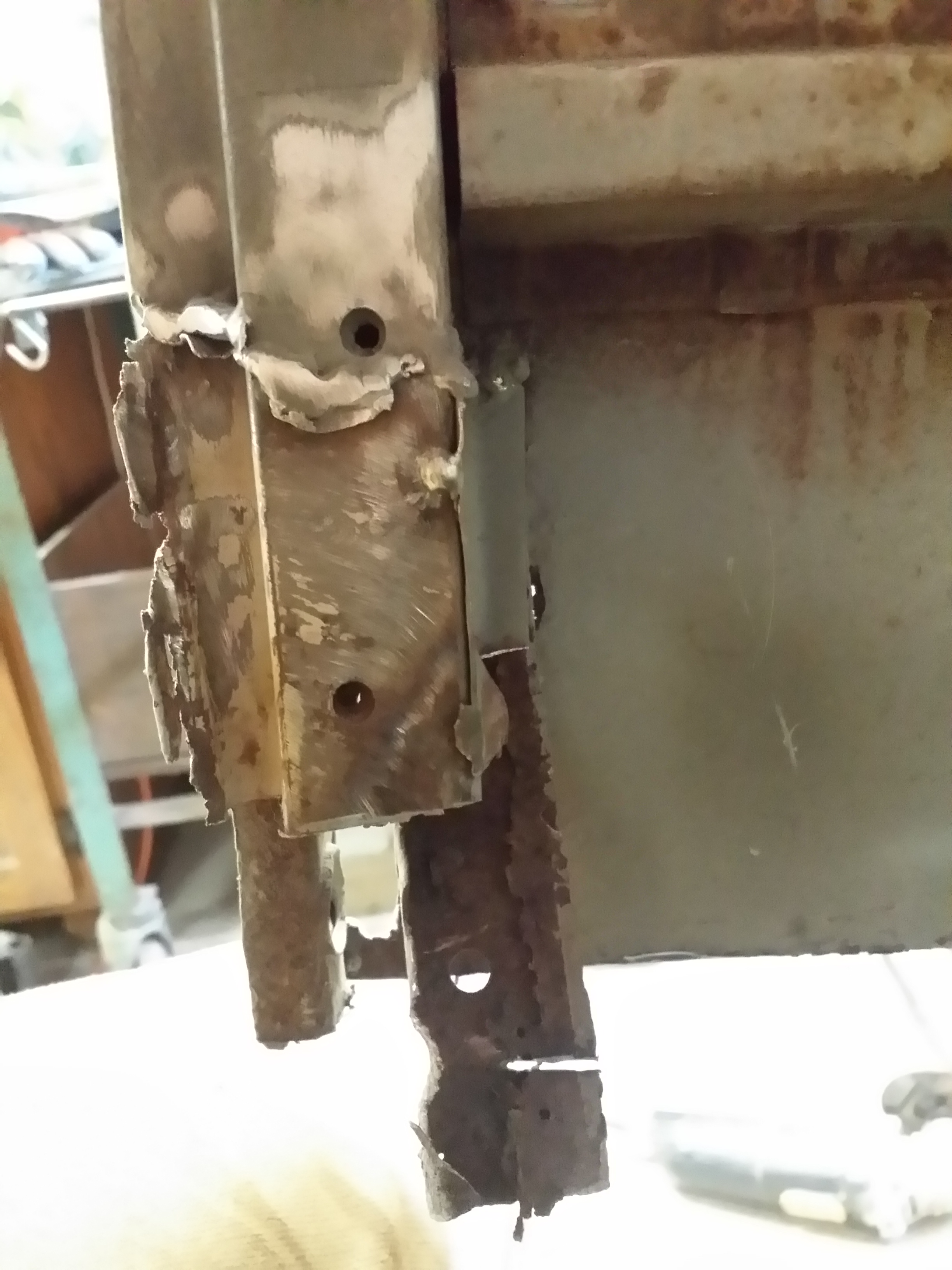

I moved over and took a look at the B pillar..well where the B pillar should have been I ended up having to add an extension onto the inner B pillar I was just about an inch or so short. I bent up a piece and tacked it together
I lost count of how many times I have had the doors on and off All of this end is just tacked as I am beginning to fit the cab doors and dog legs. I finished the short rocker I am pretty confident on the C pillar position.

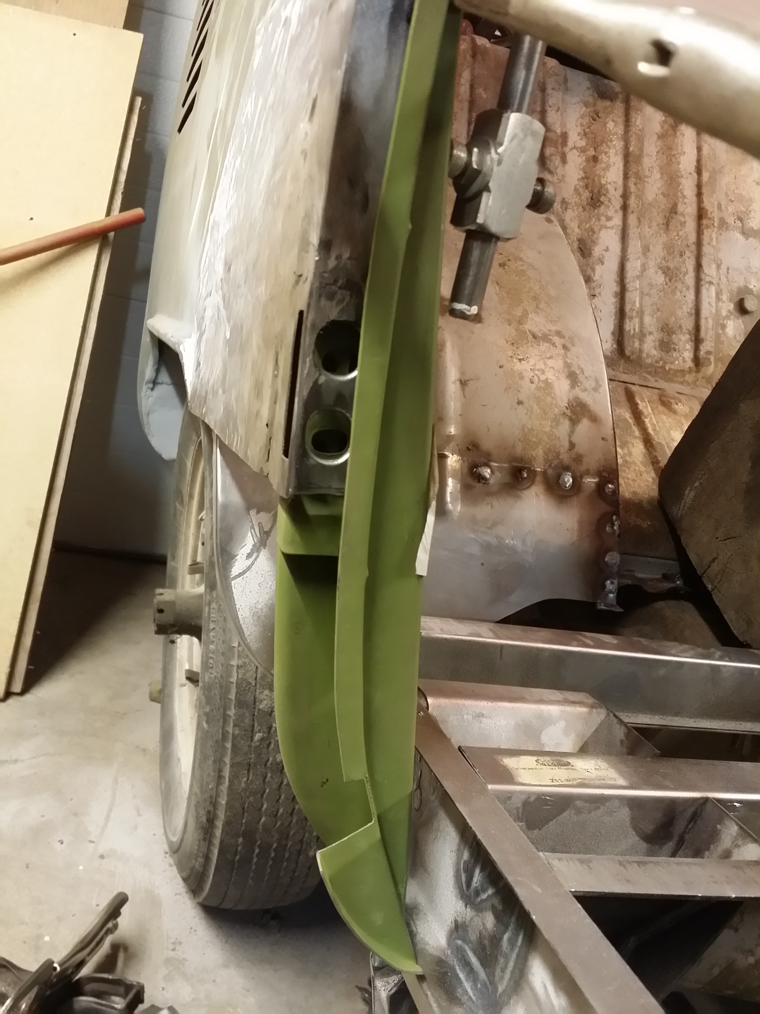

I had a full two days to spend out in the shop this weekend so I decided to tackle getting the nose back on I had a couple of small holes to fix on this really straight nose
Not a lot of pictures but I did spend 20 hours of on and off with the nose at the end of it all I had
reached a pretty big milestone in the rebirth of this pile. The nose is back on
