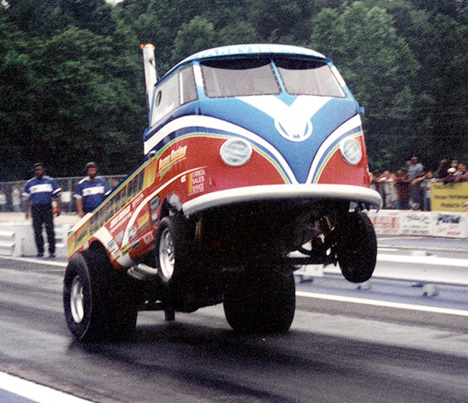

TRL wrote:Yeah!! Gunther is going to fly down the road now. Cant wait to race ya L :)
My money is on Marla. This is how I visualize her coming out of the chute!
