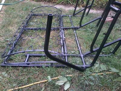

So I have fabricated a 67 middle seat out of a early bay seat..a huge thank u to the members that gave me the parts that I needed u know whom u are
total project cost so far..around 55 bucks.
WF
I am well on my way to actually not having to jump the mid seat to get to the cooler.

Re: ed's 67 deluxe
Oh ya also thank u to my local furniture store for leting me strip those springs out of a couch in there dumpster, in a thunder storm
Re: ed's 67 deluxe
Way to go Ed. That's LEAKOIL methodology!
