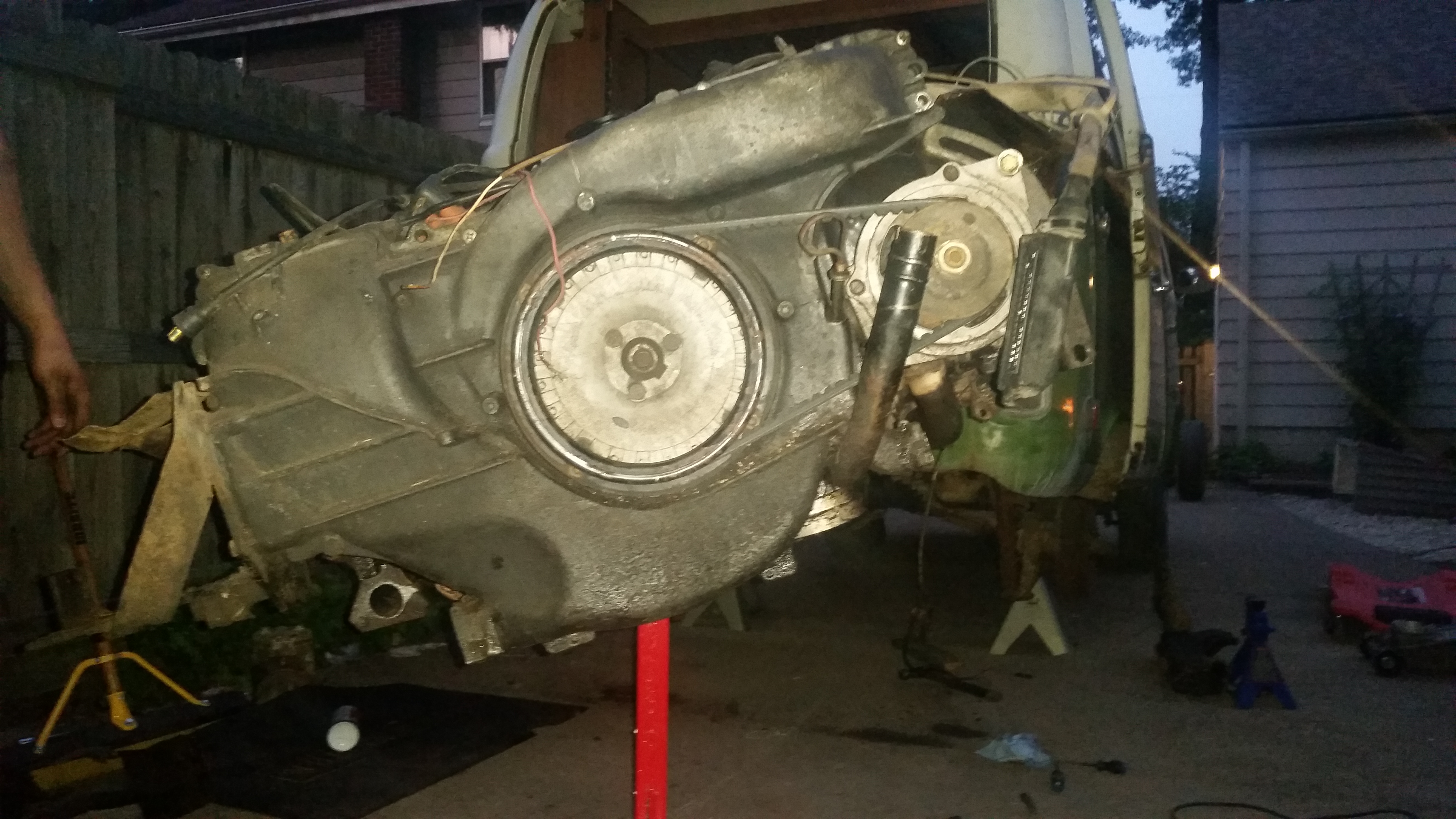

Got my engine out last night, but I managed to bend this bolt...
(Thanks to ratwell for the picture)
It is one of the studs that stay in the engine that your stand/mount can mount to... Runs through the transmission bellhousing.
What is involved in replacing it?
Posts: 3969
Not uncommon and not a big deal As I recall it is an 80mmx10mm stud. double nut it or use vise grips. as long as the threads in the case are OK,your good to go.

wwebner wrote:Not uncommon and not a big deal As I recall it is an 80mmx10mm stud. double nut it or use vise grips. as long as the threads in the case are OK,your good to go.
So just try to bend it straight again? threads inside the case are good as far as i know.

Posts: 3969
Sure,just straighten it. BTW,looks pretty solid with minimal rust repair. Now would be a good time to pull the fuel tank and inspect/clean it. Also replace filler hose if needed and especially the vent hoses and the tank fuel lines.Look at the tank outlet and return nipples on the bottom of the tank. 77 they are probably ok. 78 and 79 they packed insulation in this area causing them to rot.

Fuel tank is definitely coming out and being cleaned, fuel sender and filler neck are both being replaced. All the vent/vacuum hoses and fuel lines are going to be replaced. The tank outlet and return nipples seemed ok from what I could tell but I will inspect them better when the tank comes out.
Getting that engine out was a pain! So many frozen/rusted bolts. On top of that I had to remove the AC compressor and the trailer hitch. I had to cut out my heater boxes, too.
