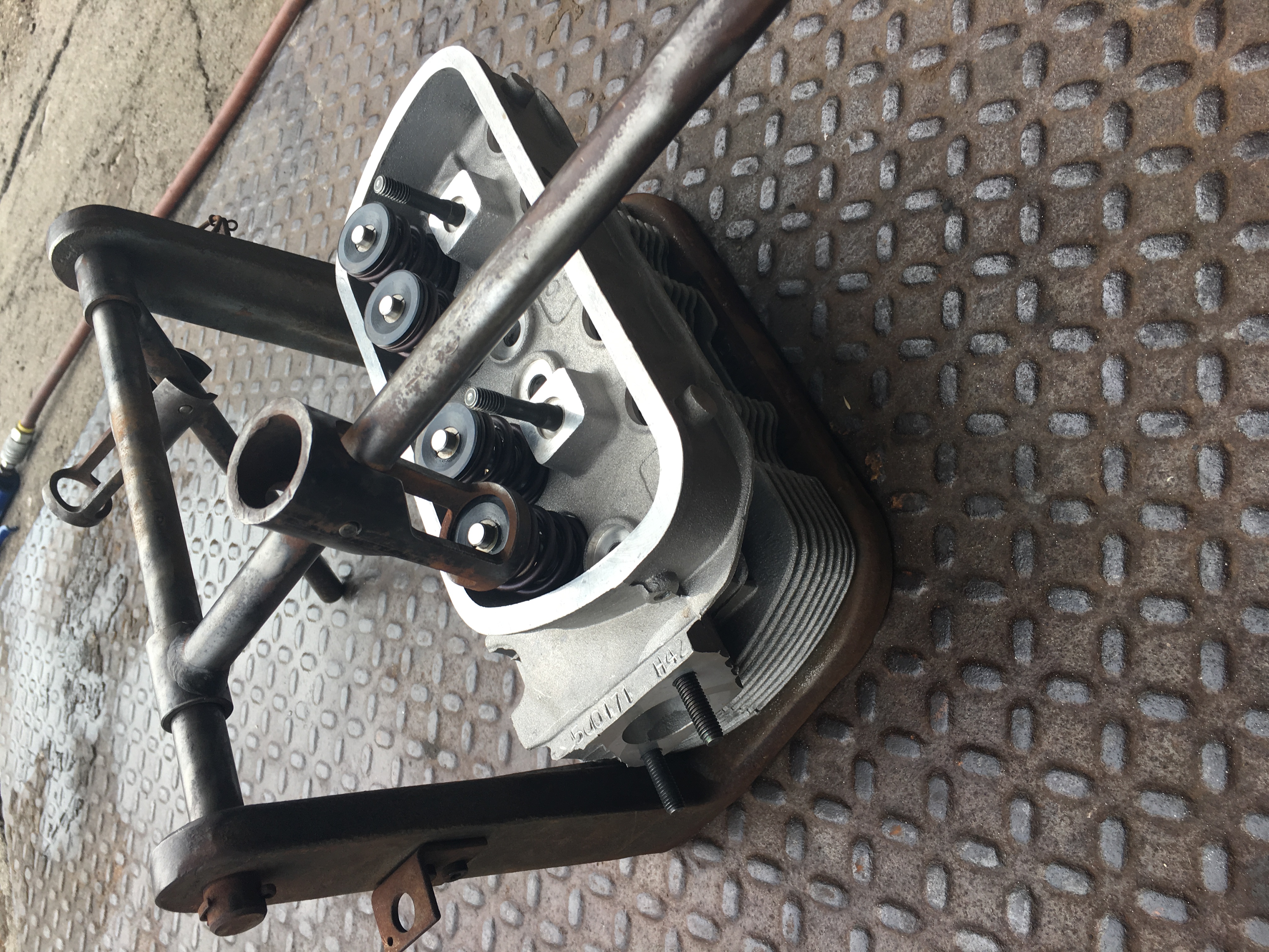

A little port clean up

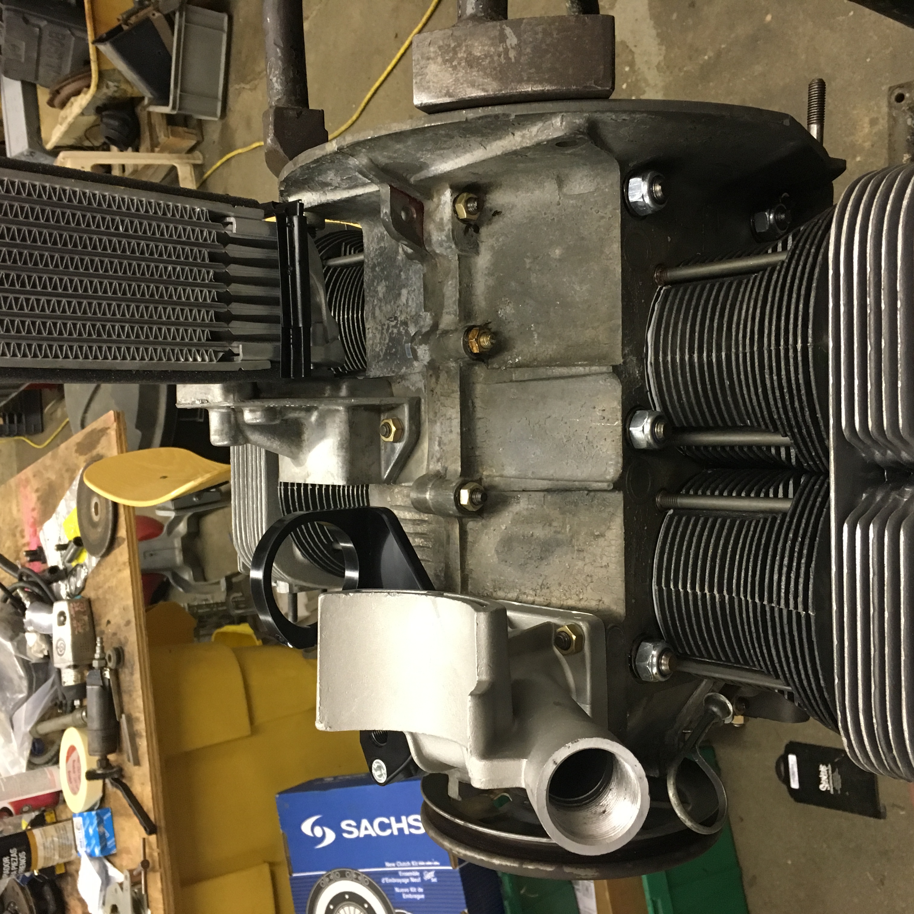

Got a little more accomplished last night. Cleaned and painted some tin. Mounted oil the mighty T4 oil cooler and alternator stand. Next will be adding tin and setting up the T-stat with flaps.

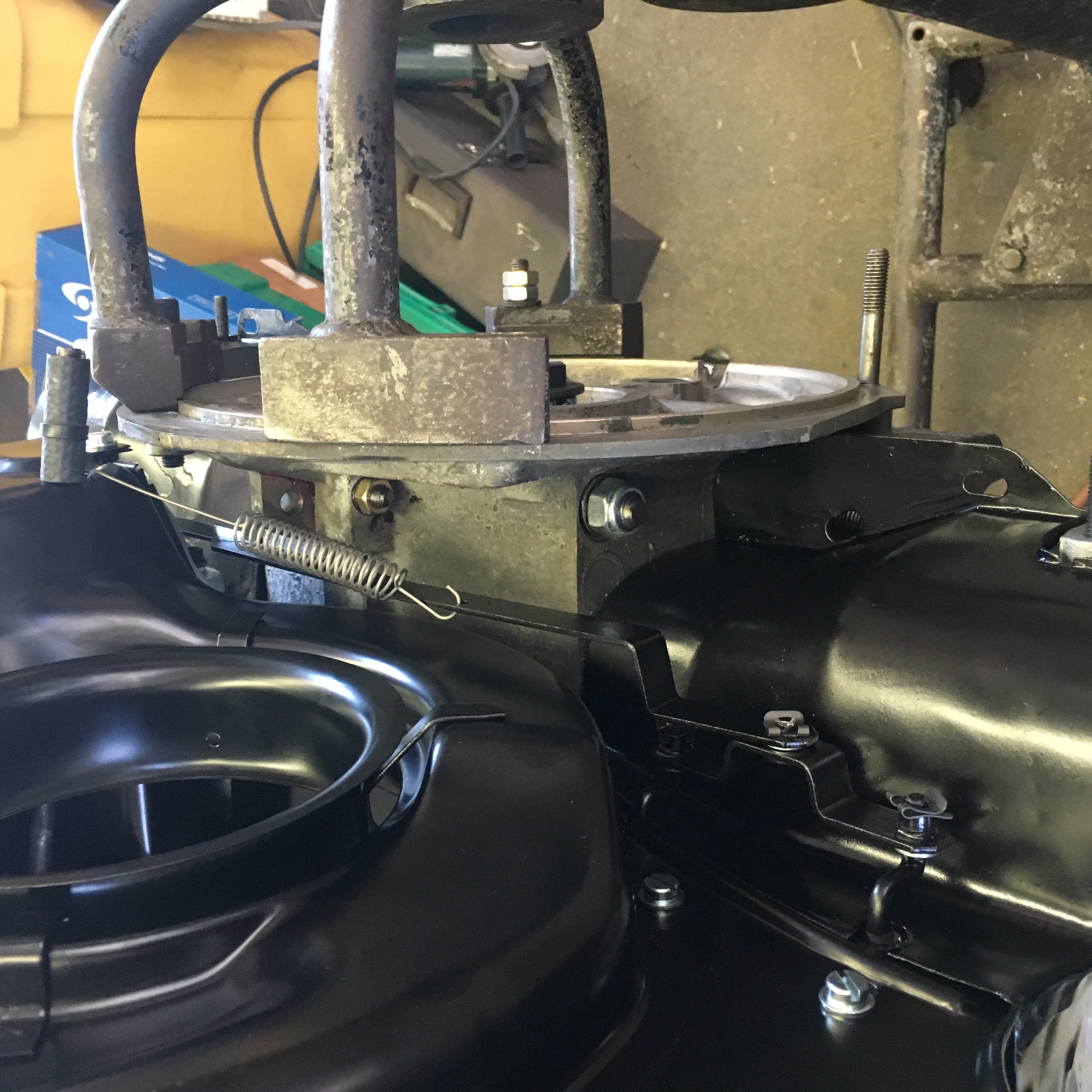

Carbs and linkages installed
