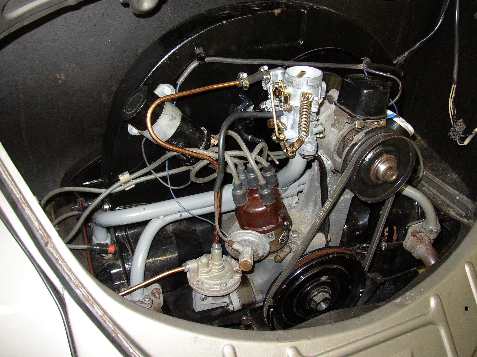

Photobucket has ruined the first 14 and 1/2 pages of this thread, but that's no excuse for me not having this thing on the road. Josh came over and lent a hand one day. (Much appreciated.) I did the best I could with the motor. Got everything back together and of course it wouldn't start. Clearly, not getting fuel. So I called Bruce. Thankfully, he told me to bring it over. Bruce will update his findings and efforts in the near future.
Posts: 1373
Re: 1957 Oval
Yes, the Oval has returned. Actually it looks pretty good and Sean (and friends) got a lot accomplished on it since I last saw it.
Well, it looks like it should start but won't. Sean says it sounds like it's not getting fuel, so let's unhook the carb line and nothing comes out. Is there gas in the tank? Sean, you did put fuel in the fuel tank, right? :roll:

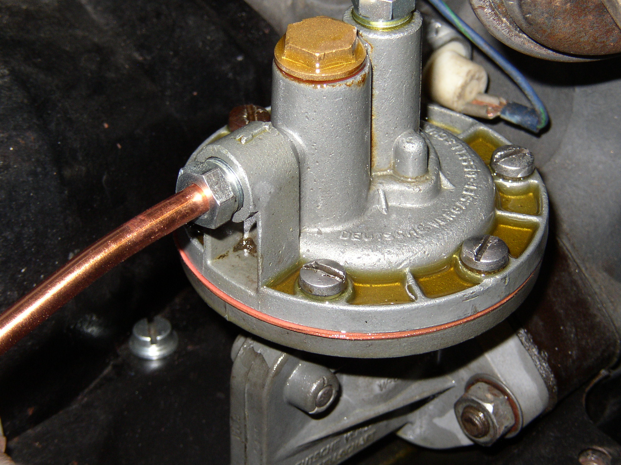

After putting fuel in the tank there's still no pump output, so we check that fuel is getting to the pump with a Mityvac jug setup. Yep, the first gulp looked like black coffee but there's fuel getting to the pump, but still no pump output. Probably a good thing as that slug of 20 year old black fuel that was in the fuel line would not have been good for the brand new carb.

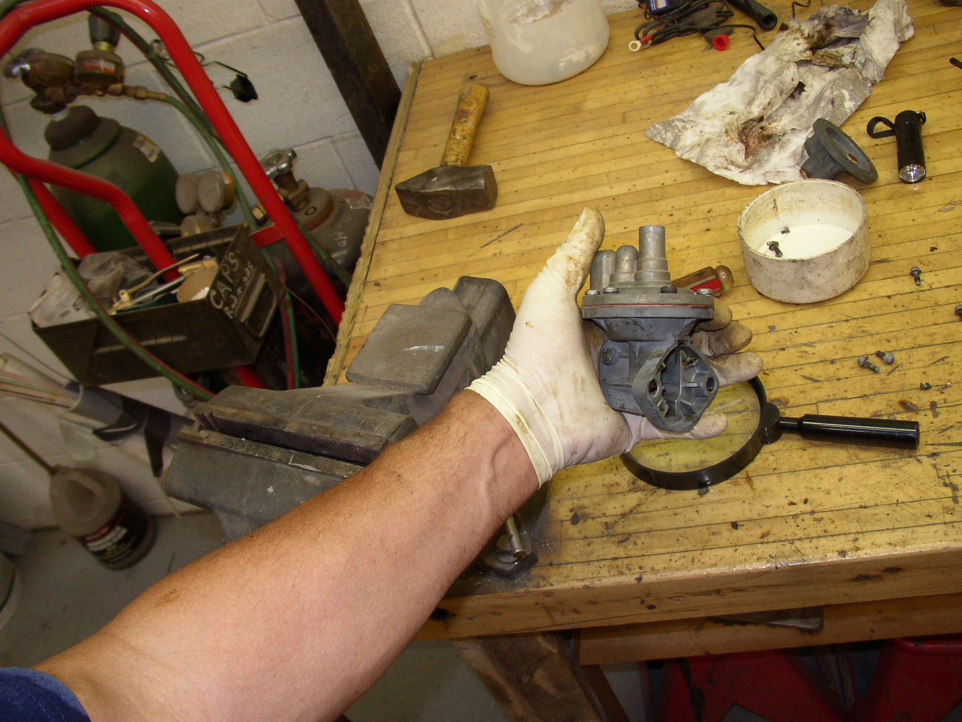

So off comes the pump for the first of what would come to pass as multiple rebuilds. :shock:
Let's put the spring back on the correct side of the diaphragm for starters, and assemble the check valves correctly. :roll:

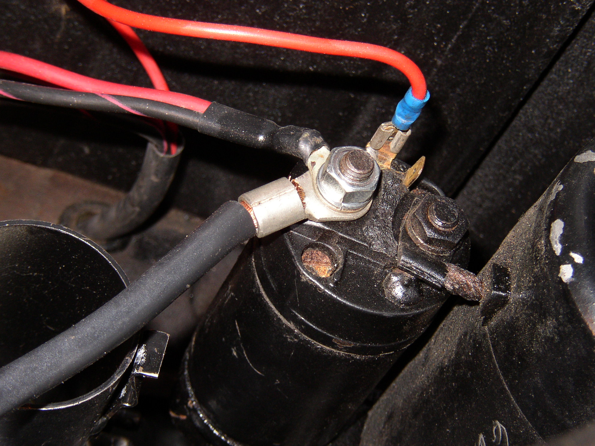

While it was on the rack I noticed the trigger wire on the starter was loose to the touch and would fall off in the wind. I'm surprised it was making enough contact to even make the starter work, being that it's 6v.
So we fix 'em up.

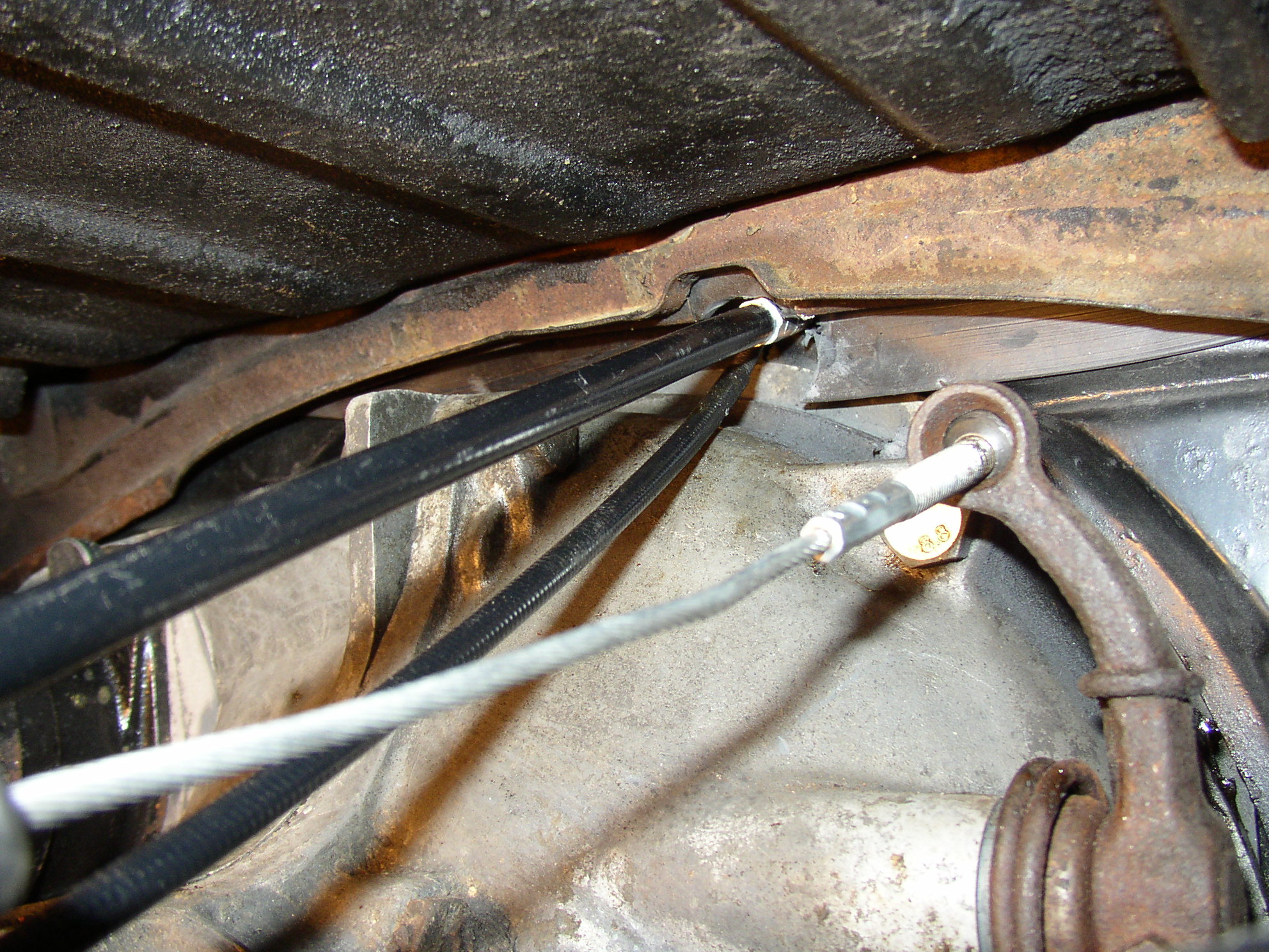

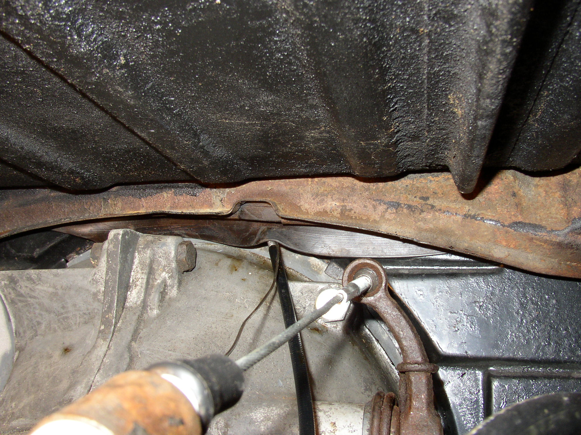

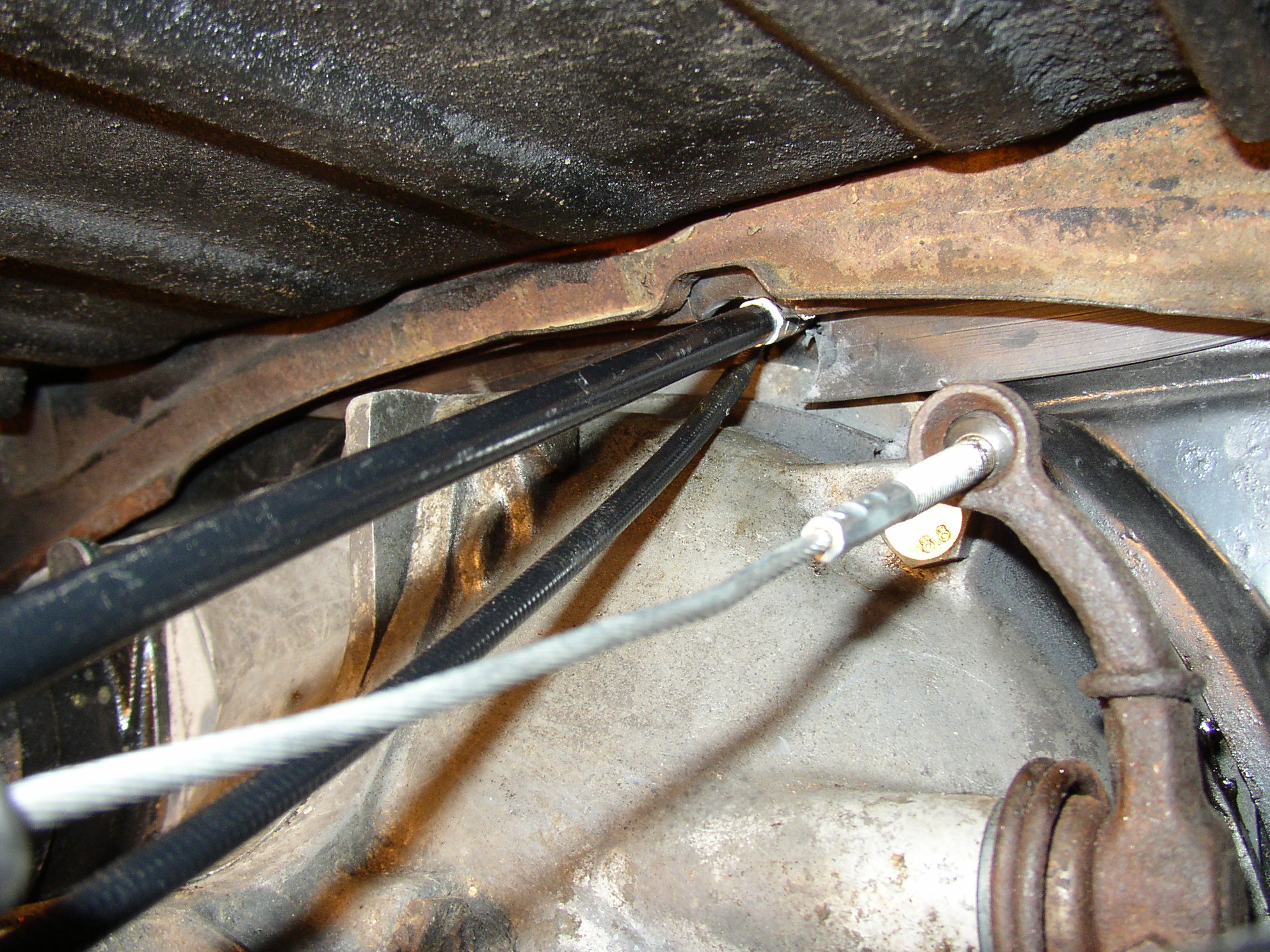

The throttle cable was mucked up, too. I see this frequently, especially after the engine weatherstrip has been replaced. You have to take a die grinder and make clearance for the throttle cable and Bowden tube, which this car didn't have from the factory.
It does now.

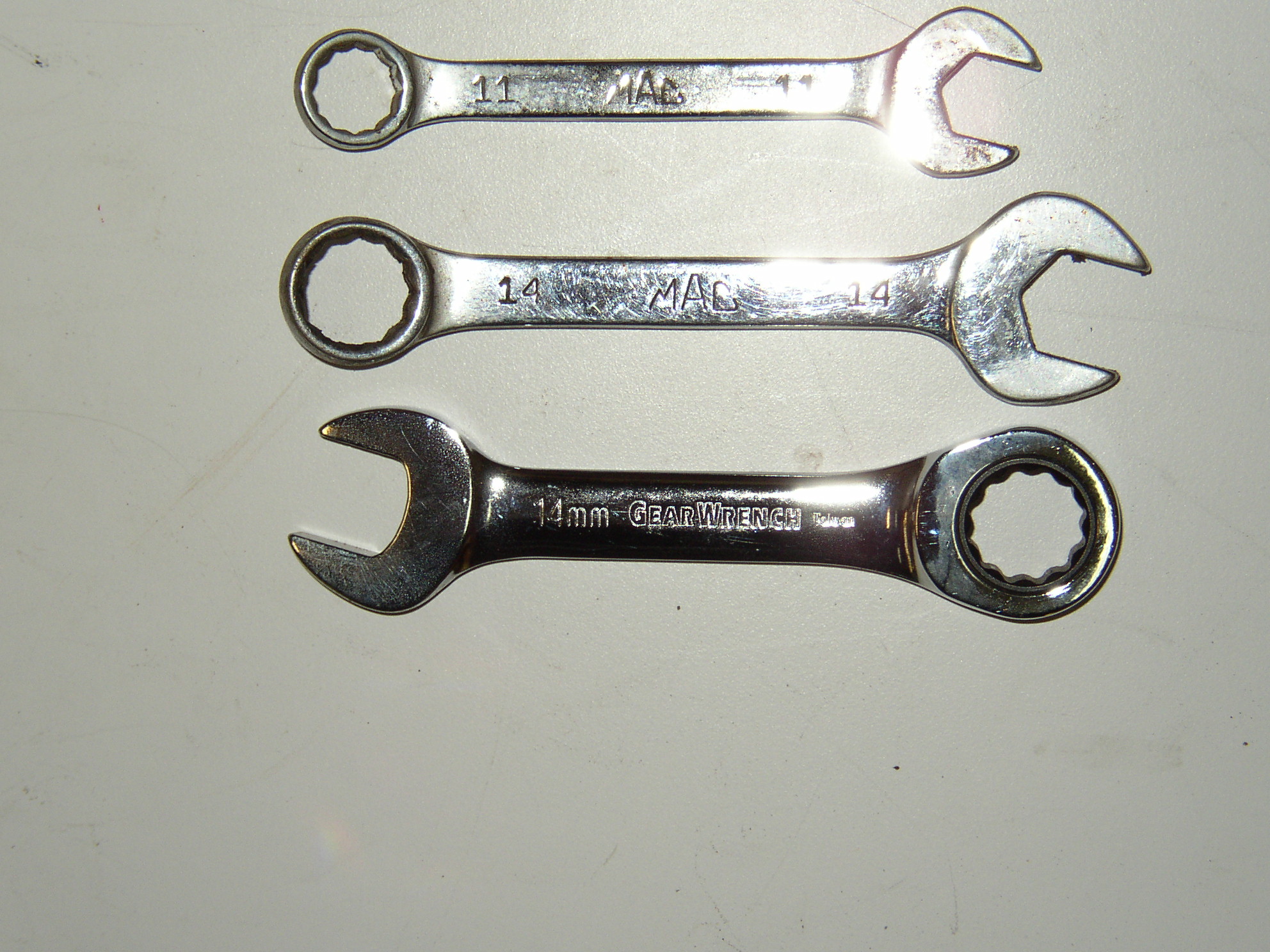

Adjusting the clutch is a real joy on these old Dubs before they have the wingnut. This is one of those few times where I get out the real wrenches instead of the cheapo ones I usually use. Sure am glad I have these shorties and the GearWrench, it made this much easier. For future reference here's what I used, in addition to a VG:

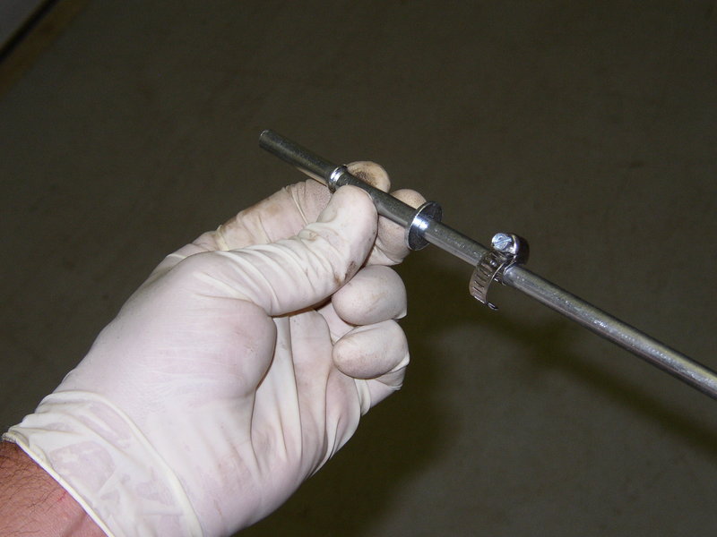

While I'm messing with that, let's put a clamp on the cable tube to keep the SOB from sliding into the shroud.

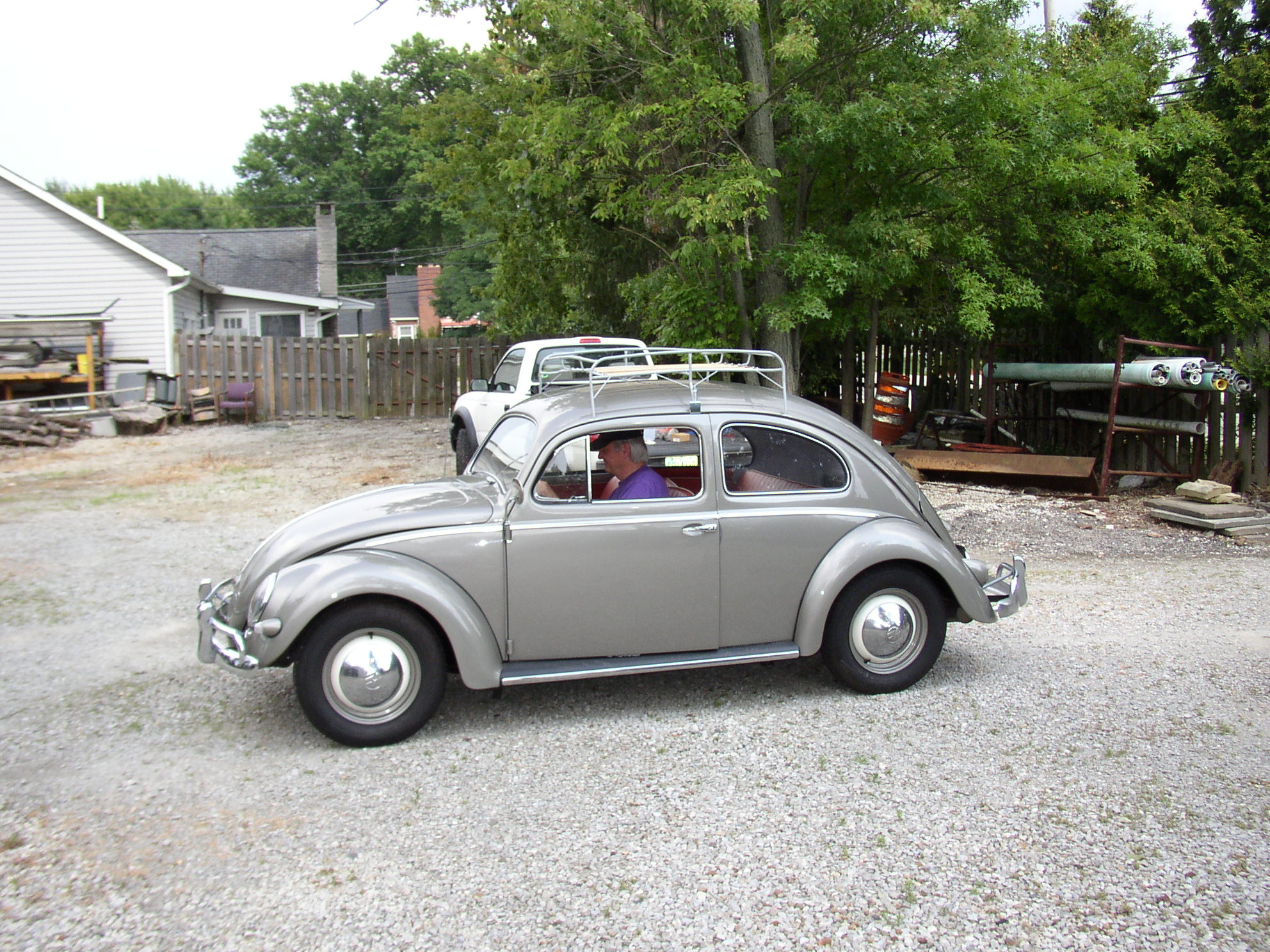

Big day yesterday, it went for a road test under it's own power for the first time in decades! That's one happy Irishman there......
But, the MFFP is leaking again after it sets. What is this now, four times?

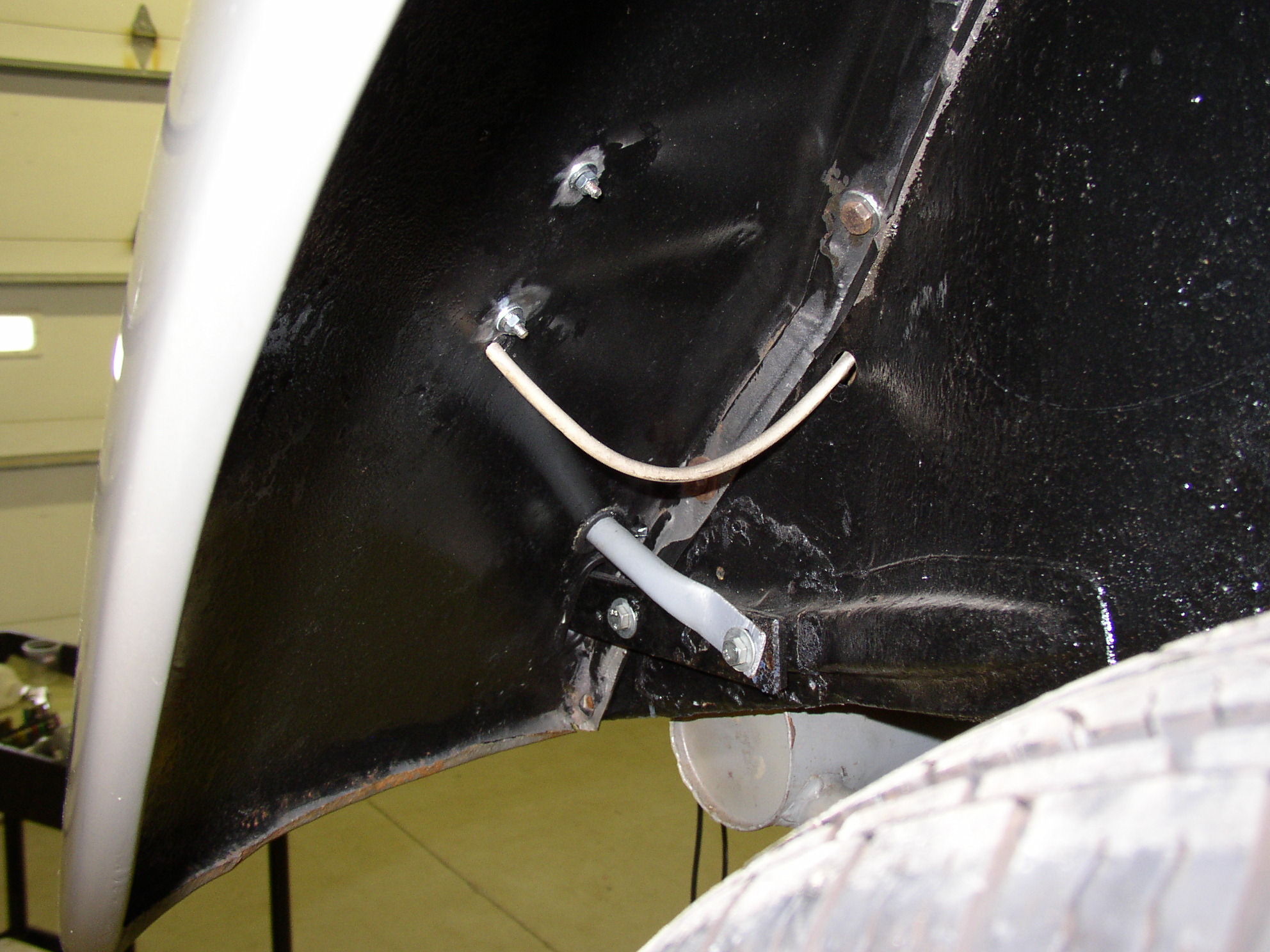

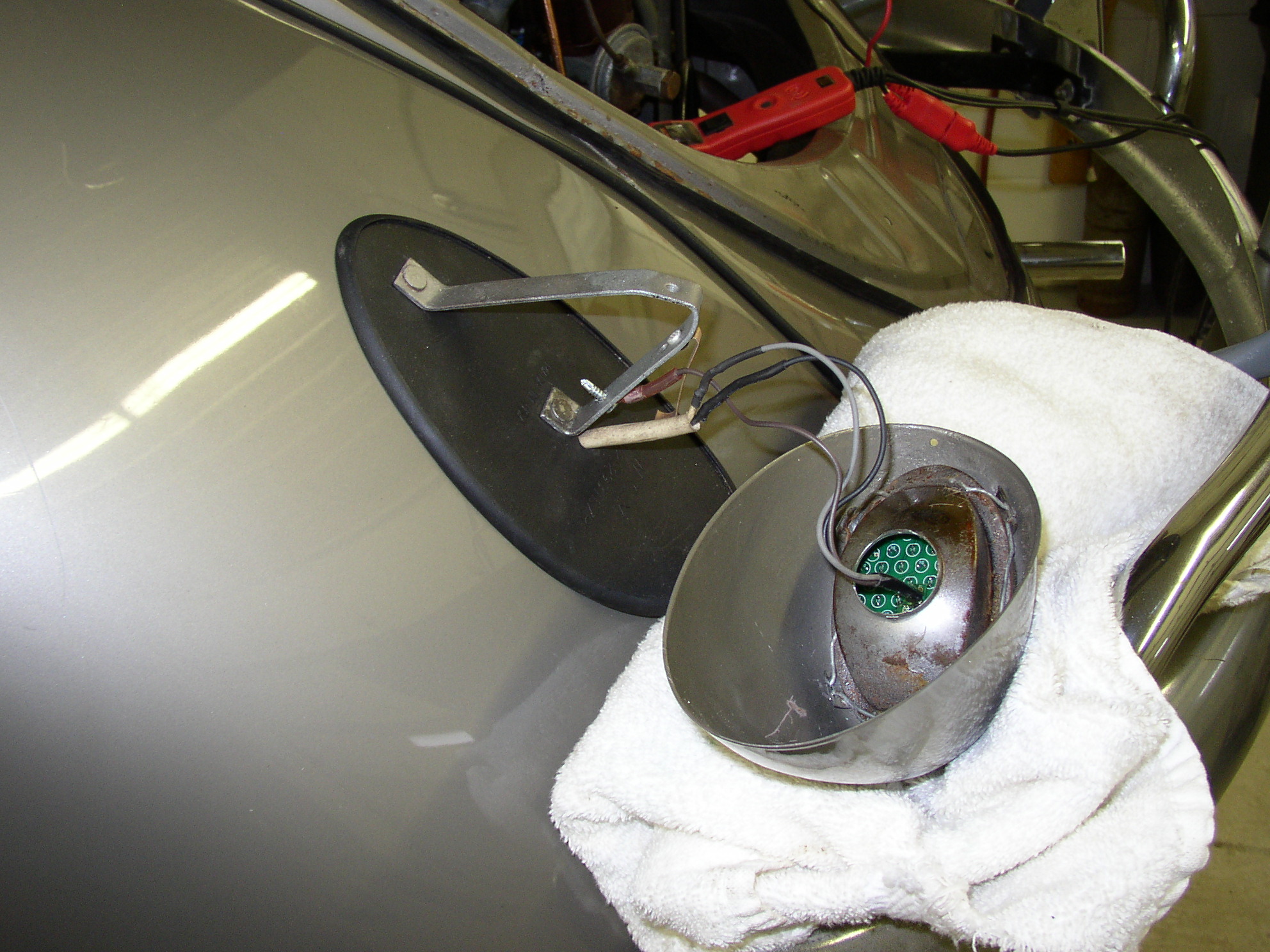

Lets straighten out some wiring. A previous technician installed LED taillights but the wiring could be cleaner.
Let's gut that and start over. Remove the assemblies, bead blast the bracket because it will be the ground now, grind the paint from the inner fender so it makes good contact, and
Solder the wires with shrink tube.
And now it looks nice and is protected. A bit of grease will go on the screws to stop rust.

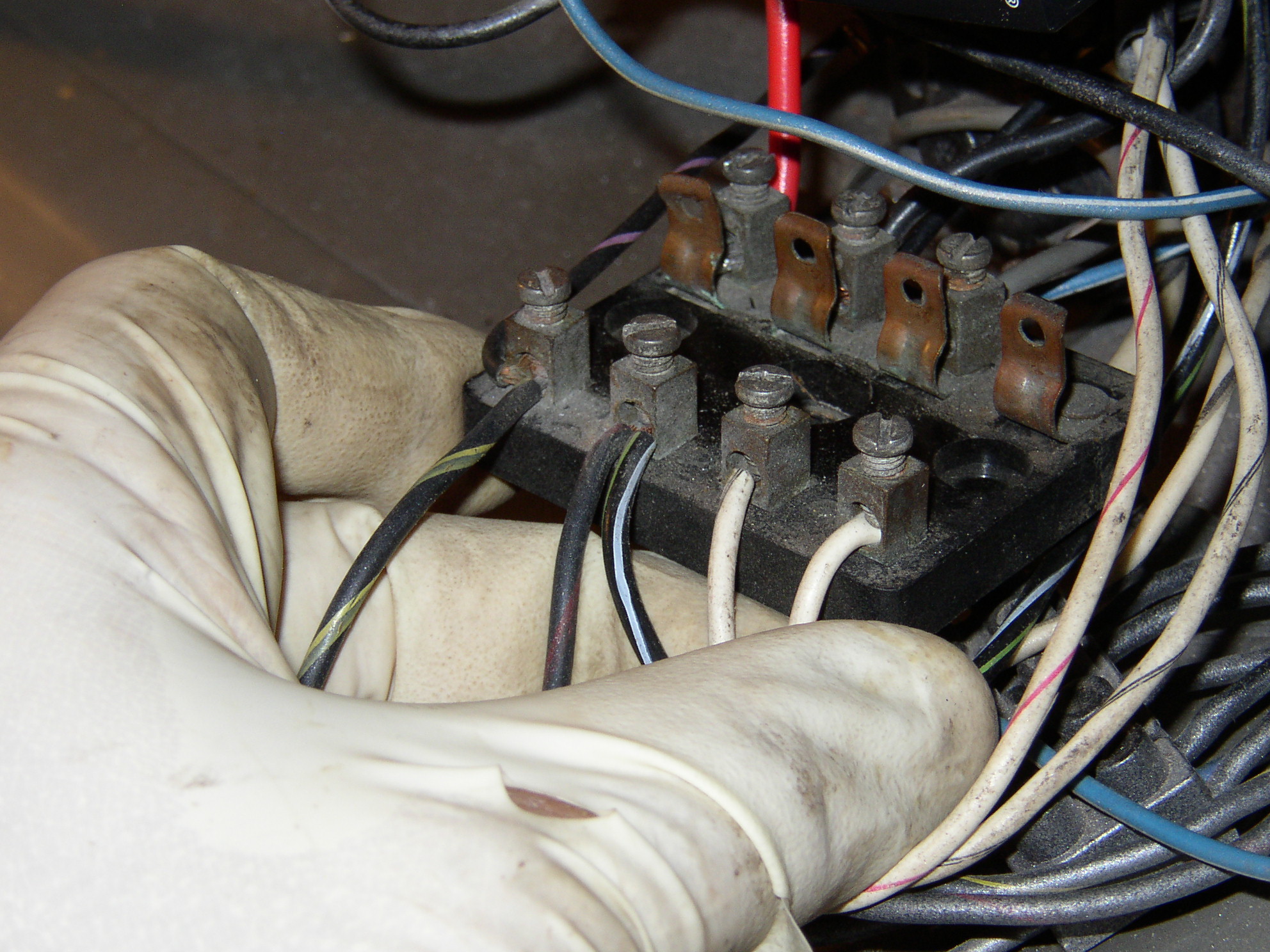

Lots of electrical doesn't work so one of the first things I do is remove all of the fuses and wire wheel the contacts with a Dremel. Shazam! The wipers "worked" as soon as I did this.

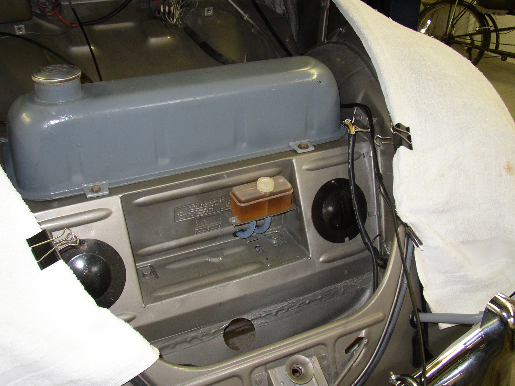

Hey Ted, what would cause this brake fluid to discolor on a car that hasn't been driven? It's the same fluid in my bus that hasn't changed color at all. I still have some left in the bottle and it looks clear, too. :?: I put this in 2 years ago when we put on the disc brakes.

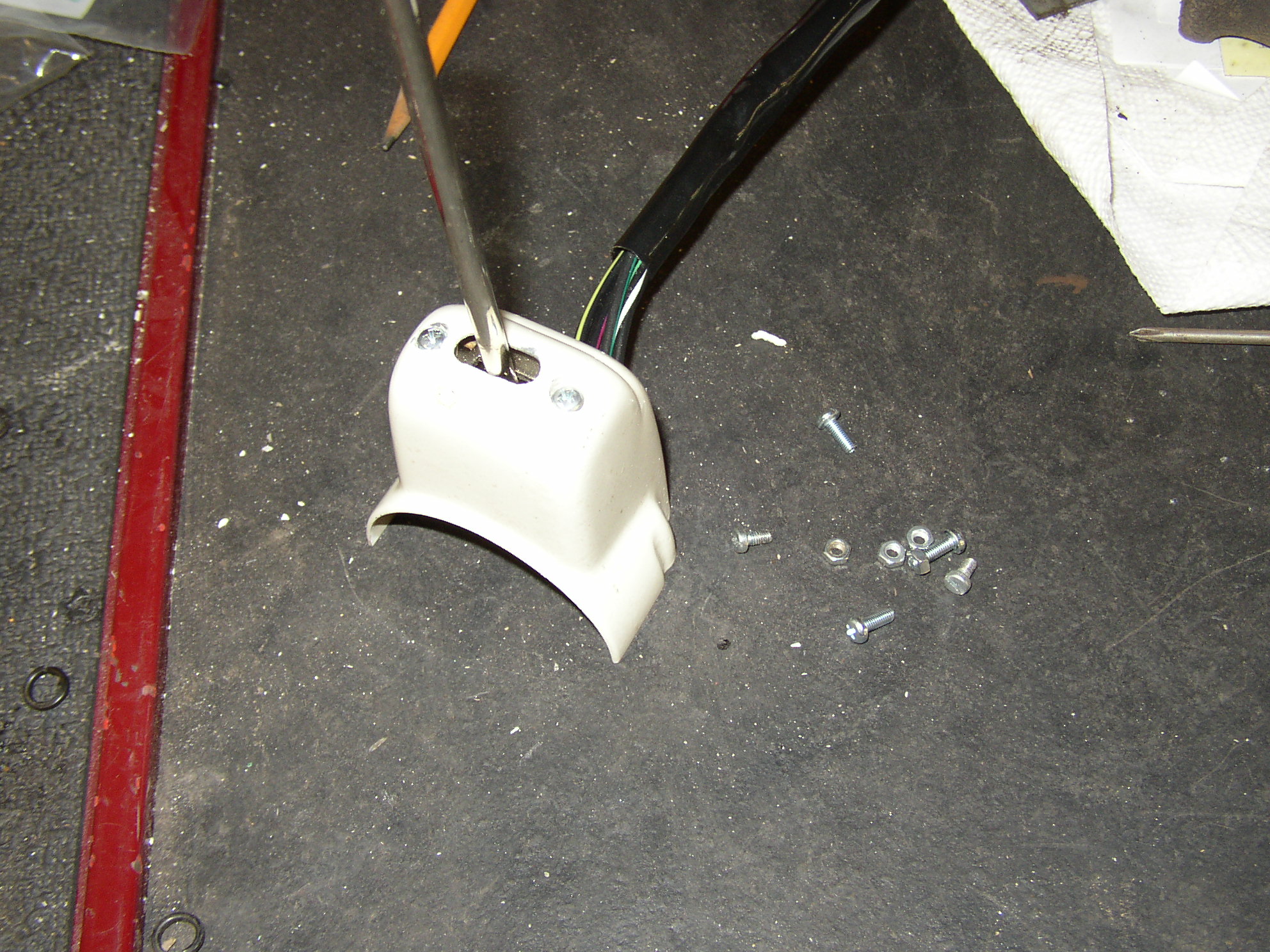

Messing with the TS switch right now, and of course the screws were too short and my bolt bin only goes down to 4mm. :x A quick stop at the hardware store got me some 3mmx7mm screws.

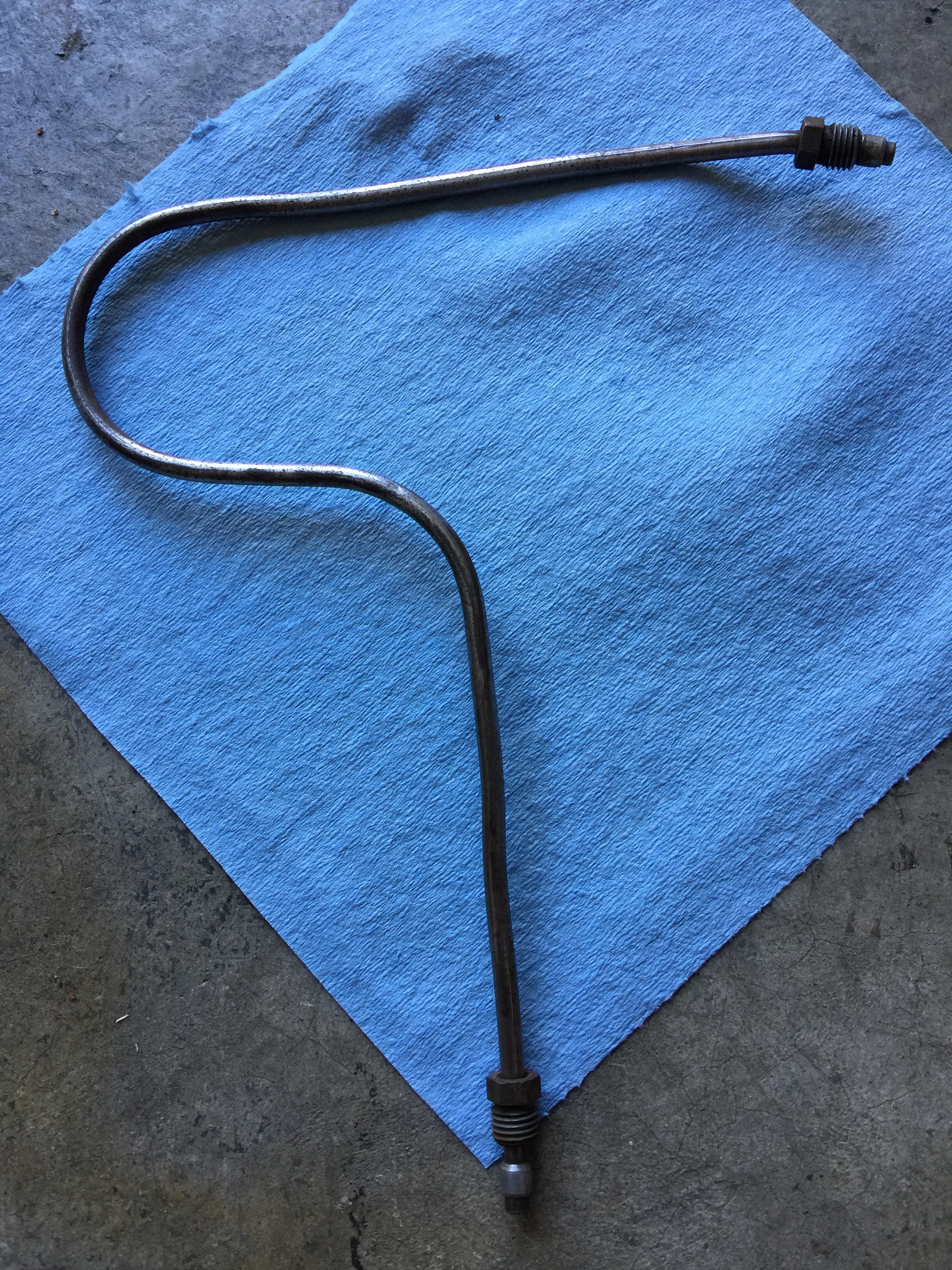

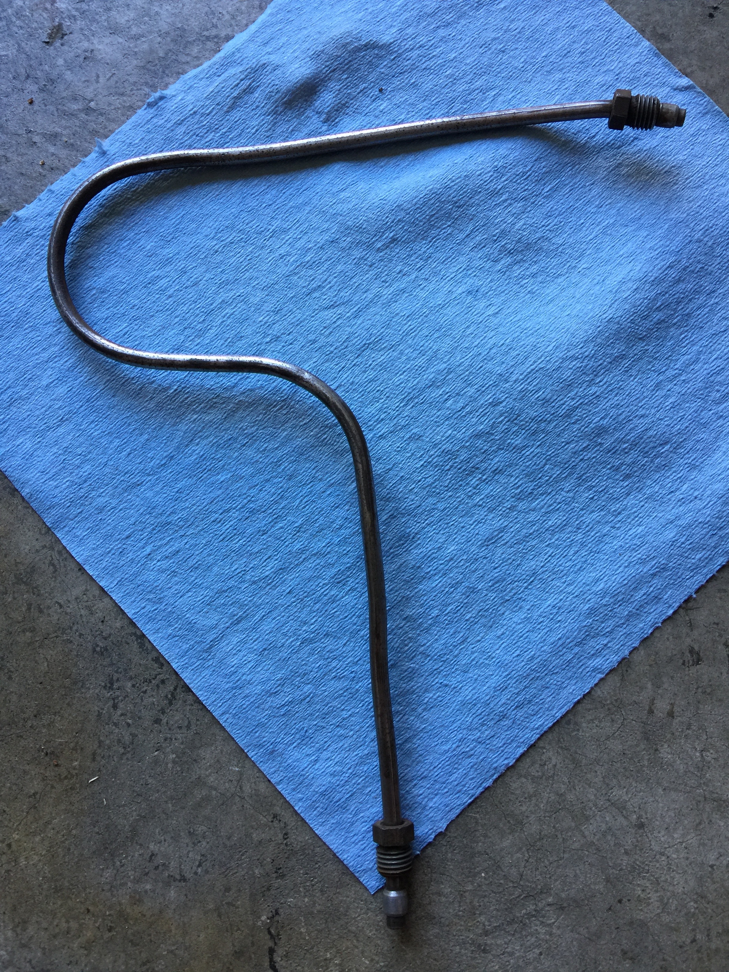

Don't know what's up wth the fuel pump outlet leaking. Bruce tried a couple combinations of tops. Even after cleaning and refitting,they leaked. We replaced the outlet lines with aftermarket ones from WW. Maybe they're the problem? If so, I found an old one that I cleaned up that I'll take out to Bruce to see if it's the answer.
