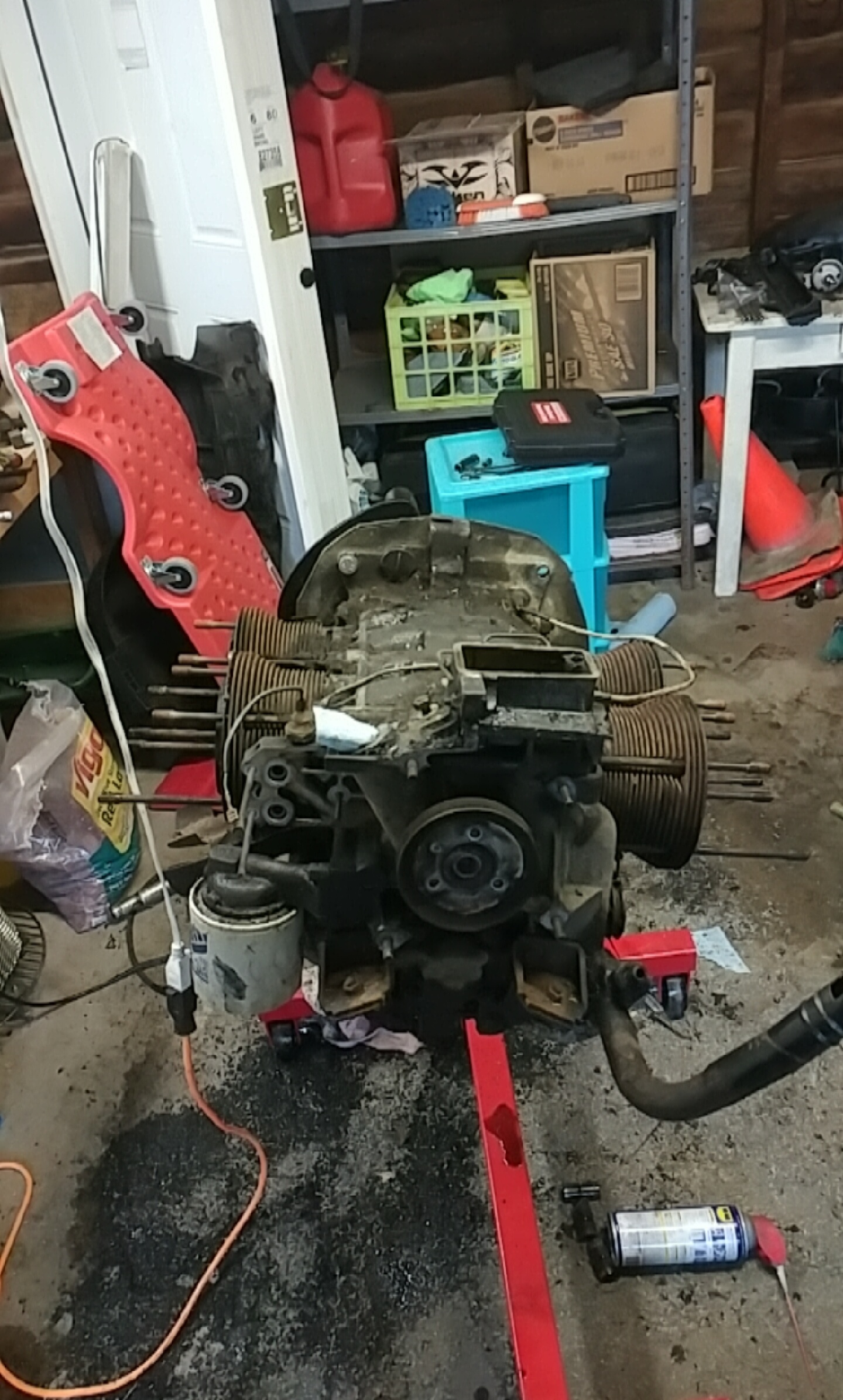

Got my engine stripped down to the long block today. I was removing what I think was the TSII and instead of the bolt backing out the head sheared off. Had that happen to one tin screw as well. No good especially on the TSII. :cry:
It gets worse. The stud i used to mount my engine is kinda FUBARed. I don't know what happened to it but I'm sure me or my helper screwed it up somehow on disassembly. The threads are gone. Anything to do besides split the case?
Heads come off tomorrow and I'll take them up to Delzani's sometime this week to have them checked out/rebuilt. Also going to order a new thermostat from awesome powdercoating.

Todays progress.
Also pulled the liners off.

Looks like you have an AC pulley on the end of the crank. I have the correct spacer to replace that if you need when the time comes. Also,you will have to get the fan hub off. It is a tapered press fit. You can use 3 pieces of 3/16 flat stock fitted behind the hub and slowly crank in 3,8mm bolts against the flat stock and the hub will pop off. Alternated turning the bolts a little at a time. Stand to the side while doing this.

wwebner wrote:Looks like you have an AC pulley on the end of the crank. I have the correct spacer to replace that if you need when the time comes. Also,you will have to get the fan hub off. It is a tapered press fit. You can use 3 pieces of 3/16 flat stock fitted behind the hub and slowly crank in 3,8mm bolts against the flat stock and the hub will pop off. Alternated turning the bolts a little at a time. Stand to the side while doing this.
You are a wealth of knowledge. Thank you. How do you feel about mahle p&cs vs aapistons? I know you're a dealer for aapistons.
Although I am a dealer for AA, I have no first hand experience with their P&C's. piston and cylinder are rarely a weak point. The advantage AA and some other piston manufacture and suppliers have is offering different configurations, such as flat top and larger diameter. I would stay away from any that seem TOO cheap.
