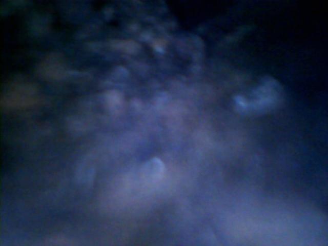

This is also a good time to check the front heater tube and make sure it's clear. I borrowed Sean's USB borescope, which is a mini camera about 1/2" in diameter on a long stiff wire.
It plugs into a laptop and lets you examine areas that you normally wouldn't be able to see. I ran the borescope into the heater tube, and into a big mouse nest, what a surprise. Thanks, Sean!
Looking at the forward end of the tube where it makes the vertical bend I see a surprise, an access port that VW put in to blow out the tube!
I bend open the access port, put my big vacuum on the back end to catch the hantavirus, and blow out the tube. That worked great! I also ran a cable/drill through it to remove loose crud.

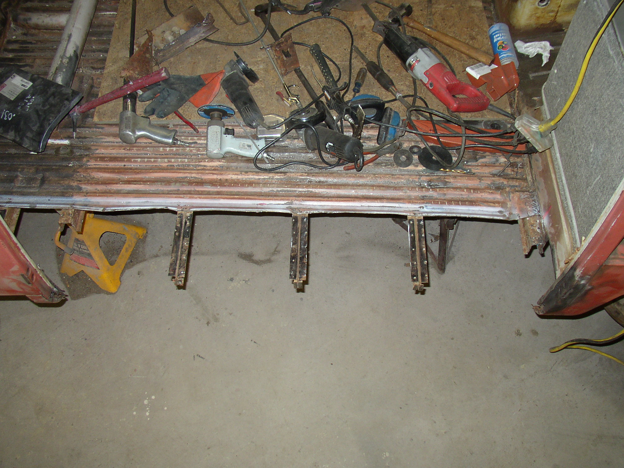

I’m in the process of doing the right floor/rocker area. Drilling the spot welds is low tech- use a flap wheel to remove the paint so the spot welds show up, then take a ½” bit and just drill enough until chips show. Then take a prybar and pop the weakened metal apart. I’ve used a variety of spot weld drill bits and have not been impressed with them. Plus, they wear out and the tips are expensive, like $10/ea.
The old stuff is cut out and the floor supports look fine.
I need to put a patch in the bulkhead, easy fix.
I have all of the replacement panels I need in a pile, just need the time to put them in. An initial test fit shows the right floor pieces fit well but I haven’t started welding yet.

- Mouse nest in heater tube 002.jpg (16.87 KiB) Viewed 12422 times
