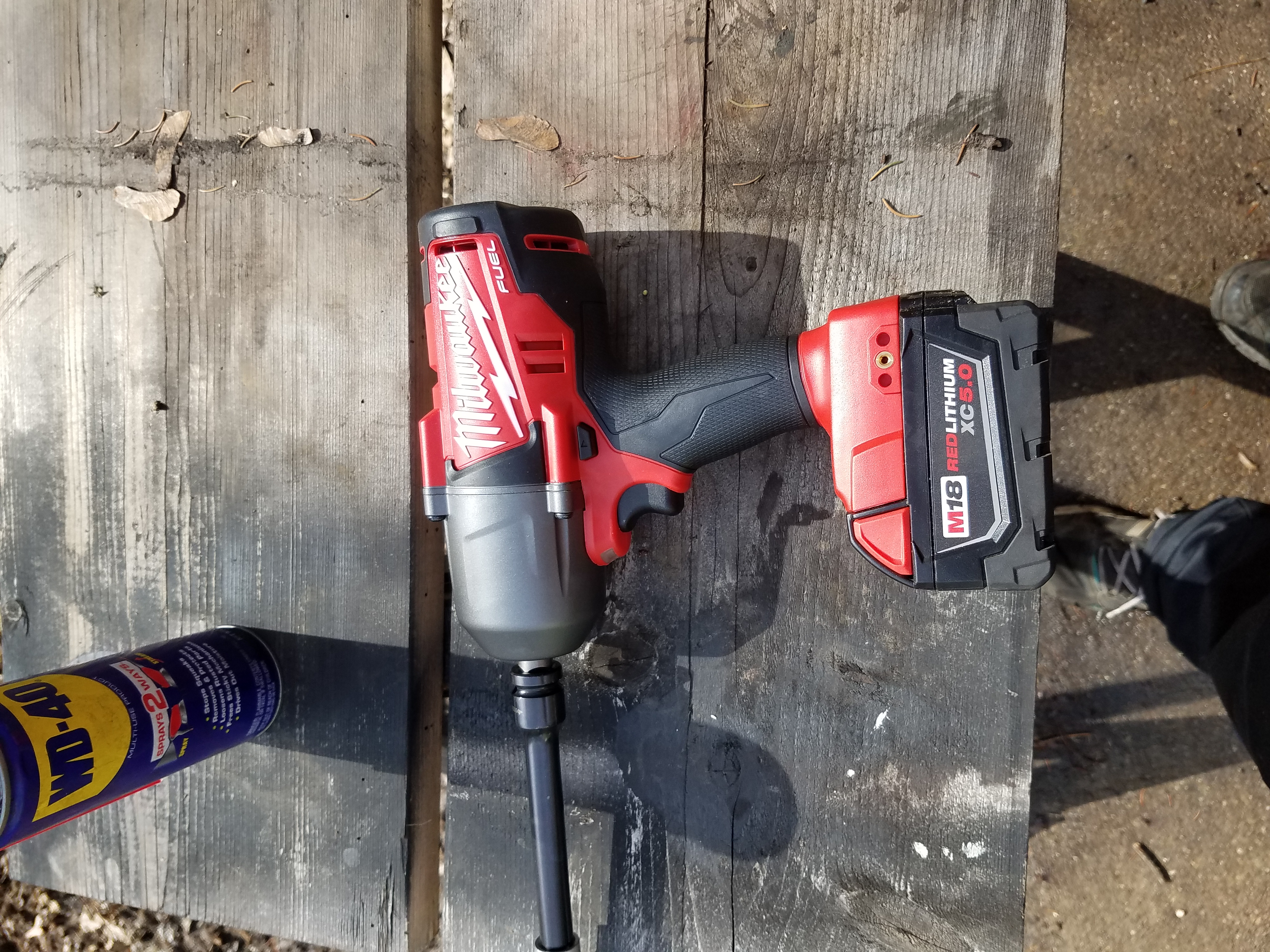

In other news, I got this milwaukee impact gun for a pretty good deal from Home Depot. Advertised 1100 ft lbs of 'nut-busting' torque.

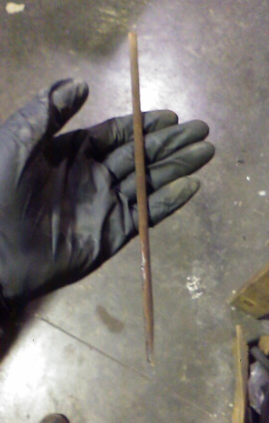

Dan found a stick in my gas tank :lol:
