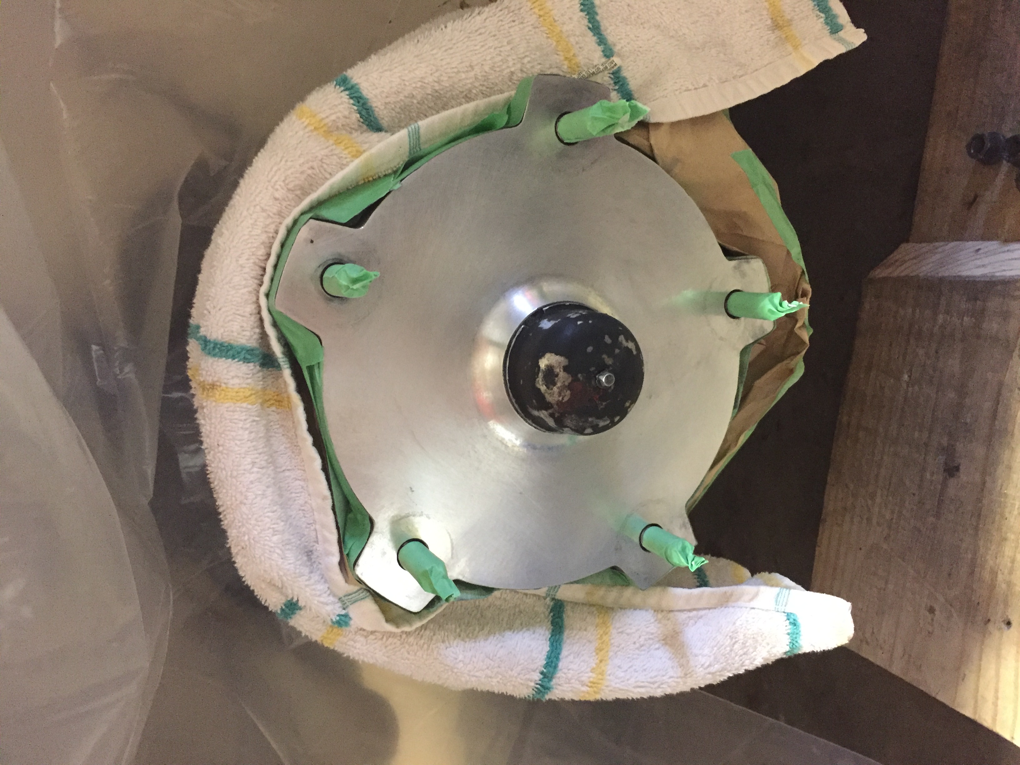

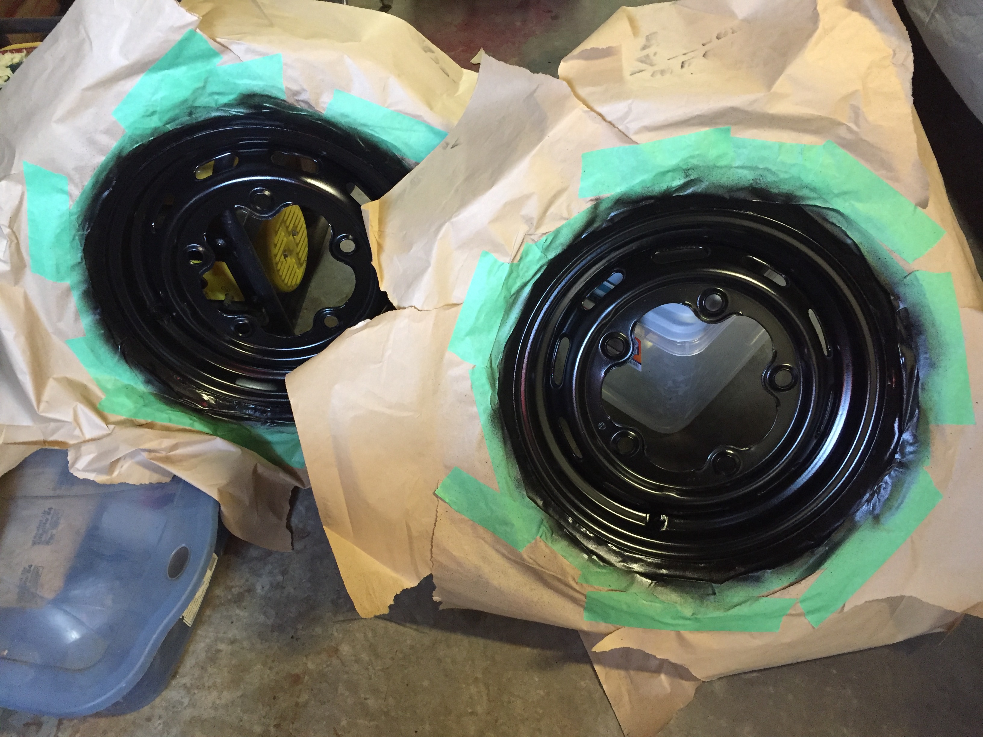

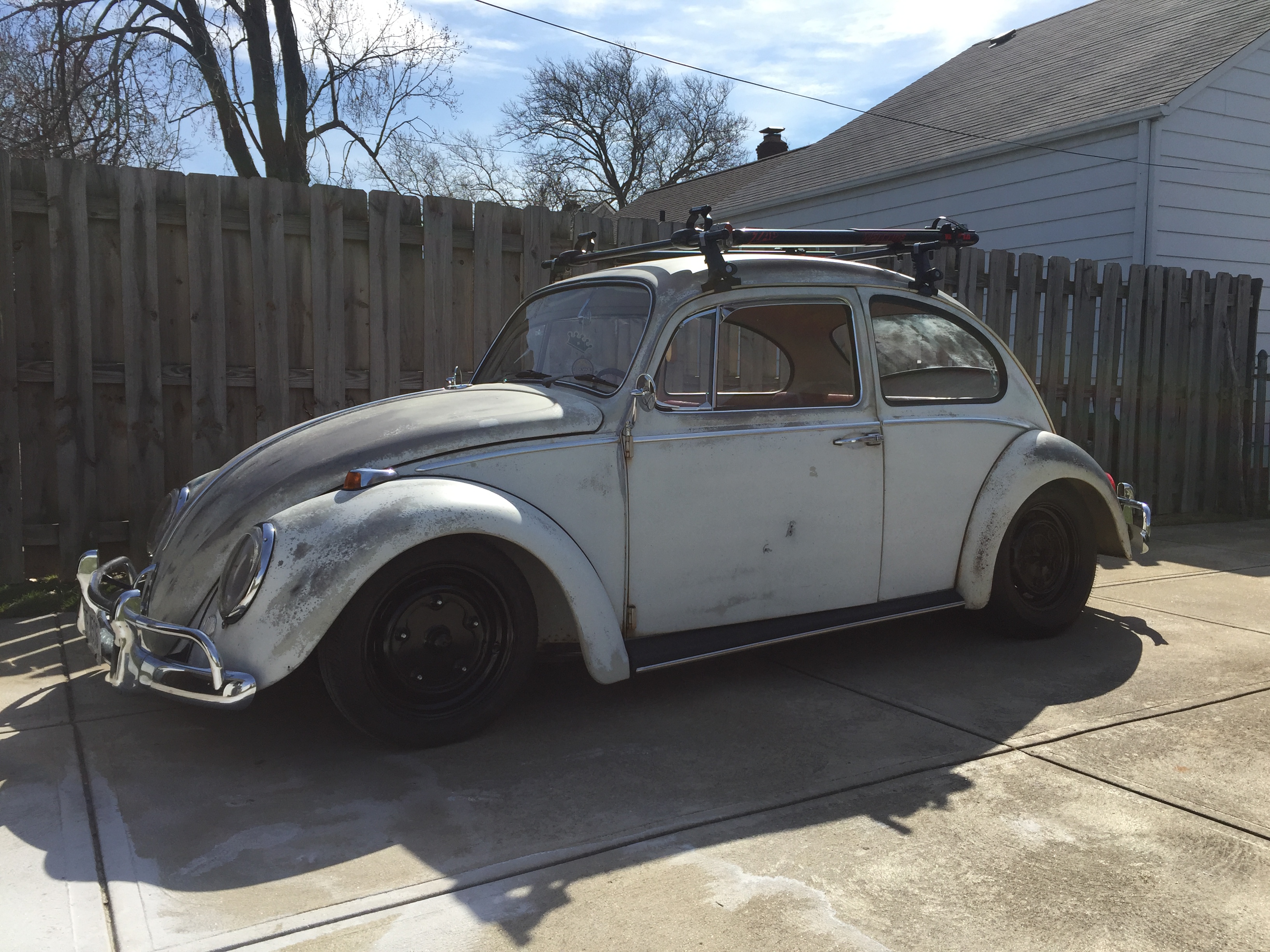

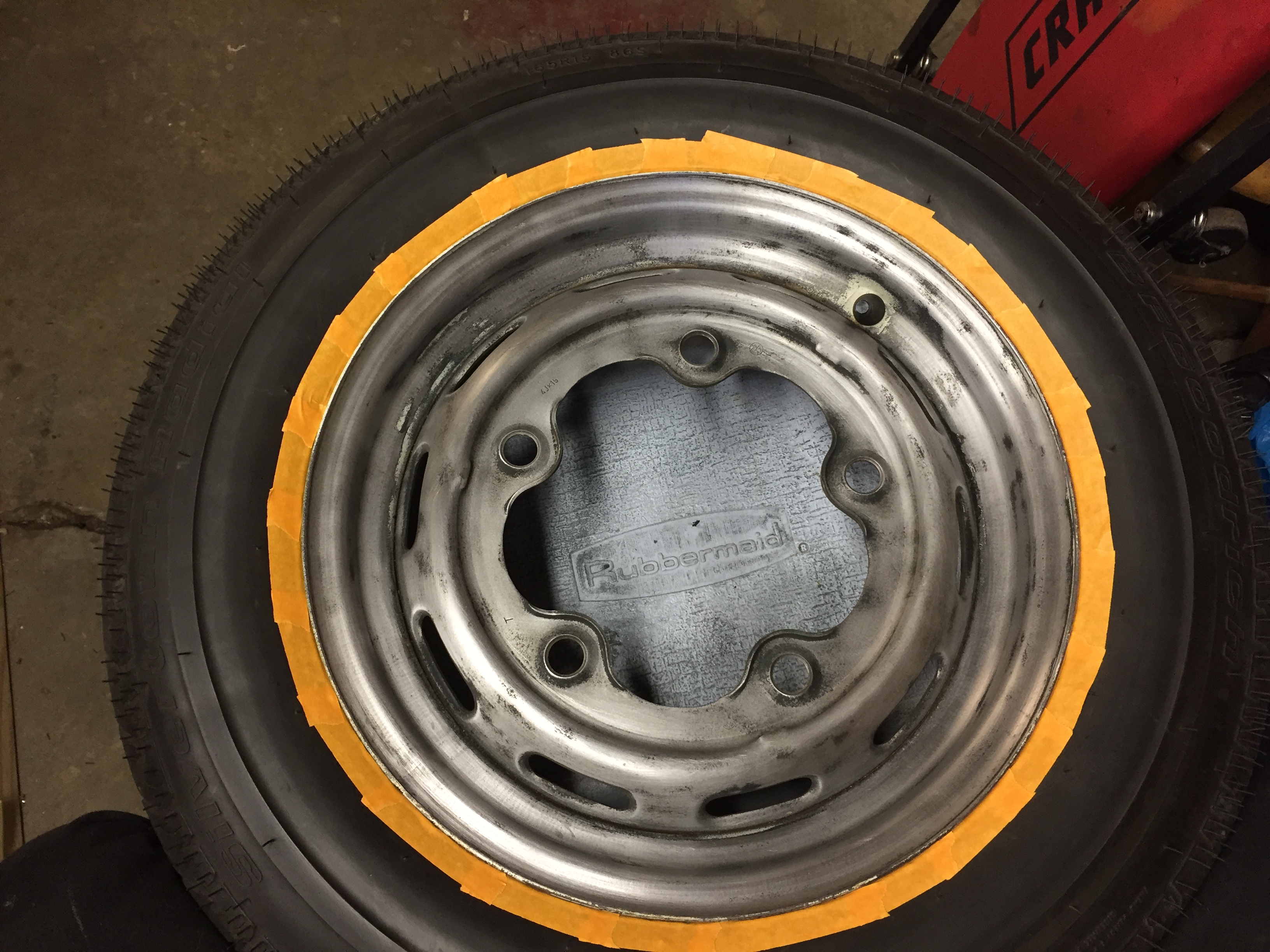

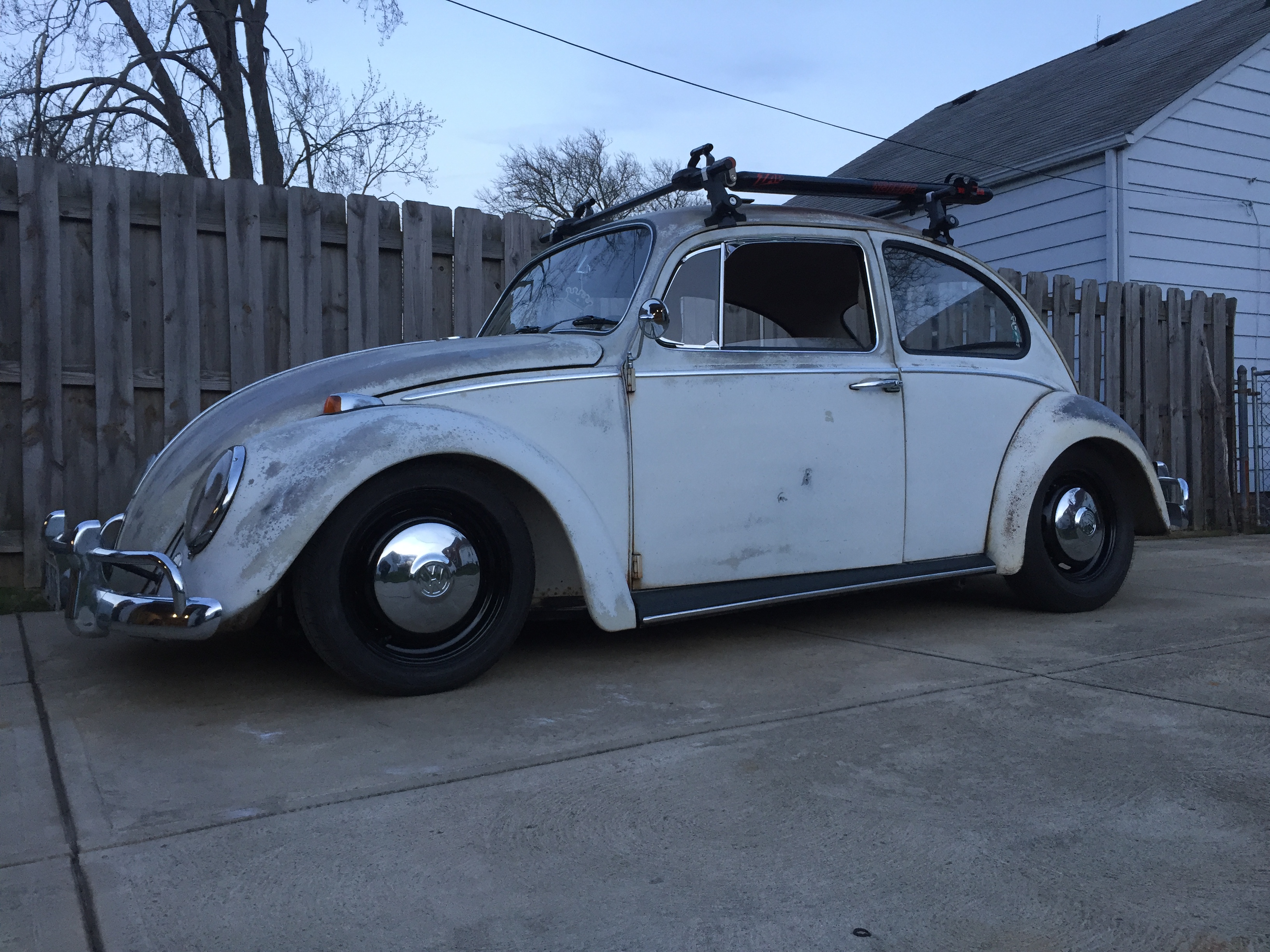

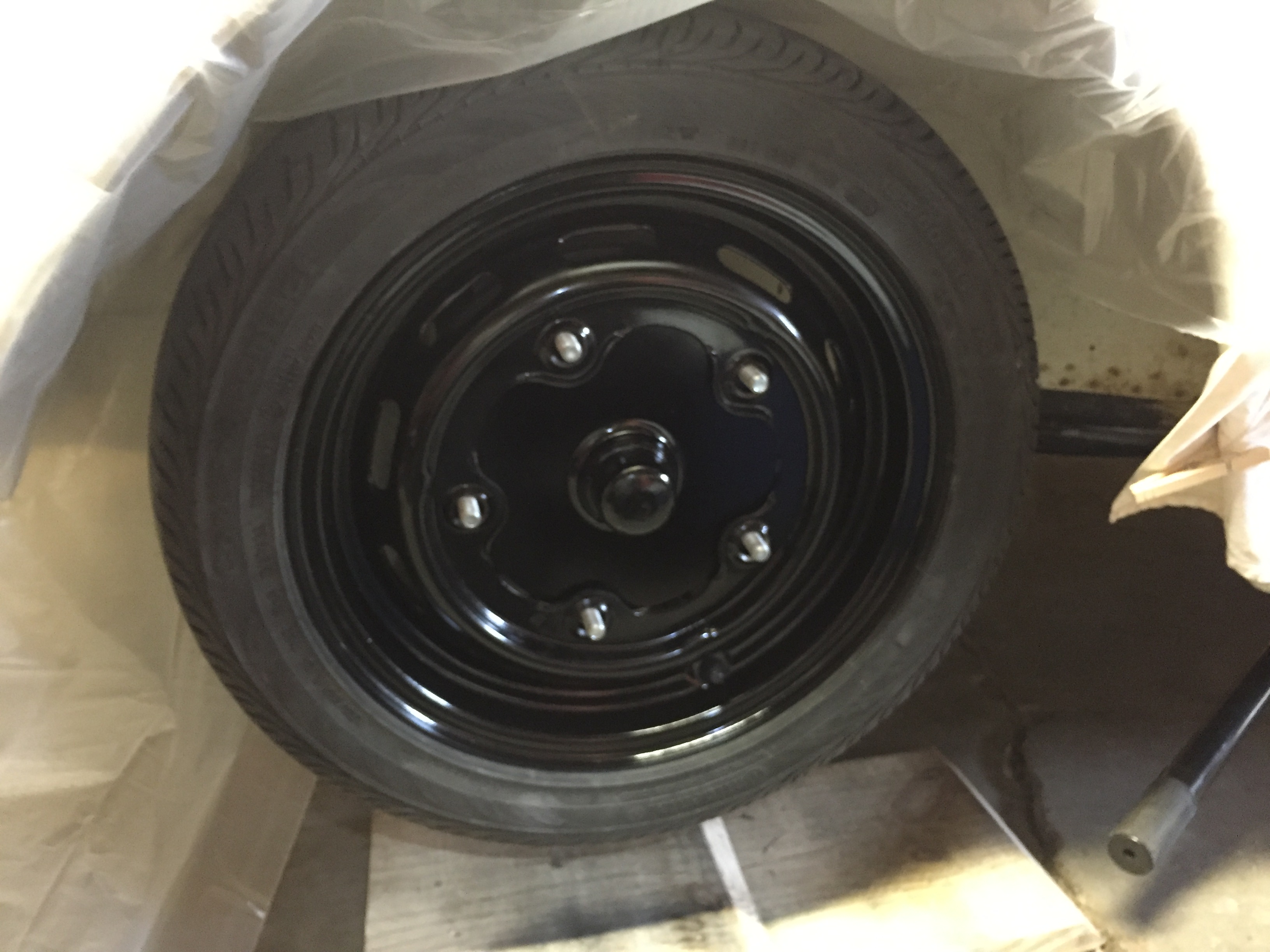

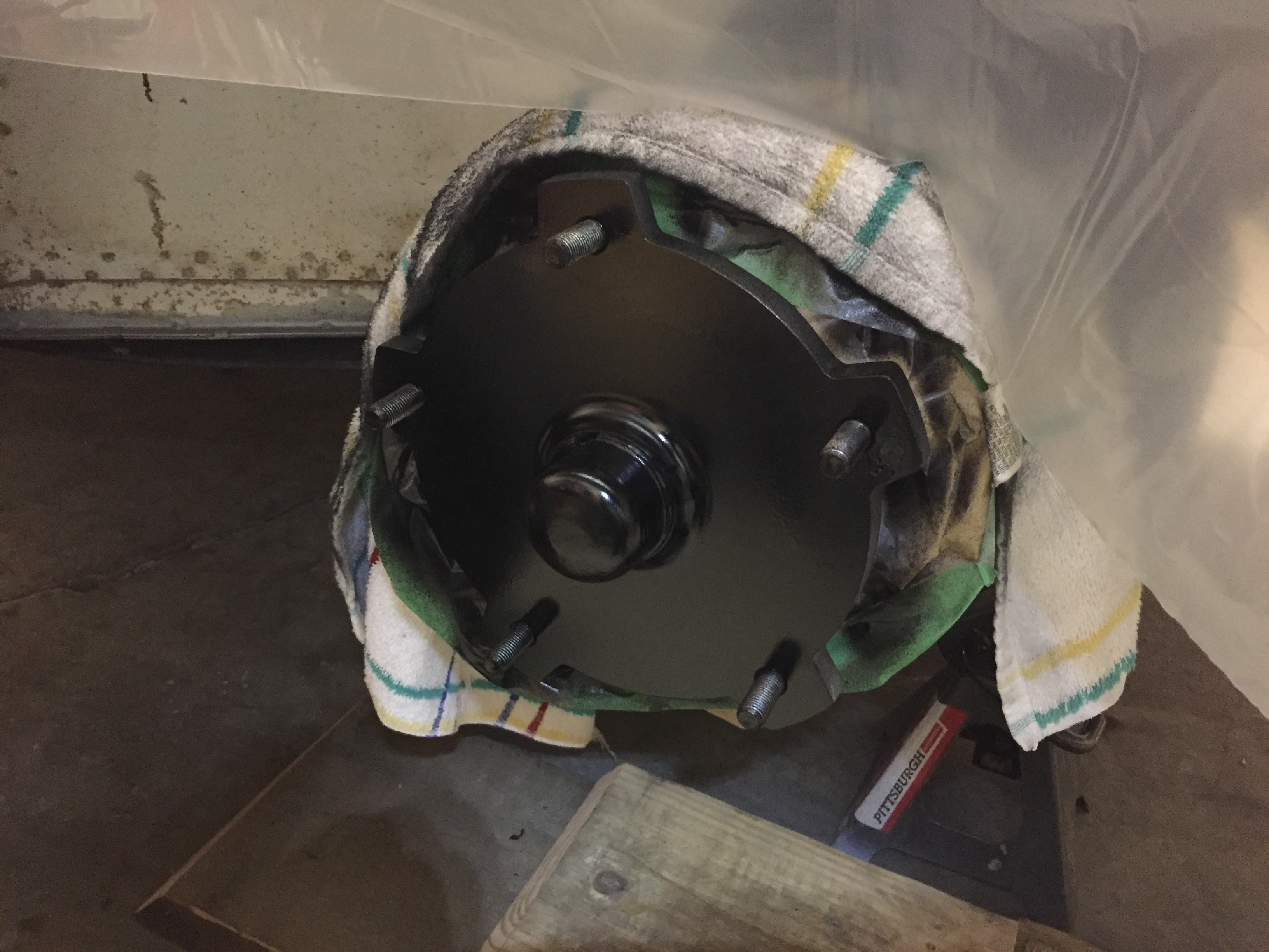

After Bruce installed the new CB Performance disc brake kit for the front, I decided that I wanted to find out what the car would look like with all black wheels. This is something I've struggled with because the wheels still had the original paint and I liked the way it looked. With new smoothie wheels on the wish list, I had been looking at what color to paint them. Now was a good time to figure that out and sacrifice the stock color or the original wheels. I have to say that I'm very happy with how they came out. Now the chrome hubcaps really stand out.
I prepped the wheels with a simple speed-blast gun from Eastwood using sand for the abrasive material. The old paint was gone in no time. I also used 220 grit to get the rest, then scotch brite to prep them for paint. I was not happy with the Eastwood primer paint at all. It didn't cover like I thought it should and took both cans back. I really think it was a bad batch. Two cans of Krylon gloss black and here they are. Two portable heaters in the garage to get the wheel surface somewhat warm on a frigid day in the garage. Since my garage barely fits the car, I covered the car with everything I could get my hands on to keep any overspray off. There was just enough room to set a wheel on the floor beside the car to paint. Plus a fan propped up at the doggie door on the garage door helped with ventilation. It actually works pretty well.
