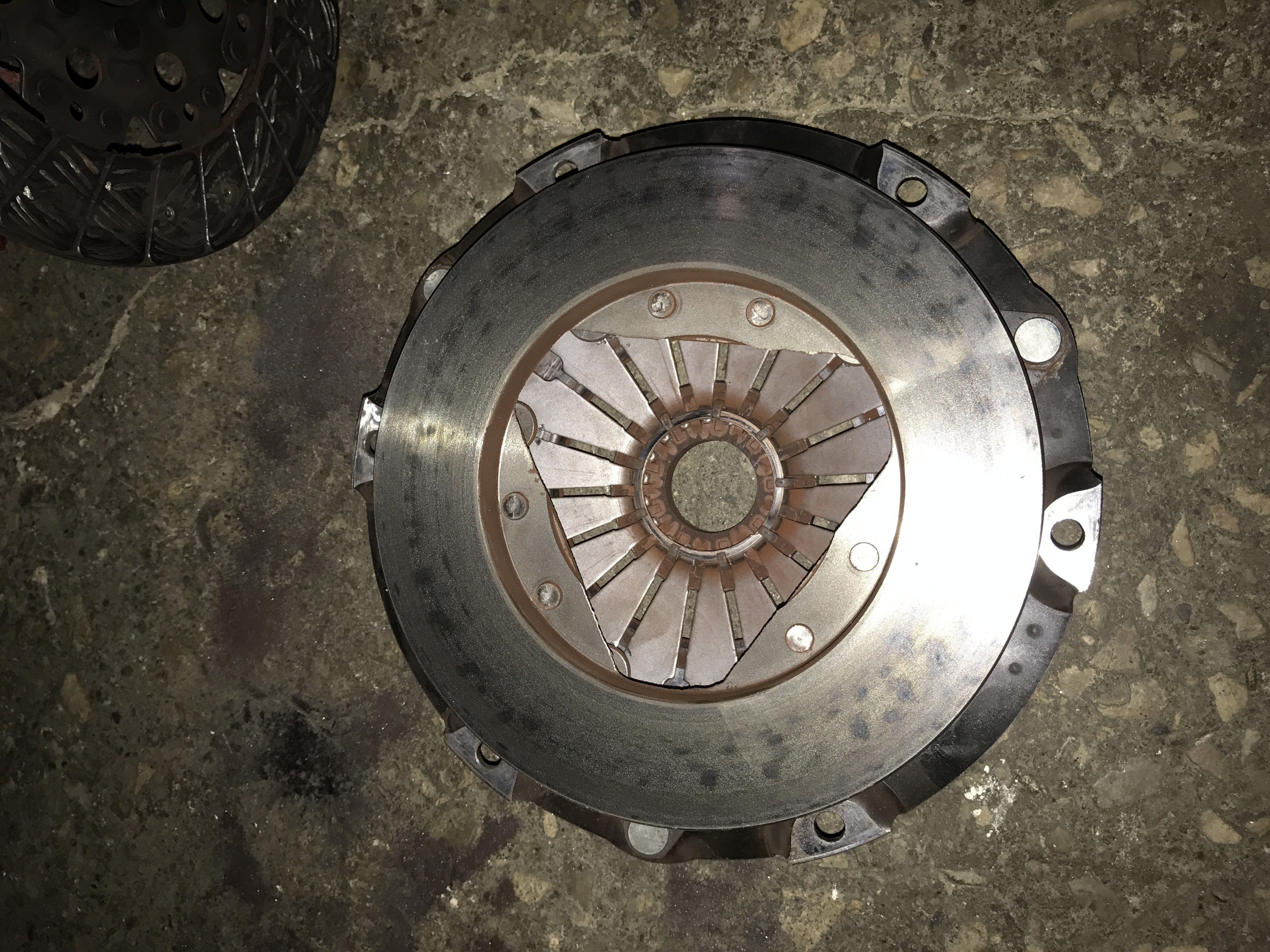

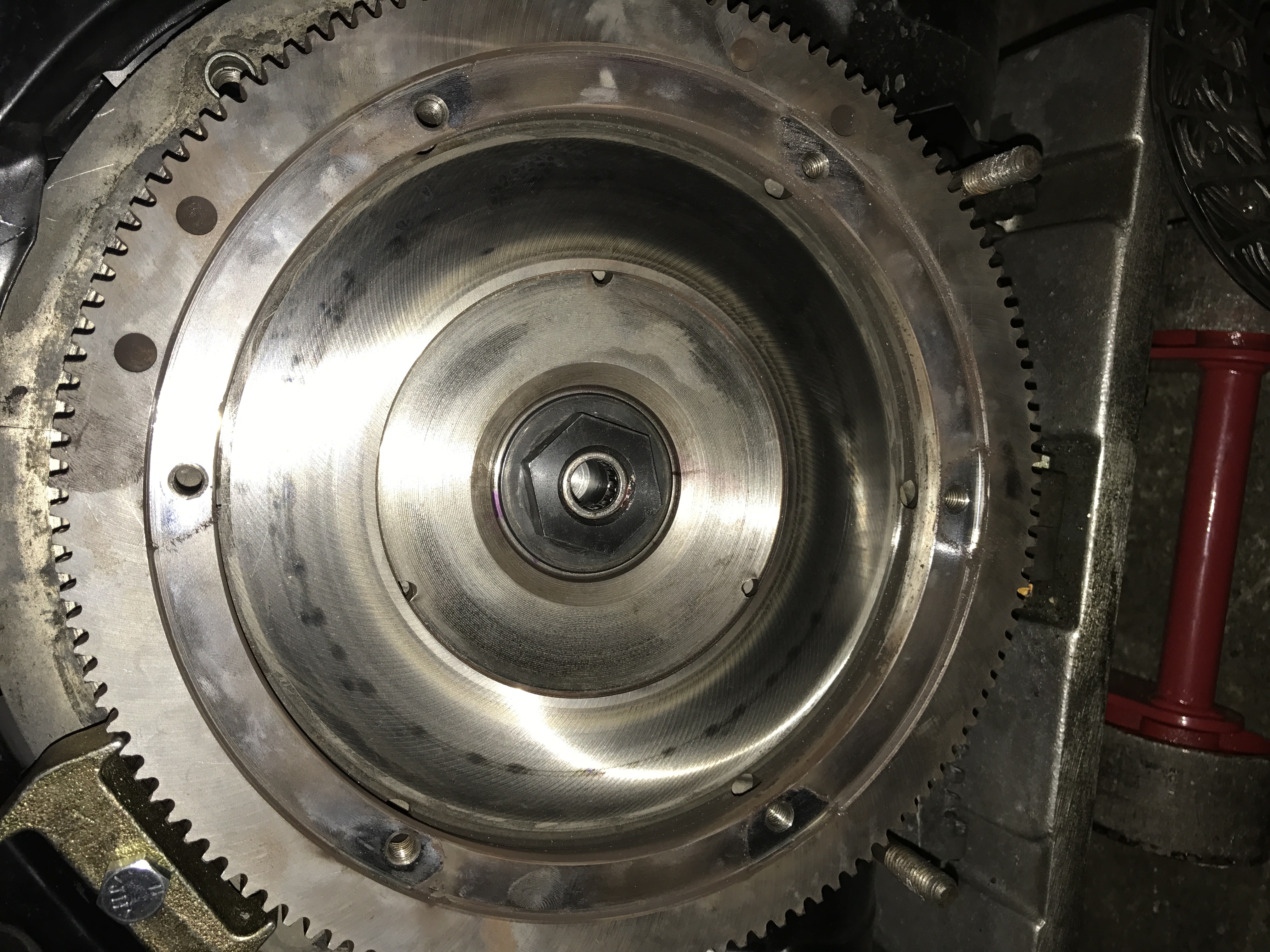

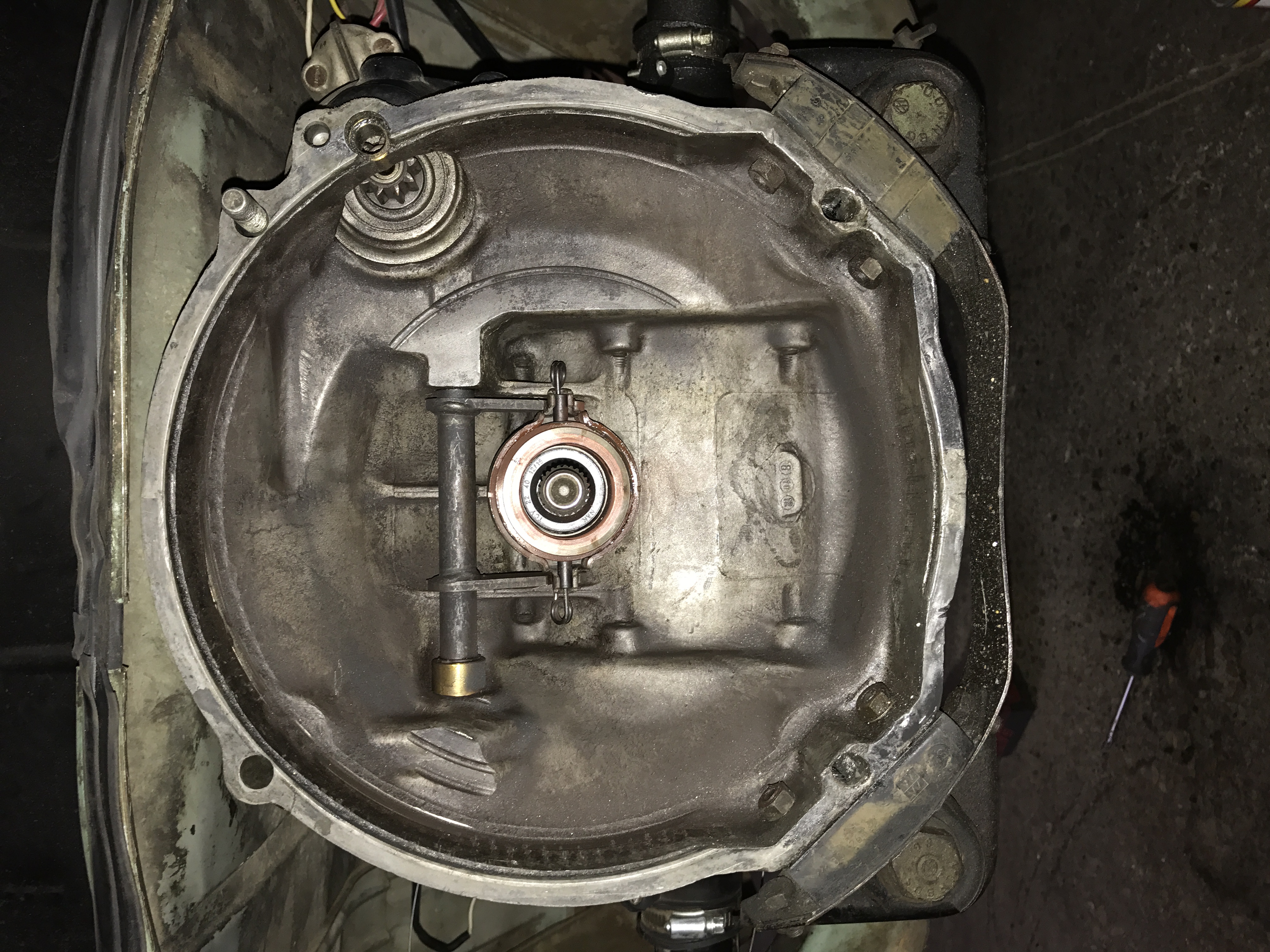

So, working on my clutch issues. Shifting had become harder and harder... and the clutch would grab with pedal to The floor. Adjusted the cable until almost no freeplay and same results. Added washers to
Bowden tube to give more bend. Then put in new cable and and bowden tube and still the same. Just pulled the motor and everything inside looks fine. Pressure plate, disc, and T/O bearing look fine. HD cross shaft and forks still look as beefy and straight as ever. I will put in a new T/O bearing since i had to drive with no freeplay to get home. Im really stumped here... Do I need a new PP? Its a nice Kennedy stg 1 and looks fine...
Put the PP on the floor face down and step on it with your foot. With your (ample) body weight you should be able to press it to see if it feels like it operates smooth and even. If you have a tranny input shaft that you're using to align the clutch, put the disc on it, stick it in the flywheel, and make sure it looks like it's running true (not warped) to the FW. If all of this looks good you'll need to swap out the PP or disc and stick the motor back in with one top bolt. Adj the clutch freeplay, put the tranny in high gear, and have your buddy push the clutch pedal to the floor. Lock one rear wheel with a block of wood and when the pedal is down the tire, tranny, and cl disc should all rotate without drag. As your buddy raises the pedal you should feel the normal point where the cl grabs and the tire will lock. He pushes down on the pedal and the tire will spin free again. This confirms clutch grab and release without the trouble of putting the whole f'ing thing back together to see if it works.

Make sure your clutch tube didn't break loose where it's welded to the torsion housing.
If it isn't broken, weld it up more anyhow. You actually drive your Bus, so it will break eventually.
Big thanks to Widefive for clueing me into the broken cable tube weld. My Clutch cable tube did in fact break free of its welds from the torsion housing and definitely flexes a surprising amount under load. It flexed so much its hopped over the accelerator cable tube and it is jammed up next to the front tranny mount. Hopefully that resolves my issue and gets me rolling again!

Good news everyone! None of that helped! Even went through Bruce's diagnostic sequence and still having the trouble of little to no disengagement. This Kennedy pressure plate was one of the few parts reused from the old motor and it seems it's time is done (or so I hope...). So I called around for a new clutch kit and LA Products had one on the shelf. So I ran down and picked up a stock Sachs kit with new PP and disc. Perhaps this is a lesson in futility and ole smokey blu doesn't want to goto Mohican. Perhaps fixing the wiper linkage and installing wiper arms and blades upset the balance of the force. Perhaps its time to bribe Chuck somehow and borrow his perfect in every way doka. More tomorrow.
