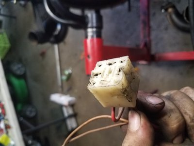

Just about done. Have some wiring concerns though
Mainly this plug. It is on the harness that connects the double relay to the starter, reverse light switches, etc.

Looking good Austin
That relay plug has seen better days but if it still has the spades in good shape then it should be fine. If it was cracked or something then that would be a problem. Almost there!

TRL wrote: Wed Jun 14, 2017 9:17 pm That relay plug has seen better days but if it still has the spades in good shape then it should be fine. If it was cracked or something then that would be a problem. Almost there!
The spades are pretty bent up
The spade connectors can be extracted. New ones installed on the wire and re inserted. Best to do them one at a time.
