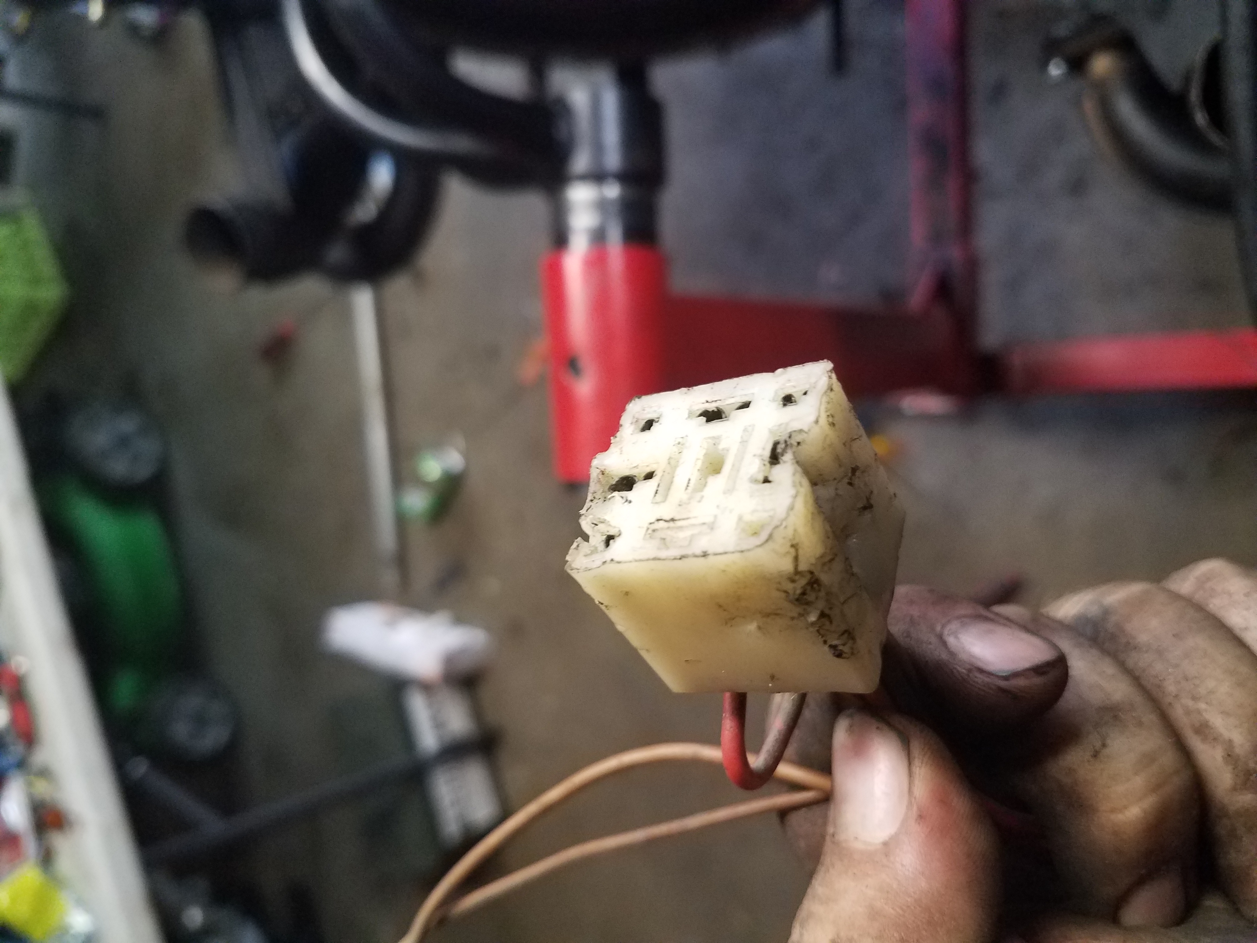

Mainly this plug. It is on the harness that connects the double relay to the starter, reverse light switches, etc.

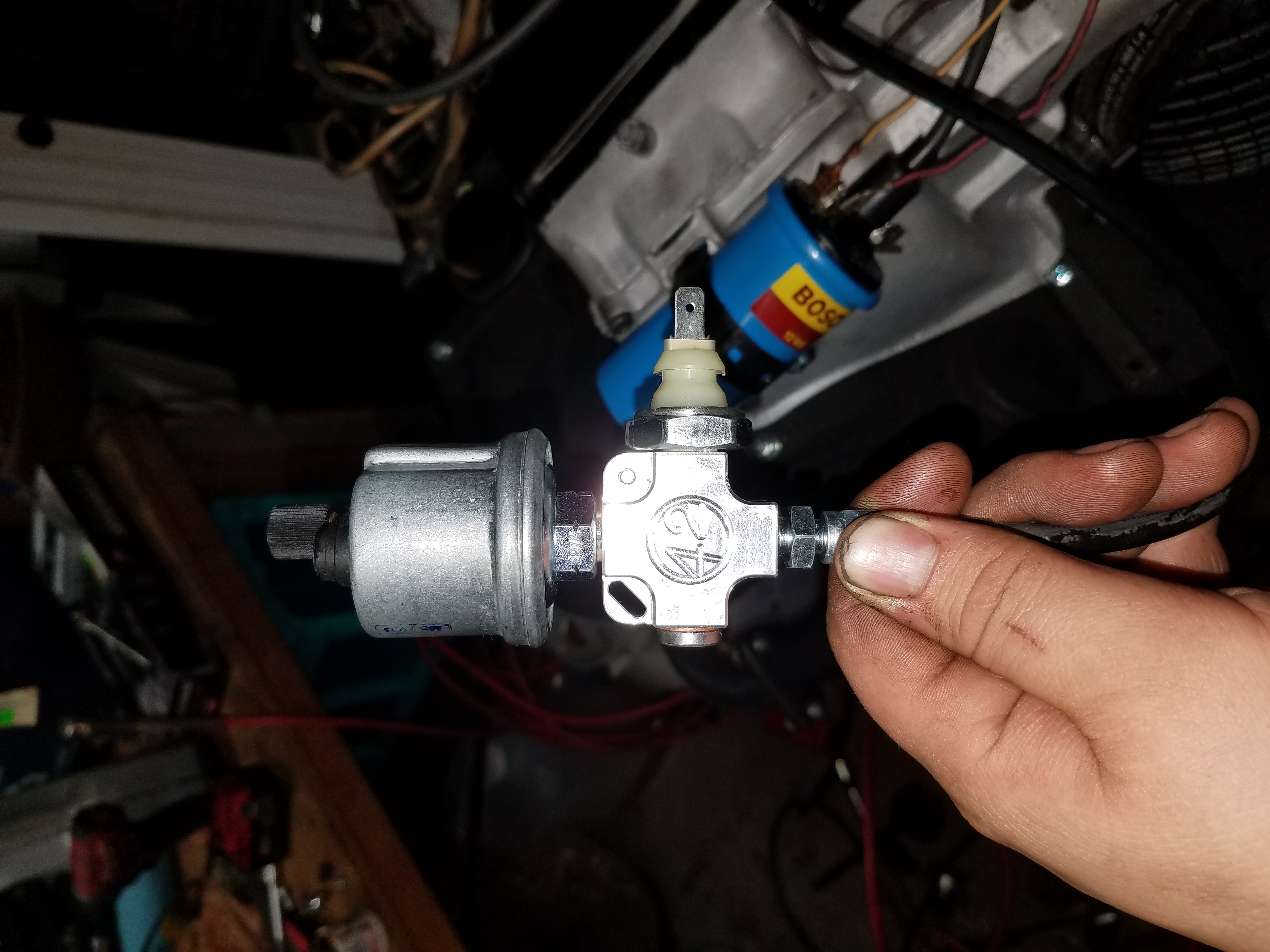

Dakota digital sender and original oil pressure switch on a tee for remote mounting on the firewall.

That relay plug has seen better days but if it still has the spades in good shape then it should be fine. If it was cracked or something then that would be a problem. Almost there!
Thanks Bill
The spades are pretty bent upTRL wrote: Wed Jun 14, 2017 9:17 pm That relay plug has seen better days but if it still has the spades in good shape then it should be fine. If it was cracked or something then that would be a problem. Almost there!
The spade connectors can be extracted. New ones installed on the wire and re inserted. Best to do them one at a time.
