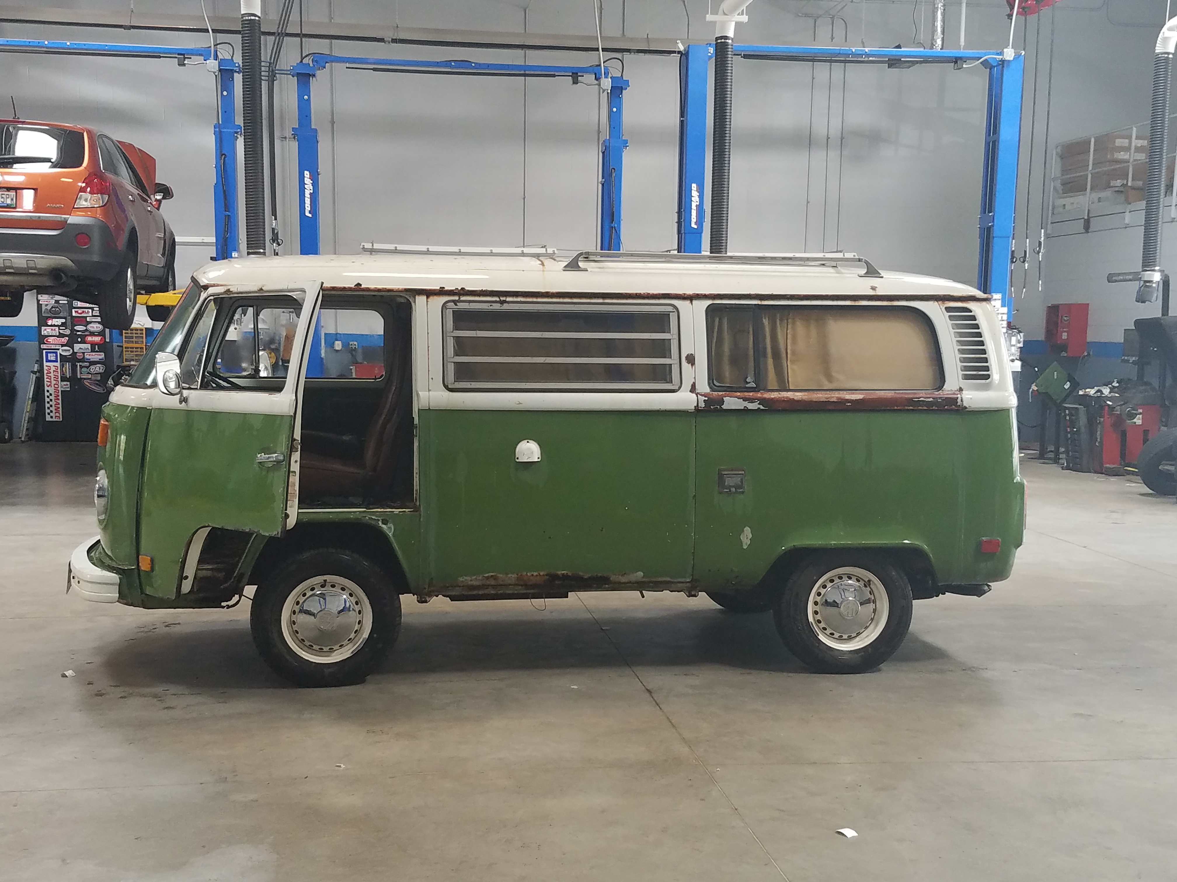

The bus really swayed on the highway during my drives on Friday. I took it to work with me on Saturday and installed my new Koni shocks and a new Cofap steering damper. Rides way better now. Also washed it and put the hubcaps on.
