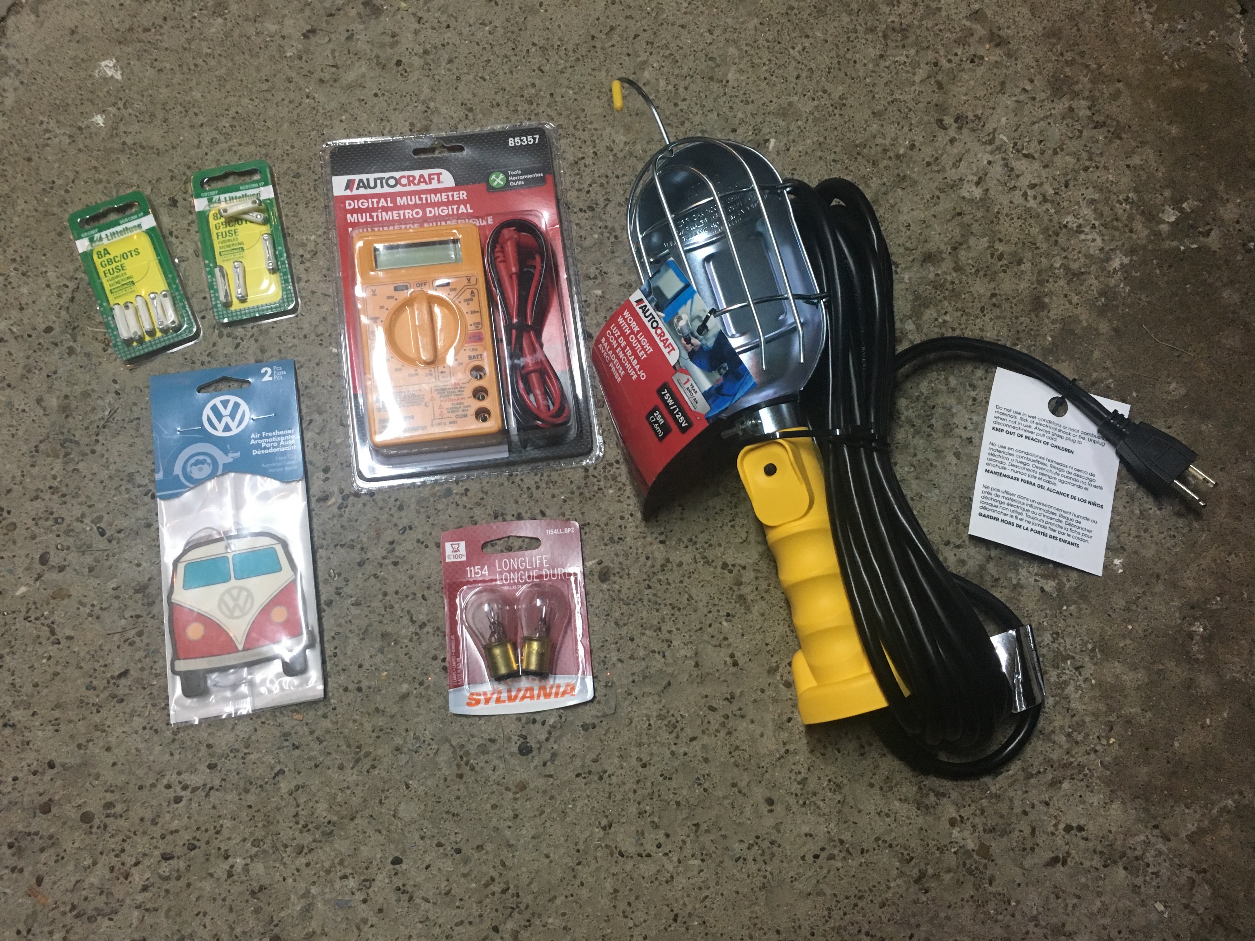

Just got back from Advanced Auto Parts...here is my bounty. Did I get the right kind of Voltmeter? I'm going to venture underneath tomorrow after work and check out this brake light switch aka "the creature"

That multimeter will work.
You might also want to get a 12v test light

Those 1154 bulbs will work for about 5 minutes and be very bright and burn out. They are 6 volt, you need 1157 that are for 12 volt cars get some 1156 too.

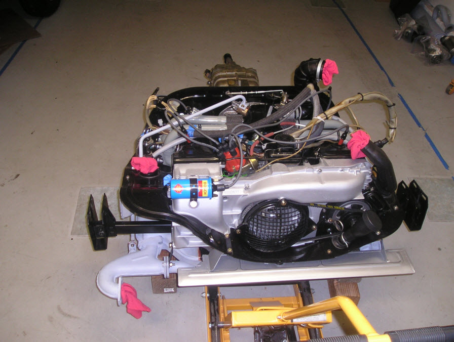

This is what your engine should look like...

Put an LED bulb in that lite. Incandecant gets too hot.

PS +1 on the LED bulb- Bill's talking about the trouble light, not your bus. LEDs run cool, plus they don't break when you drop them.

I'll take the bulbs back and get the 1157 and 1156, and also pick up a 12v test light. Anything else that is a must have in the garage at the moment?

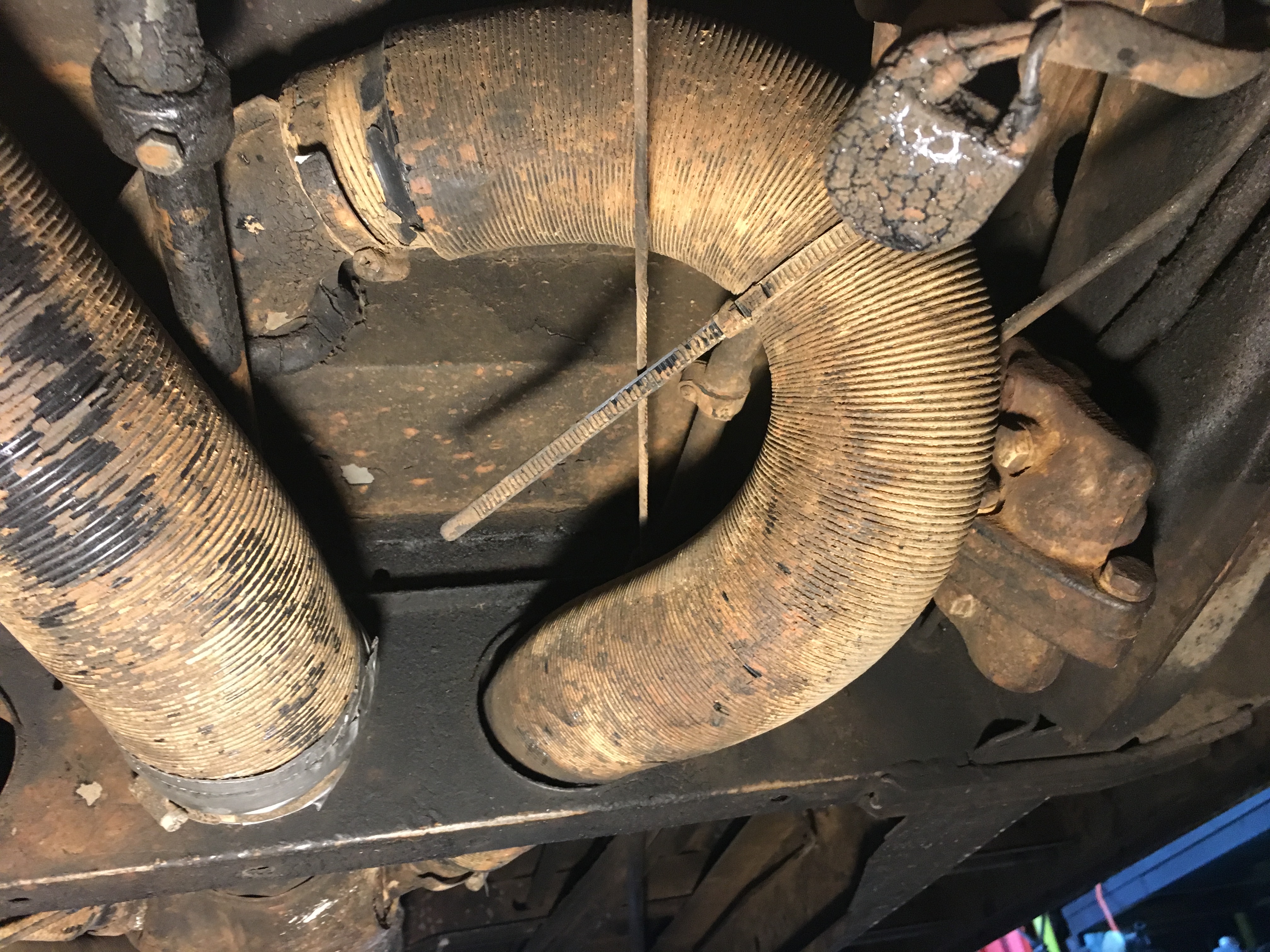

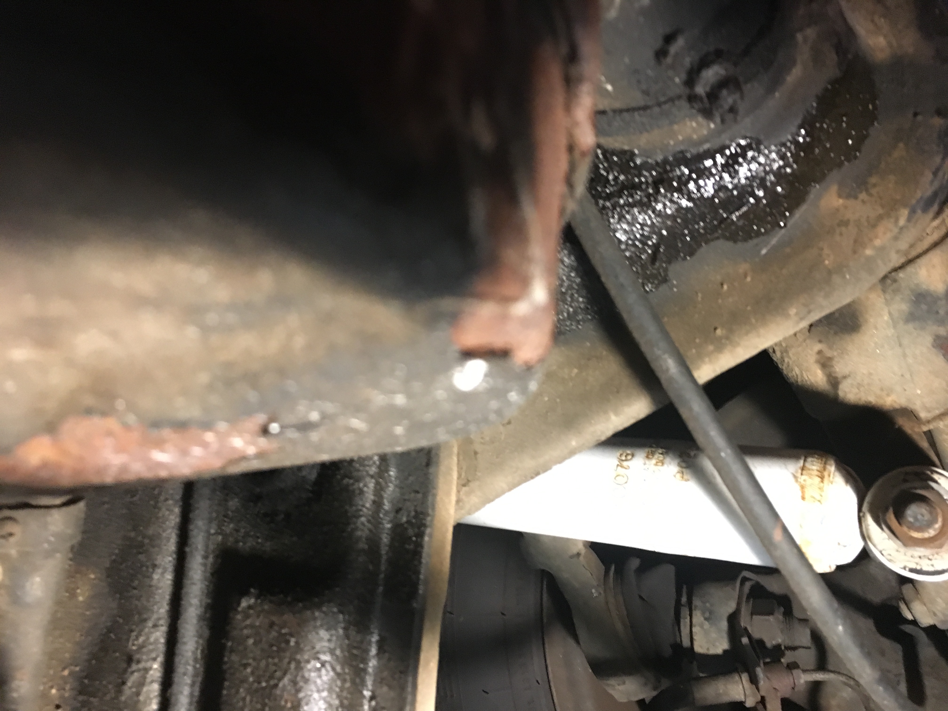

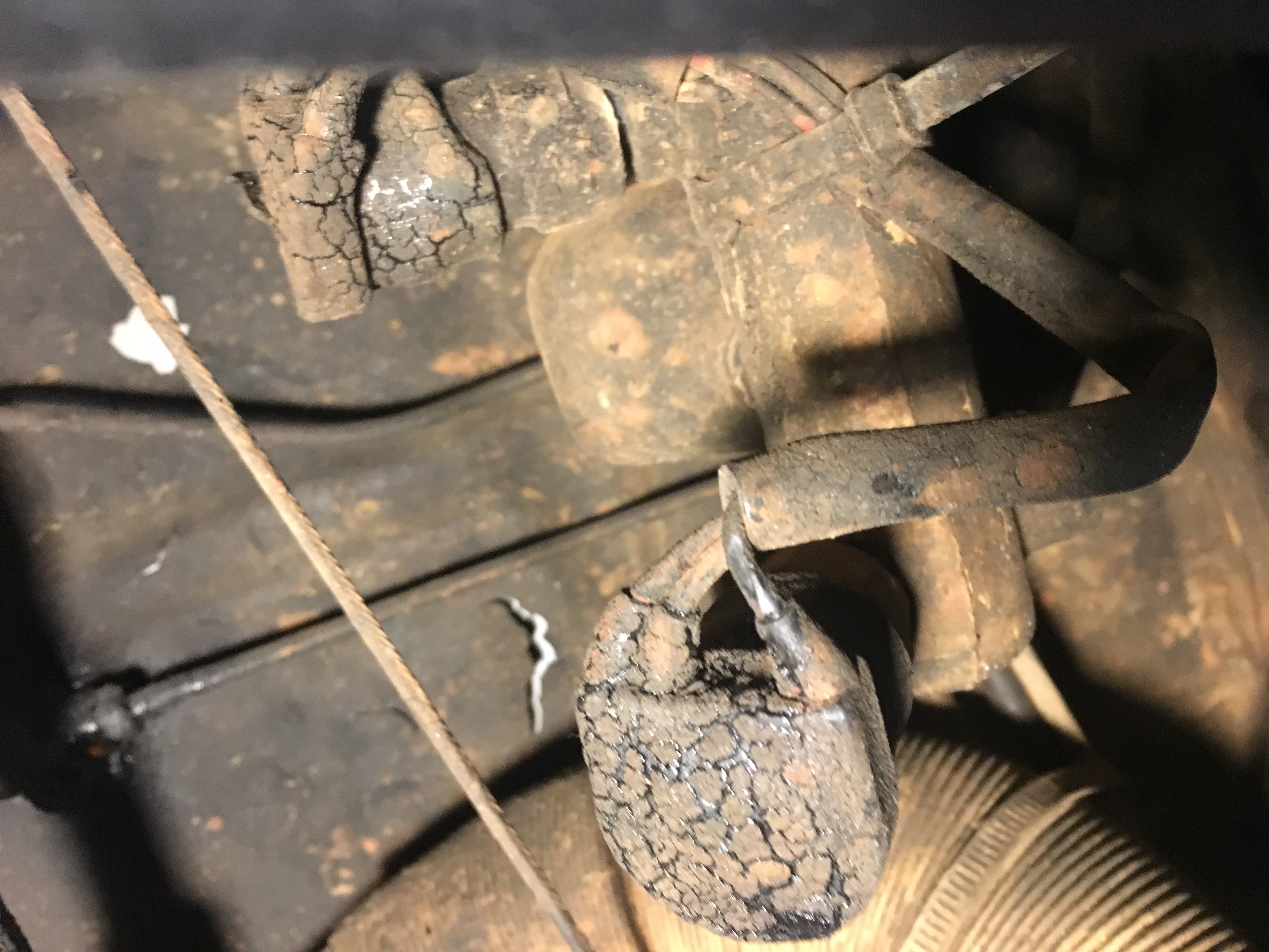

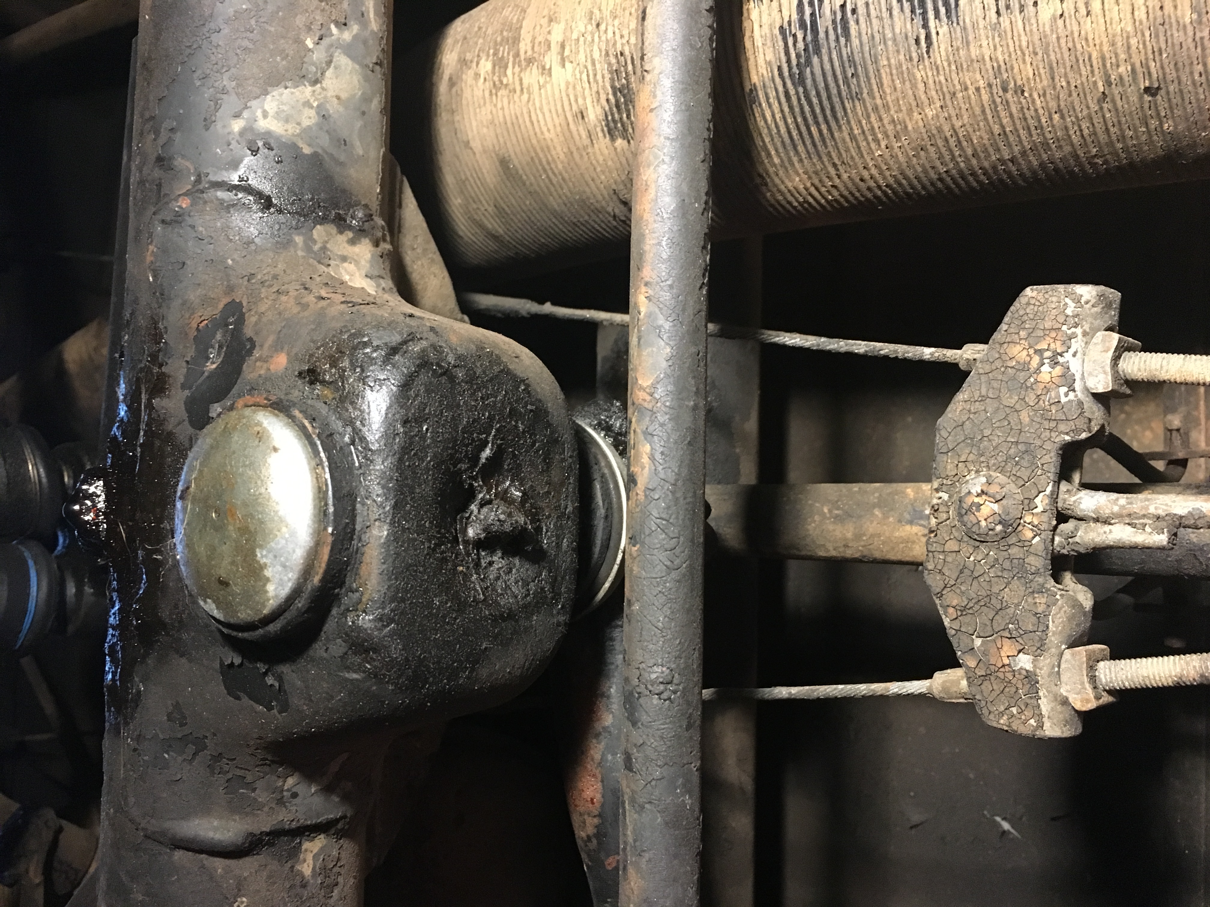

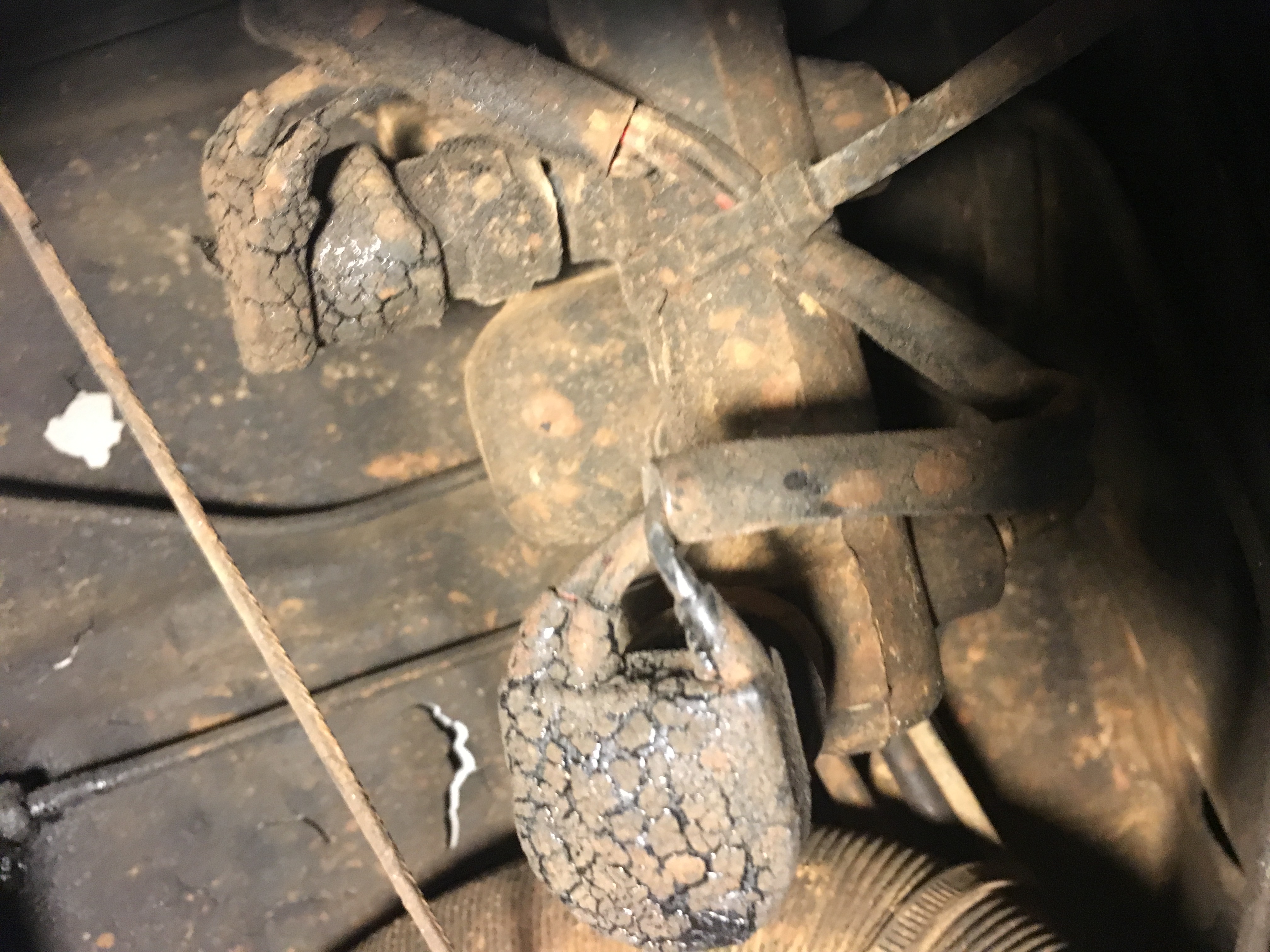

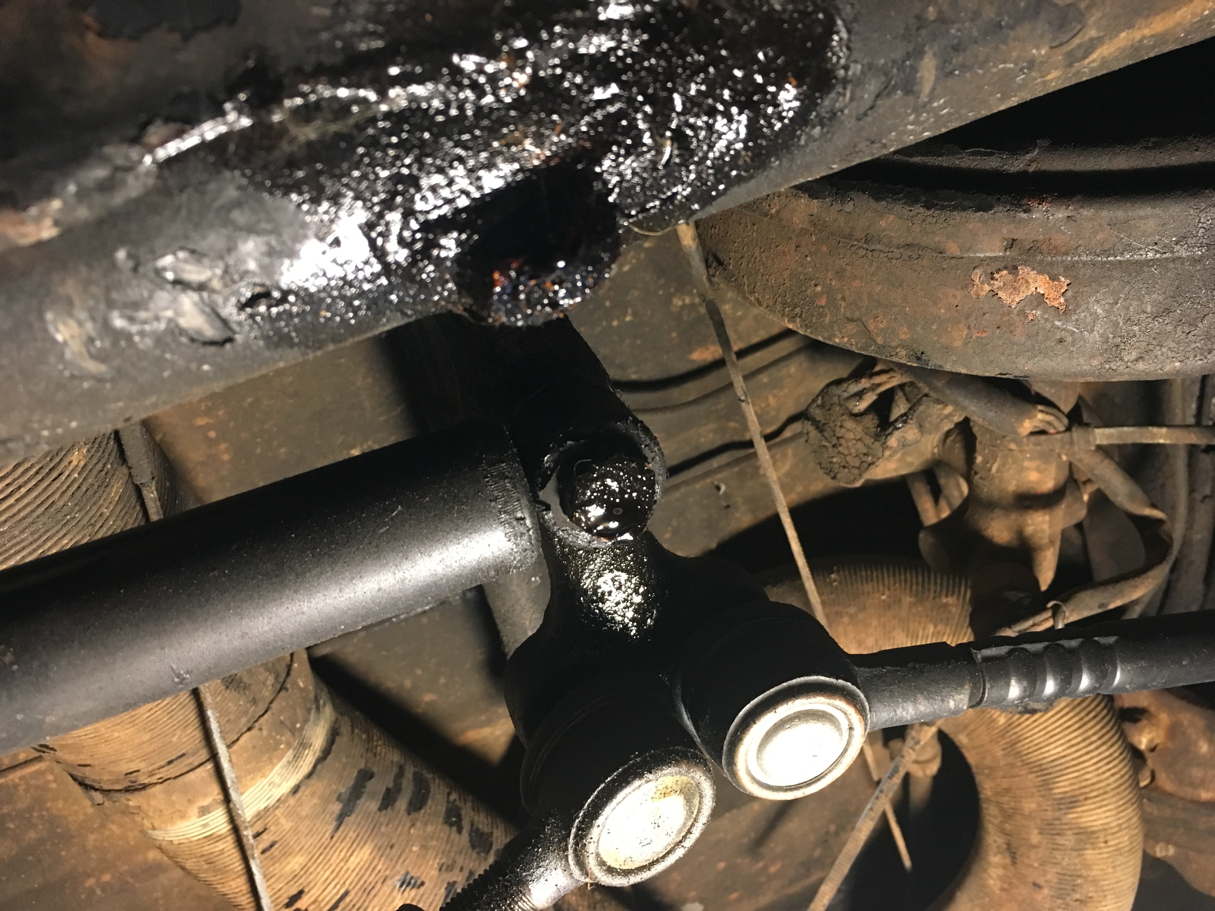

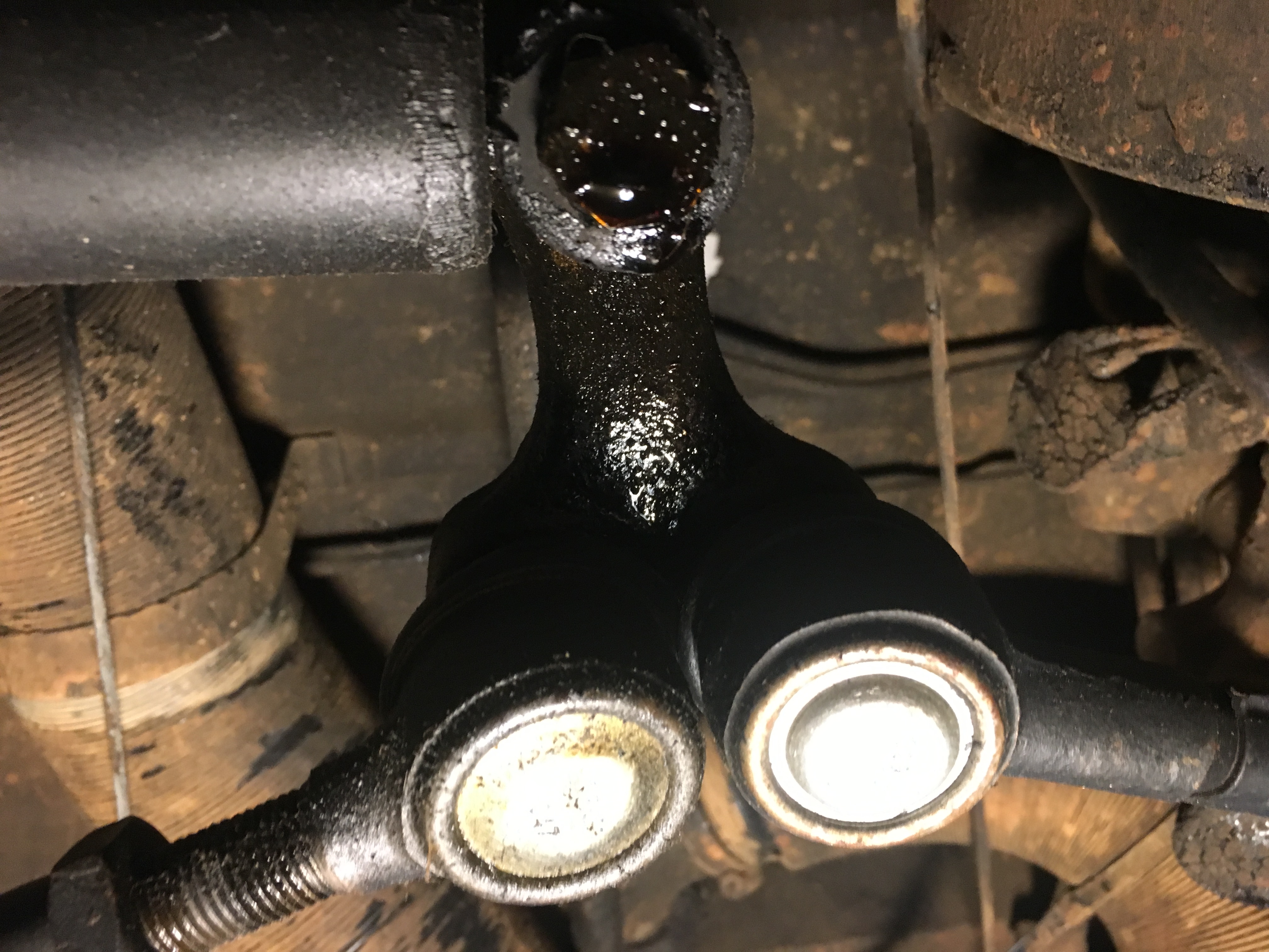

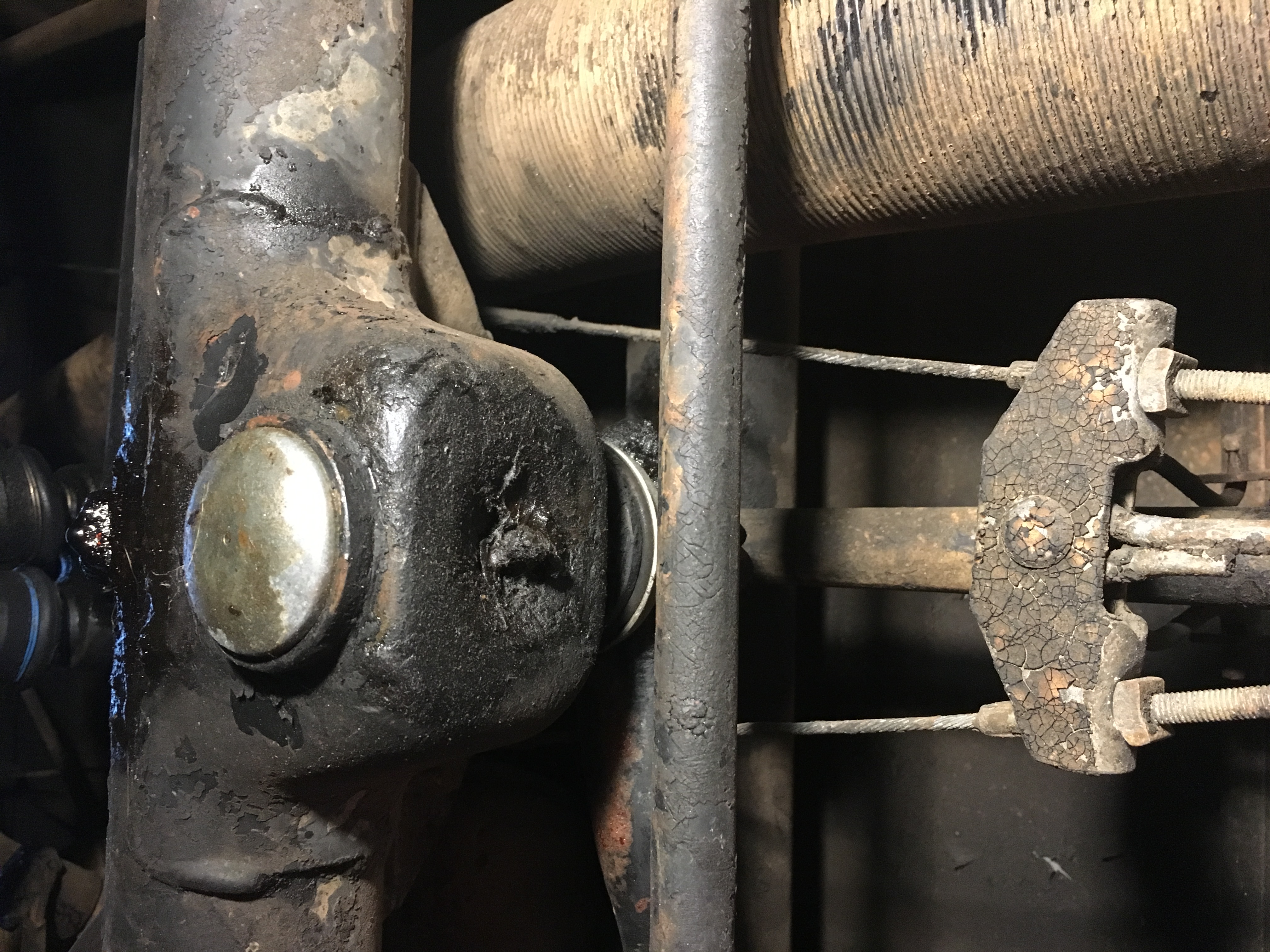

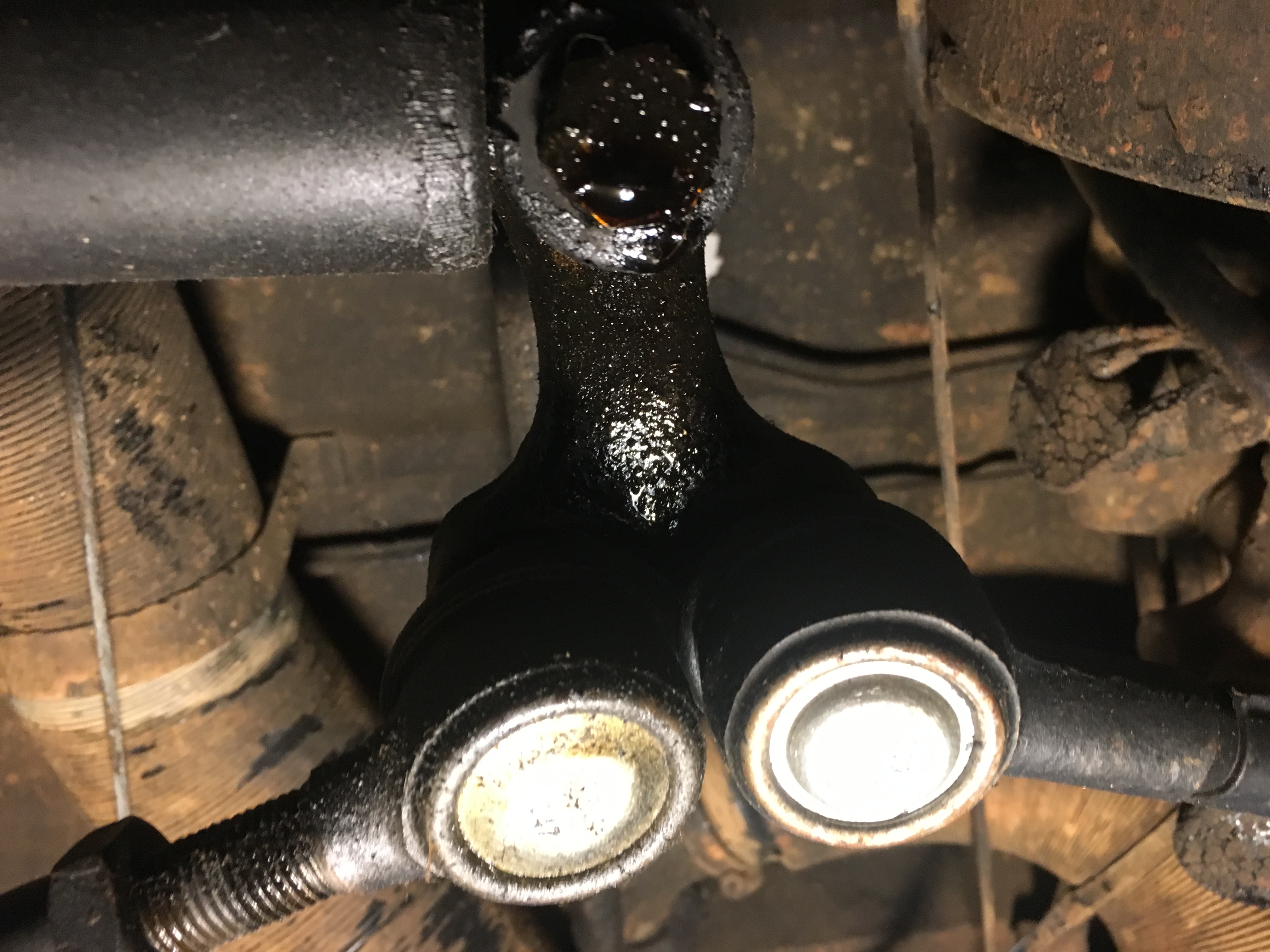

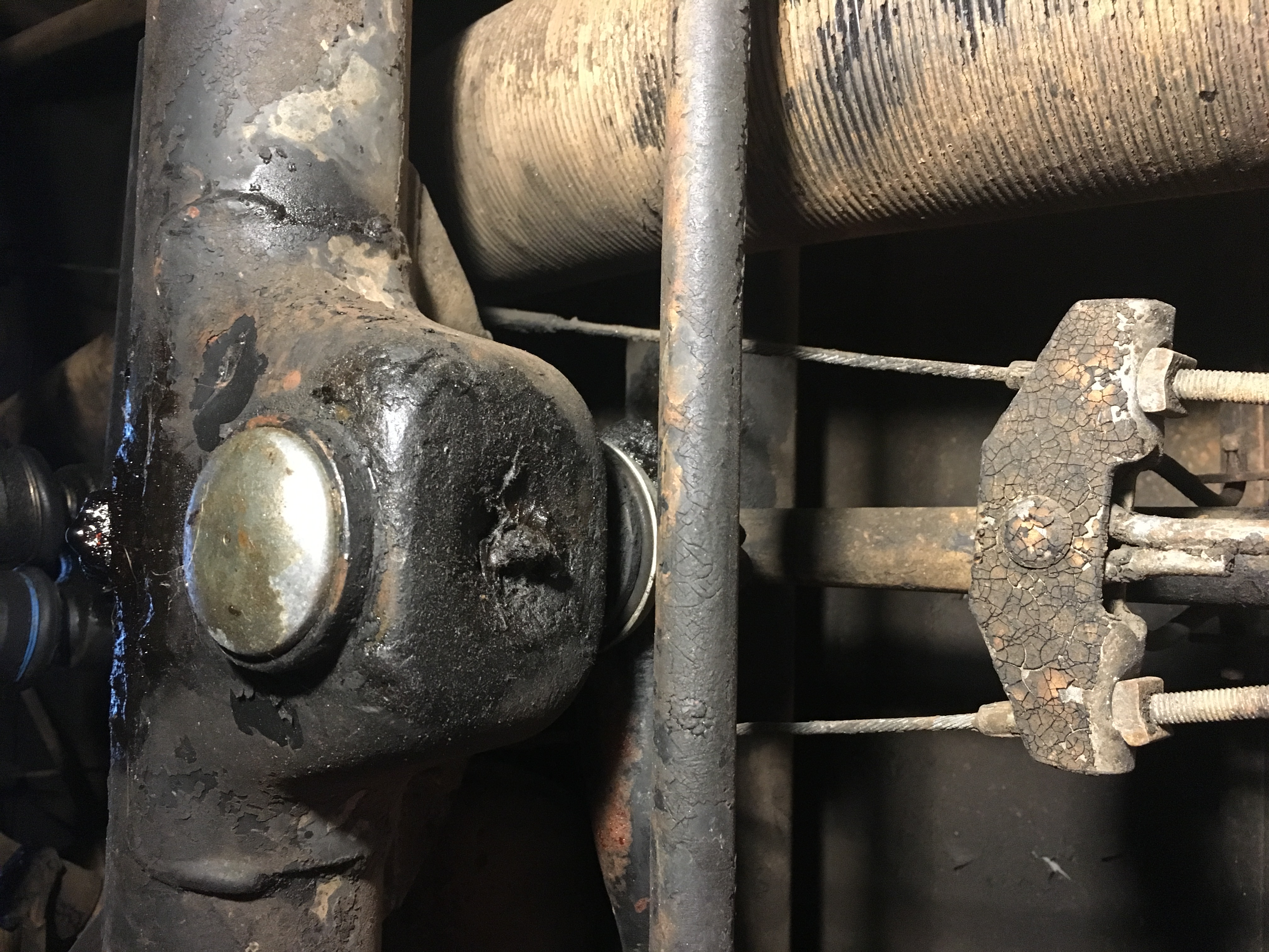

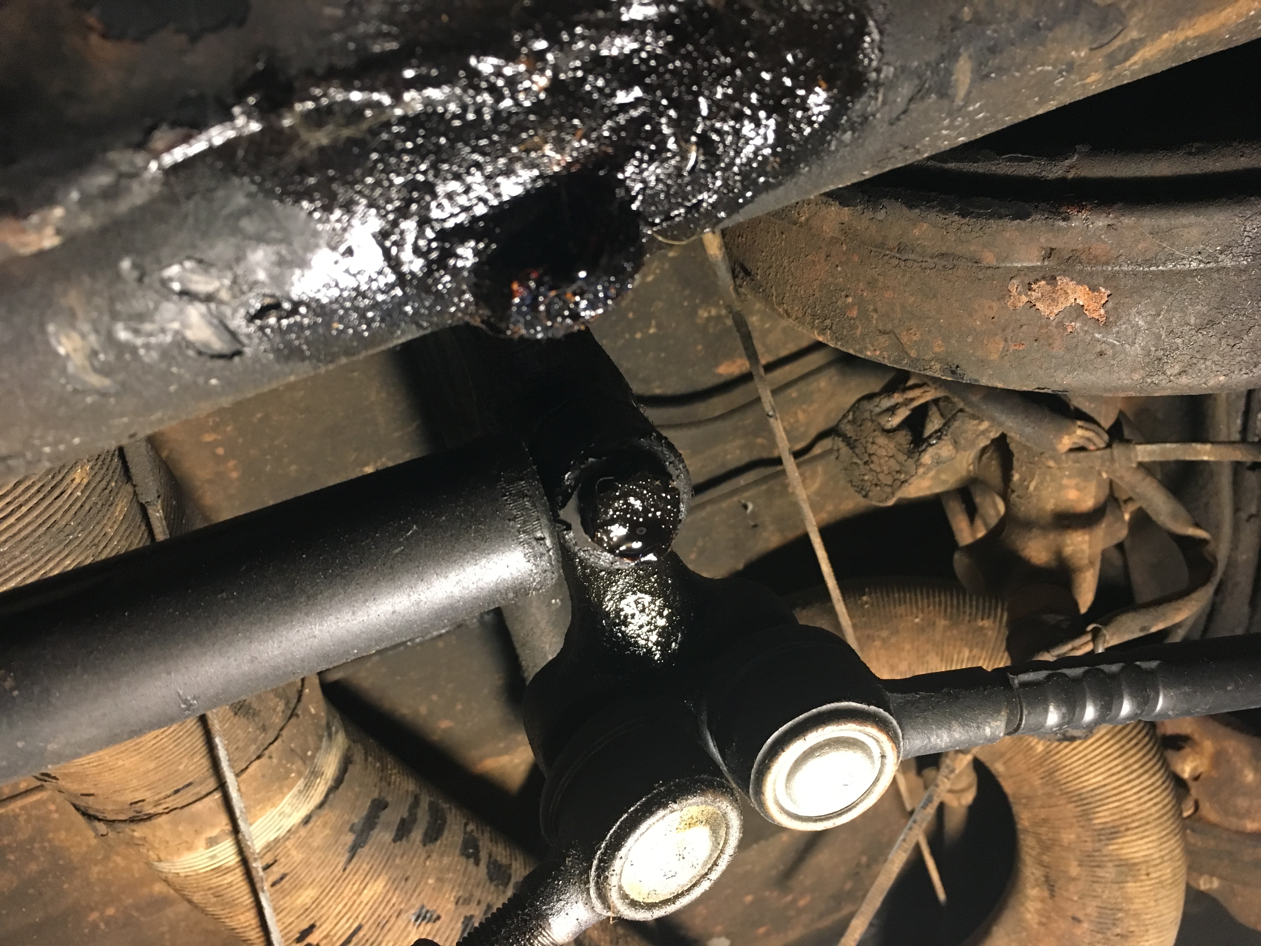

well I'm back. I ventured underneath. I took the pan off but I can't find the brake light switch. I see two black things with wires connected to them but they weren't underneath the pan and they are pretty corroded. They have what I would describe as caps on them so I can't see how the wires are connected. I was a little hesitant to go poking and prodding. I did take a bunch of photos of underneath. I'm not an expert but I think I can safely safe there is definitely some work to be done here. Thoughts?
I have the bentley, just didn't know what I had. Thanks

Get this book too
FI replacement means putting the original parts of the fuel injection system back on. The carbs work but if you are not used to working on them they can be a pain, it will also make cold weather drivability an issue without chokes.
