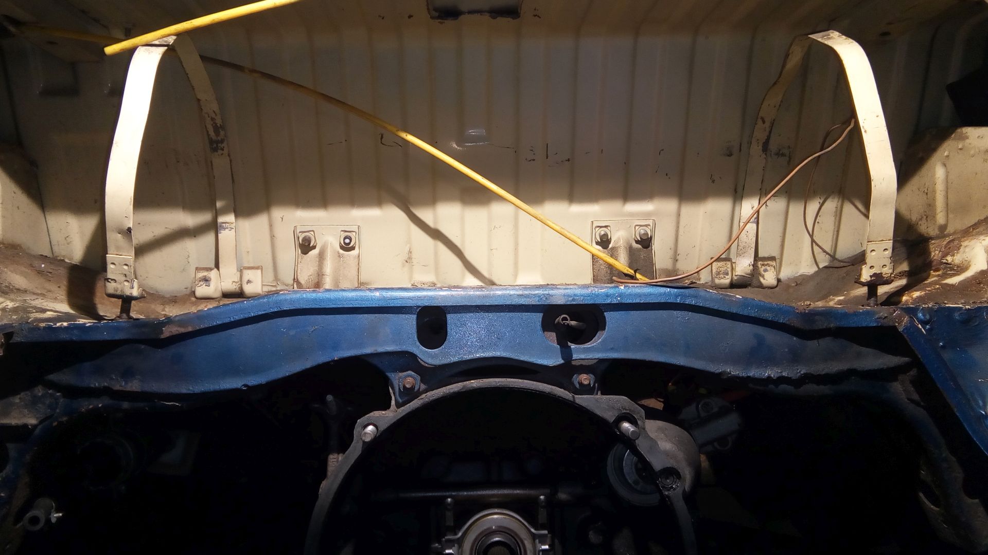

Post by ohiowesty »
Next, I removed the firewall screws and the damn thing would not come out. It took me a whole 45 min to discover two hidden screws underneath. Got the tank out, does not look bad inside but mind as well have it boiled and treated. Inspected the filler neck and breather tubes and found some weak rubber. Bell housing is pretty caked, some cleaning is in order.
