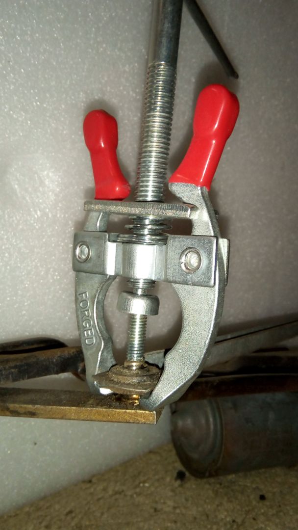

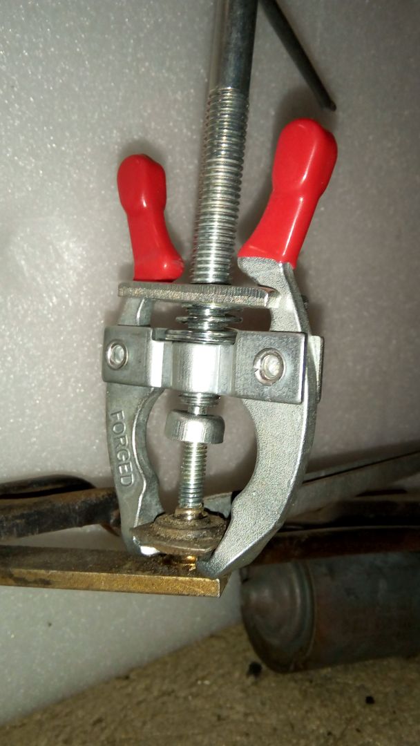

Linkage arms are kind of bendy, so I refrained from prying them apart. A battery terminal puller will do the trick. The cup at the end of the puller is too big so I inserted a bolt in between the cup and the linkage/articulation.

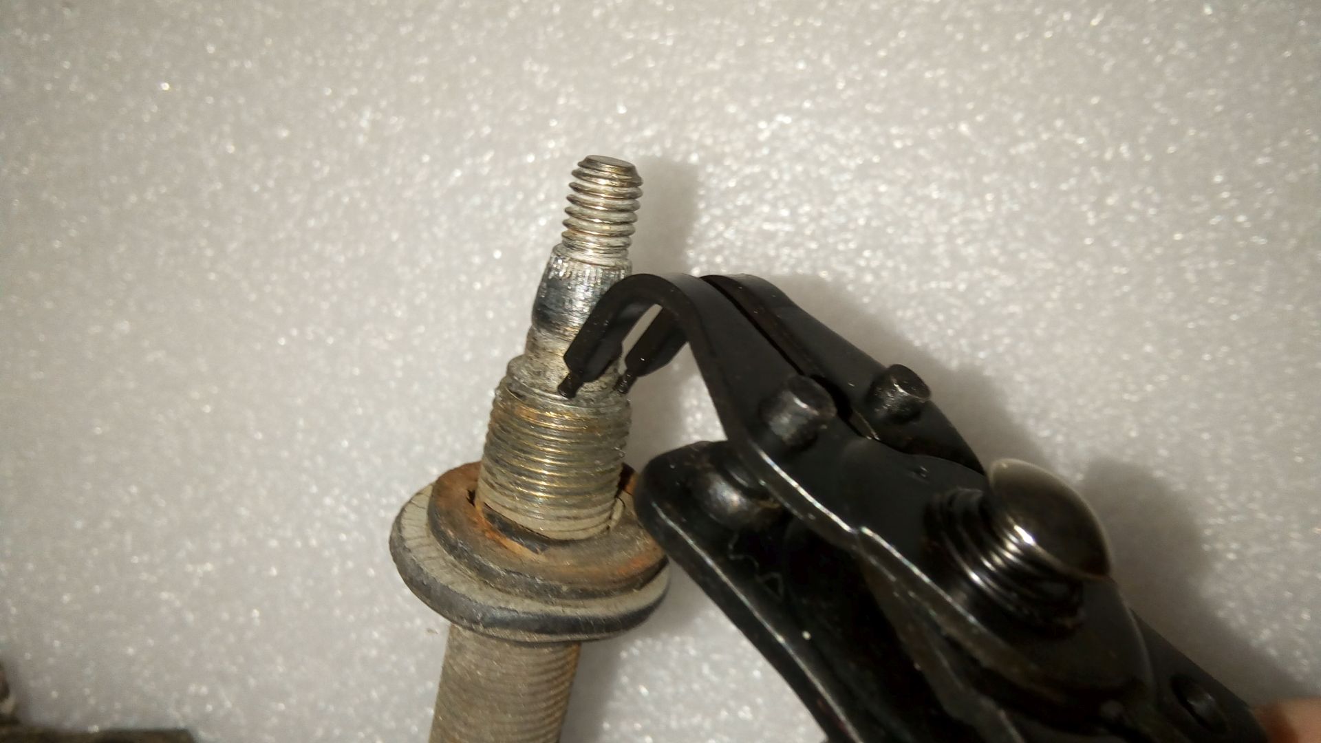

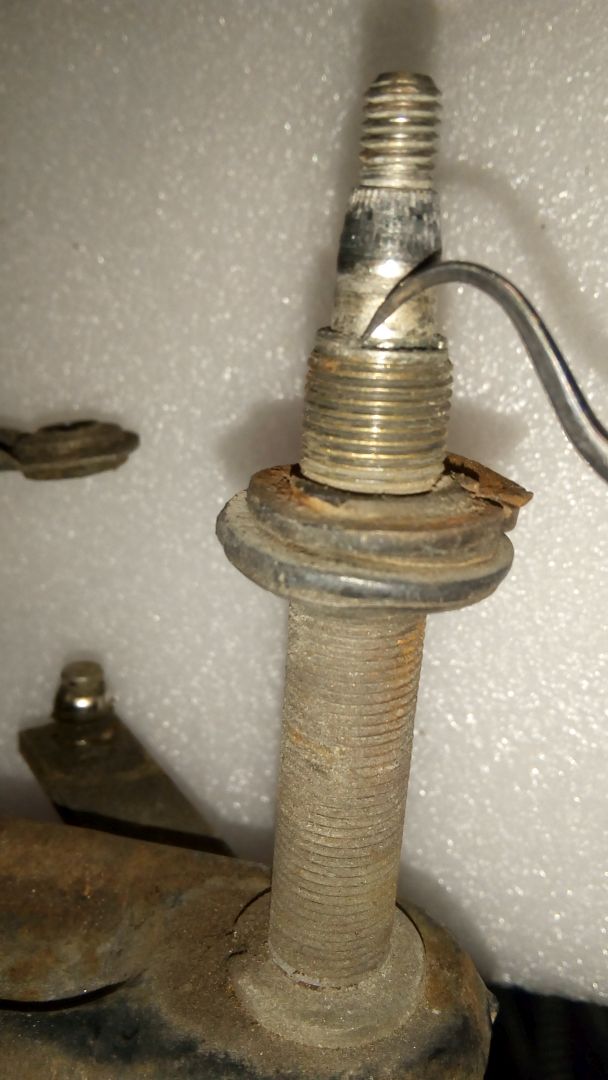

somewhere under this grime there's a circlip that prevents the wiper shaft from pulling out
After poking around with a pointy thingy, I found the groove; you can see one end of the circlip right by the tip of the pick

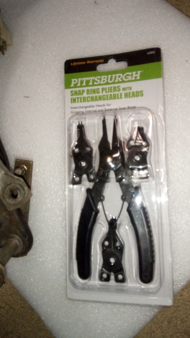

Earlier in the day, I had a 20% off superbowl HF coupon and I got me a set of snap ring pliers for 5 bucks, and got a free multimeter with it.
Yeah, I know they are not for this kind of clip, but they worked

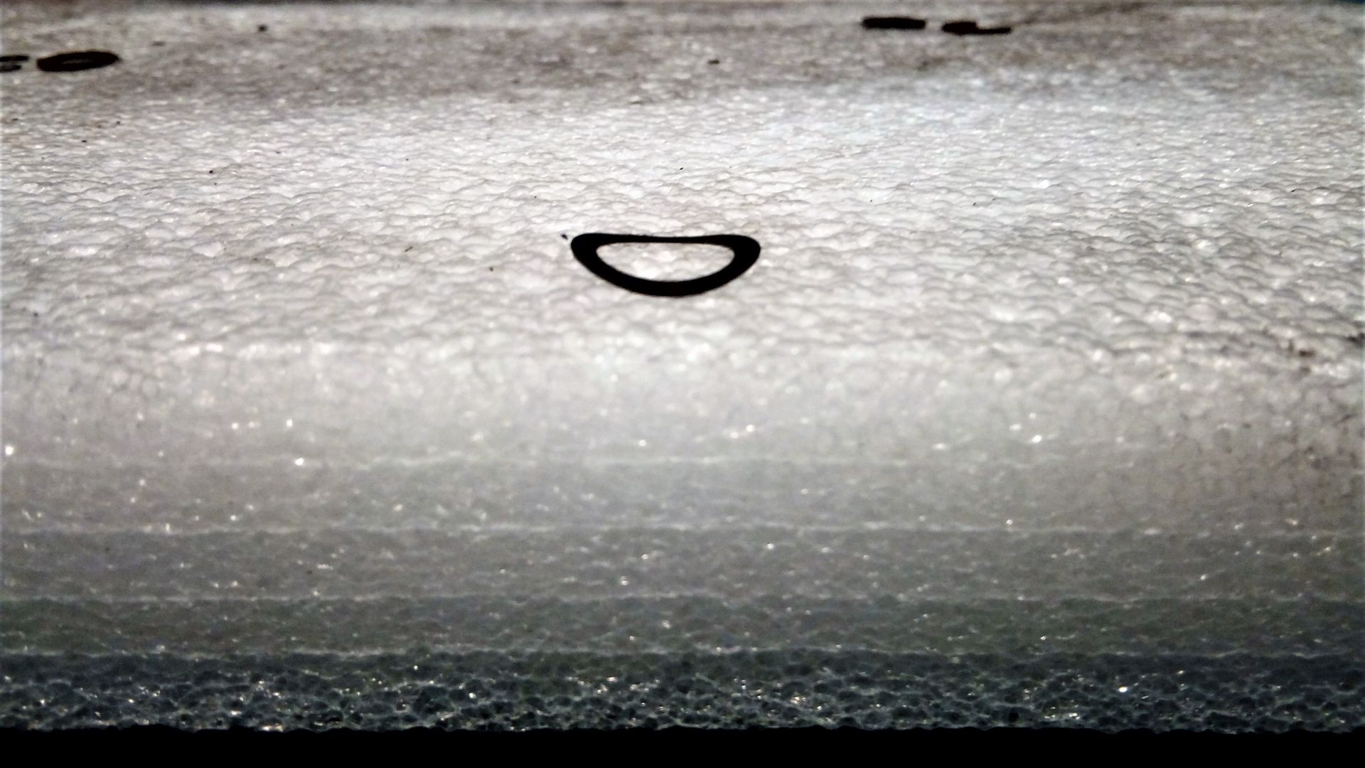

While cleaning the parts I discovered another washer, buried in grime at the base of the shaft
It's a wavy little thing

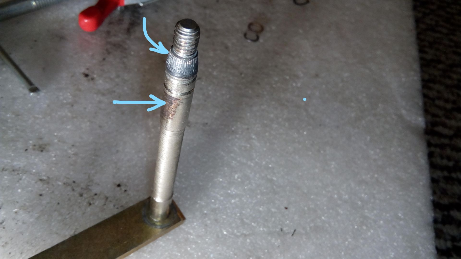

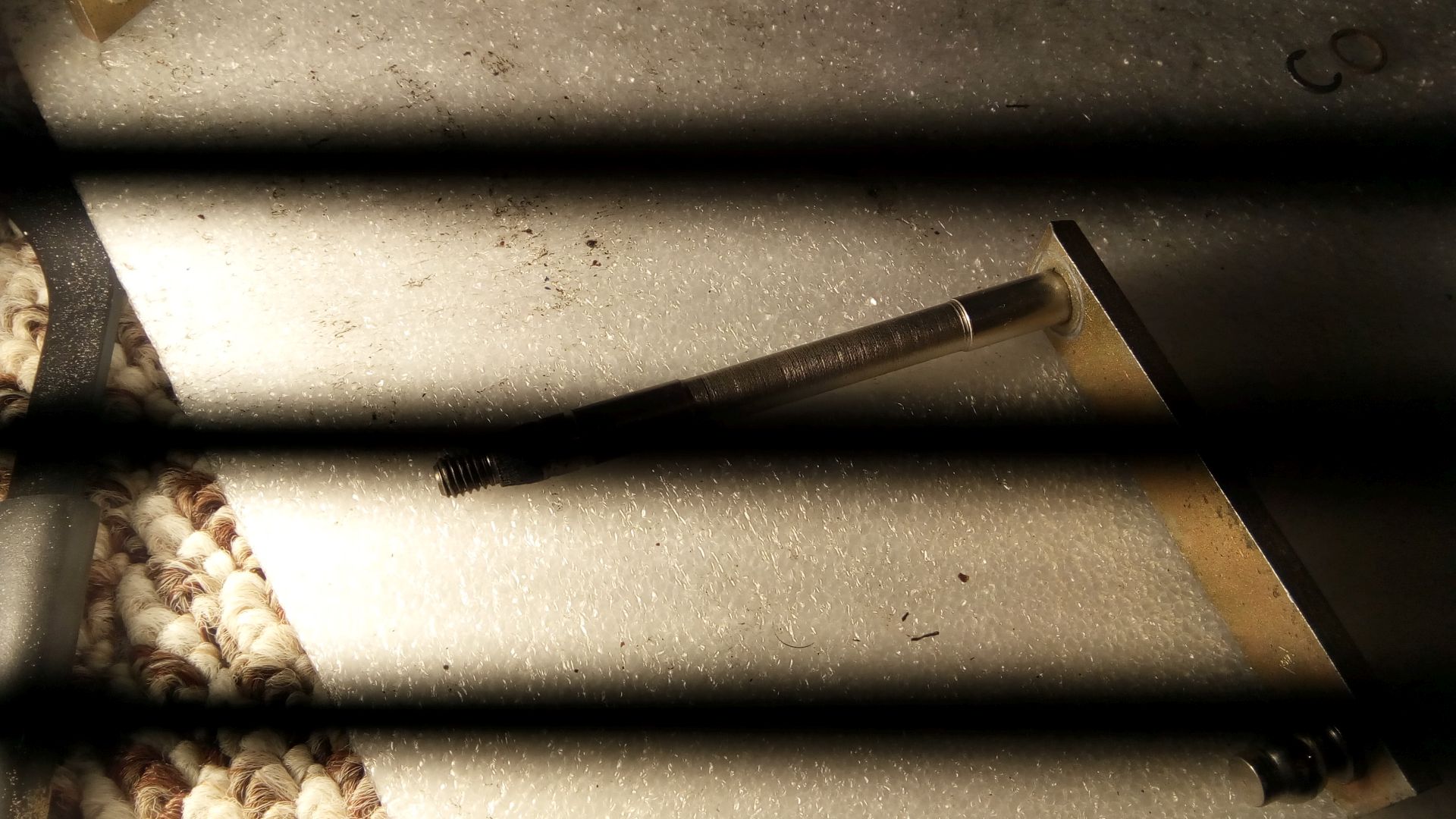

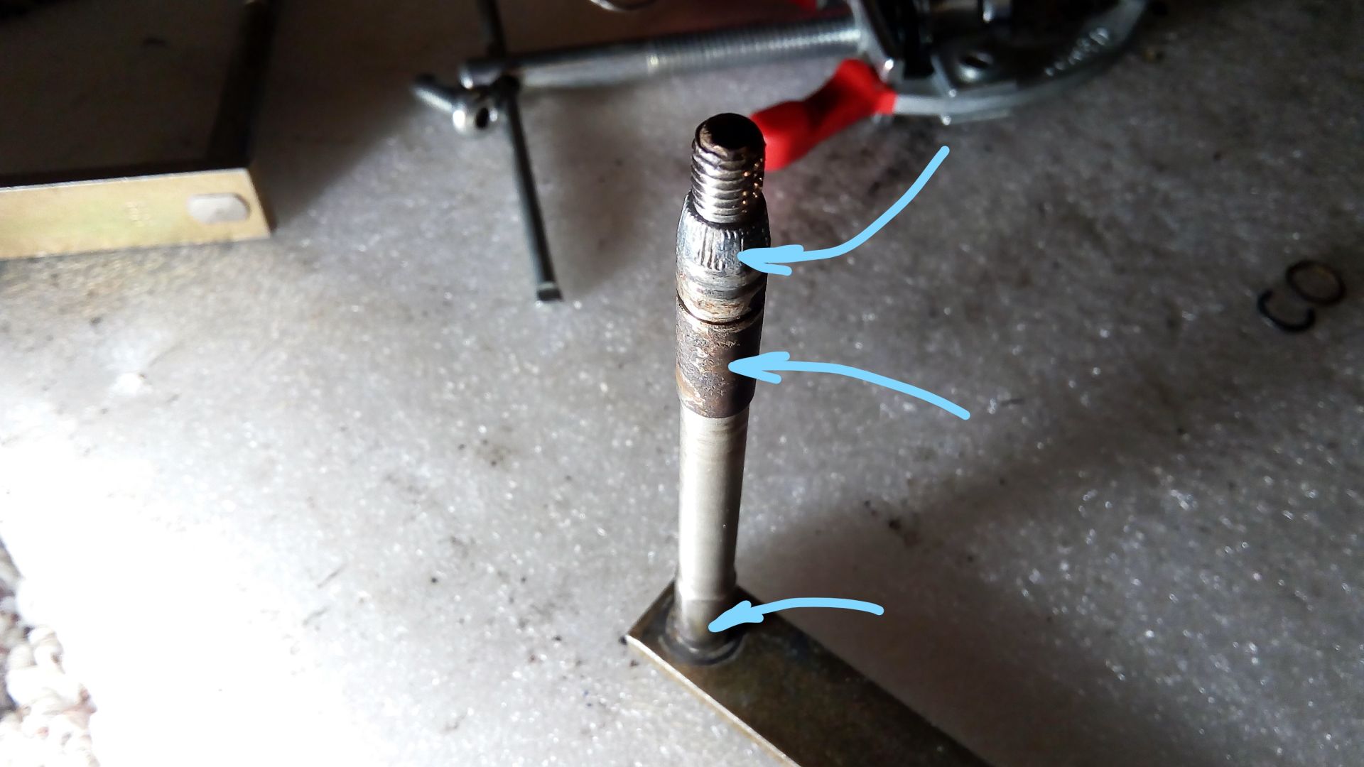

Re: 78 westy

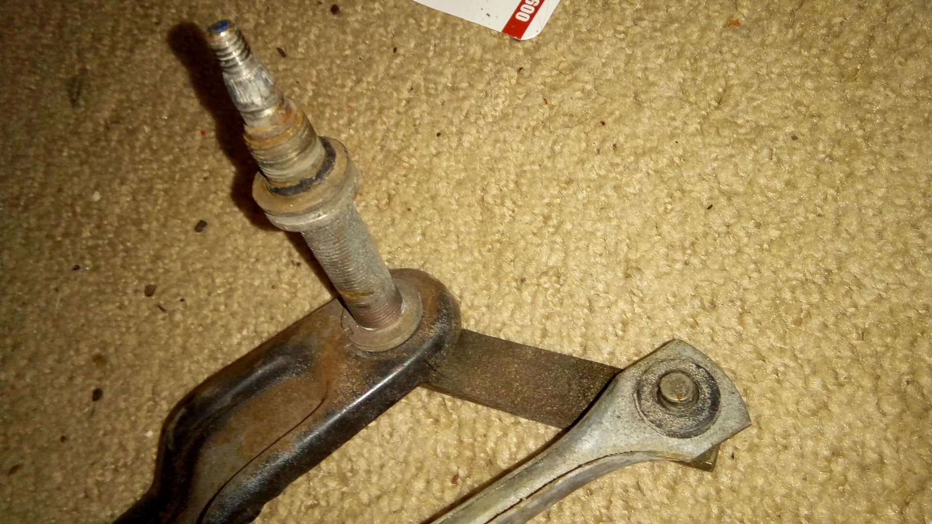

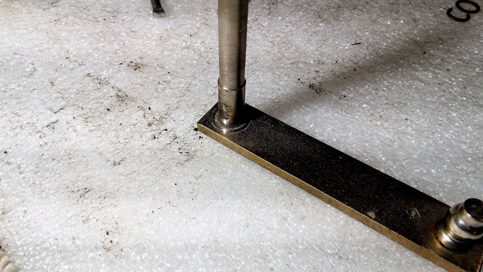

Notice the worn out splines below the threads; and the rusty area below the clip groove is actually slightly recessed from wear
The other shaft was the stuck one; splines are also damaged, and there is evidence that water infiltrated all the way to the bottom
I can gently sand down the rusty areas and pack everything tight, but there will be slop; my main concern is the damaged splines, which will cause the wiper arms to eventually skip.
IMO these shafts are shot and due for replacement. What do you think? Can I make these original ones work, or should I just get some crappy after market ones http://vwparts.aircooled.net/Wiper-Shaf ... m?CartID=1 ?

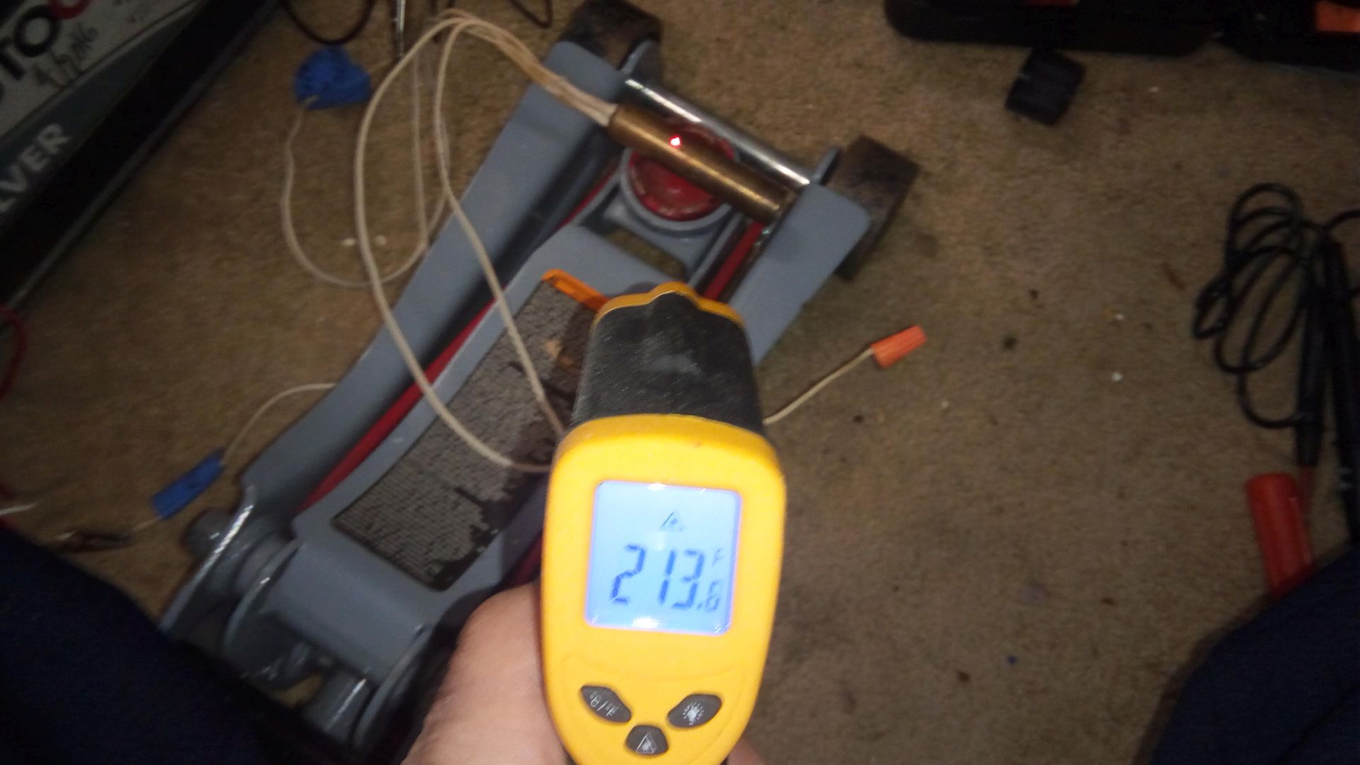

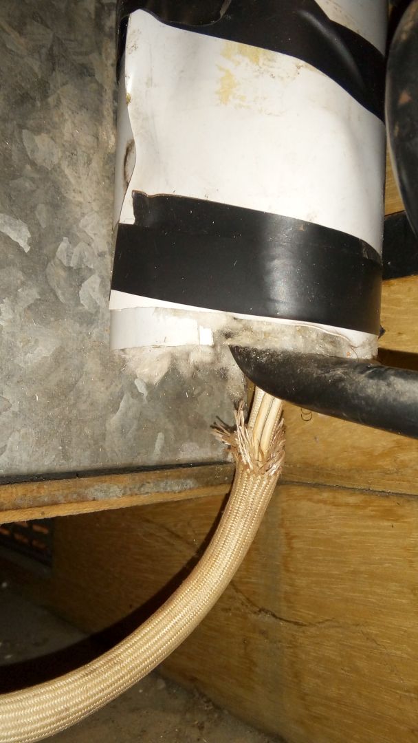

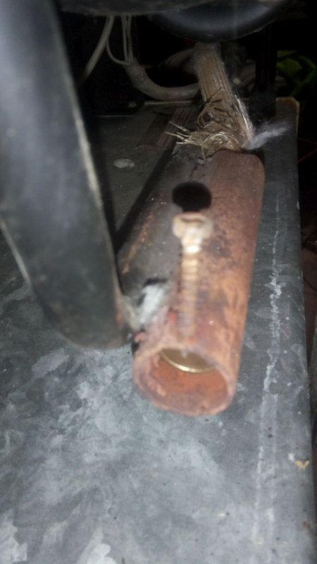

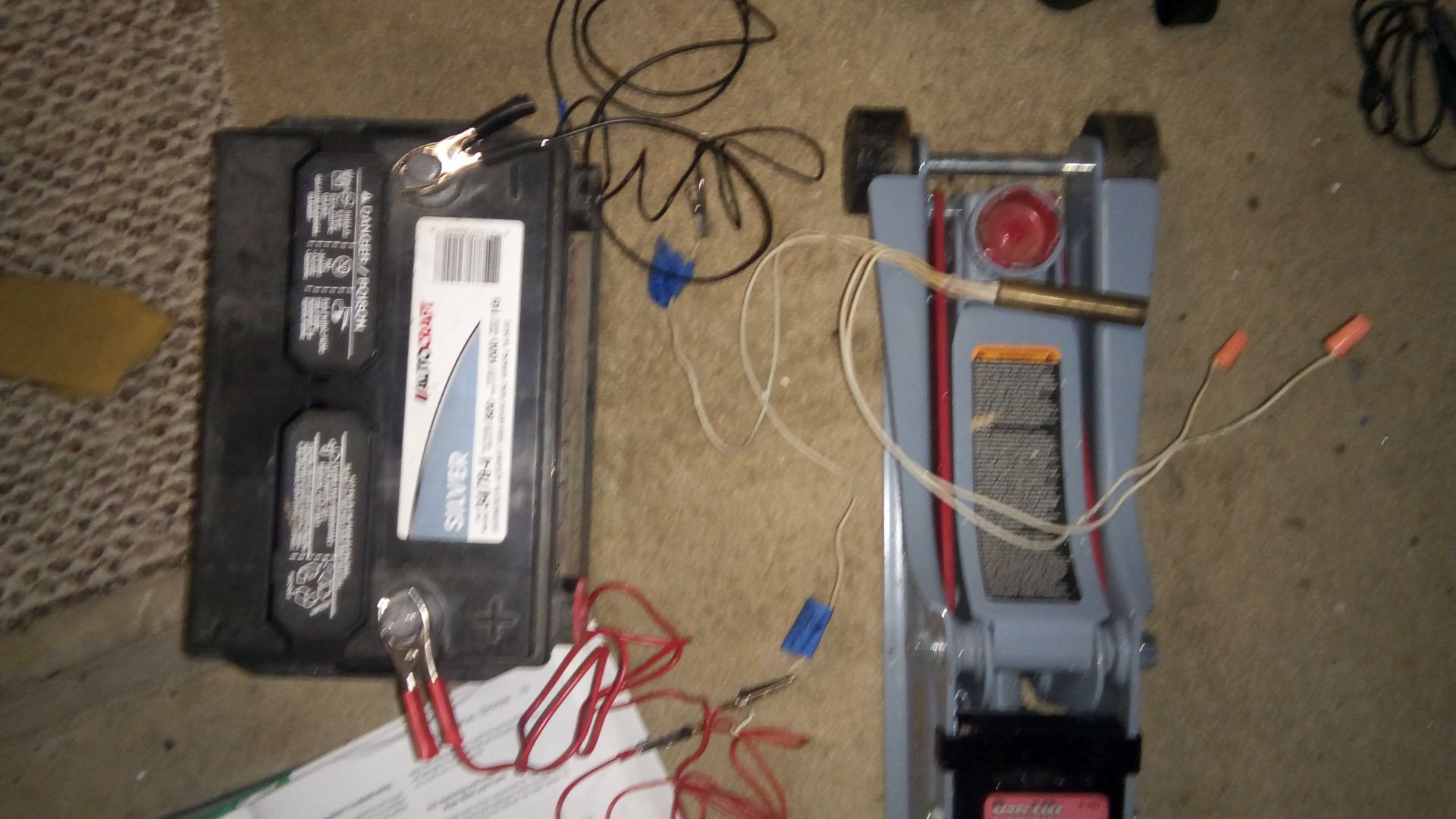

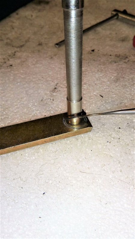

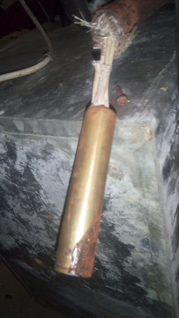

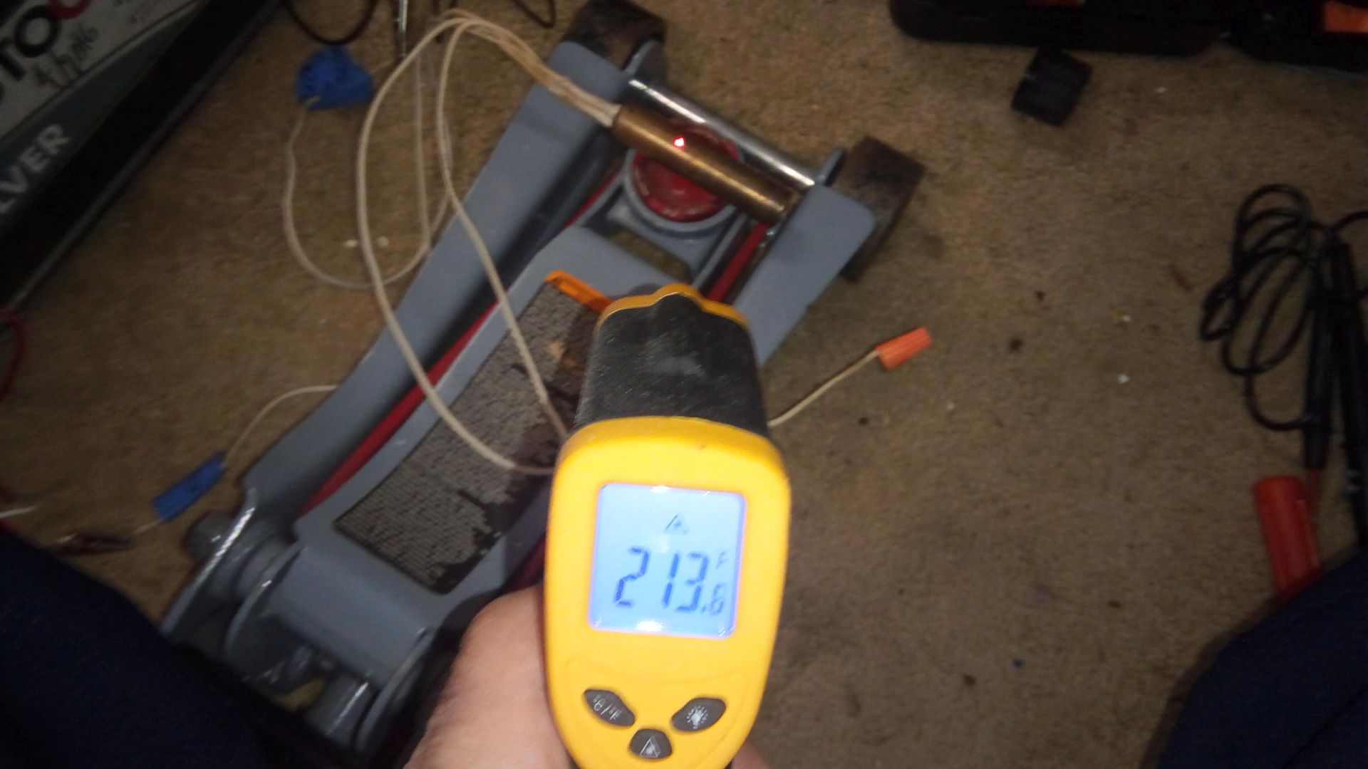

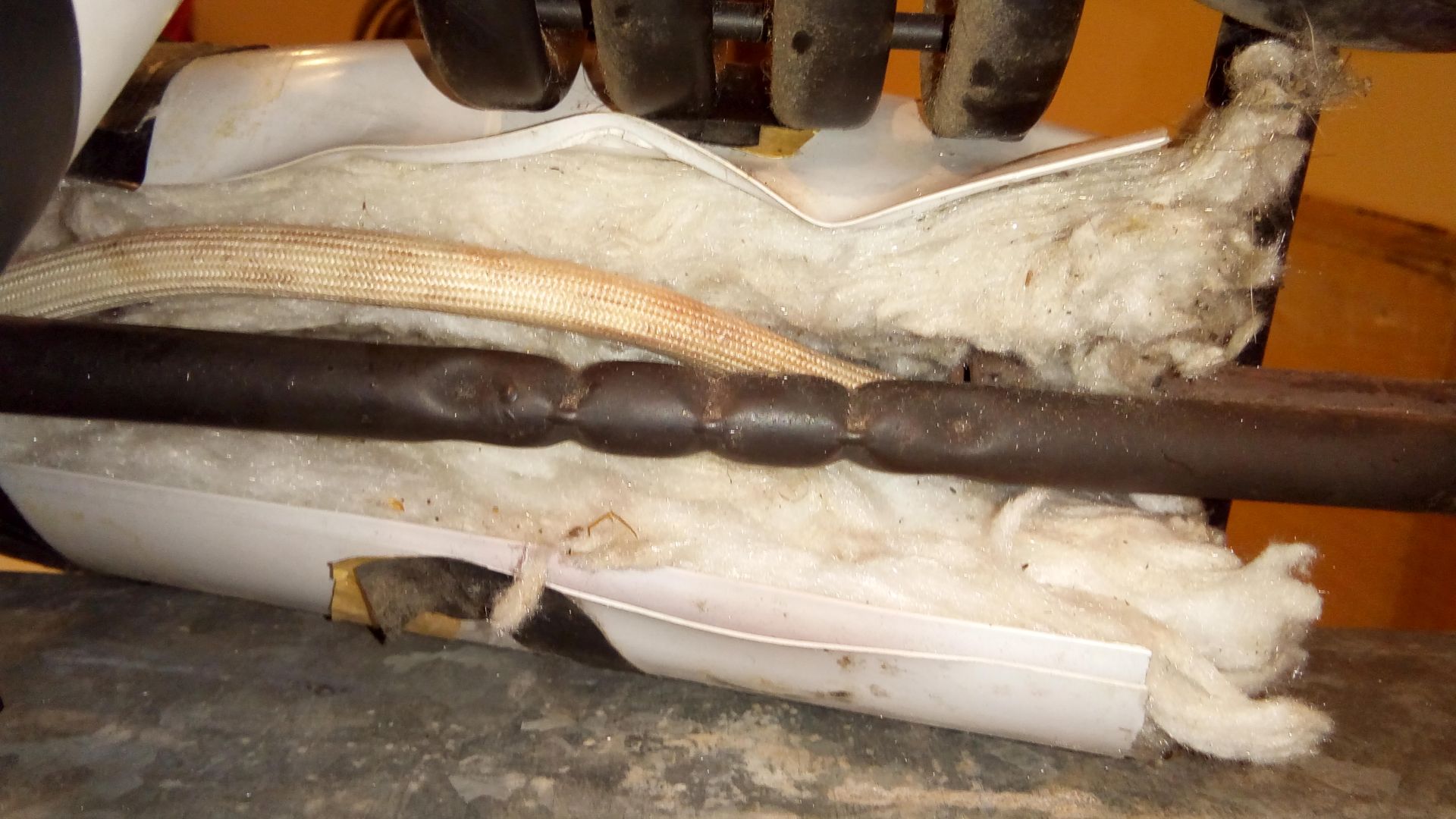

Testing the heating element.

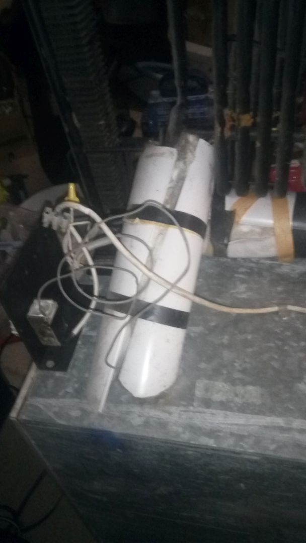

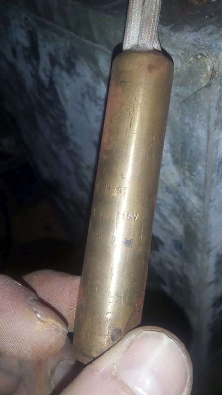

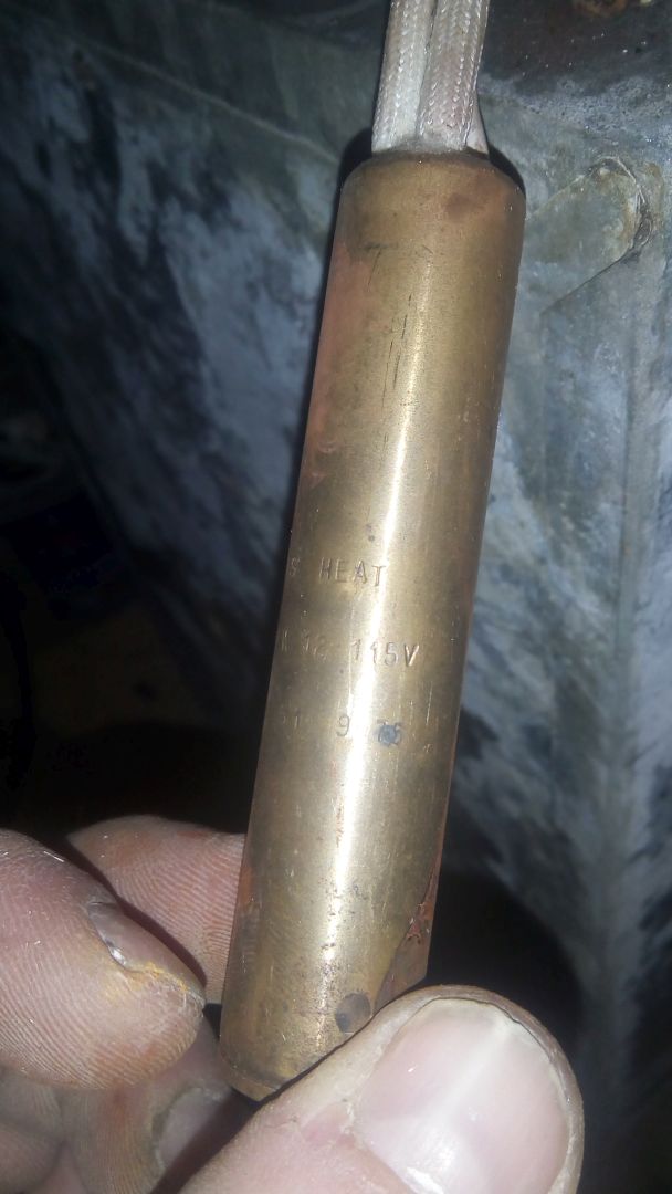

The yellow wire nuts and the electrical tape on the insulation mean that a PO messed with the unit. Removal of the bottom insulation reveals the heating element, hidden inside a tube welded to the coolant line you can see the tip of it inside the tube; admire the ghetto clamping screw! The heating element slides out easily; the first problem is that there are four wires coming out of it, instead of two Notice the stamping for both 12v and 115v, which means that it belonged to a canadian model - with separate circuits for battery and shore power. Next I removed the fabric insulation to expose the entire length of the wires, so I can separate the 12v pair from the 112v pair. I assumed that the 12v pair was the one initially hooked to the blue and black wires on the socket; I actually lucked out on it.Testing is easy - just hook up the wire pair to the battery terminal - I don't think polarity matters the element started immediately, and was piping hot within 20 seconds So the heating element is good!

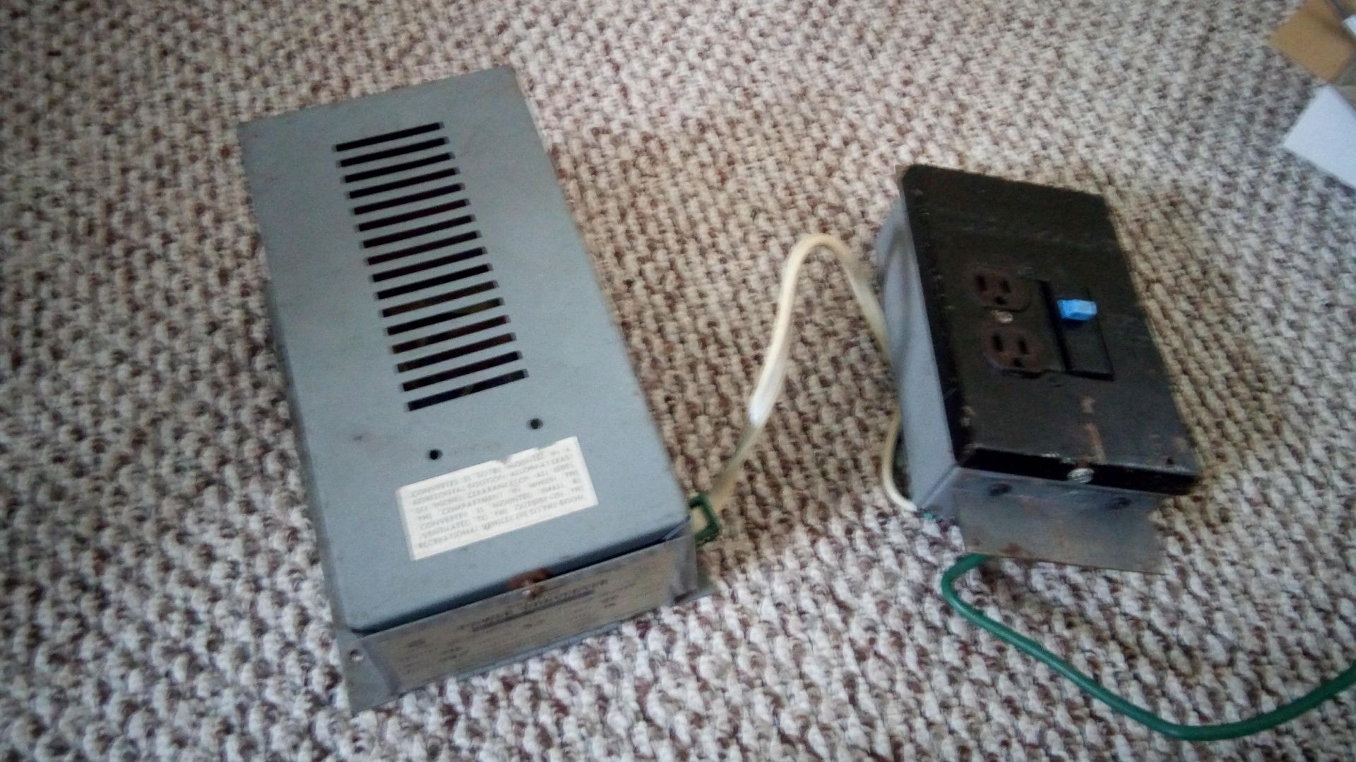

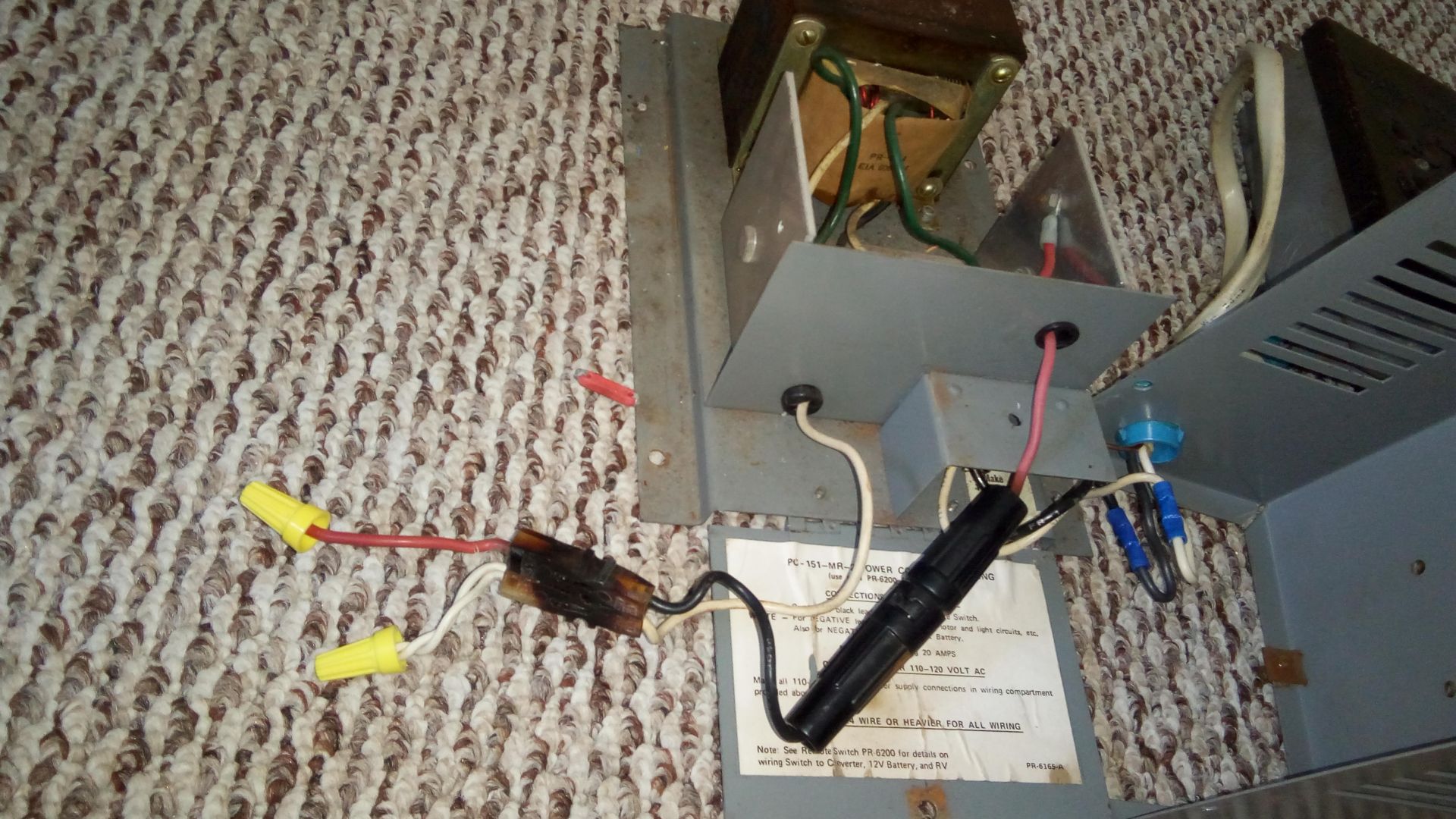

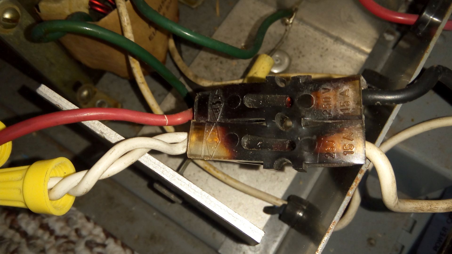

Re: 78 westy

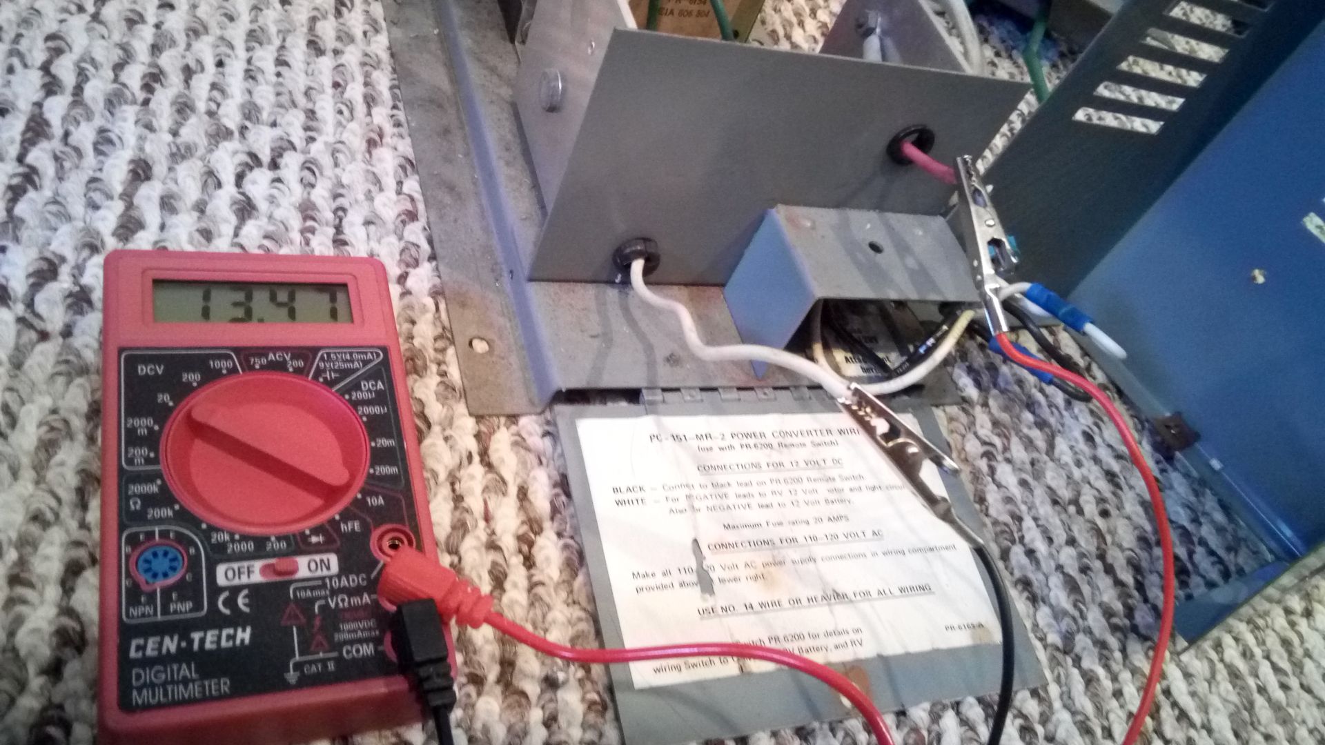

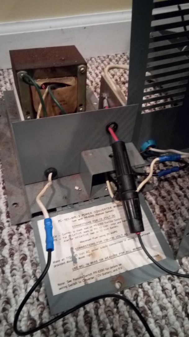

Testing the 12V power supply
remove the transformer cover
it's supposed to look like this

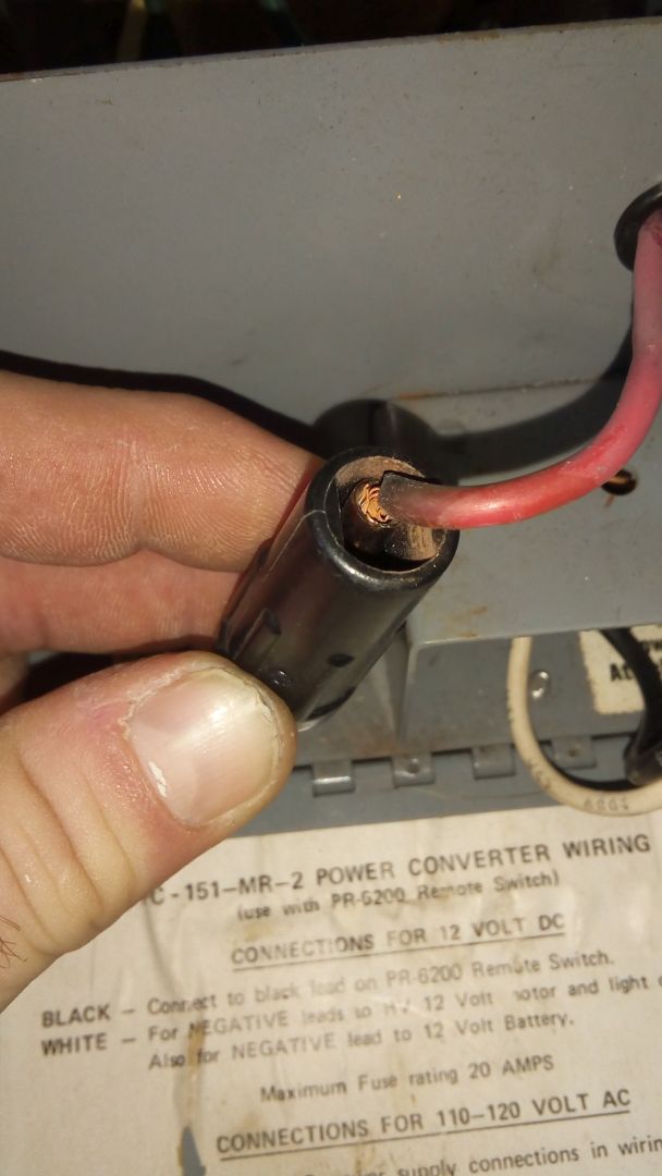

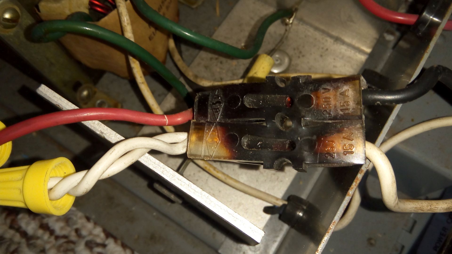

instead, I got this mess - see below - so I snipped both 12v wires

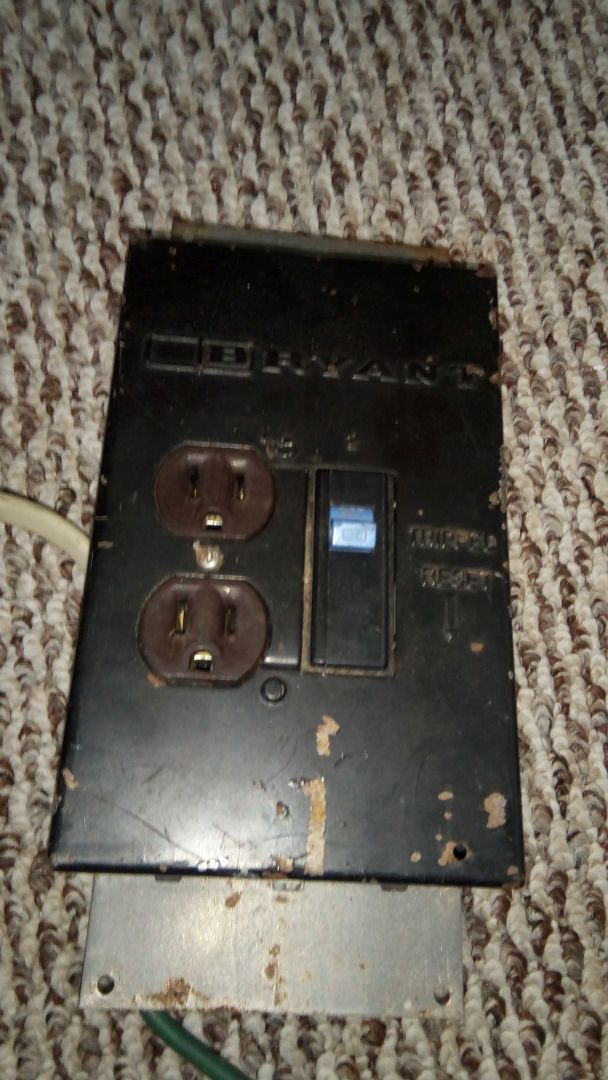

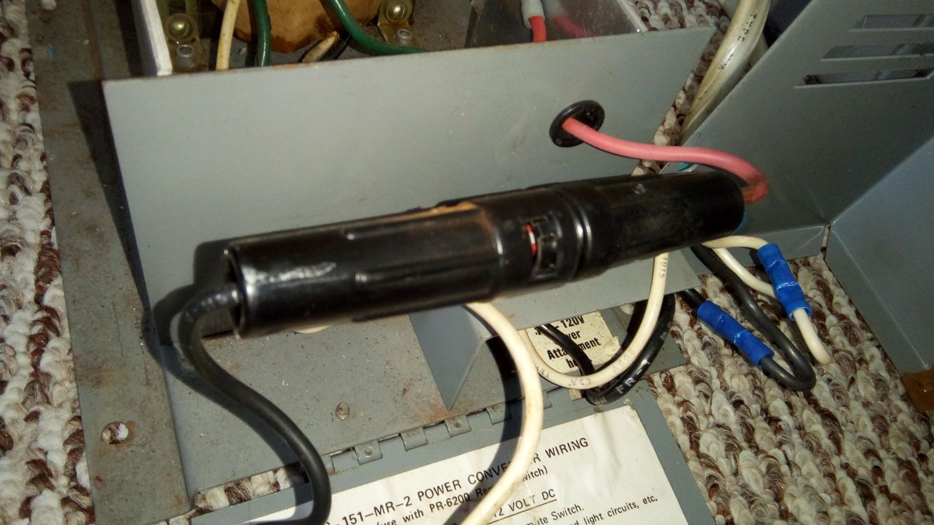

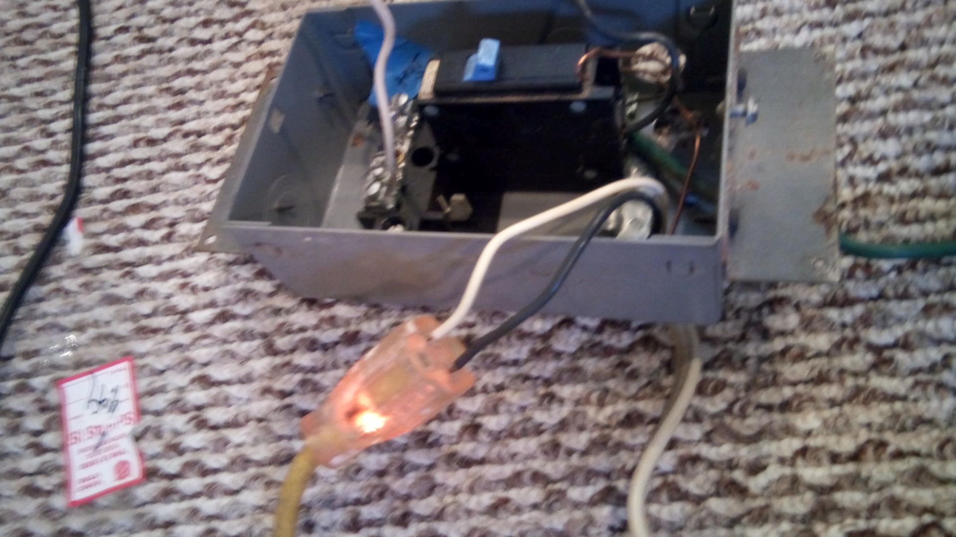

The breaker box supplies power to the transformer.

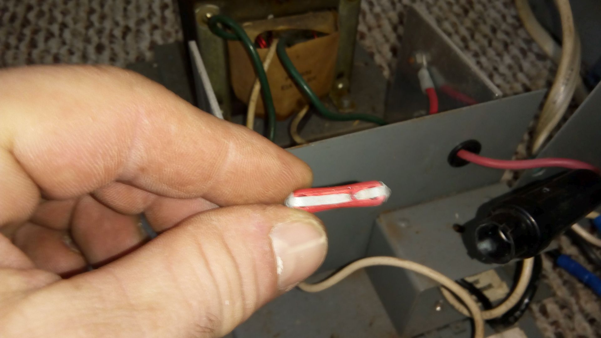

I removed the cover and inspected everything; the outlet turned out to be garbage - with wobbly connections even after tightening down the screws. I then powered the transformer by rigging the black and white input lines to a wall outlet, via an extension cord
set the multimeter on 20v DC and checked for 12 volts across the freshly cleaned up red and white wires coming out of the transformer; It's good!

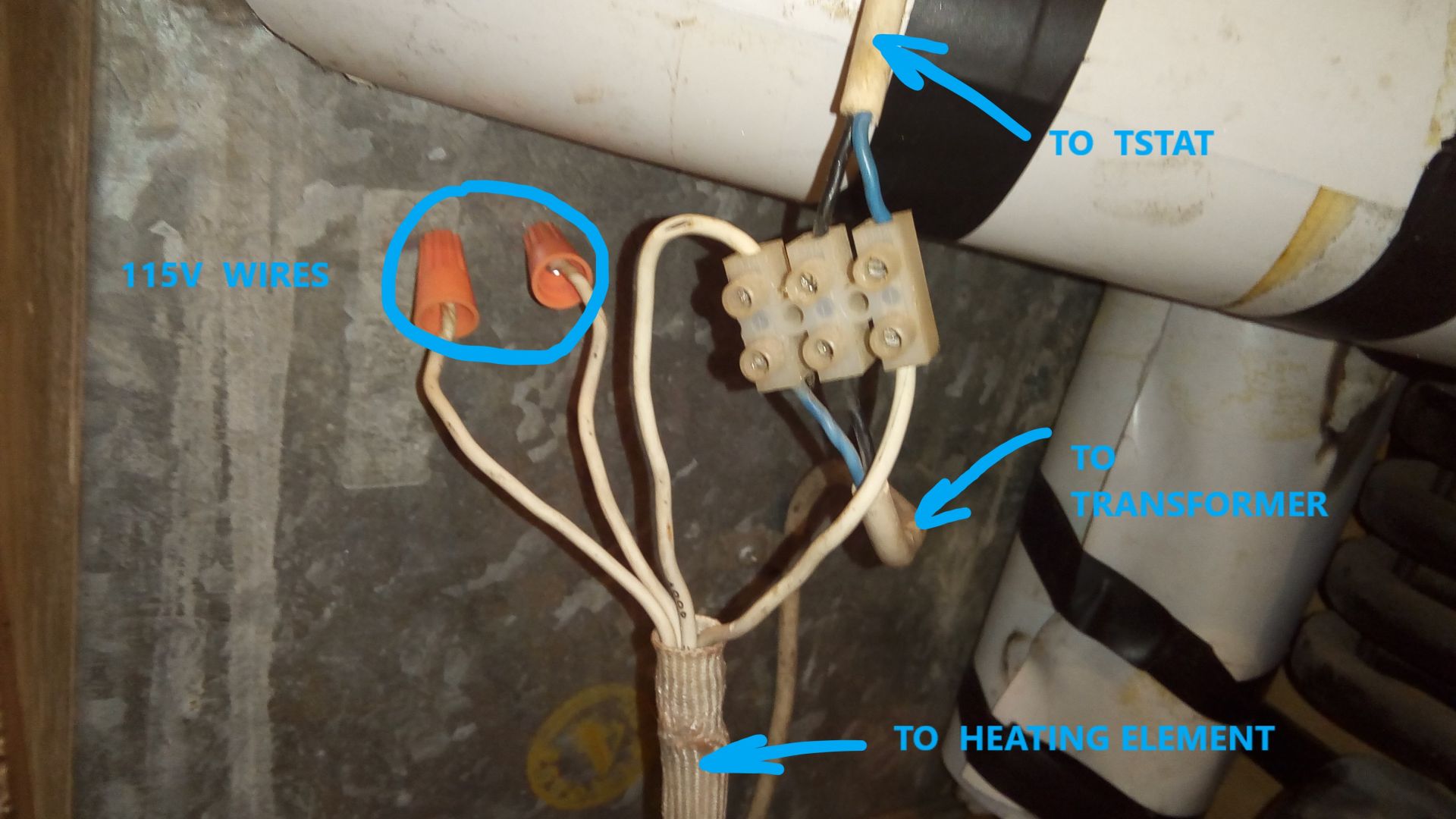

Next is wire cleanup.

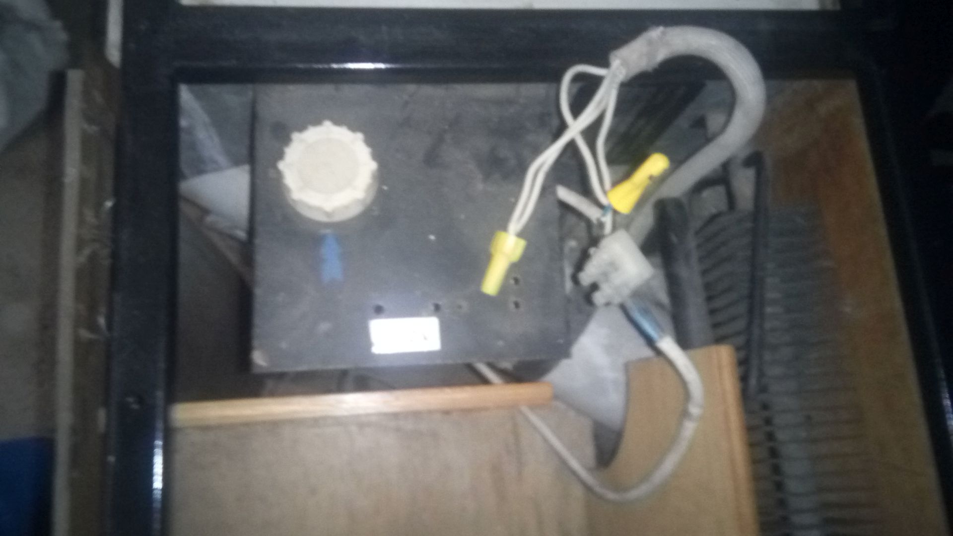

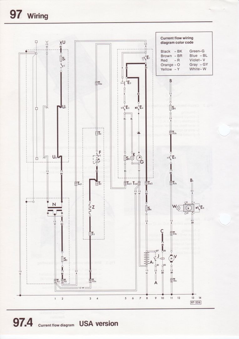

I installed a 20 amp inline fuse and extended the temporary test lines to the fridge. Figuring out the rat's next under the thermostat took a while; I could have hooked up the heating element directly to the transformer and call it a day, but I wanted test the dial knob too. Here is the diagram, the fridge wiring is the rectangle in the middle and here my hookups at the triple connector under the Tstat

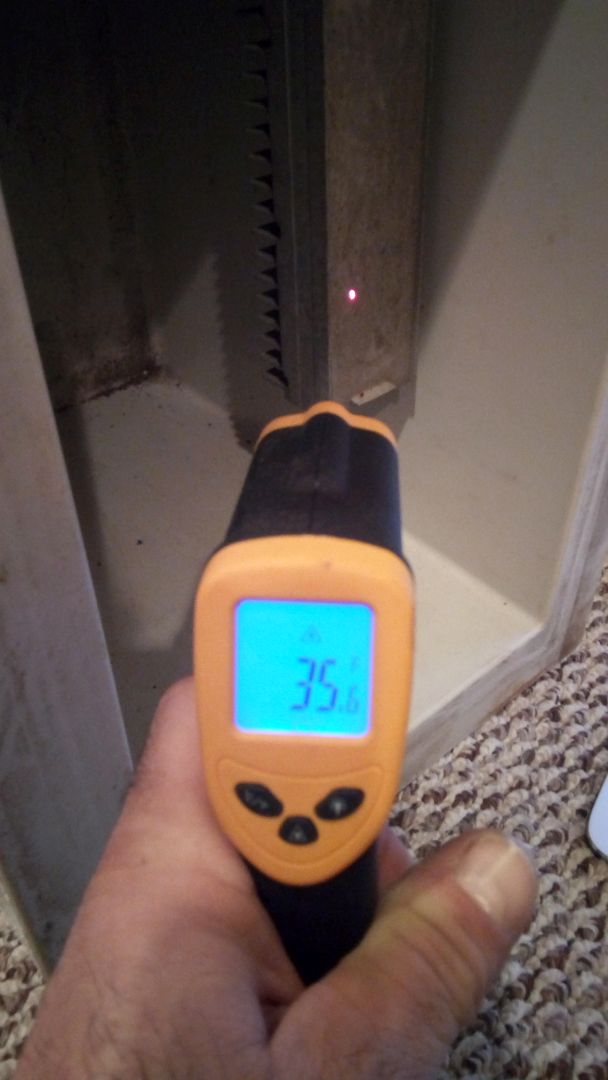

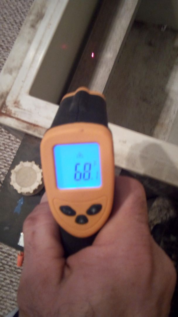

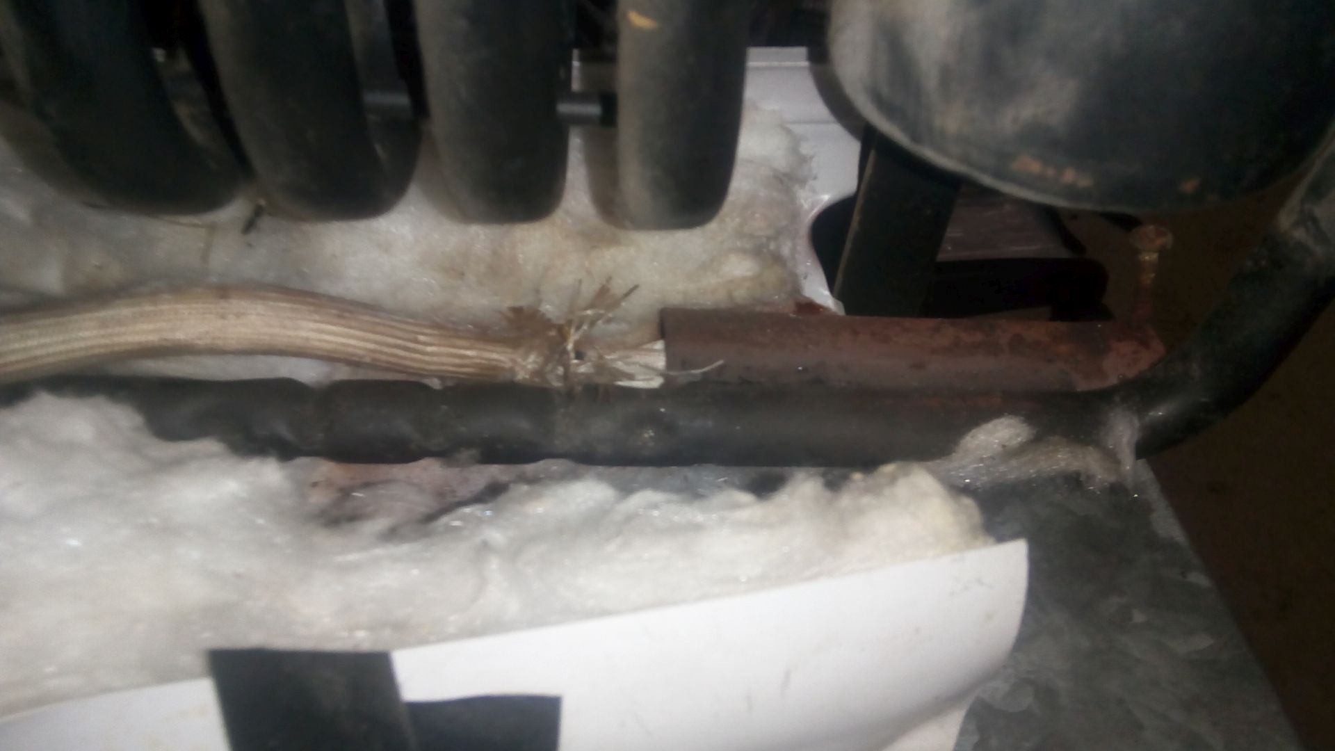

Re: 78 westy

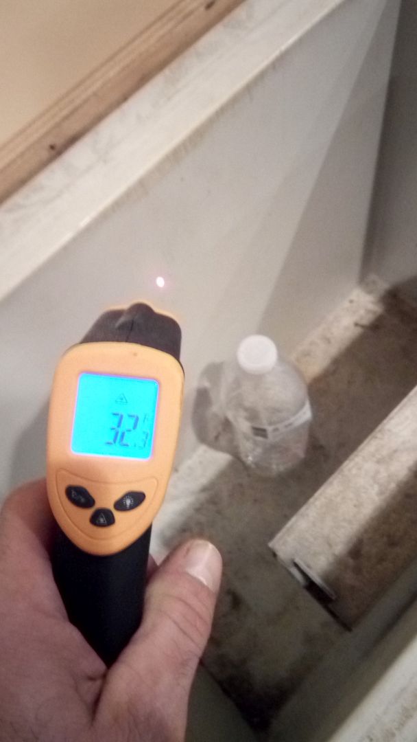

Fridge test

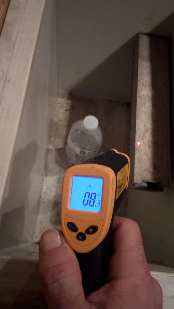

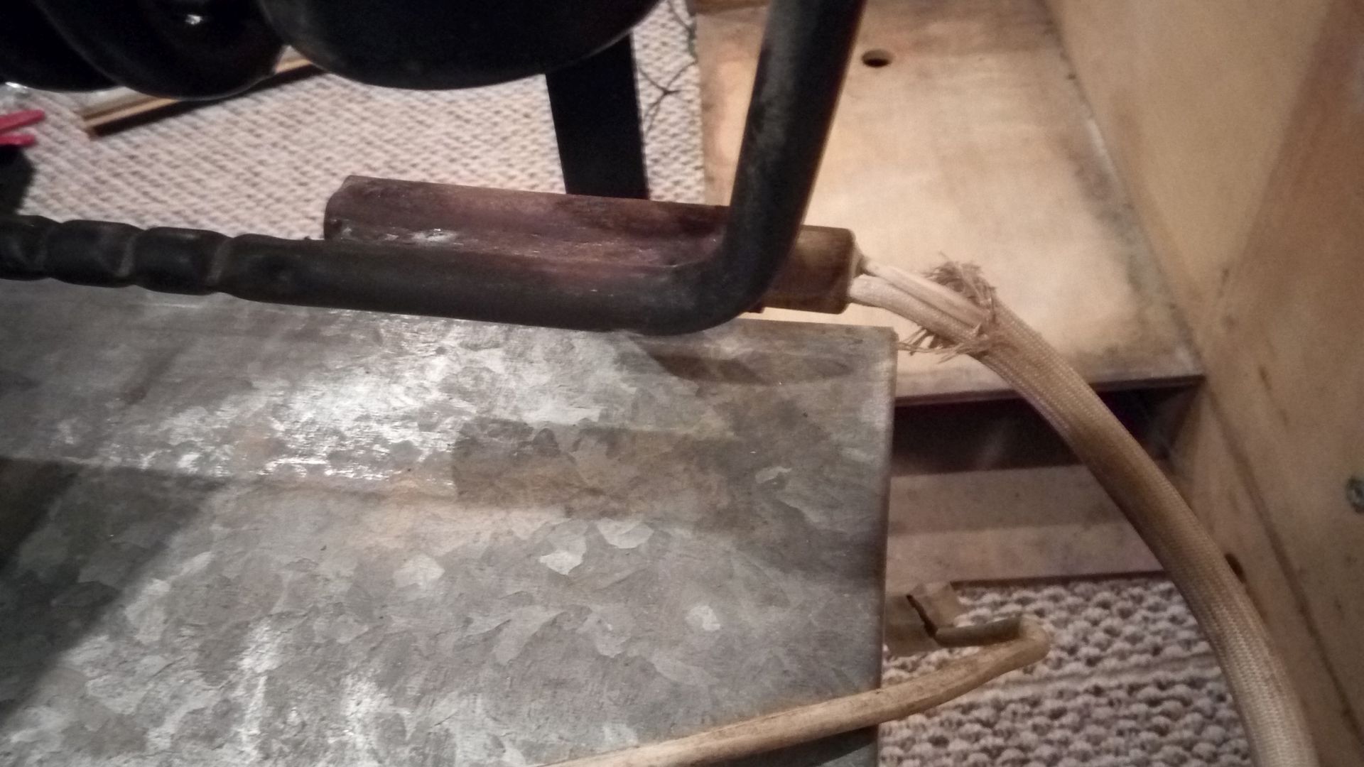

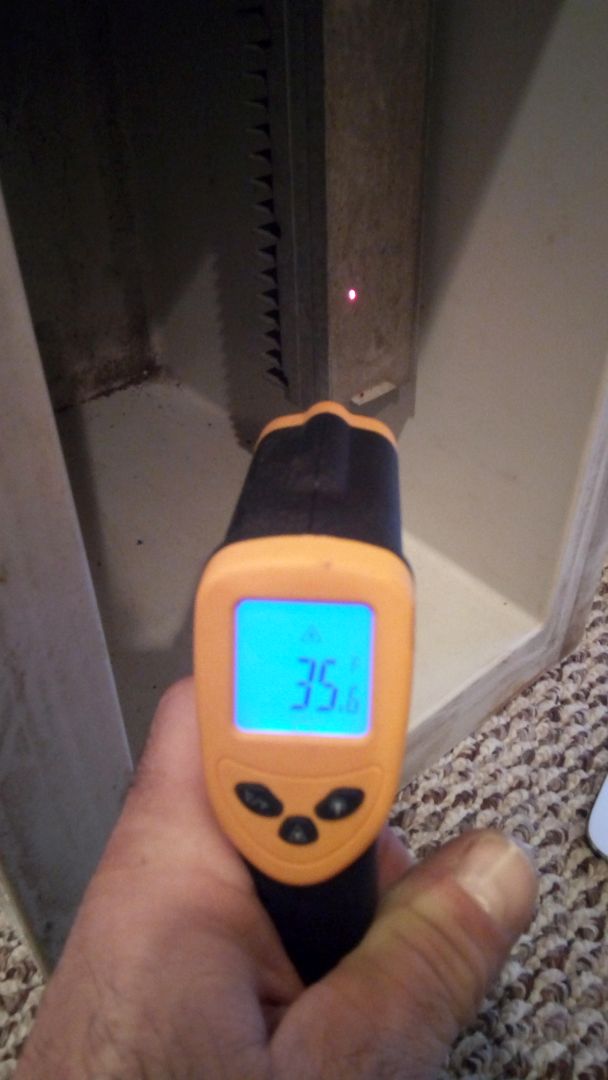

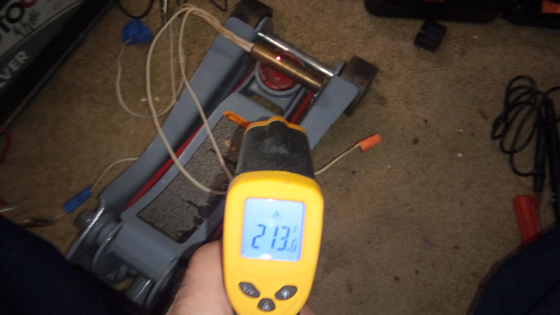

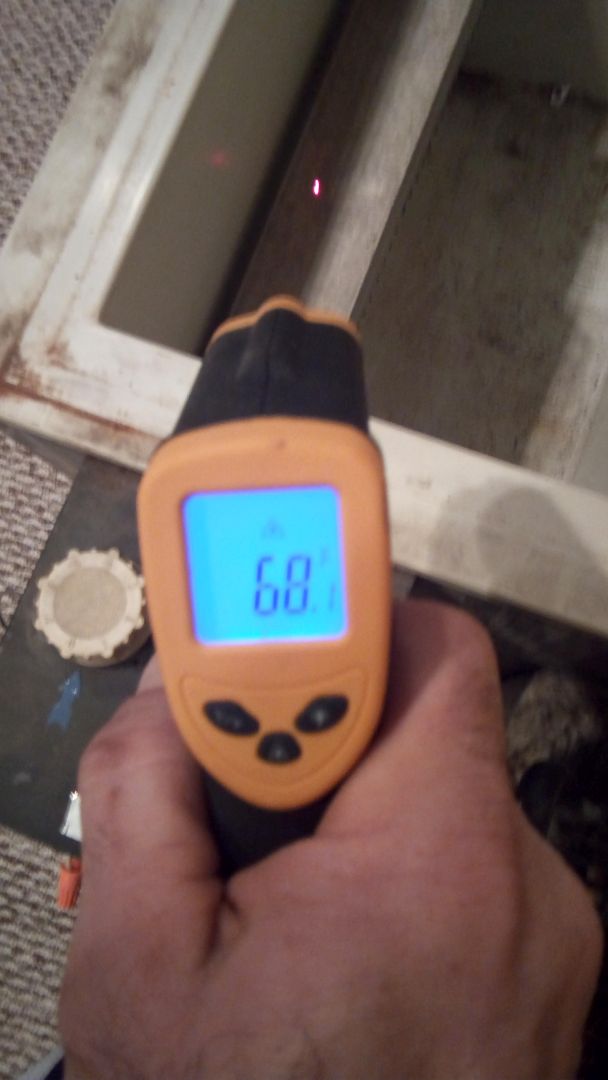

all hooked up to power! nothing blew! temperature at start of test temperature after 20 minutes right about now I had an epiphany and realized that I might burn my basement down, so I quickly unplugged the fridge.
this is how the heating element wire was routed by the PO, so I reinstalled it the same way: inside the insulation sleeve, along the piping hot line. the wires could melt and cause a fire.. so I pulled out the heating element and installed the other way - with the wires opposite to the lines, and not touching a thing after an hour, dial on max setting: condenser is super cold and there is a film of ice on the side of it after two hours, temperature of the inner walls is 32 Verdict: overall I am pleasantly surprised by how fast this little fridge starts cooling; I think that with intermittent battery use, and with a bag of ice in it, it will work just fine for a few days of camping. And with shore power it's great.
