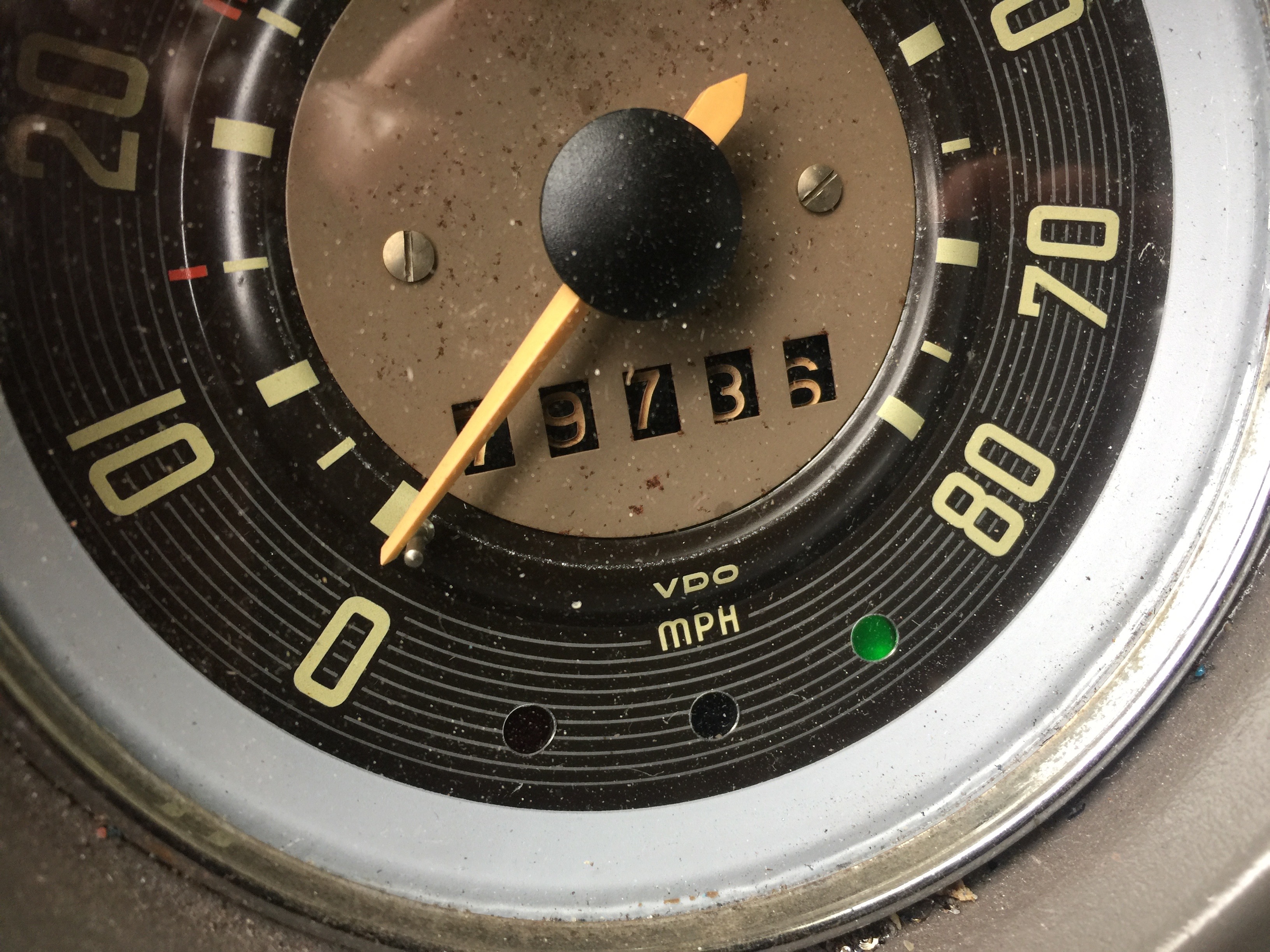

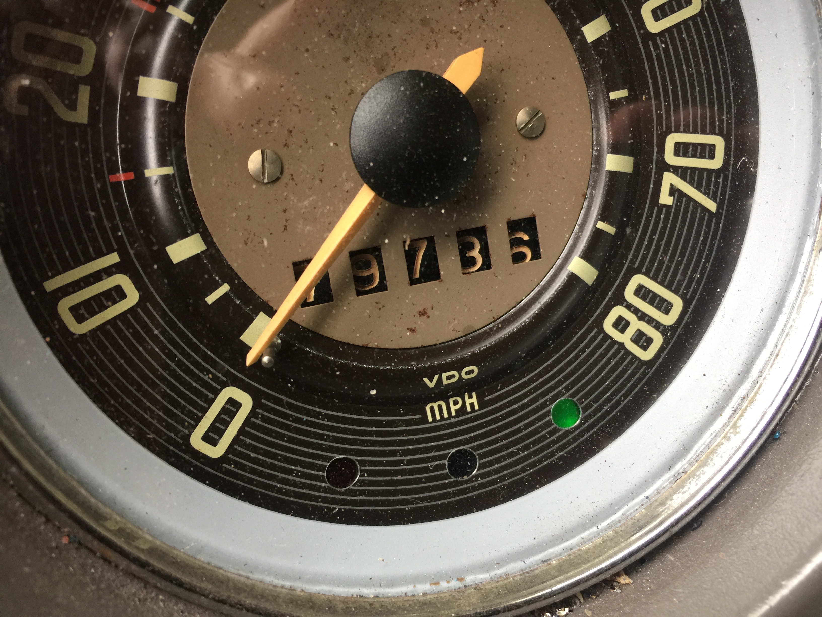

I know I have good idiot lights because Bruce did them. :D When I came off the freeway ramp this evening, I noticed the dreaded red light on at idle. :x Slight rev and it goes out. Stays out under load.

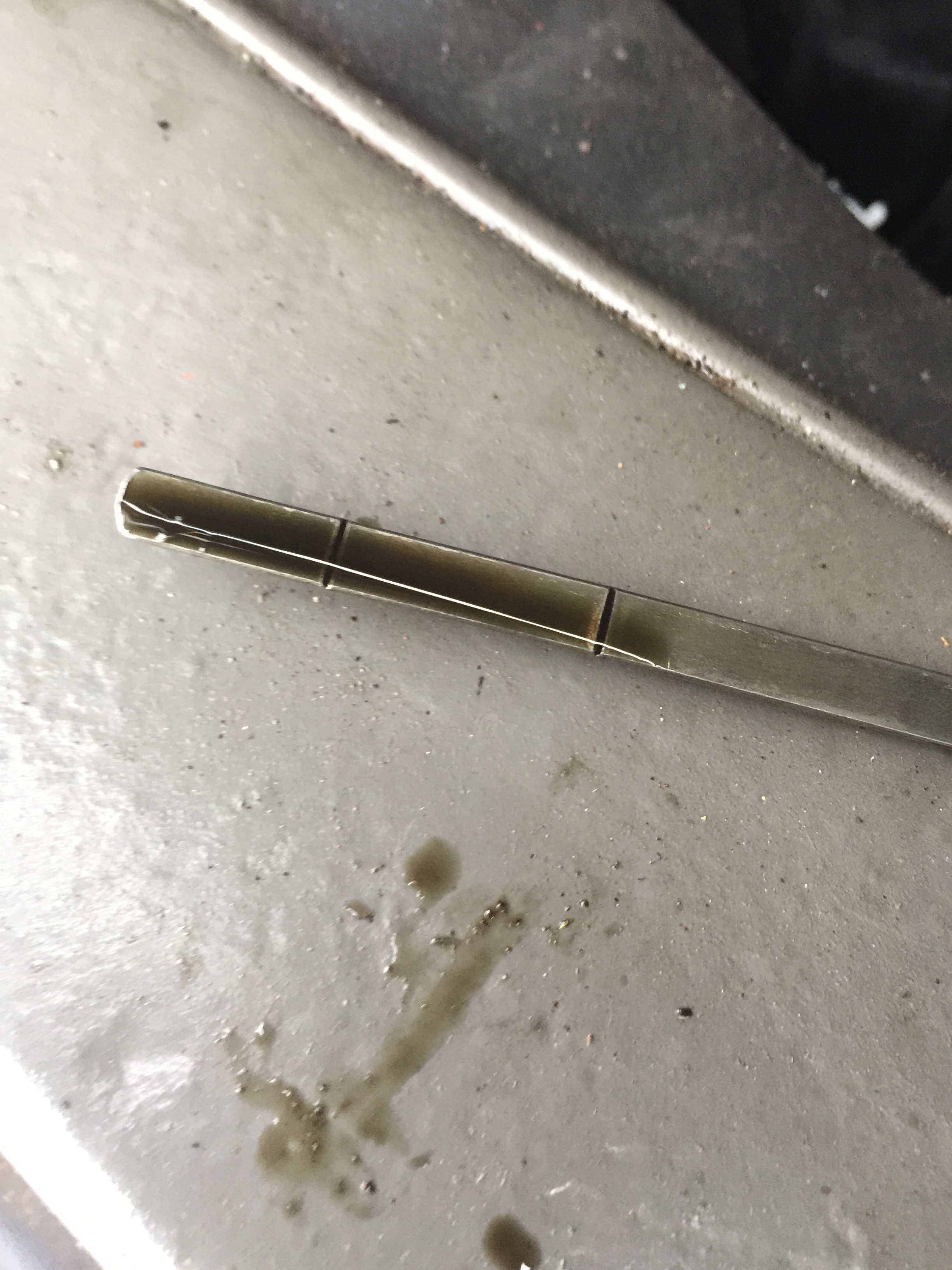

When I get it home The dipstick is not too hot to touch. It's hot, but I can touch it and hold it.

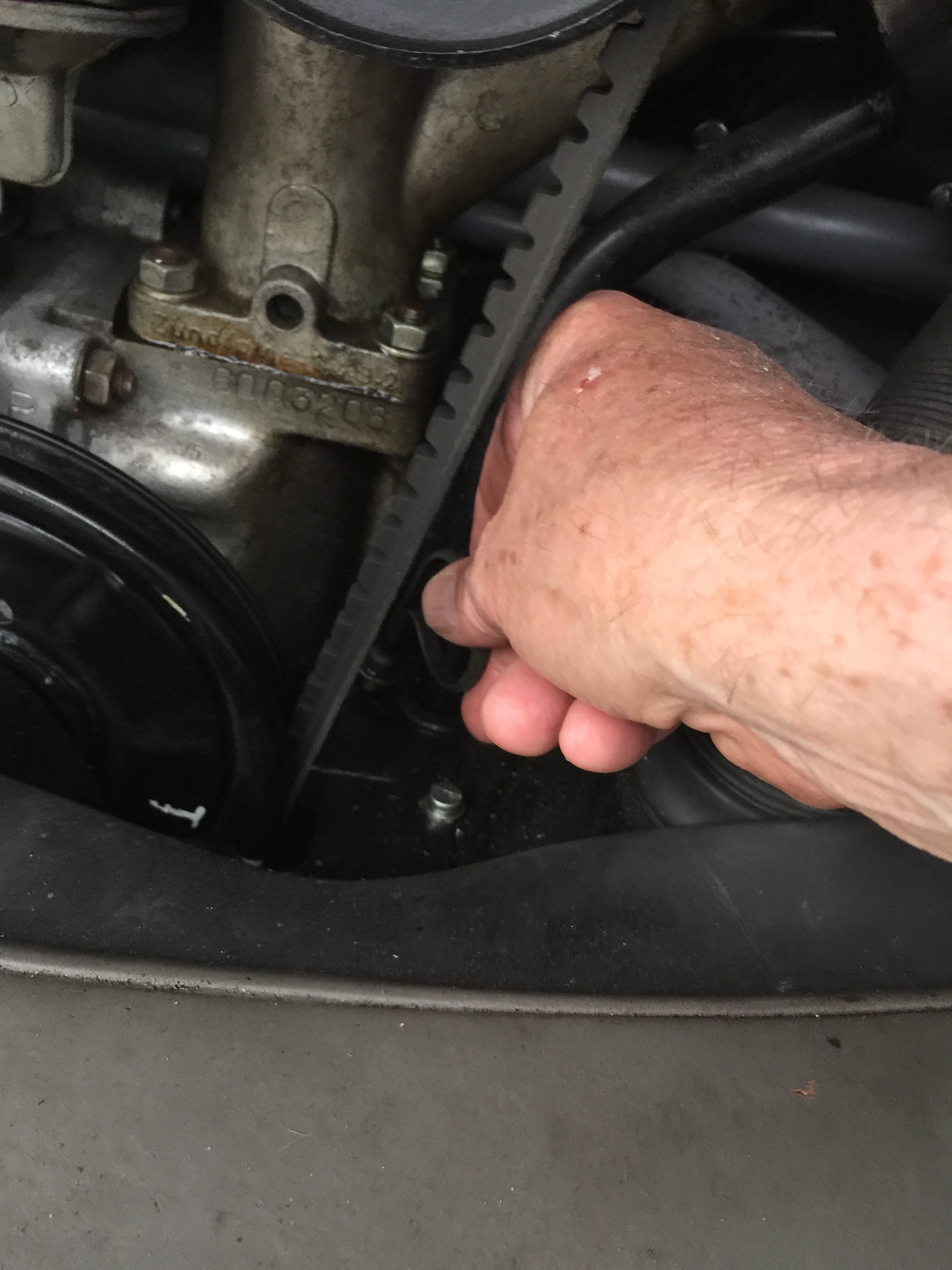

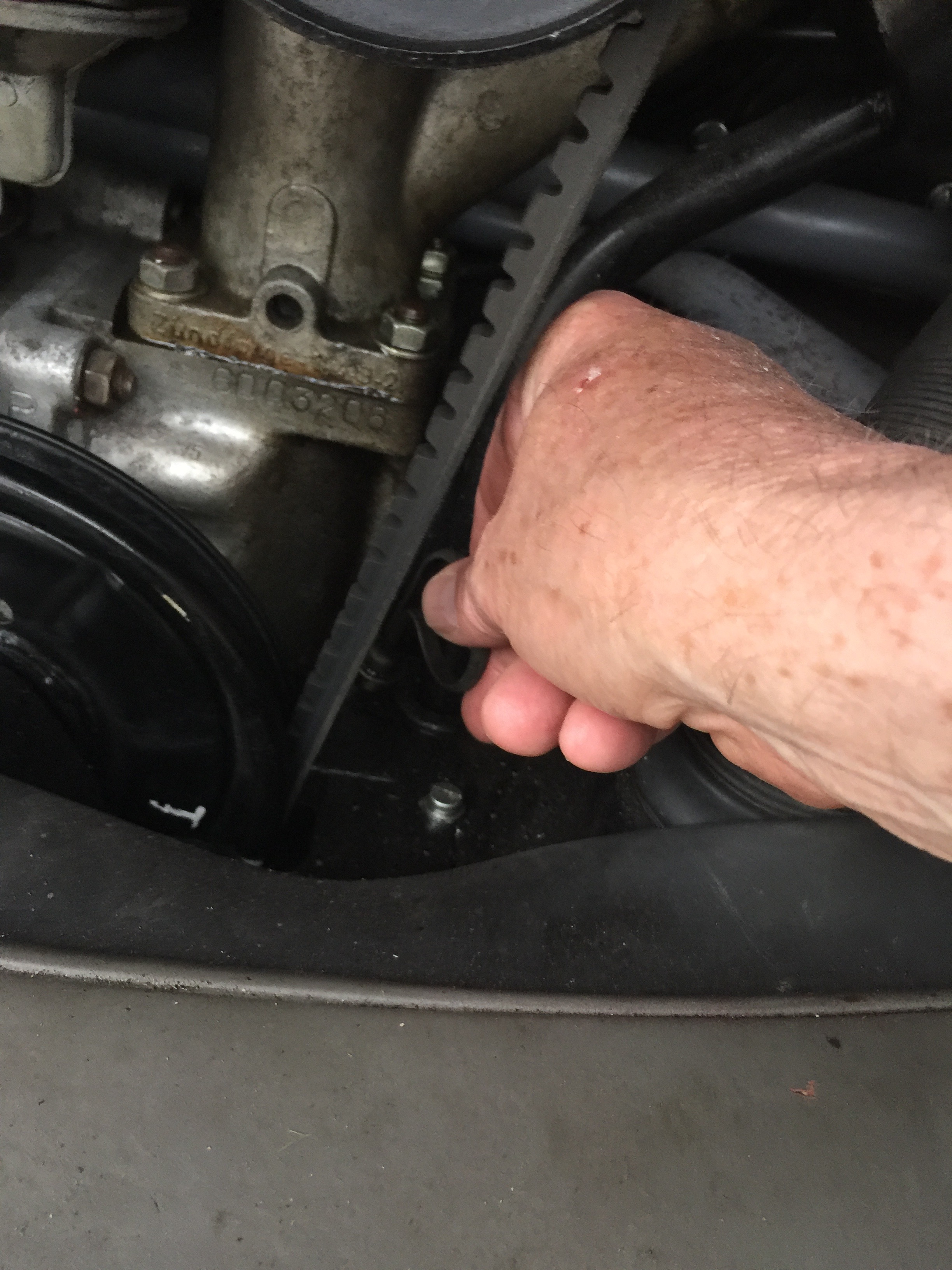

Here are some shots of the dipstick.
I have to work in Columbus tomorrow, but is there an easy test for oil pressure? Do I take out the oil pressure sender and insert a gauge there? Get a reading at idle and with some RPM's?

The red light on the left is the generator light. :) Idle too low?

I guess I learned that the red light was electrical many years ago in my Muir days, but the symptoms were speaking to me in the language of oil.

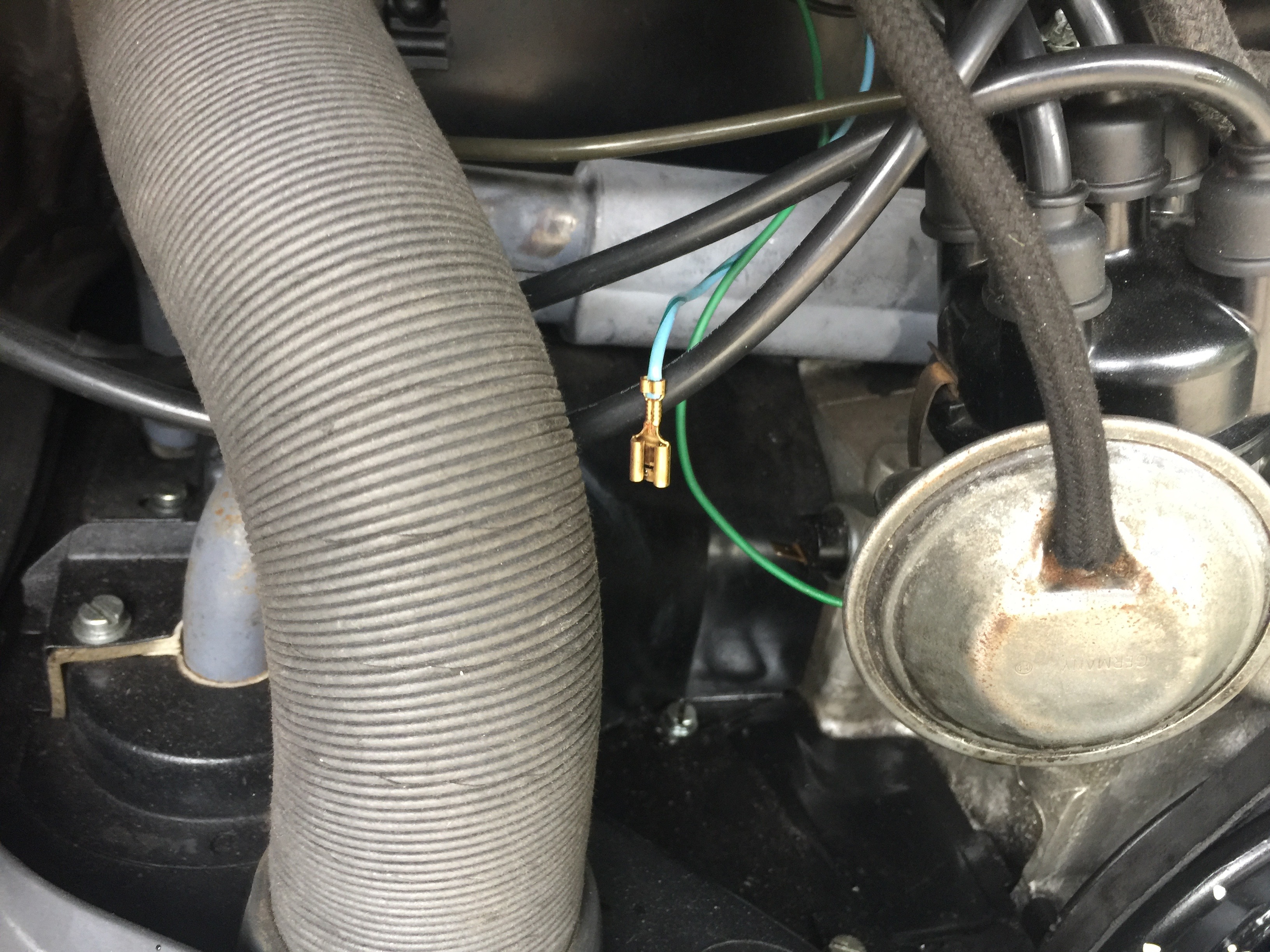

The idle at 850-900 seemed good enough with all the new electrics. And why would the light only come on after a freeway run and not always at idle if it was electrical? Well, I thought the only explanation is the wires might be crossed and they are. I turned the ignition on and observd both idiot lights on then when to the engine compartment and pulled the wire off the oil sender. Then went back to the cab and the red light was now out and the green light was still on. So the oil sender was wired to the red and hot to green. Easy fix.

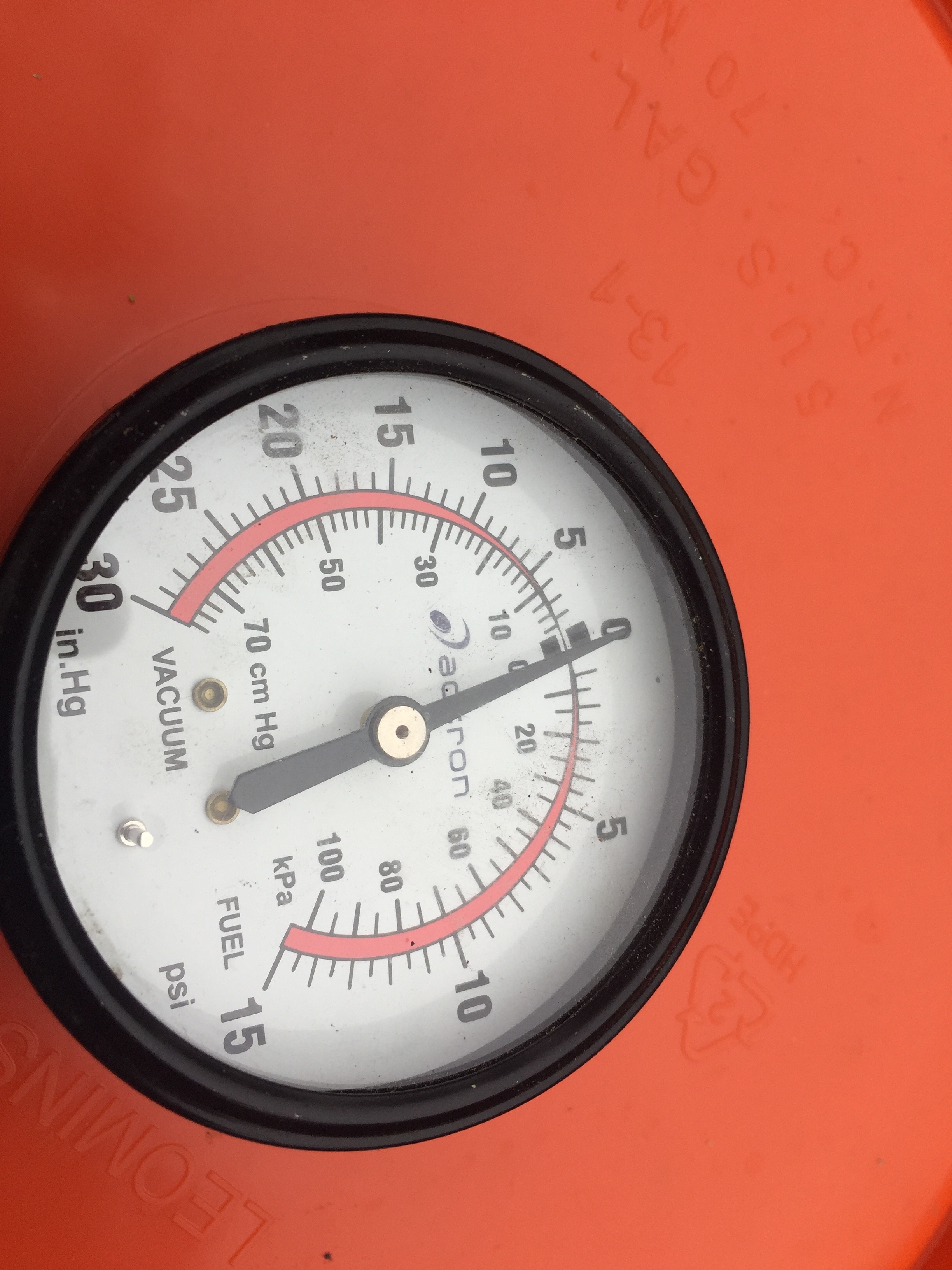

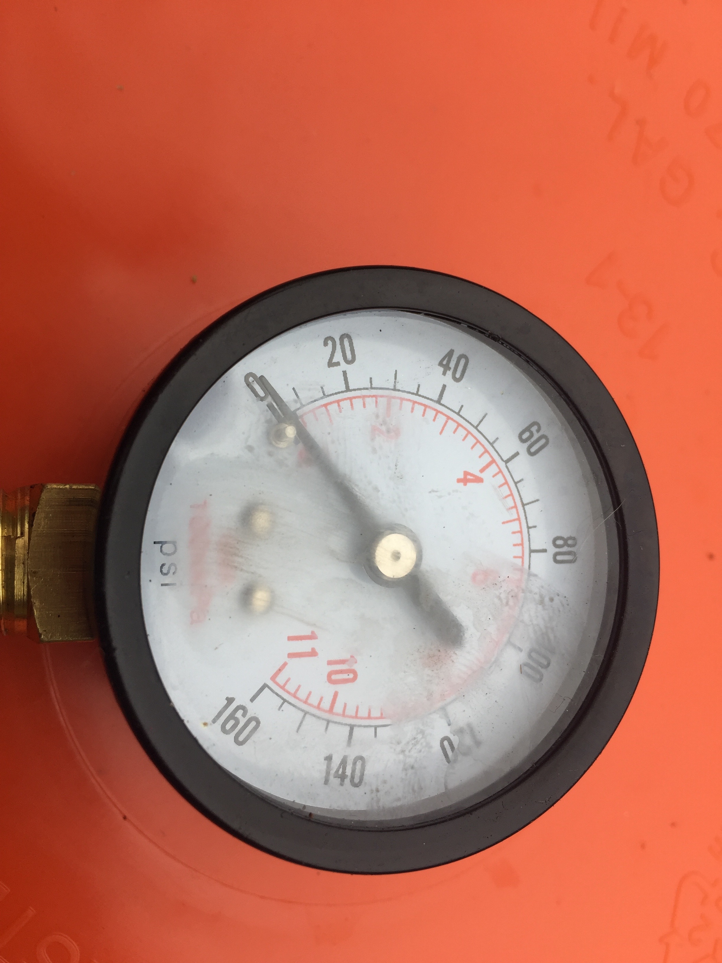

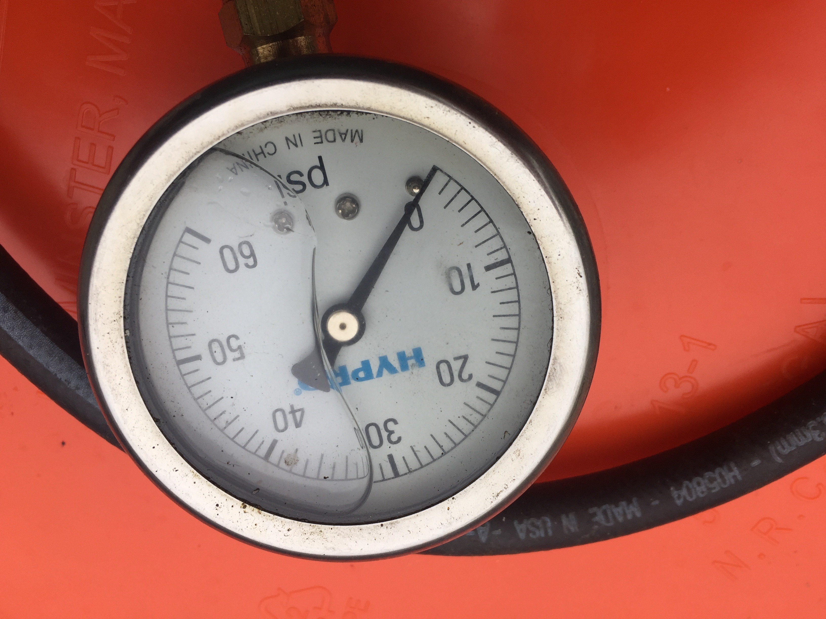

So, here are some of the gauges I'm going to play with. I don't have a vacuum port on my manifold so I guess I can forget vacuum.
I guess I can try the first one for oil. The second or third ones for fuel. I think the 4th one is for fuel injection. The fifth one is (I think) for water! :lol:
I'll report back on Sunday after I have my Green Eggs and Ham! :D

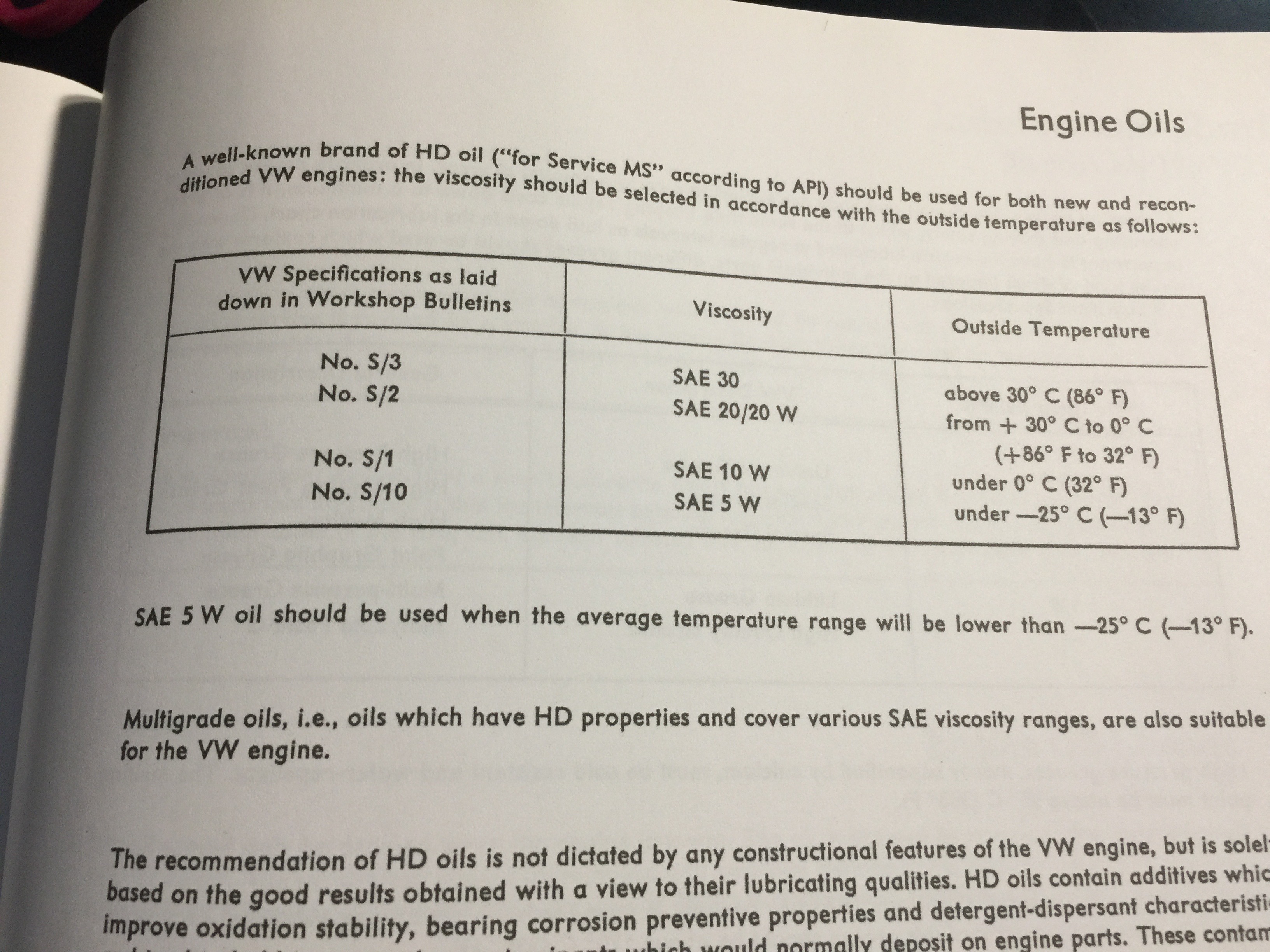

IMHO 30 wght oil is too thin. Check your Bently manual.
Re: Sean's '59 Panel
I thought 30 was consistently thicker than the ranges 10-30 or 10-40? Should I try to find straight 50W? Here's what I could find in Bentley. I've never heard of 20/20. :?
VW's recomendations changed in the 70's. I have always used 20/50 This is from 70's Bentley.
