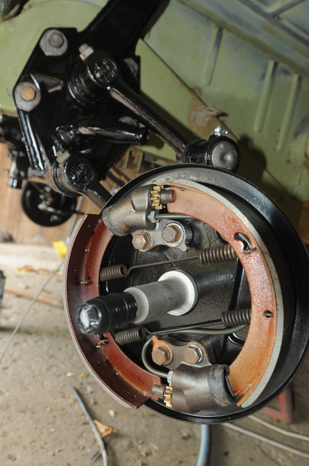

You "probably" have the late brake but here's how to tell.
I don't know how to ID the front spindle/brake without pulling a drum, but here's what to look for with the drum off:
This is an early brake, note the straight spindle and goofy angle of the adjuster vs. the cylinder:
This is a late brake, note the tapered spindle and adjuster parallel to the cylinder:
These are not my busses! If you go back in this thread you'll find pics of my spindles too.

032.jpg[/attachment] I know nothing about early bus codes. The photos Bruce provided make it clear that I have the later spindles. Many Thanks Bruce.

Dual Port wrote: Thu Apr 11, 2019 9:48 am how to ID the front spindle/brake without pulling a drum
Dust cap mounts IN the drum it's Early spindle shaft. Dust cap mounts ON/OUTSIDE the drum it's Late spindle shaft.
If you have 20mm link pins and a Late shaft those are '63 Only spindles.
Late spindles have 22mm link pins.
The link pin sticks out the back of the torsion arm, so you can measure it there.
No need to remove any brake/spindle parts to positively ID the spindles.
