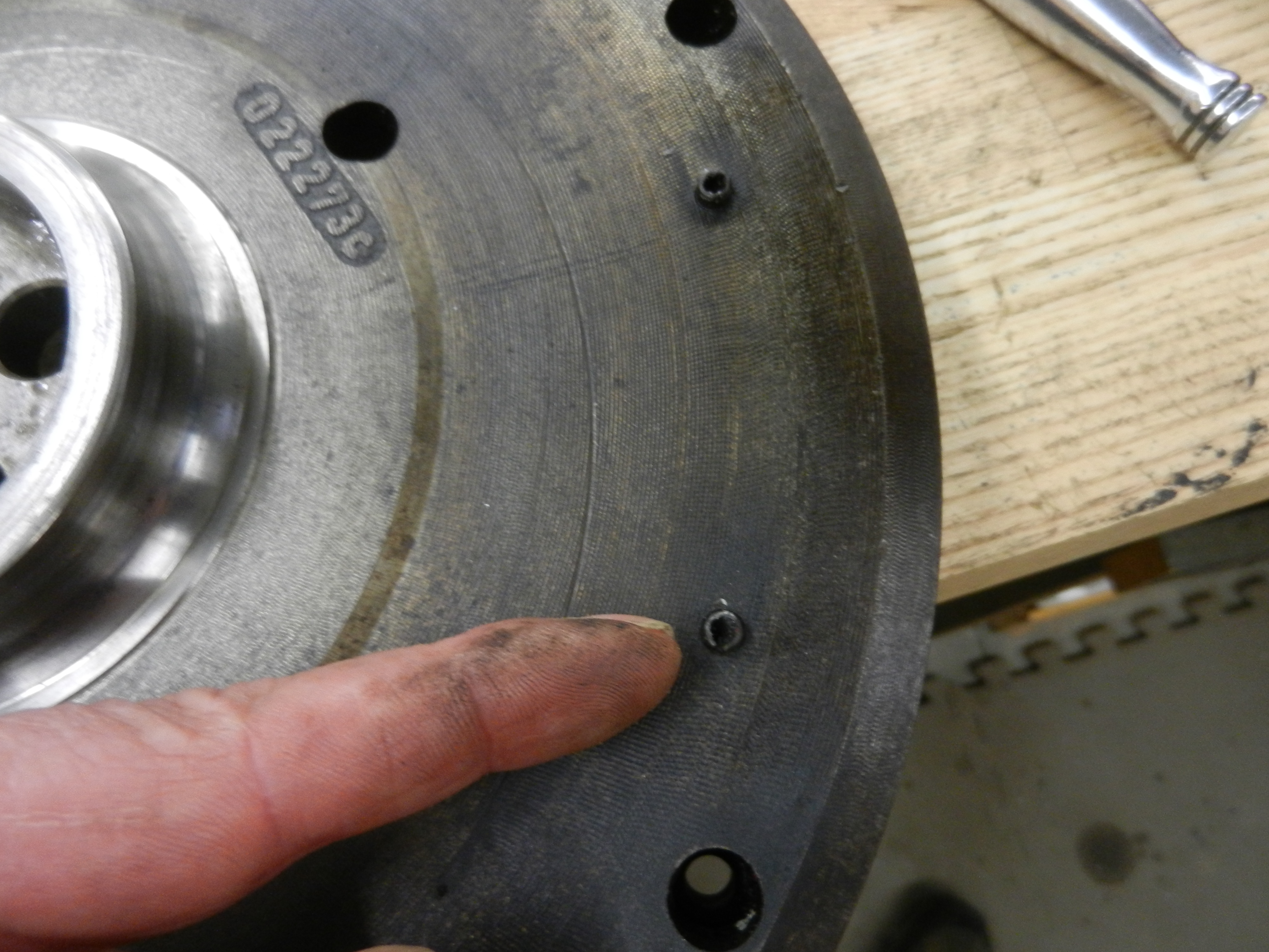

This is why. These dowels on the flywheel will hit the protruding plug and when you try to turn over the engine, you will only get so far before it stops.

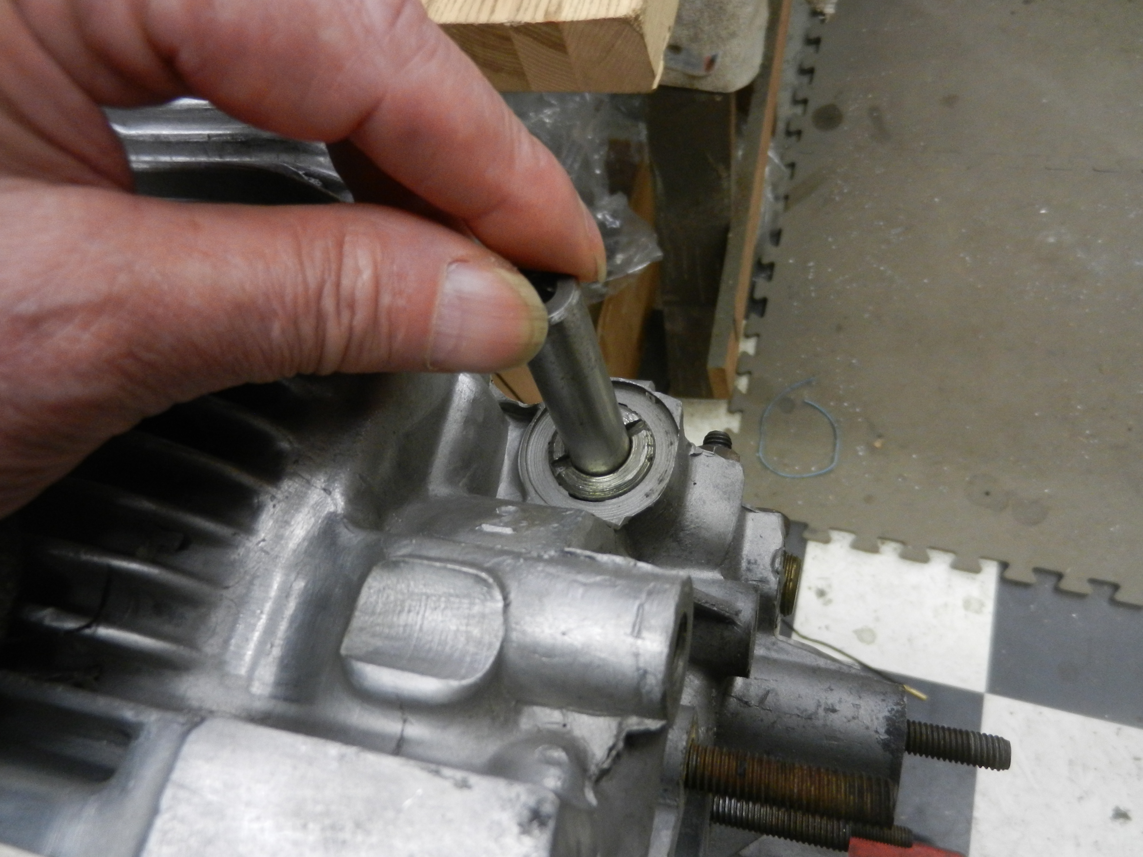

This one is VERY important. It holds the oil pick up in place. It is 71mm long. Too long or to short and you will have problems. Check it carefully. It is sometimes bent, do to someone over tightening the strainer sump cover,which only torques to 9ft lbs. If is bent, get another one and check the threads in the case as they may be damaged.
on assembly it goes thru the left case half here. Which is easy to miss on teardown,as it is usually buried in crud.

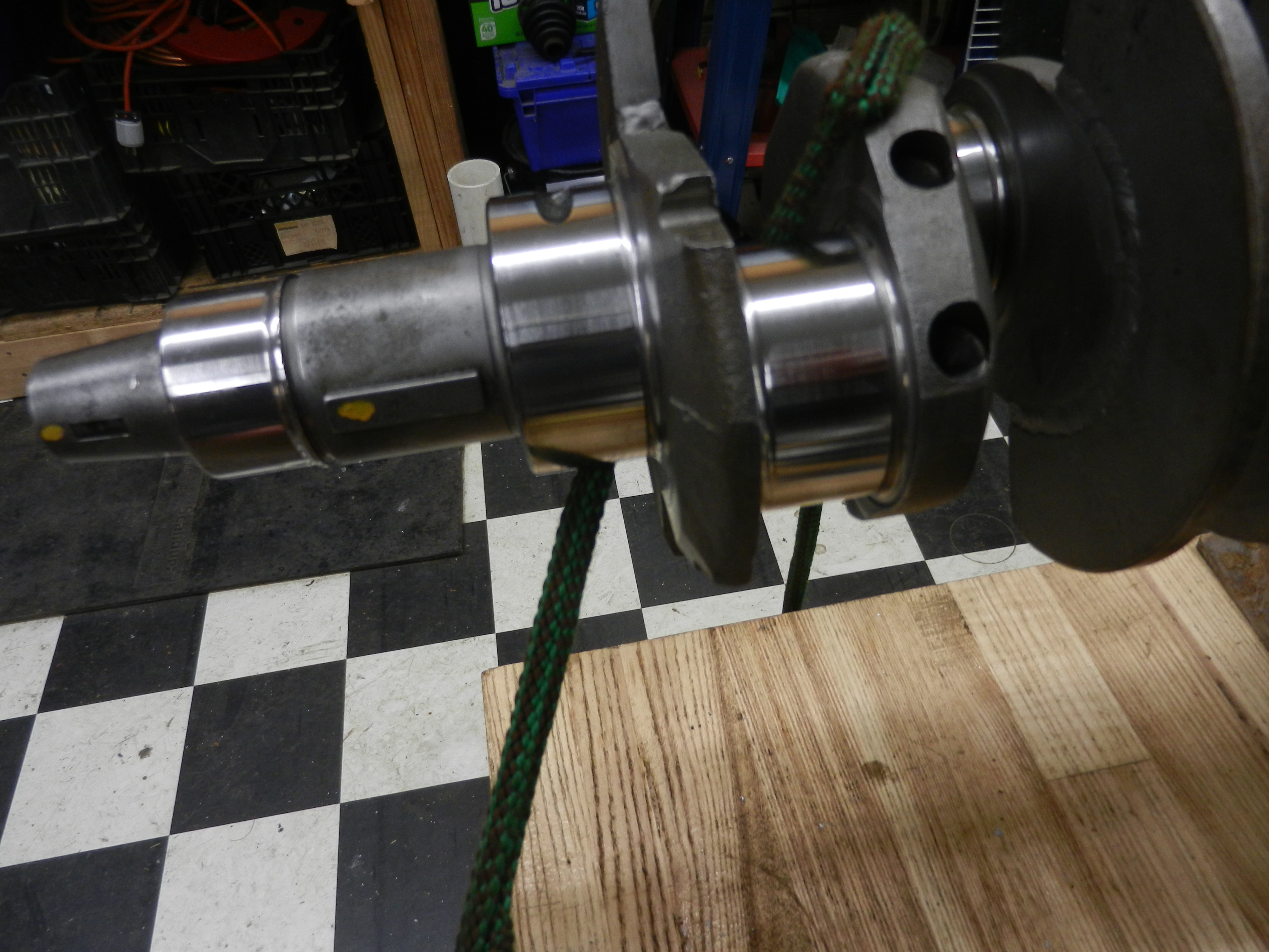

We are going to set the case aside and move to the crank shaft.
Check it AGAIN. 1,2 and 3 spec is 5.97-5.99 they were all spot on. No pic for #4, but it was also spot on.
Now clean the oil passages. A gun cleaning bore snake works well for this.
Now to install the crank gears and # 3 bearing. Bruce documented this well and the procedure for type 1 and type 4 are the same. BUT, I had a little problem.
After wiping the journal and bearing with brake cleaner and wiping the journal with assembly lube,
I pump a little oil into the journal. This pic shows another journal (no pic of #3)
I heat the gears on a piece of fire brick with a torch.
Be sure you orient the gear so the timing marks face the nose of the crank.
Install the spacer and heat and install the dist drive gear.

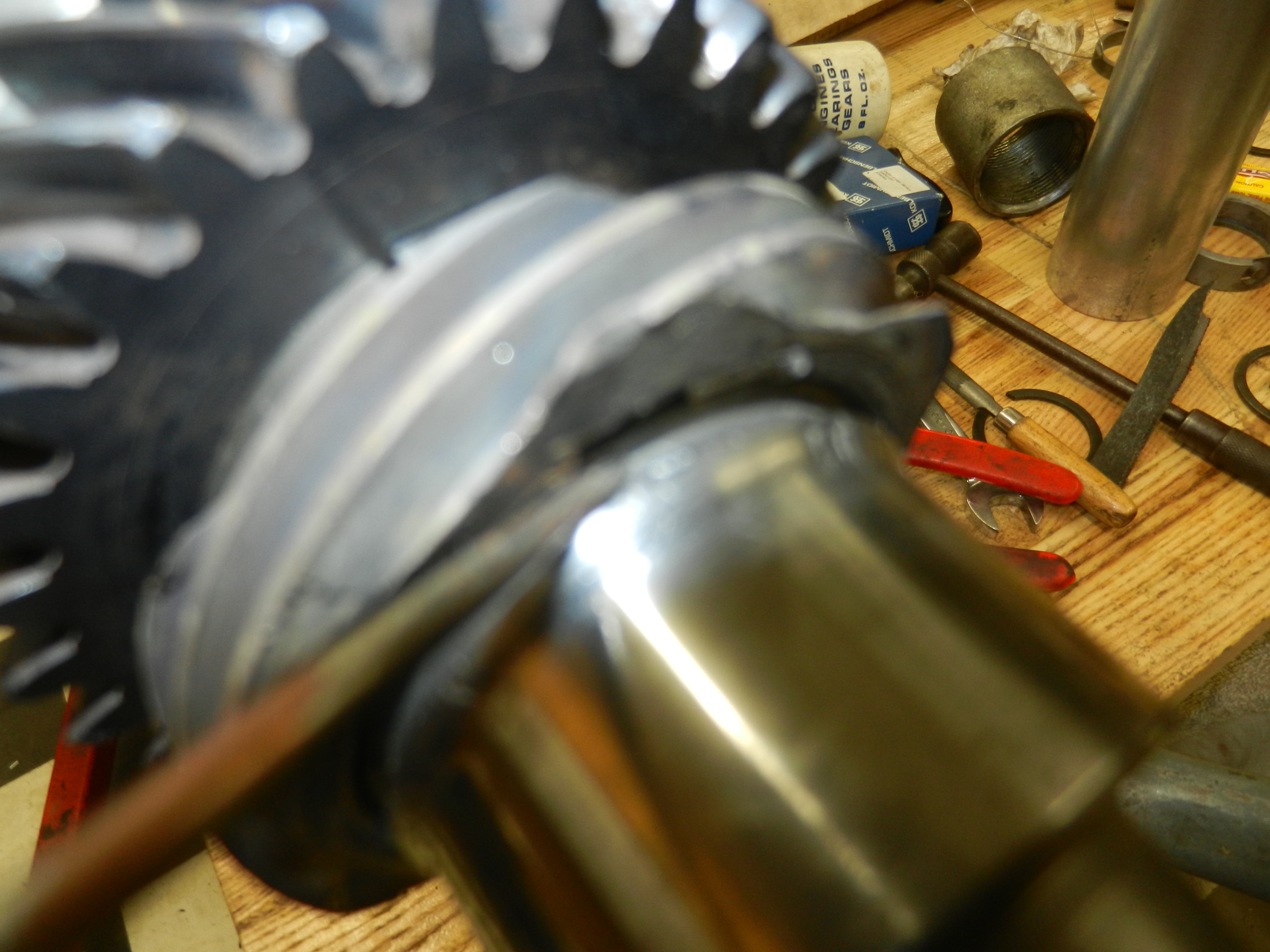

Then, install the snap ring in the groove in the crank. This is where i had a small problem. The snap ring would not seat in the groove.
Shit. Maybe I did not have the gears seated. Pull them off and try again.
Re installed and had the same issue. Pull them off again.

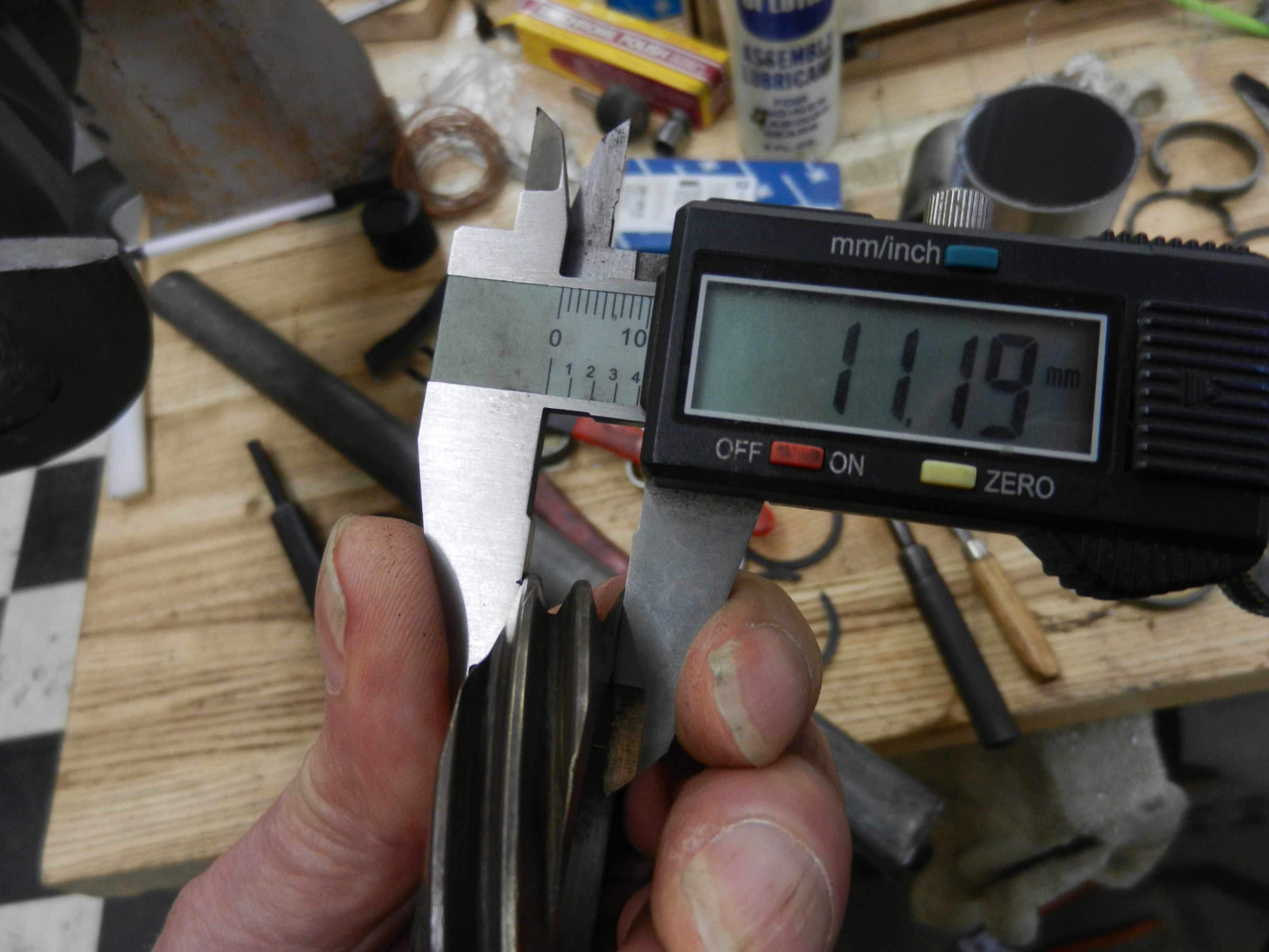

I had used a NEW brass dist drive gear. Let's check it out.
POS
Grab a used dist drive gear and guess what.

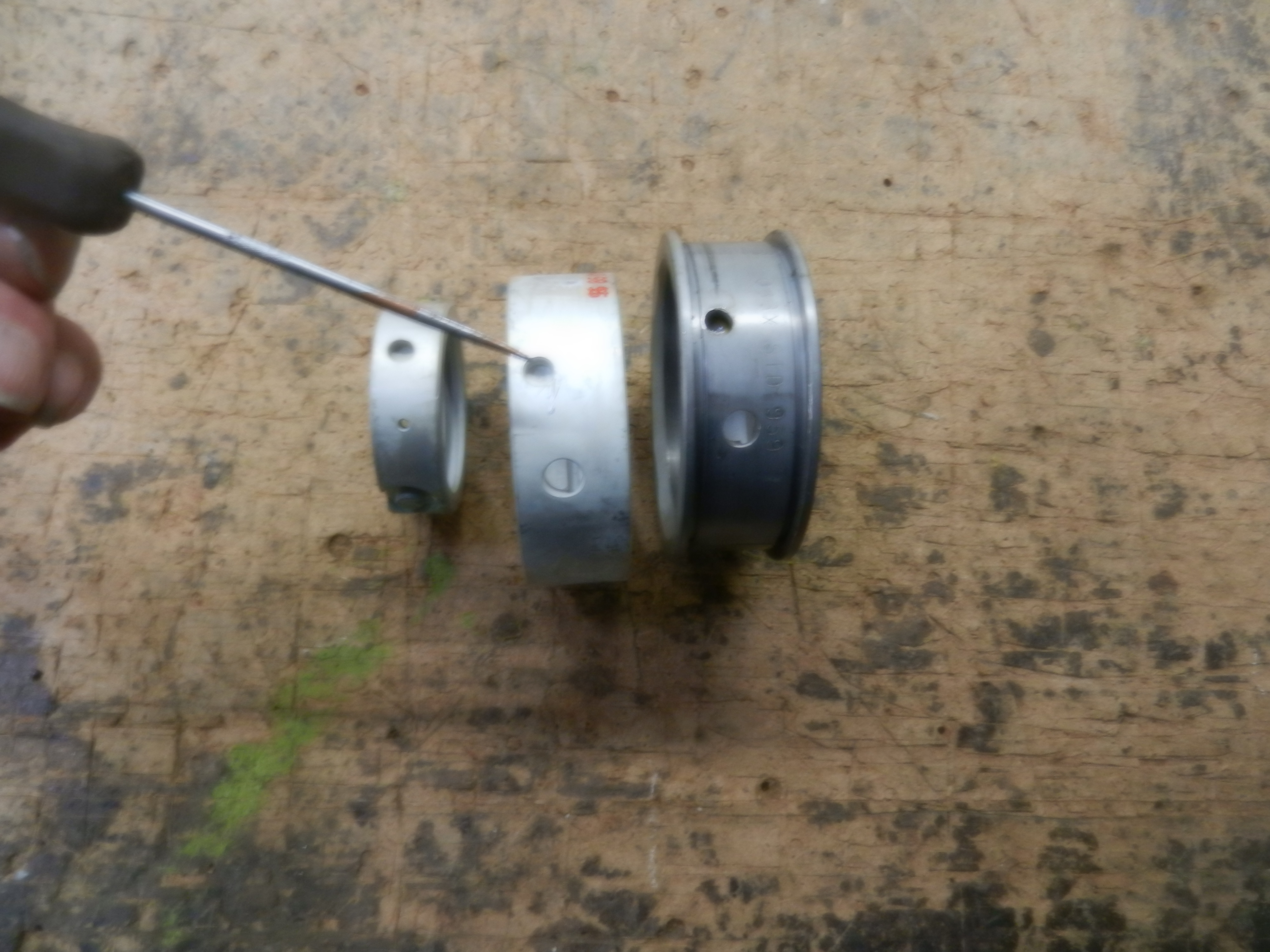

Before we move on. I am going to back up a bit. Before installing # 3 main bearing, you need to orient the bearing, so the dowel holes are aligned.
Note, the dowel holes are offset.
They are all offset towards the flywheel end.

Also, set the bearings in the case, making sure they seat nicely and mark the parting line. Also a good idea to put a magic marker mark on the.flywheel side of the bearing. #1 shown, but the same was done to #'s 3and 4

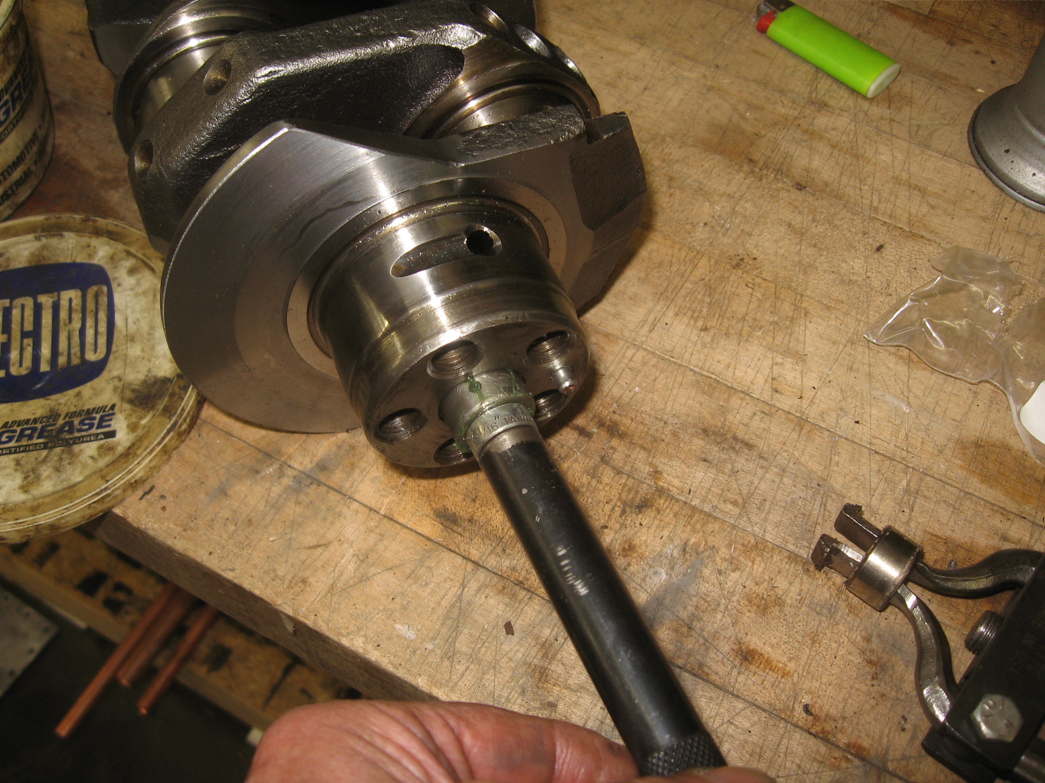

The pilot bearing in the type 4 is in the end of the crank. It is in the gland nut on Type one, and in the flywheel on 914.
ALWAYS REPLACE . When this bearing fails, it grabs the trans mainshaft like a Chinese finger and you are stuck in whatever gear you are in. Then, it's pull the motor, which is not easy,as the crank and mainshaft are locked together.
Pull the old one out
Pack the new one with grease, I use Spectro synthetic
Install the new bearing.
