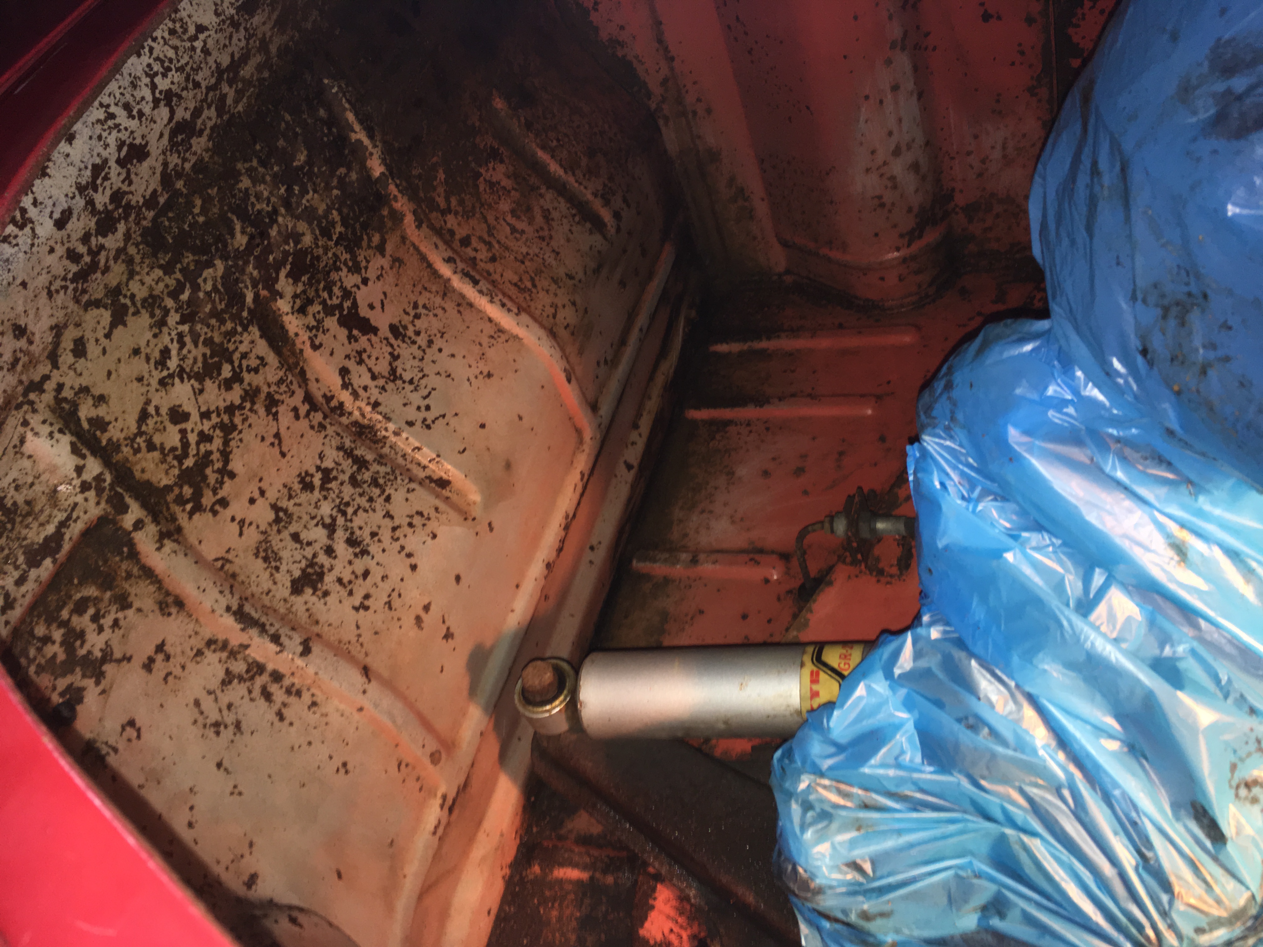

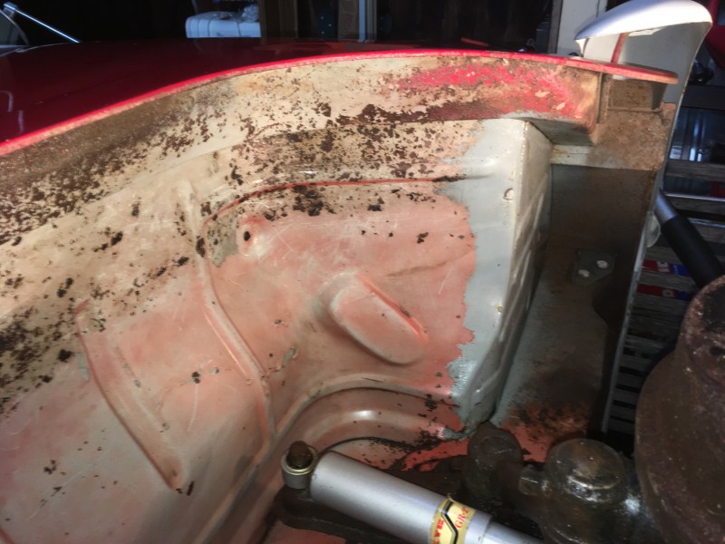

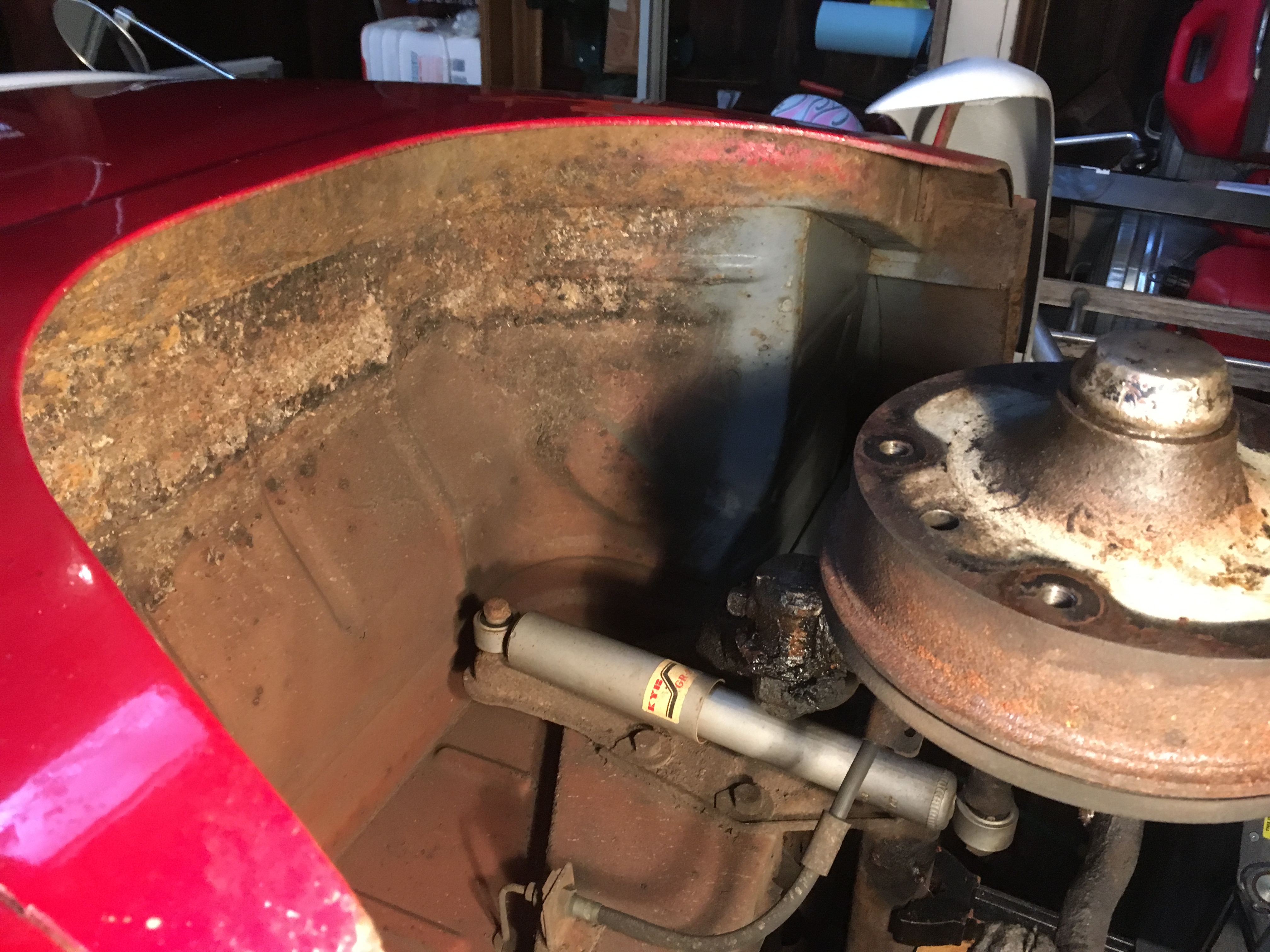

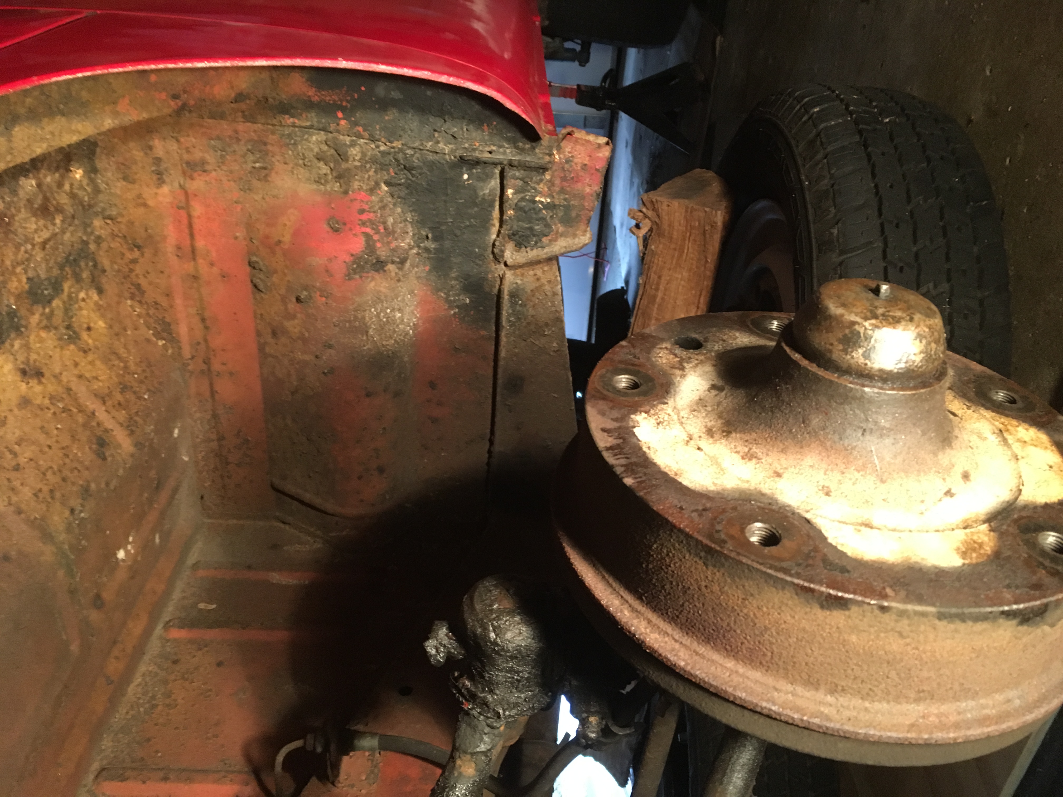

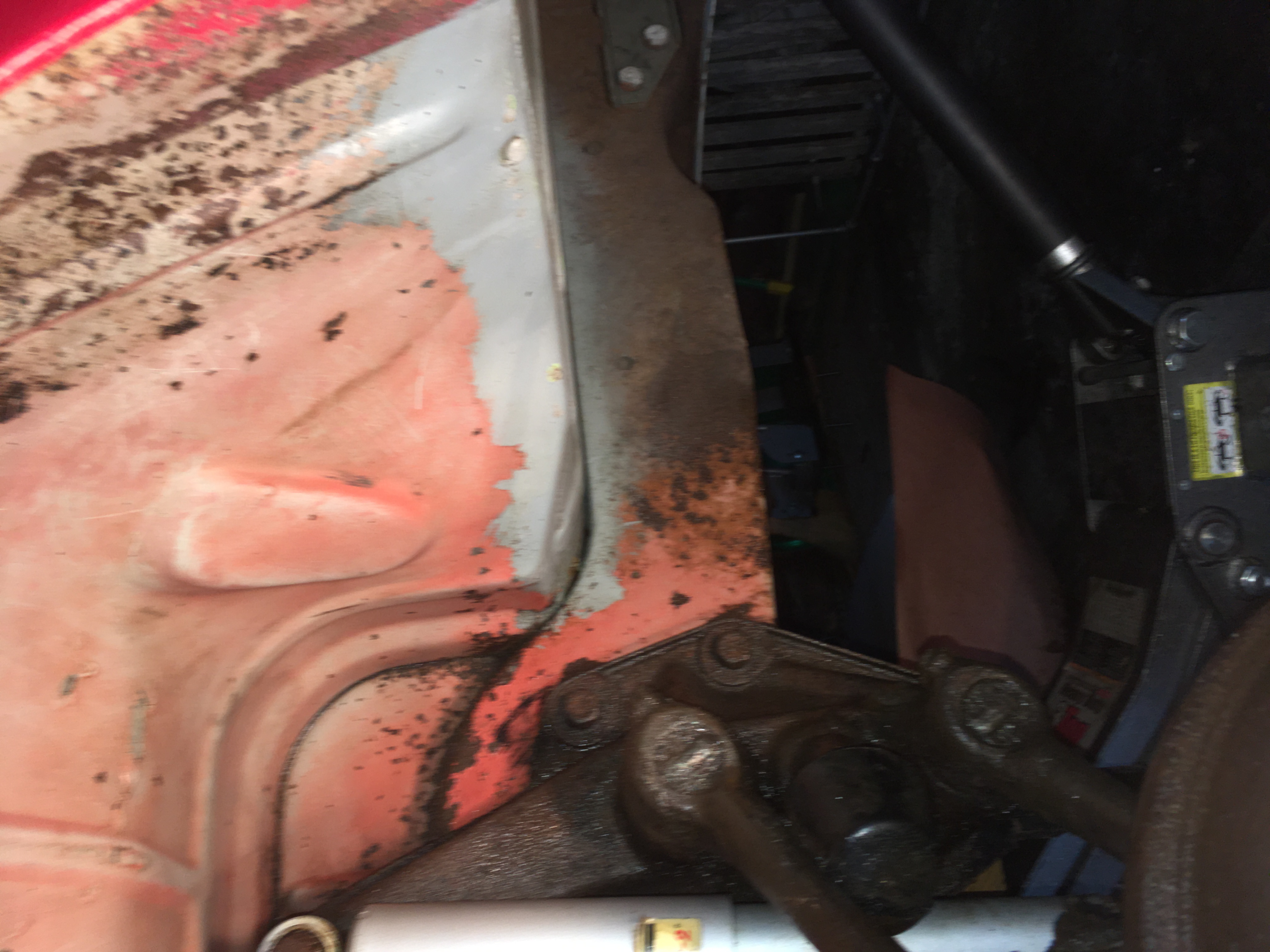

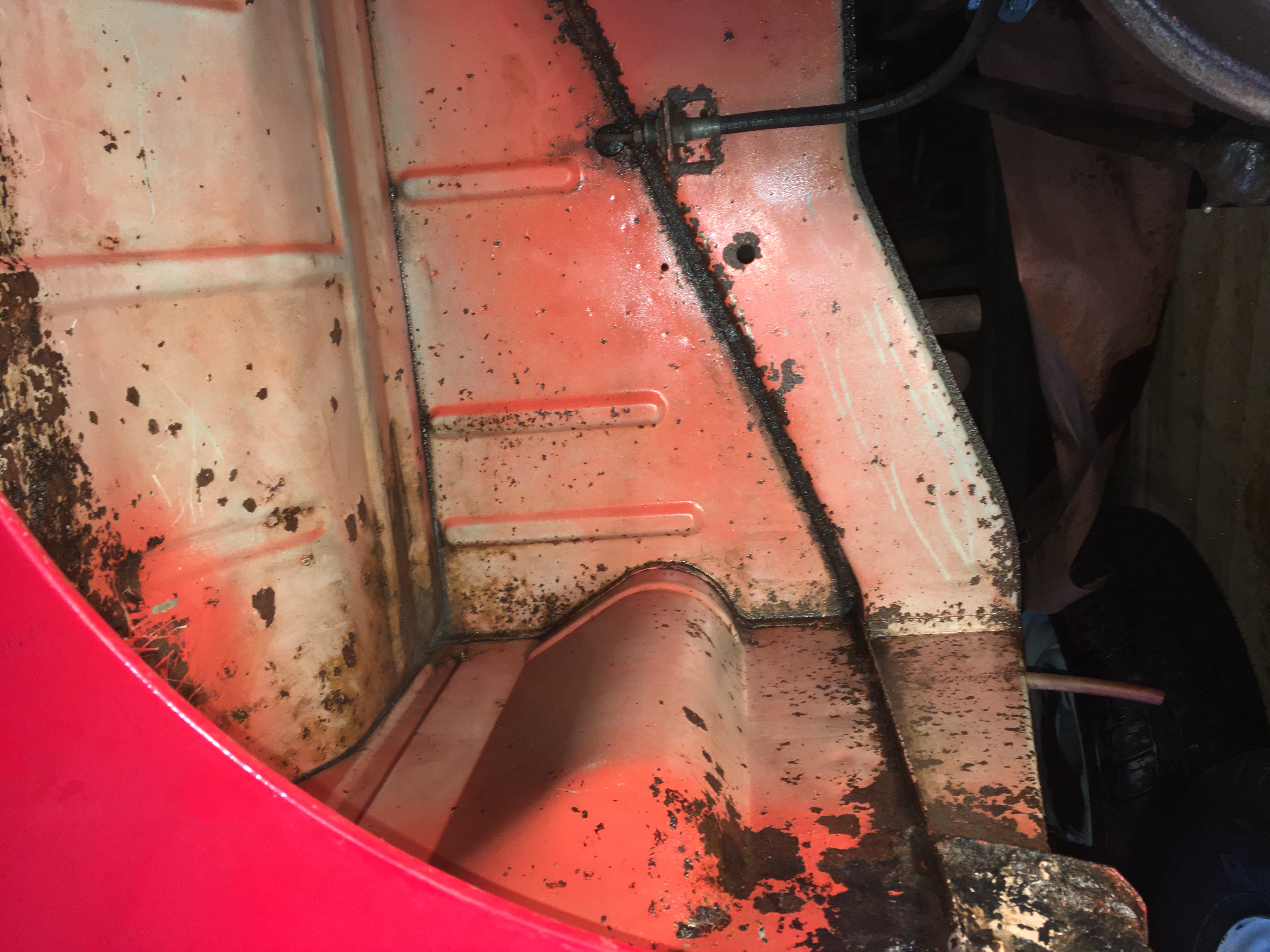

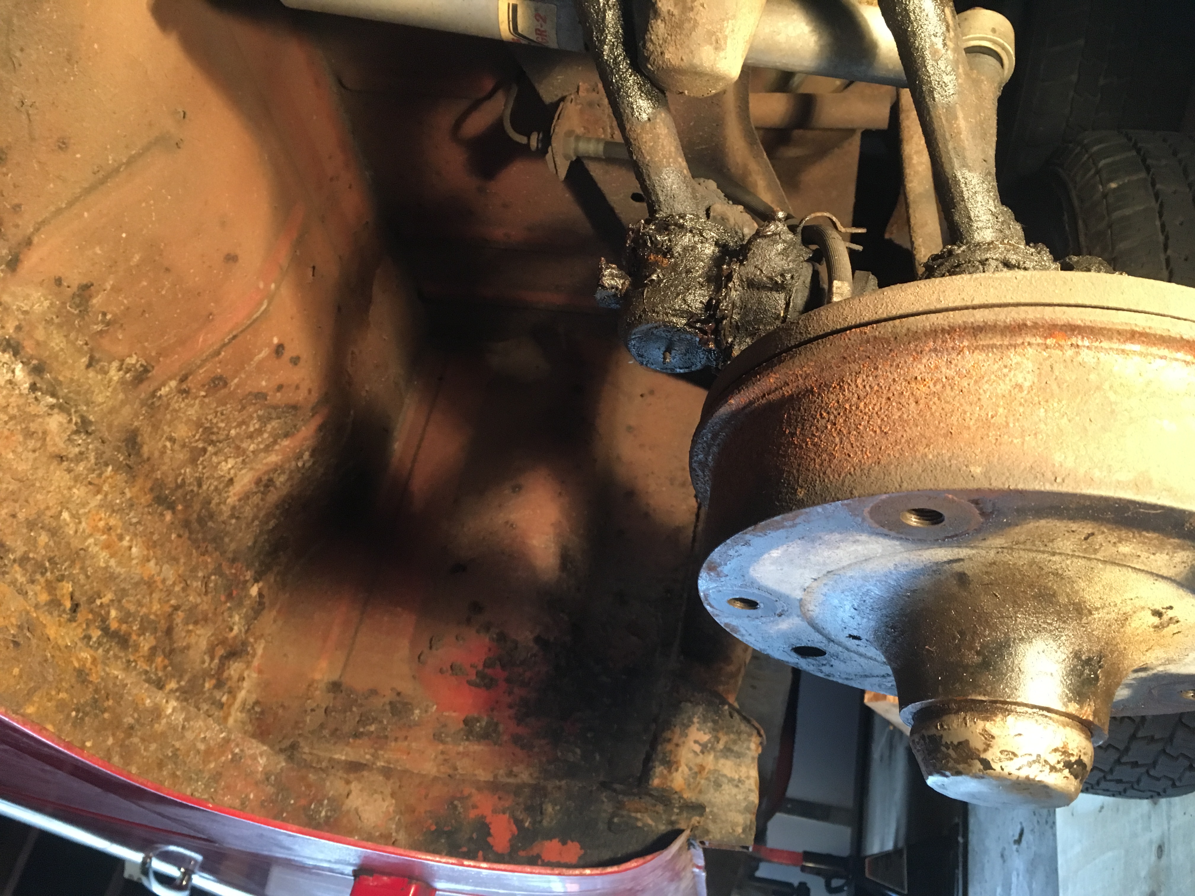

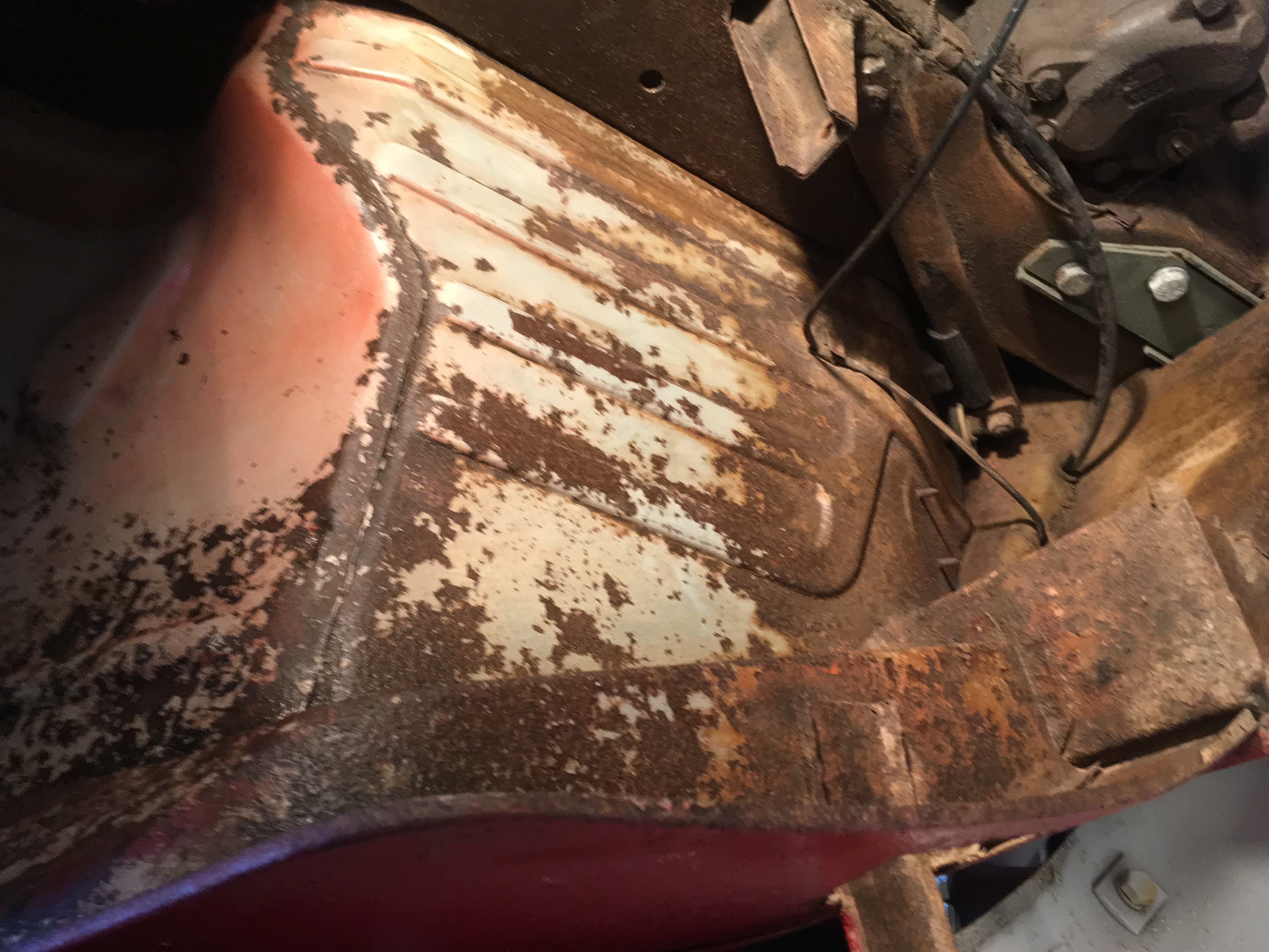

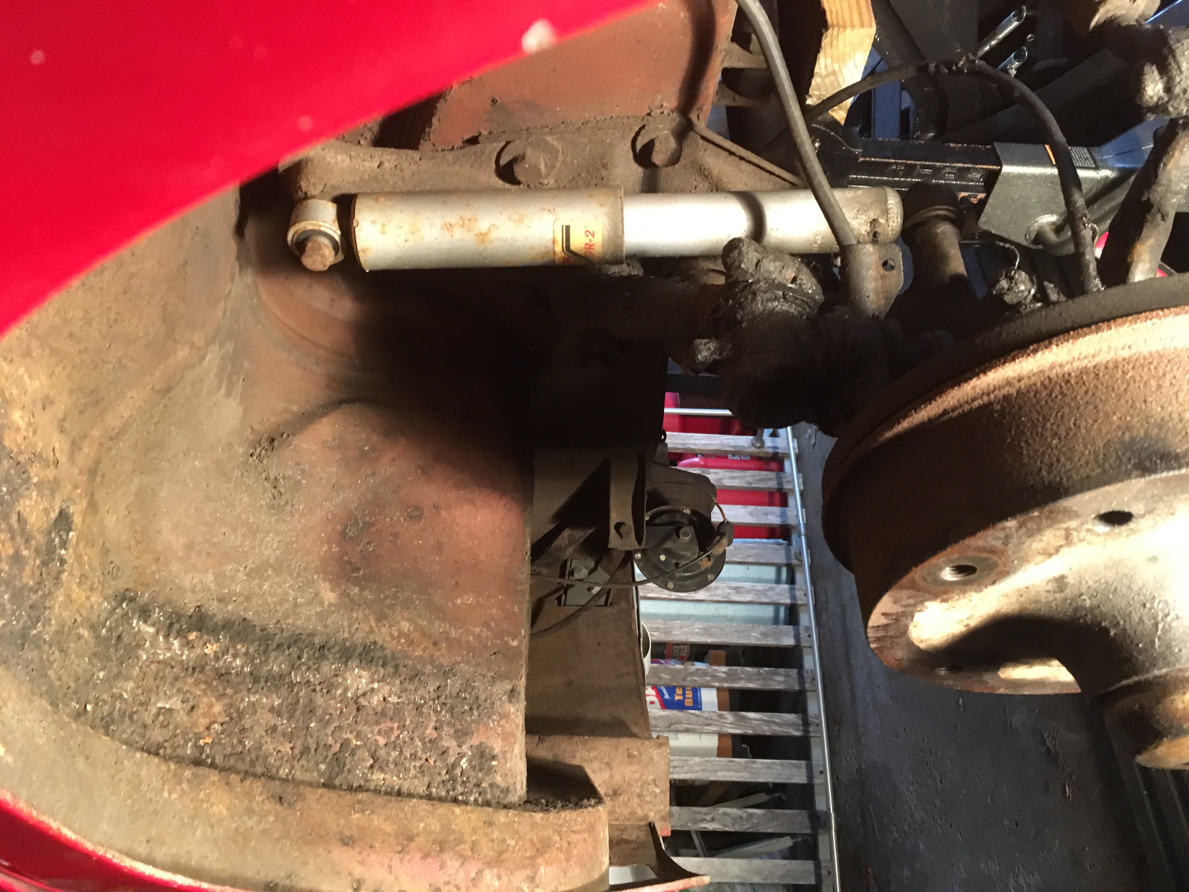

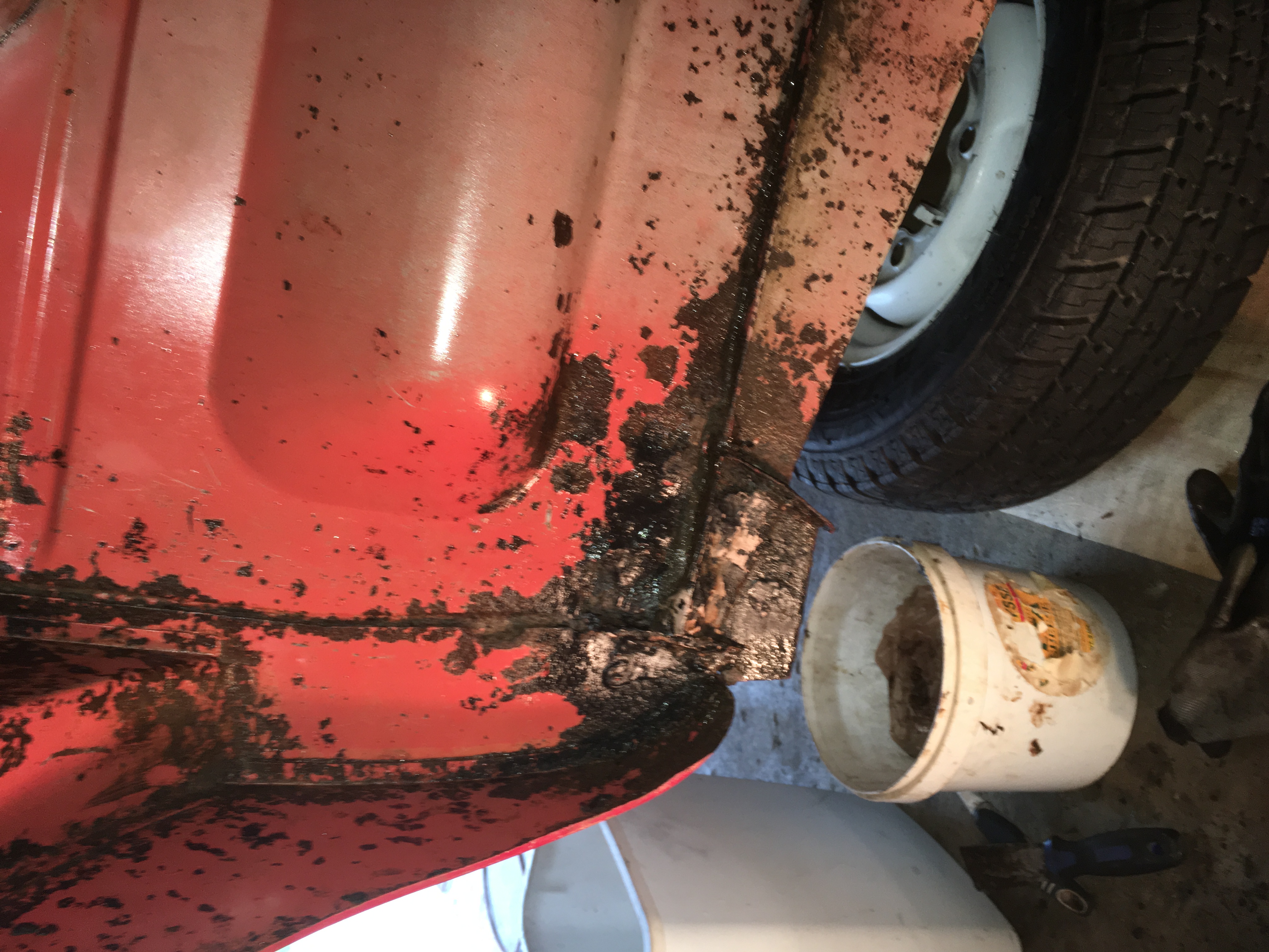

Wow, it has been a long time since I have posted an update to this thread. Not entirely due to lack of work being done, just nothing big or worthy of a post.
I decided to ride out COVID 19 up here in Ohio in lieu of being in FL. I am working from home, so while I am here, I figured I'd get back to a project I intended to start 4 years ago. This past weekend I started cleaning and prepping under the front wheel wells. My goal is to clean and seal the surface rust that is under there. As you will see, this was a much needed project to get to.
All in all, it is pretty solid, I was happy with that. No holes in the metal but some Bondo in the area near the jack points. It felt solid and there isn't a lot of it, so I decided to leave that alone.
So far, I cleaned a very hard and thick layer of dirt and grease from the underside. I used a scraper, Zep Purple cleaner and Pine-sol to get it cleaned. I brushed on some Etch and Prep and let it sit over night to seal the rust. Next will be to wipe it down, let it dry and then 2 coats of primer. I will have to wait for the temps to get a little warmer, or put a heater out there to paint.
Below are before pictures and after it has been cleaned. Click the phot to see them right side up.
Nice work Marla! Is this the product you are using?
https://www.homedepot.com/p/Klean-Strip ... /100406369
I'm going to do something similar to all my Tacoma frames.
That looks like the stuff Sean. They may have changed the label? The bottle I have says Phosphoric Etch and Prep. The directions for rust on metal and prep looks the same. Don't forget to use PPE with it.
Wow, looks good, that bus is a lot cleaner than either of mine was when I got them. Keep up the good work!
